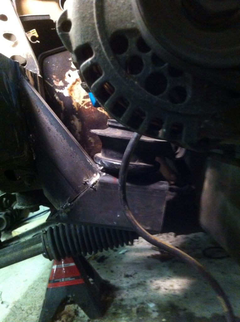

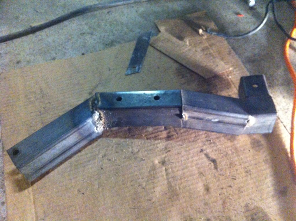

              For the mounts i used 3x3 1/4inch square tube. I felt that for the amount of weight and torque that the rb has, i didn't want it sitting that far from my subframe. I felt that welding them to the chasis would be alot safer.

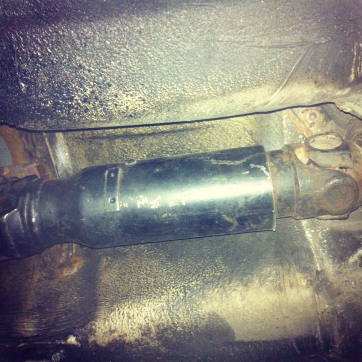

              I chopped the shaft and did a quick test fit. i also wanted to see if everything lined up. I dont have a lot of room to look under my car at the moment so im going to eye ball it. So far everything looks pretty good :up:

                looking good man, check out my build for any ideas. i welded mount perches to the frame rails also, and i also ditched the booster, plated the firewall and moved the master cylinder over and mounted a remote booster on the passenger side under the dash....just another option for ya.
                  The mounts are interesting....

                      As for the mounts, yes they do look interesting lol. But so far they are feeling pretty strong. I'm not exactly done yet though. I'm adding some stuff to it hopefully tomorrow. The tranny mount should also be done tomorrow as well.
