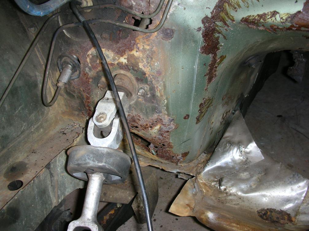

    The Car

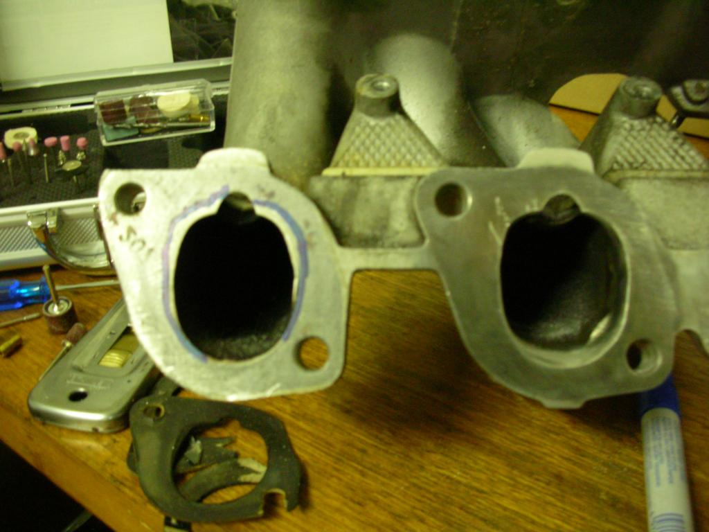

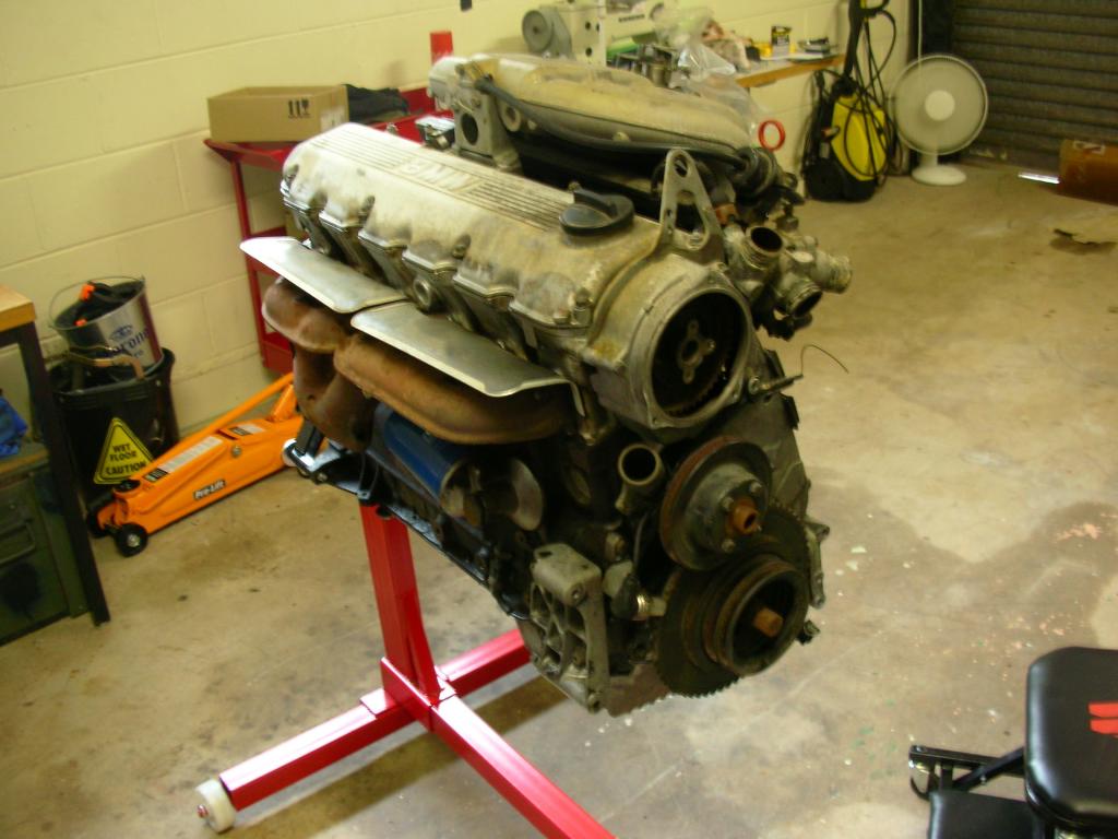

    I fully stripped the engine and began clearancing the block to receive the 3.1L stroker crankshaft, conrods would hit the bottom of the bore if not clearanced. I also stripped the head as I was replacing the entire valvetrain.
    Whilst I had the die grinder out I also cleaned up the intake runners where they meet the head. The old manifold gaskets had left a very nice impression of where the castings didn't meet up, so I simply enlarged the runners to suit.
    I may have upset the purists here but my thinking was sound. intake is all about getting as much air into the cylinder as possible, laminar flow is the type of airflow, laminar flow is best achieved when the air has as few interruptions as possible. QED
    Once this was was done I sent the block and head to the Machinist Shop along with all my other new goodies for a deck, bore, hone and balance of the bottom end. Straighten, deck, pressure test, then valve guides, seals, springs installed.

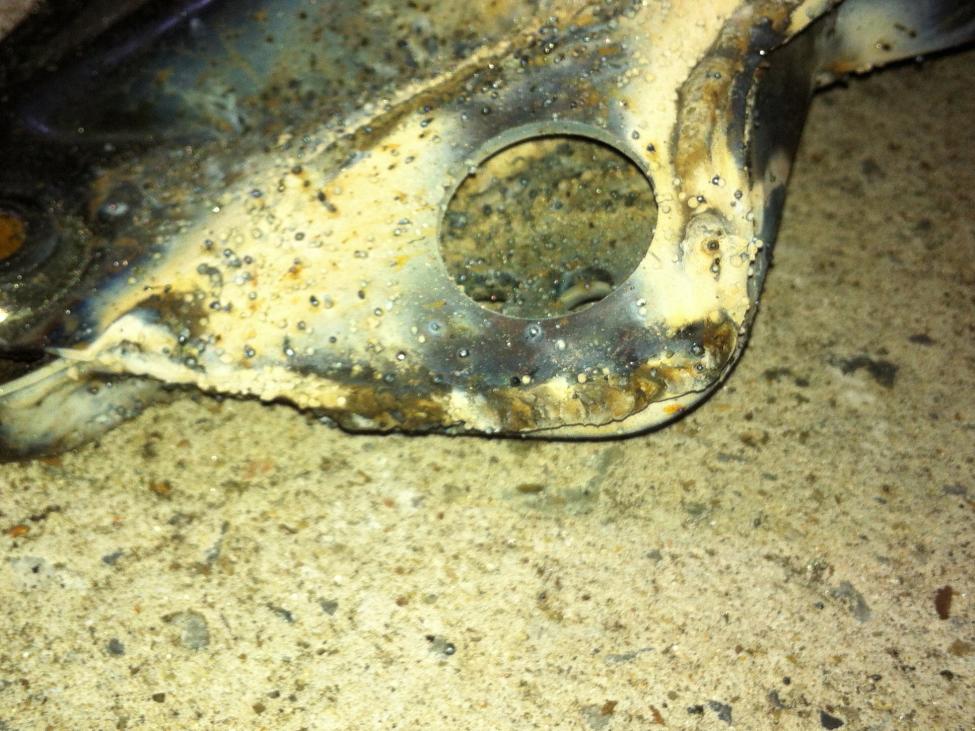

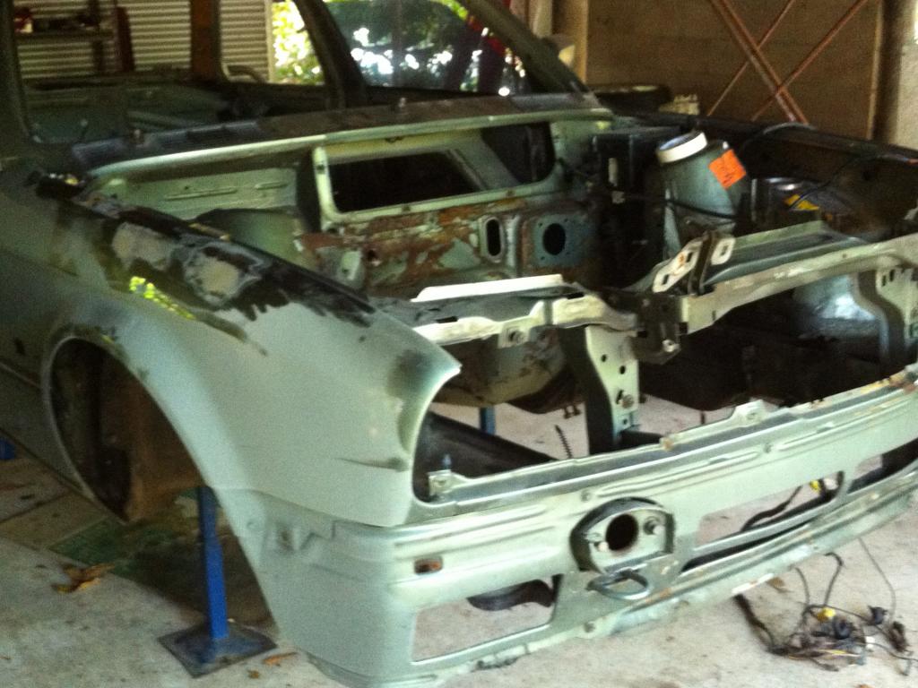

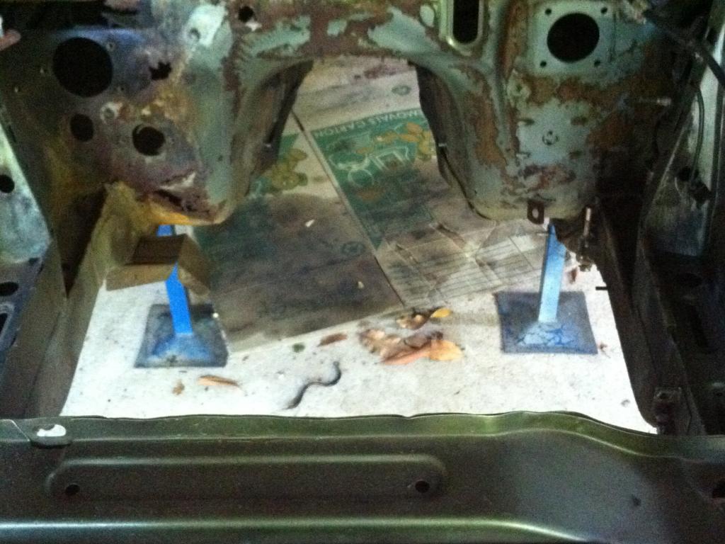

        The next phase of the build was actually the disassembly, which co-incidently was also a discovery phase :(
        Got the old motor M20B23 out gearbox and all, dropped Diff and tailshafts and then proceeded to remove the interior. All was going along swimmingly until I pulled the carpet on the drivers side, right side in Australia, and notice a little surprise.
        Yep, that's the garage floor seen through the floorpan.

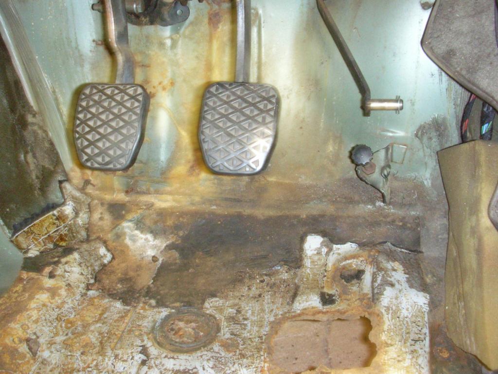

        I should digress, I bought the car over the internet, flew 4,500Kms to the seller, looked over the car, was satisfied, and after a snappy fluids change, (oil, brake and diff), drove all way home.. The car drove beautifully, the stroked 2 litre had plenty of torque and sat at highway speed comfortably. It had plenty of poke upwards of 130km/h and would accelerate well through any gear. In a nut shell, I was stoked.
        This floor pan issue was the first real obstacle i'd encountered, and to be honest, it had second guessing myself for some weeks. Let me explain: where i live in Darwin, you could count the old Bimmers on both of your hands and still have fingers left. The other issue is the tyranny of distance.. the nearest source for second hand panel etc., is almost 6,000 kms away, at the other end of the country. For a while the problem seemed insurmountable, but fortune smiled and I had to attend a course in the very city that the best wreckers was in :)
        I bought a 1/4 cut for $250, trimmed it down to fit in a box and put it on the plane on the trip home.

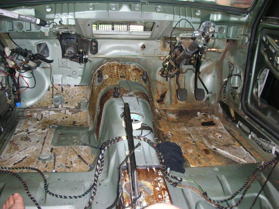

        Anyway, the dismantling continued, and the obligatory removal of that crappy tar/bitumen stuff.
Name:	Interior Strip 4.jpg

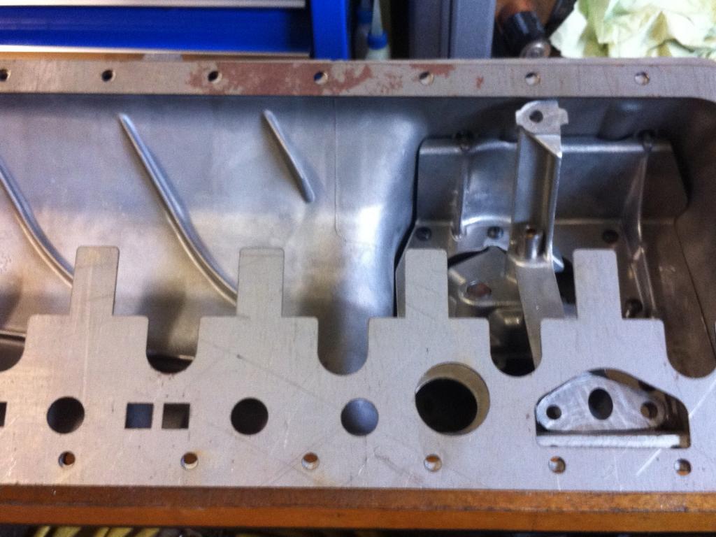

        I also had a bit of a play with oil pan baffles and windage trays/crank scrappers.

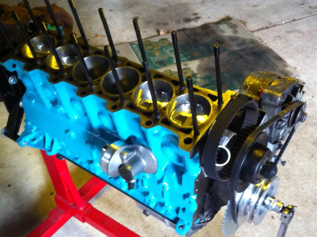

        The Machinists had finished with my engine bits. Mmmmm......Engine bits....

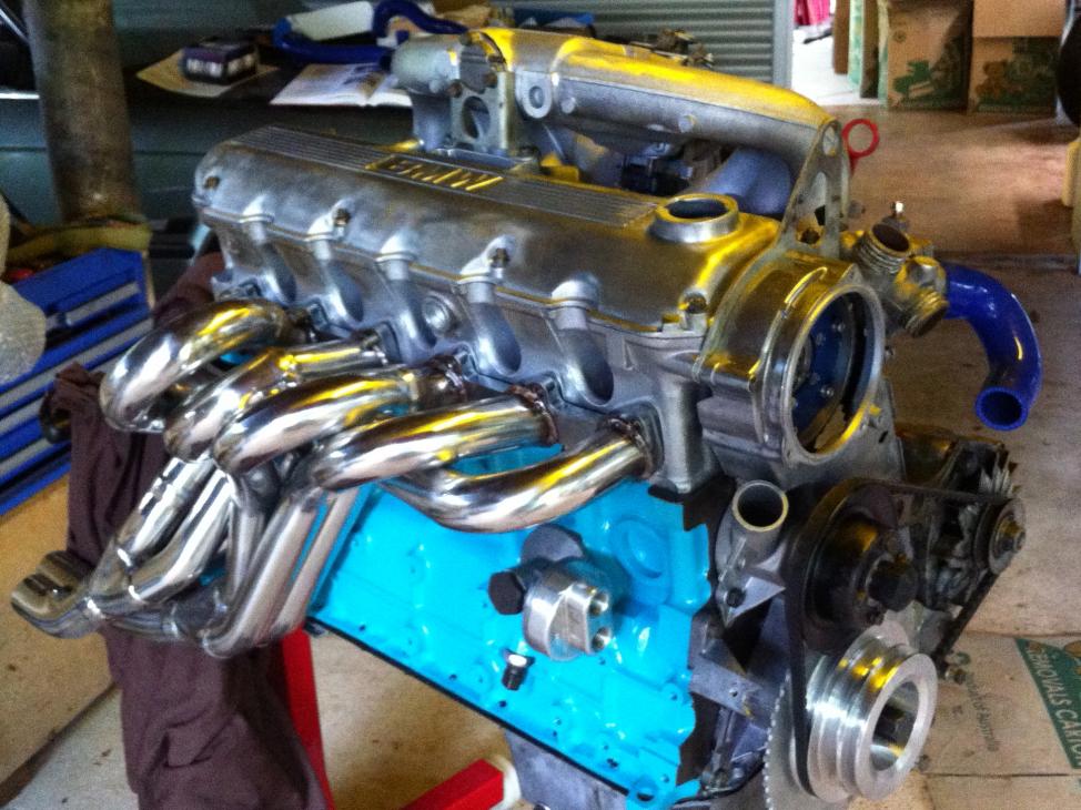

        I set about rebuilding the engine, and I have to say this is by far the most rewarding thing I have done. From the sorry M20B25 I had started with........

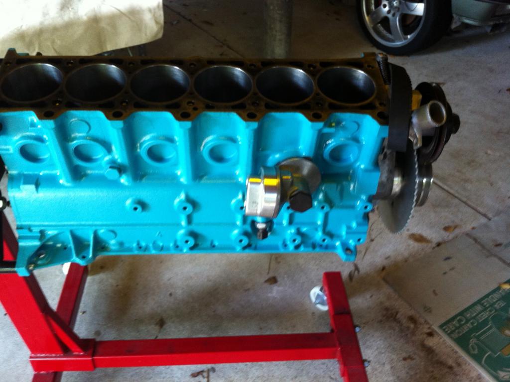

                Some Photos of the Engine........
                All surface rust removed before install. These parts were from Ireland Engineering and are fantastic. It should be noted though that some minor modification was required for the oil pan baffle. I'd also recommend test fitting a few times before using gasket adhesive and final install. I, and my lovely blue motor, got covered in the shit before I got a got method worked out. Then got covered all over again trying workout why it didn't fit first go! Oh well, lesson learnt. I also recommend using two gaskets although it is fiddly getting all the holes to line up.

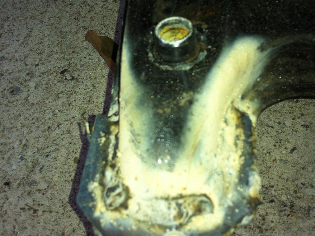

                            Once I had put aside the motor for now, I rearranged the area under my house, read "garage" and got my pride and joy out into the middle so I could get to work.
                            Up onto stands, wheels off and then tie rods disconnected, front sway bar disconnected, control arms removed, struts removed and finally, subframe out.
                            I had purchased a seal/rebuild kit for the power steering rack and took it to be rebuilt.
                            Now to see about re-enforcing the subframe.

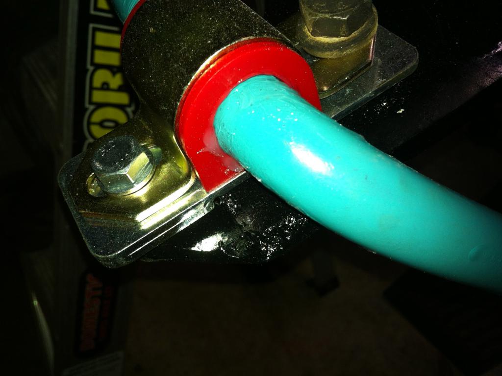

                              IE to the rescue, again. sourced swaybar reinforcing plated and HD swaybar brackets, and with the help of a good mate got to work.

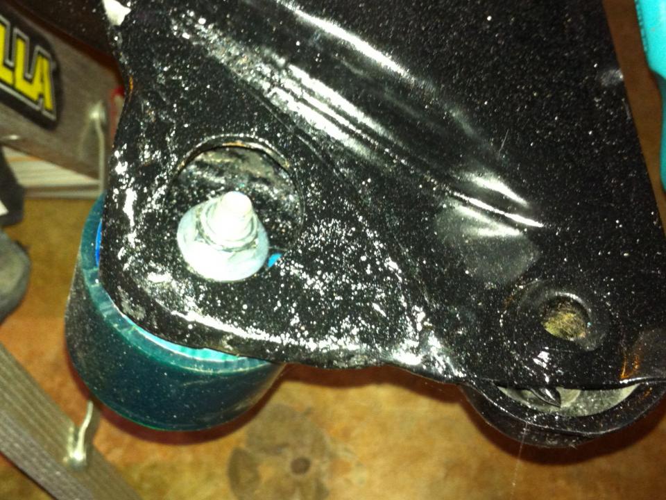

                              Also bought their motor mount reinforcing plates. These had to be modified slightly to get a good fit in the subframe itself, and then the holes provided for acces to the motor mount needed to be opened up a little with a die grinder to allow a socket in.
