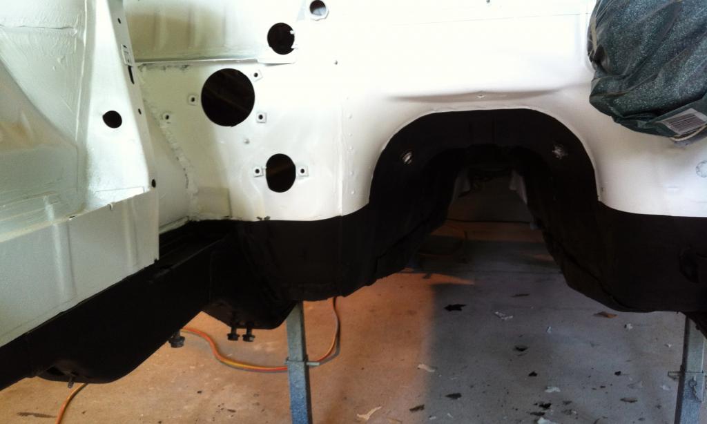

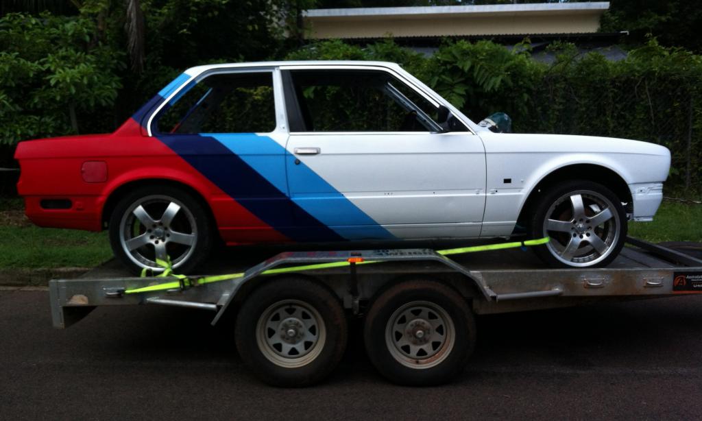

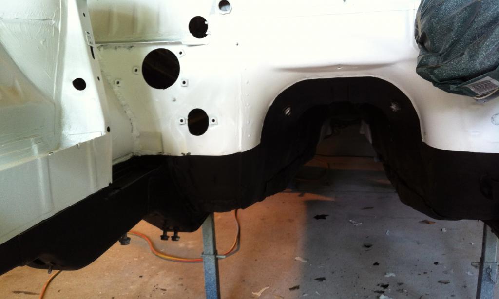

          So with the colour finally on, YAY, I could now start the business of putting things back together.
          I was on a pretty tight schedule as I wanted to get the car out to the welders to get my roll cage installed. I had had the cage professionally made for me, and sent up to Darwin. The cage still had to be notched and assembled and then welded into the car. This was the last bit of work I would need somebody else to do for me, and it was also preventing other work from being started. I couldn't finish painting the interior until the cage was in, fit/modify the dash, seats, wiring, etc.
          I had to pay some attention to the underside of the car as I didn't want to go through all that metalwork again. I got hold of some aerosol chassis black that had a rust inhibitor in it and went to town.

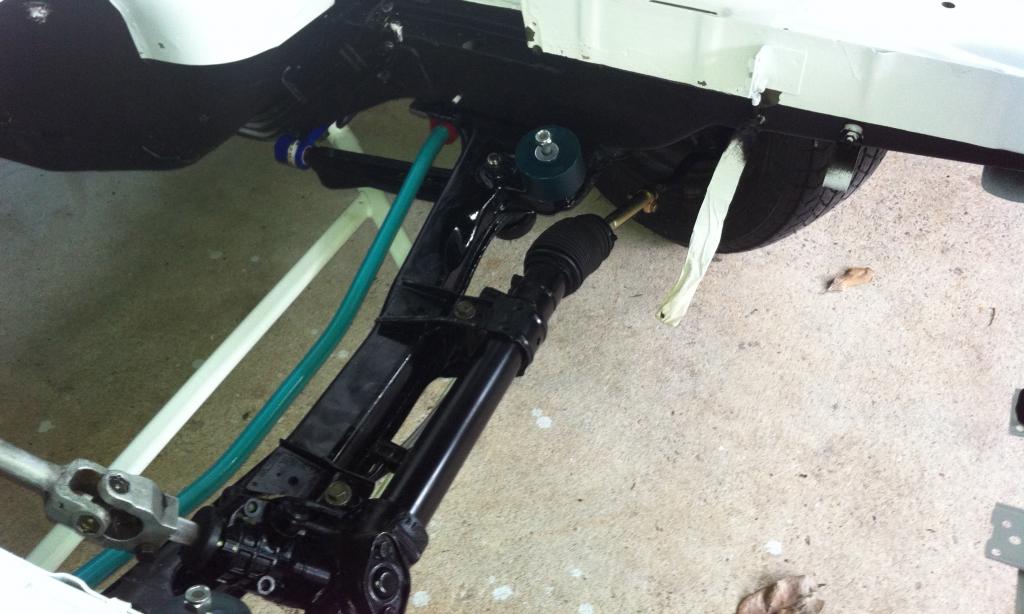

          Once this had dried I set about putting the steering and front end back together. Time to bust out some shiny new pieces :D

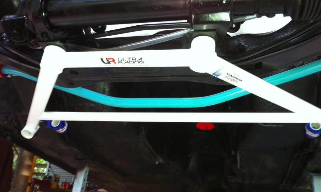

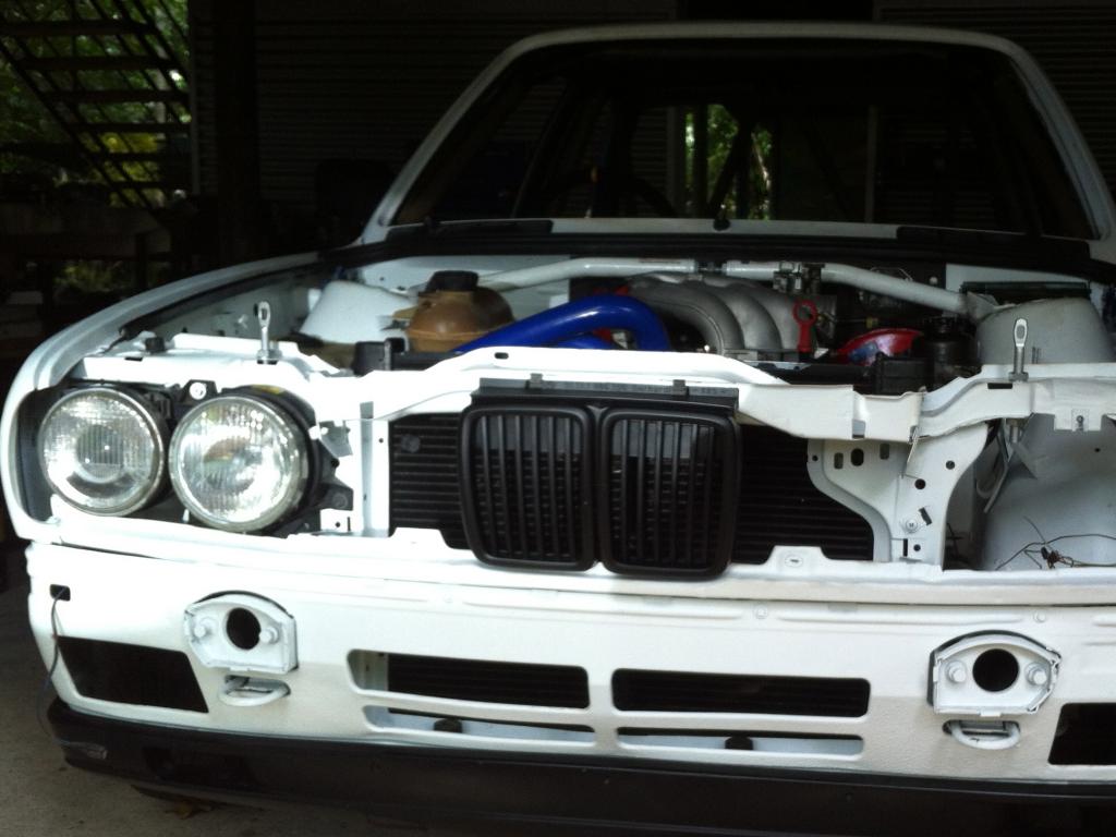

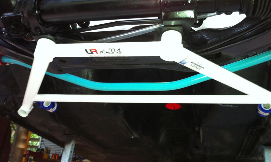

          I had tracked down some Hard Racing eccentric mounts for the wishbones, IE upgraded front swaybar mounts, Ultra Racing 4 point X-brace, brand new wishbones, and a fully refurbished steering rack.
          Back on its' wheels, and on the way to get a new cage put in. Stance is a little off, but there is no motor/trans/diff/etc.

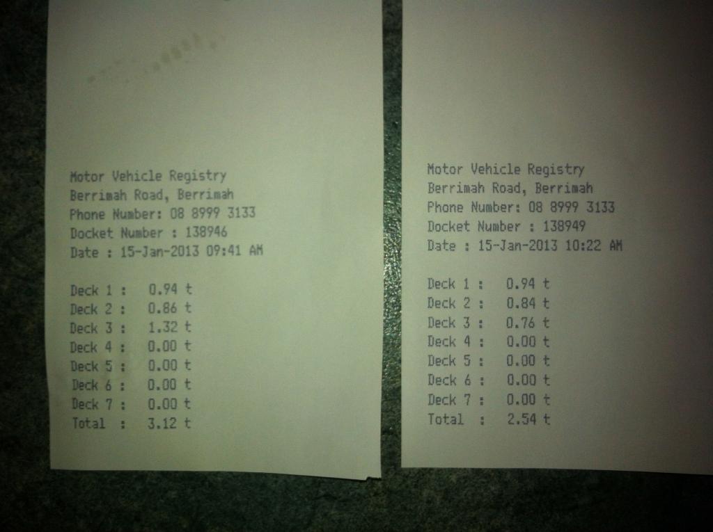

          On the way to dropping off I went over a weigh bridge. 3.12 metric tons on the way there, 2.54 on the way back. Whole car at this stage weighs approx 580kg!

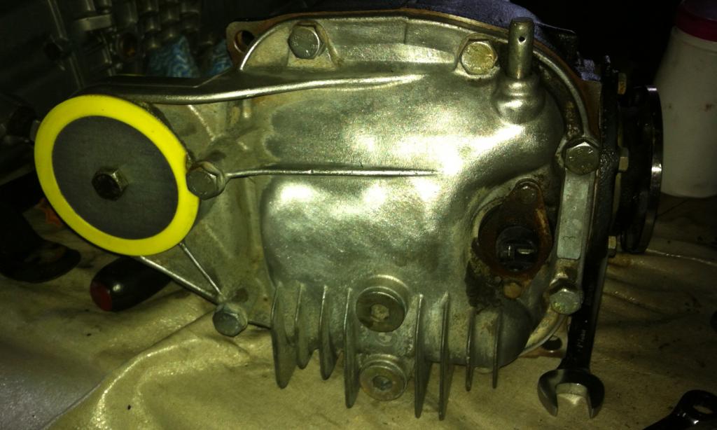

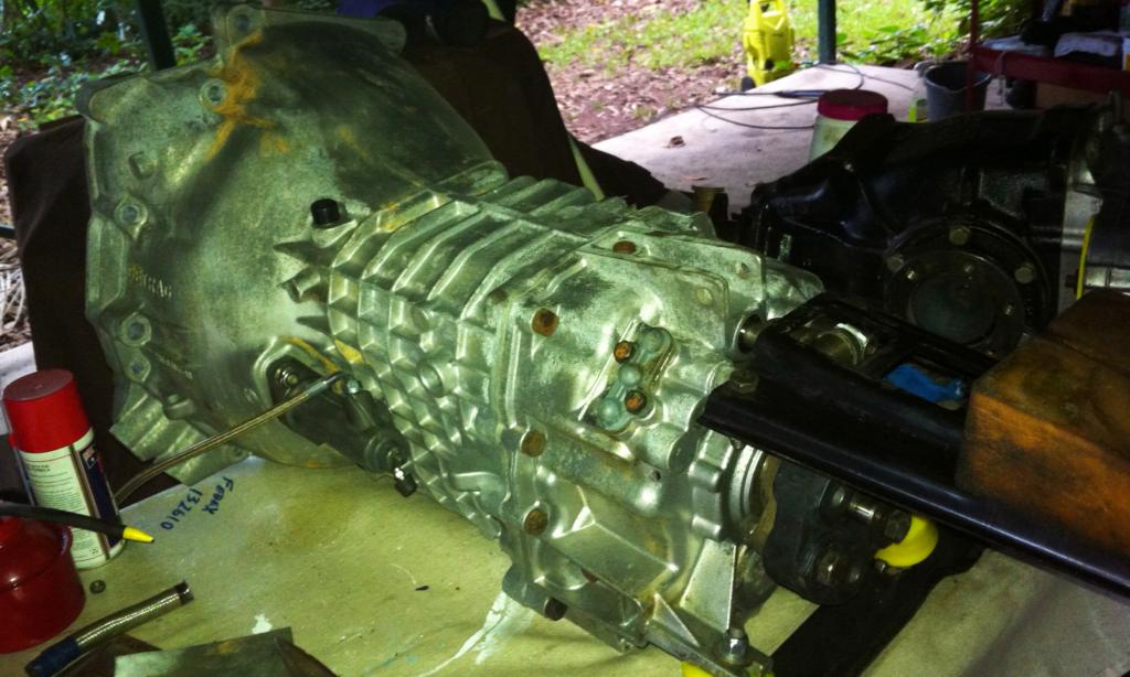

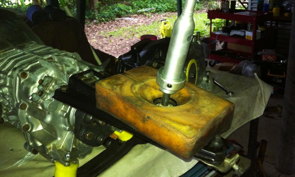

            Lots of jobs still to do while the roll cage is being assembled. Spent some time today cleaning and servicing both near box and diff. I also replaced the diff carrier bushing and gearbox mounts with PU.
            I gotta say, whoever designed the outside of the Getrag GB was a sadist.
            I took to it with a pressure cleaner, and no matter where I stood, or where I point the spray, I got cover in blowback.
            I ended up looking like a dalmation.
            I refurbished the gear linkage with all new bushes, o-rings. Spacers, retainers, stops and fitted an IE short shift. Replaced oils in both. Fitted a new clutch slave cylinder and a brass pivot button for the throw out bearing. All should be ready to handle the new stronger clutch when it goes in.
            Pics to follow.

                  Can't decide whether to keep the rubber/foam pad or not. If I keep it doesn't weigh much and will keep a little heat/noise out of the cabin. I will still be installing a rubber shift boot over the top anyway, so it's probably redundant?
                  • DREWHALL
                    • Feb 2006
                    • 1207
                    #39
                    All I have is the rubber boot then the factory boot in my street car. It doesn't let any more nosie in than the lack of sound insulation. I would just chuck it so it doesn't fail and jam up the shifter some how. Car is looking good so far! Are you planning on changing the wheels?
                    • Saascat1
                      • Jan 2013
                      • 60
                      #40
                      When the budget allows, yes. Although I'm undecided as to what to use. Baskets or something else. The wheels I have have the wrong offset, +40, not +25. I don't want to use spacers on a track car as that would put extra load on the wheel bearings :(
                      Thoughts?

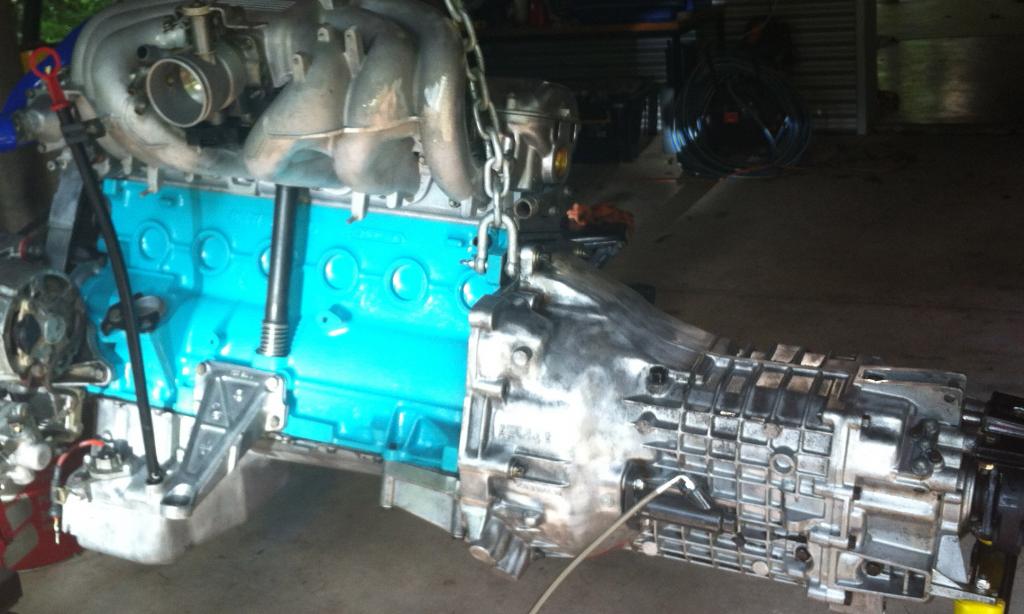

                        I went back and gave the GB and diff a bit more love. I was getting tired when I took those last photos and I thought I'd done a good job of cleaning. Wrong!
                        anywho
                        I am still waiting for the cage to be finished, rang up and was told they hadn't even started

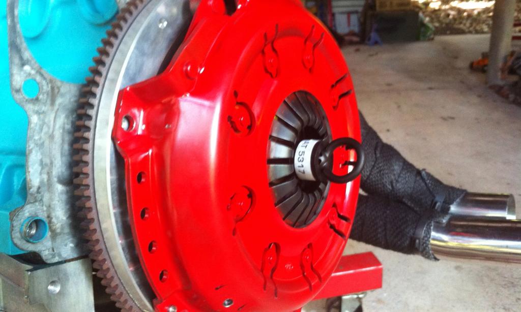

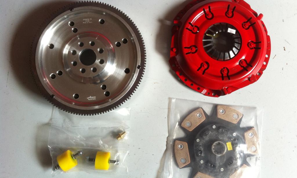

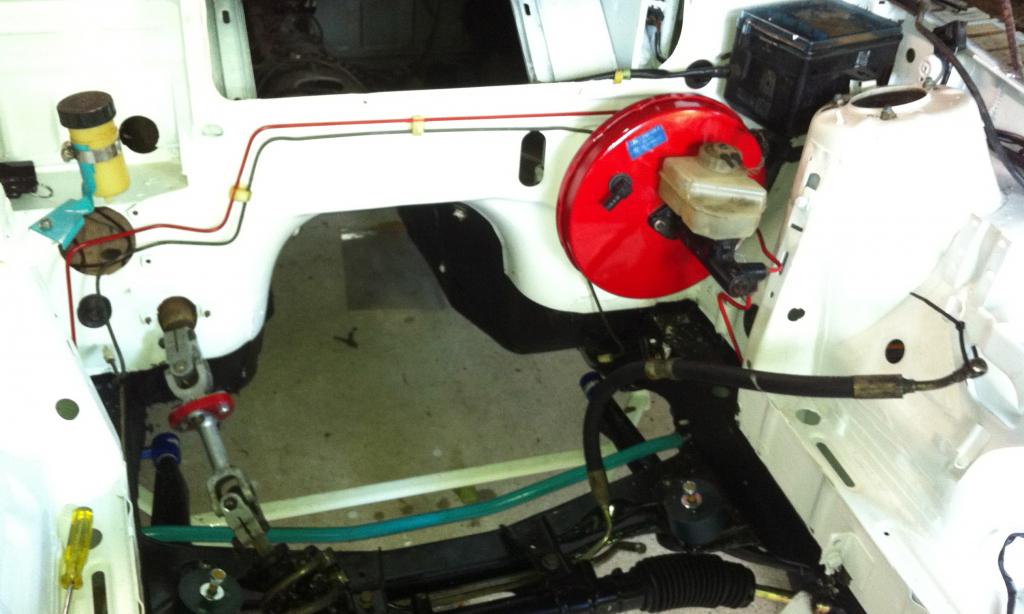

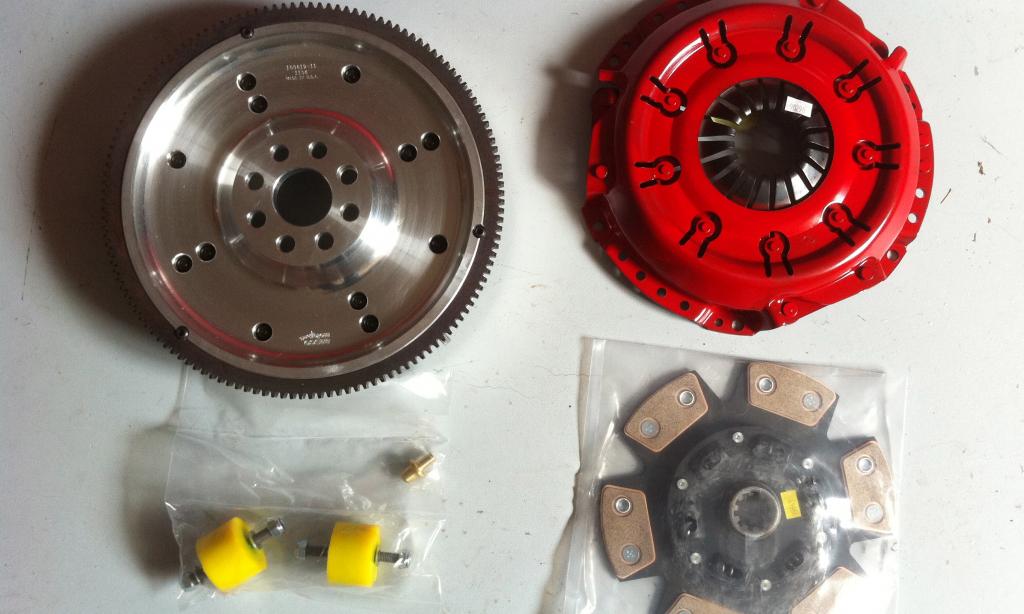

                        So I kept moving with other things. I rebuilt the pedal box with all new bushes, pedal springs and a clutch master cylinder. Cleaned up the PS pump and fitted to the engine. Replaced PS hoses from/to reservoir, sprayed the kidneys matt black, and put paint on a few other bits and pieces.

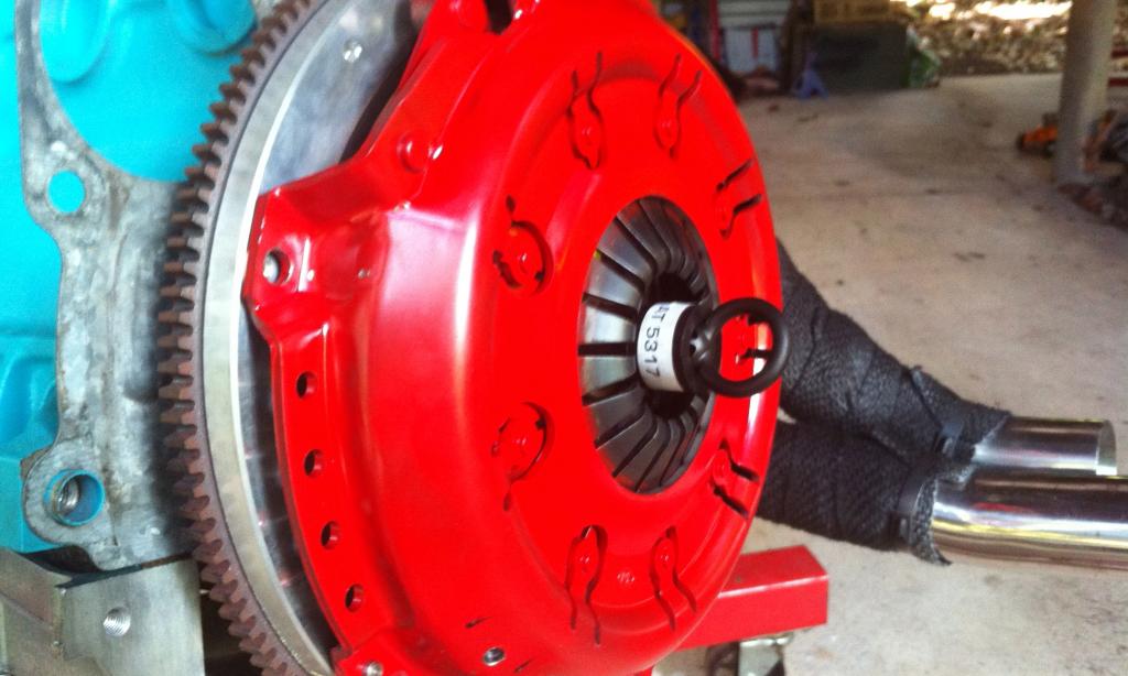

                        Next it was time to put the new Aasco aluminium flywheel and clutch on.
                        Mmmmm..............Shiny
                        And now
                        Snug and Meaty
                        All one piece.

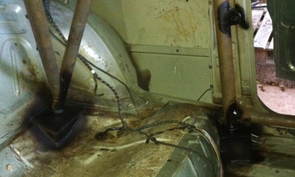

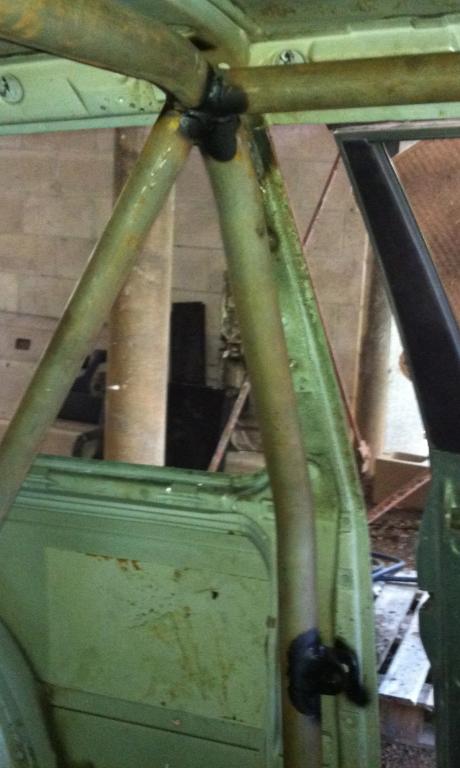

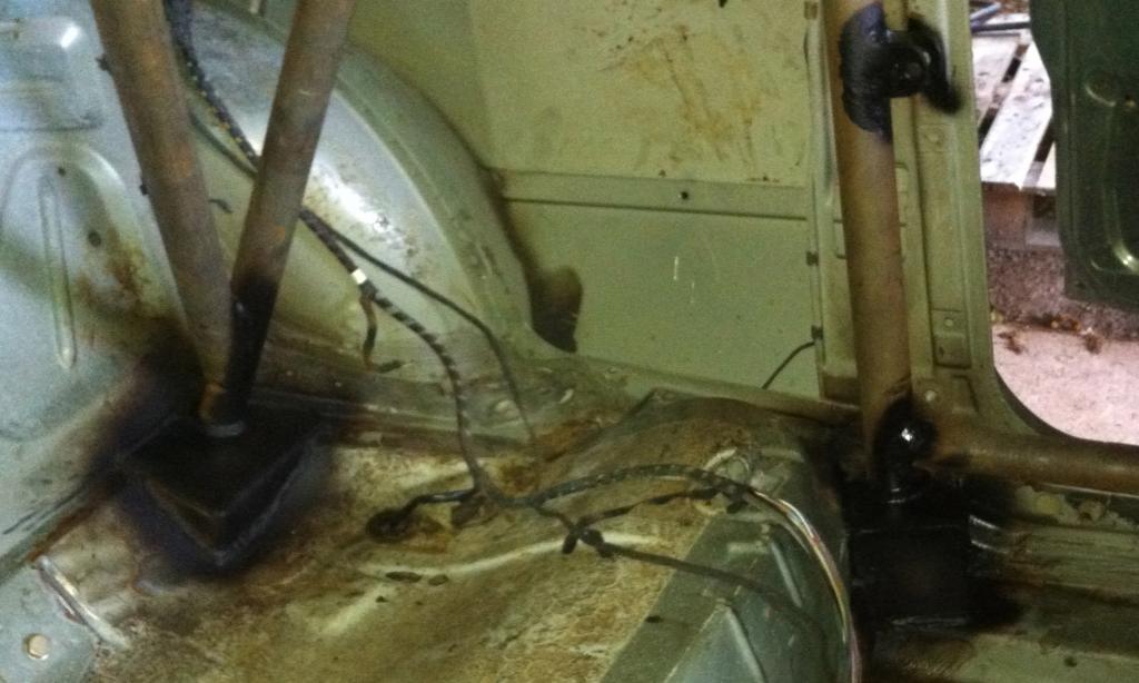

                          Finally got the my baby back from the cage people late friday, and lets just say i'm far from impressed. The front right quarter panel was missing, at the panel shop being repaired, the car was absolutely filthy, and the welding and grinding debris had been swept into the chassis rails...........Aaargh.
                          The cage I had was supplied to me from a renowned cage builder, and just needed to be notched and welded into place. I had a plan of the design and had spoken at length to the installation guy about my requirements and how to put it together.
                          When I got it back they had ignored pretty much all of it.
                          Notice the main hoop is obscuring the the holes for mounting seat belts and the rear quarter window.:x
                          They'd also sat the cage so far forward I would have been unable to put the dash back in. Door bars were a set length to allow this when mounted correctly. Main hoop should be mounted in the corner of the rear seat mount.
                          With the clock ticking away in my head, and not being able to do anything about the cage till Tuesday, (long weekend), I set about putting the engine bay back together.

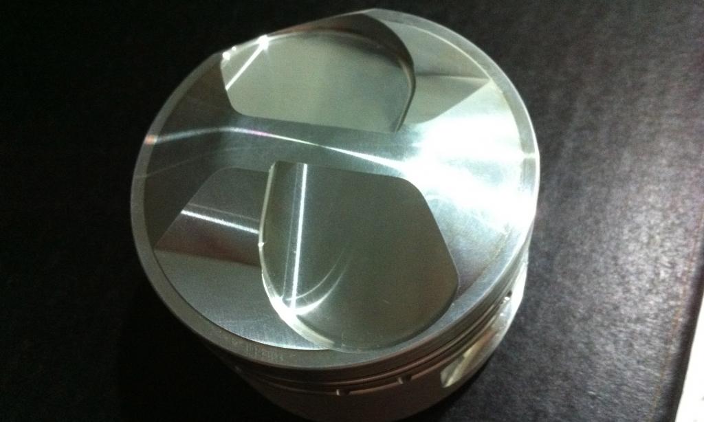

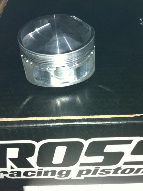

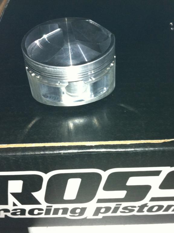

                            good to see the M20 is still getting attention........ive always wanted to do another build now that i am alot wiser that i was when i did my stroker........
                            Did you go +1 on both intake and exhaust valves ? How close do the two valves get to clashing together at Overlap with the 304? It has a lot of lift around TDC due to the narrow LSA and stout duration and this is something I see as a limitation of the head in terms of possible valve area. I think +2 overall i.e. +1 on both would be the safe limit but there are other permutations and combinations possible

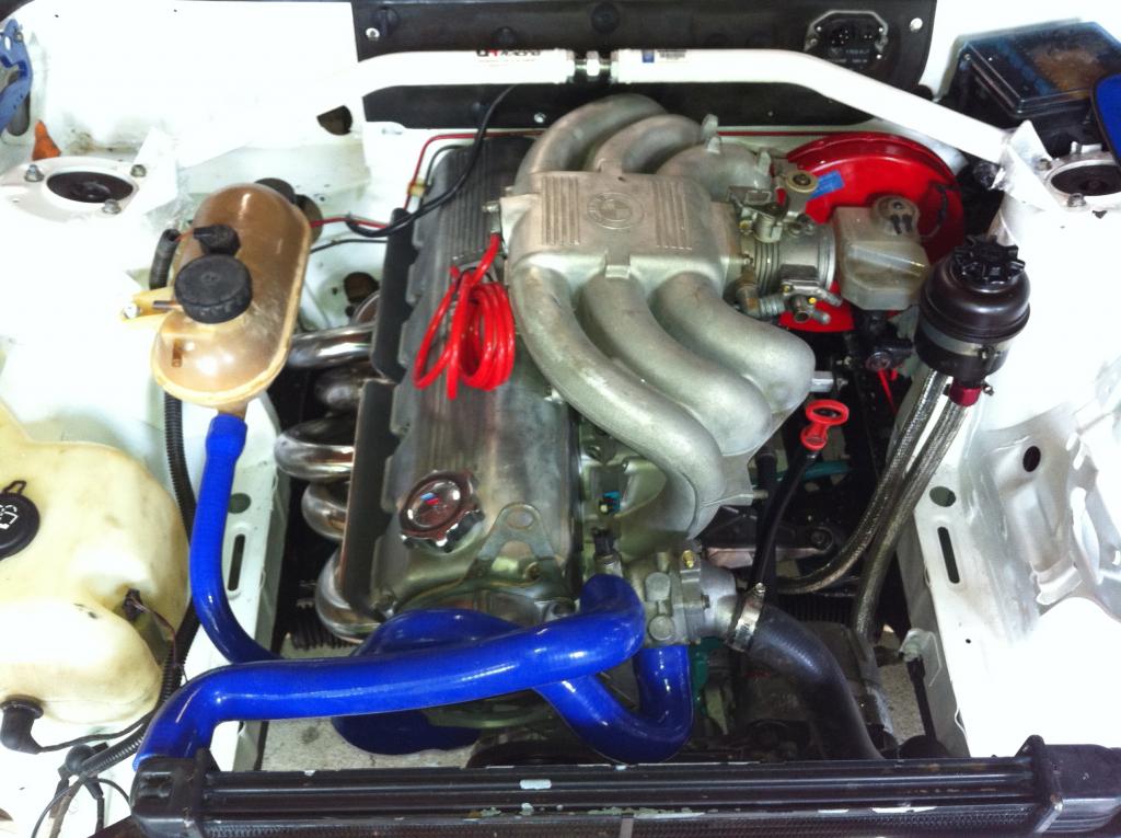

                                G'Day Digger,

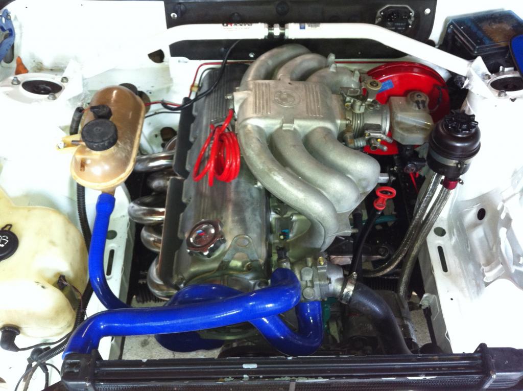

                                Yes I did go +1mm O/S on both Intake and Exhaust. The valves do get pretty close, but something would have to seriously bent for them to clash. I also did a multi angle grind on the valves so they sit V nice. I have an E34 with M20B25 and have been running a similar top end for a couple of years now, although the cam is 272/284, ( Miller W.A.R. chip and MAF, Custom CAI{Galeforce Performance}, custom long tube stainless headers). I got it ground from billet stock at Wades Cams in VIC. Goes like a train from 2900 onwards.
                                I am still a little way off from having this engine up and running, but I expect it should pull like a 14 y.o.
                                My thinking is that the torque developed by the stroke being over-square should make up for the cam not really kicking in till later in the rev range. The bore is also +1 so a little extra capacity should also help in this regard. The Stroker Kit from IE has Ross Racing Piston in it and I specified 10.5:1 Comp. The pistons look a bit weird, but at 290gm each they could look like Nicki Minajs' Butt for all I care!
