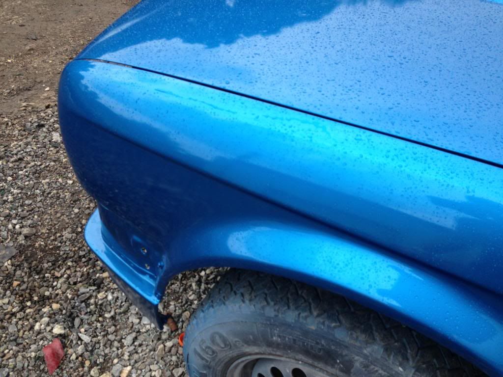

                            We have paint
                            Finally its painted. Not finished with the chipgard around the bottom but shes all blue!
                            Let me know what you think guys!
                            There isnt much orange peel, but my buddy is gonna cut and buff it this week to smooth everything out and make the paint pop. Im pretty pumped, though quite nervous on putting the entire thing back together.
