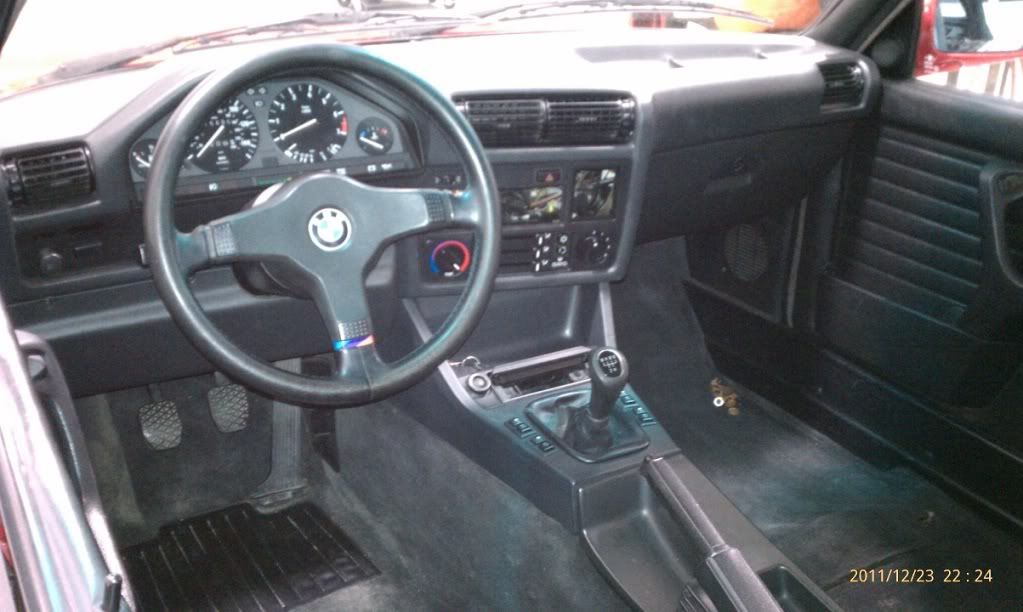

M-tech wheel and crack free dash from junk yard.
