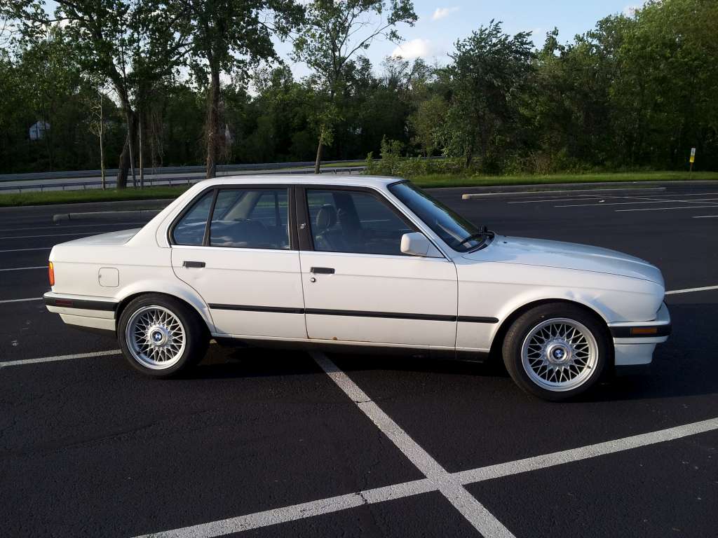

    As she sits now, wheel covers ftw

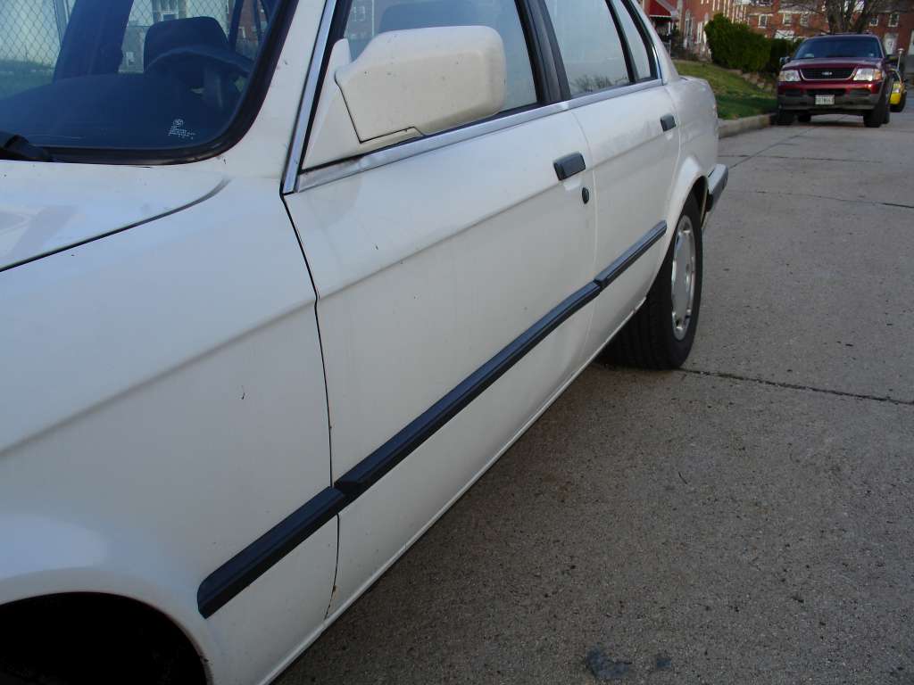

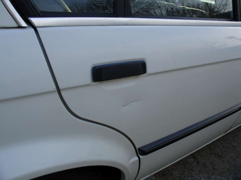

    Dented poorly painted drivers door

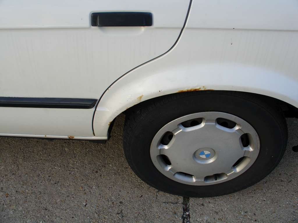

    Fender cancer

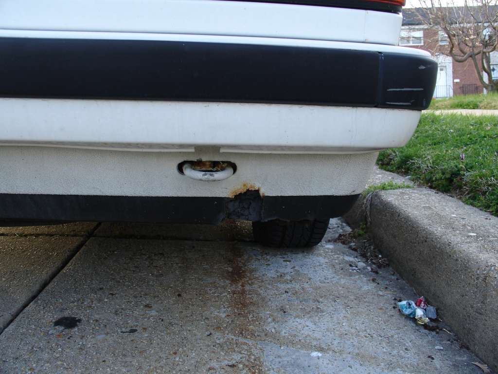

    Battery box cancer

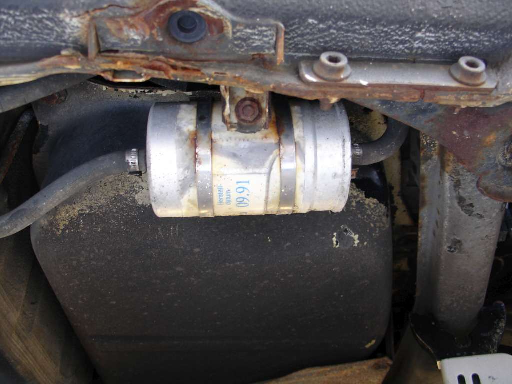

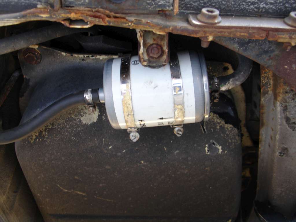

    My fuel pump has started making a lot of noise since it has gotten hot recently so I pulled it out to check it. It looks fine, the sock wan't clogged and it was replaced somewhat recently, so i figured I would replace the fuel filter to see if that would help.
    Said fuel filter
    Yeah, that's original :hitler:

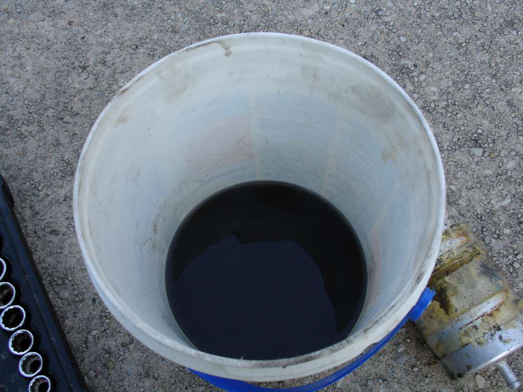

    I pulled it off, and this is what came out
    Replaced it and the small bit of fuel hose with new bits from GutenParts
    Much Better

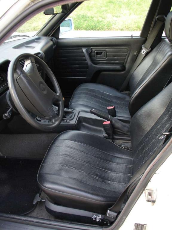

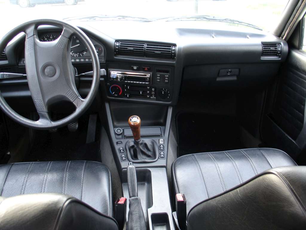

      The interior is in pretty great shape, dash has a few cracks and the carpet could use some cleaning.

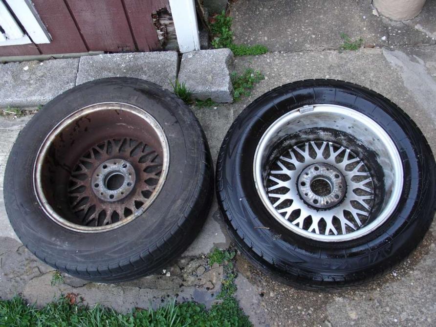

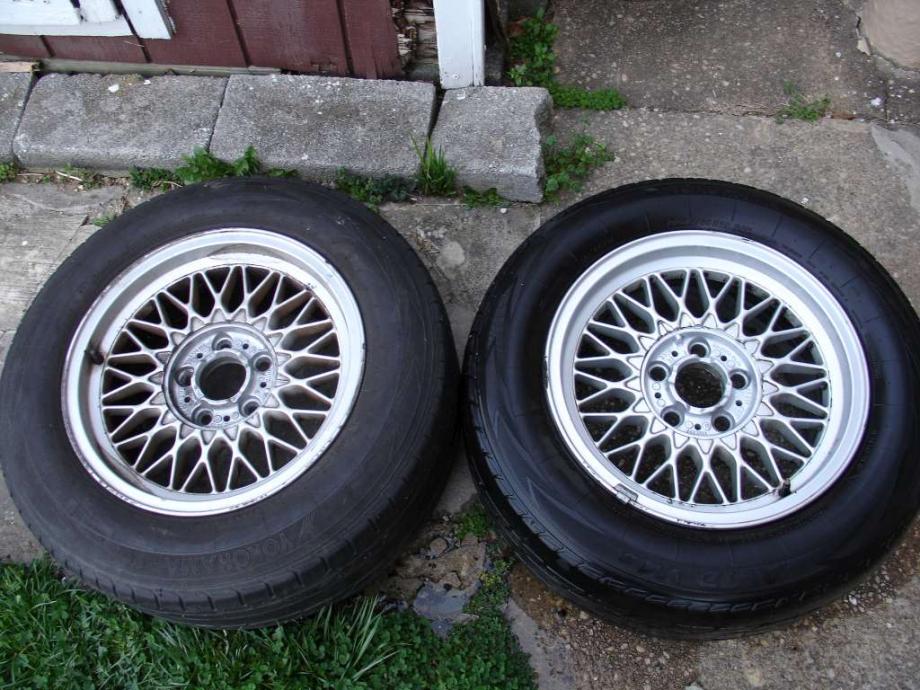

      The other project for the day. I worked on one of e38 style fives. I think I'm going to need to strip them and repaint. Dirty on the left cleanish on the right.
      Anyone need e38 tires?

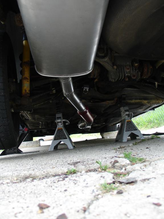

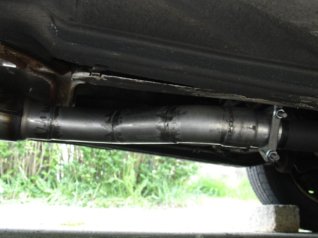

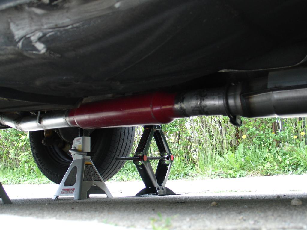

                            I decided to try and teach myself to weld by putting together the exhaust for my car. I picked up a cheap flux core MIG welder from Harbor Freight that actually is pretty well reviewed and some scrap metal to practice on. Then I headed down to Mandrel Bending Solutions, an exhaust shop a little south of Baltimore that has a true mandrel bending machine and sells parts. I picked up 2 J bends and some straight pipe and headed home. These guys are awesome and really know their stuff. I think most of they guys there drive VWs.
                            I got a high flow cat, cherry bomb type glasspack for tone control and a Dynomax Super Turbo Muffler. For the time being I just used a 2.25 to 2.5 adapter after the O2 sensor, but when the kit comes, I'll cut it off and run a flex pipe straight to the cat from the down pipe.
                            On to pictures! The welds look pretty shitty, but they are solid with good penetration.
                            Adapter to cat
                            The cells in the high flow cat look similar to the stock cat, but there are more of them. I think some high flow cats have larger cell sizes, this one was pretty cheap.
                            Cat to glasspack
                            Looking forward from the muffler
                            Quality Control, they are sticklers
                            I think it sounds pretty good, much deeper tone than stock. Maybe a little bit too loud for me, but not very drone-y on the highway. I'll be interested to hear how the turbo changes the sound. It's tucked up in there pretty tight, but it will be more solid when i get rid of the adapter and clamps.
                            Putting it together was a huge pain in the ass and by then end of the weekend I would have paid someone a ton of cash just to finish it, but I feel good about getting it done and now I can kind of weld. I'll probably hit it with some high temp paint to cut down on corrosion. Still not sure what to do for a tip, probably just leave the bare pipe.
