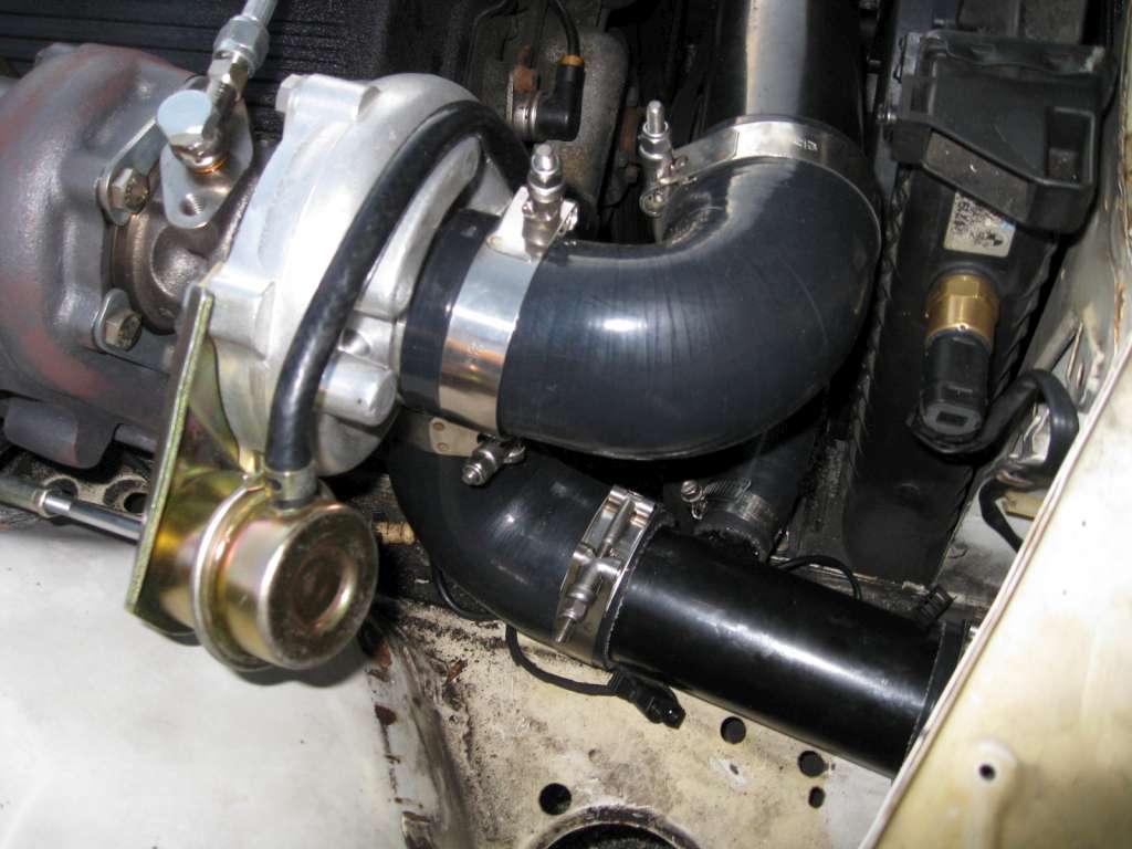

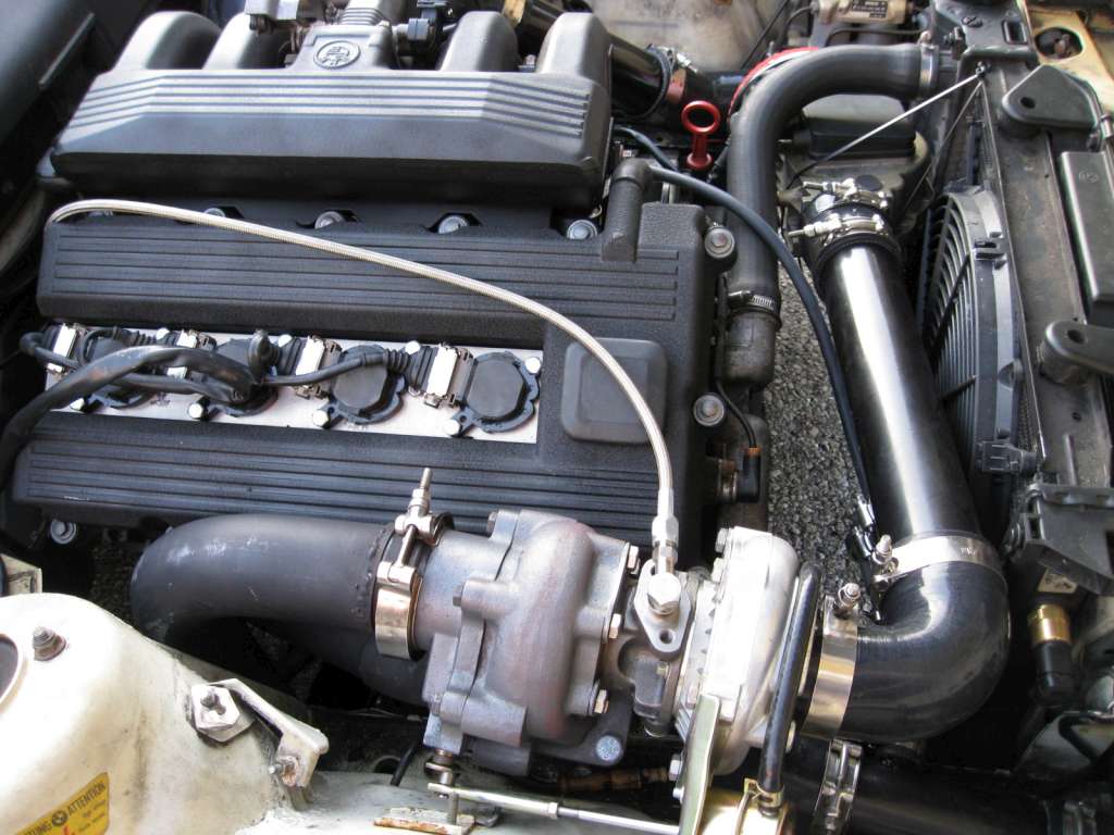

      Long time, no update. After a ton of frustration it's all on and I've got boost! Initial frustration was from trying to get the exhaust manifold off. Of course the nuts on the flange between the manifold and mid-pipe were completely rusted and took an hour to get off. Then the new manifold interfered with the AC compressor.

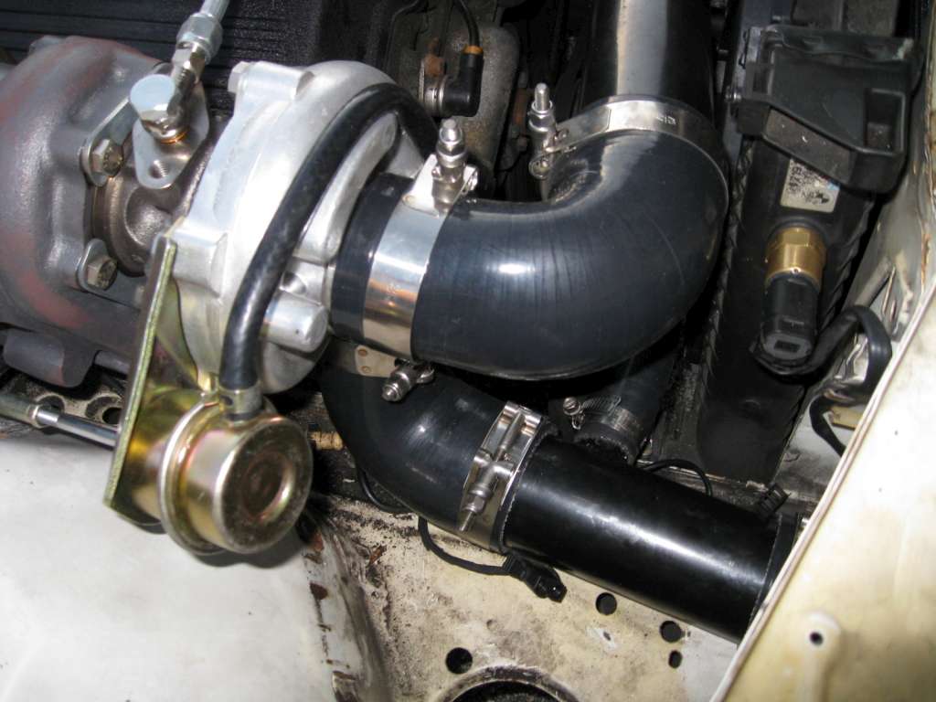

      The turbo clears the hard line coming down the wheel well, but you can't connect the lines to the compressor. My AC wasn't working, so i just pulled it all out.

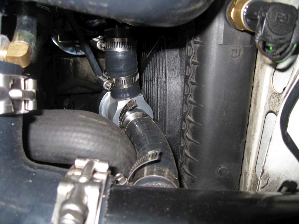

      Everything else went on pretty easily, but i had to shorten a few of the pipes and generally cram it in. The area around the turbo is obviously very tight. You have the compressor inlet and outlet, oil return, bypass valve, and radiator lines in very close proximity, so it takes some work to get it to fit.

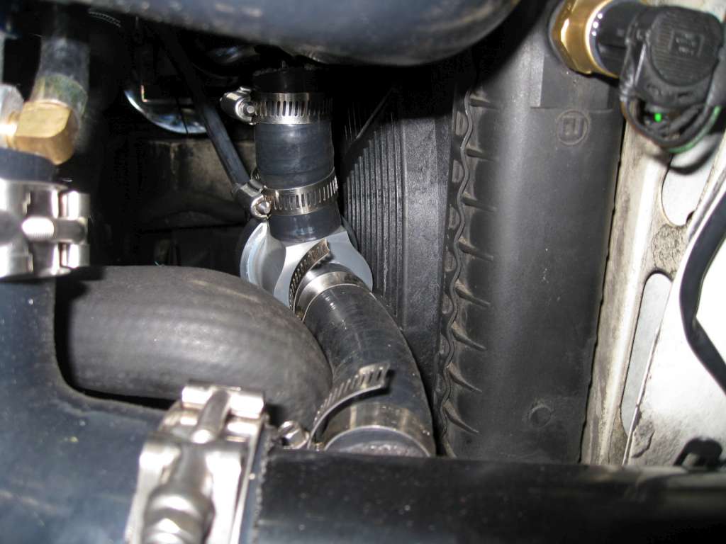

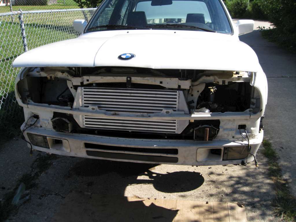

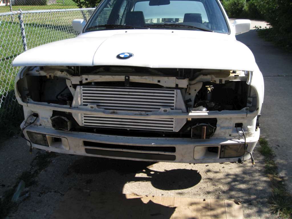

      I got them a few days later, installed it all and fired it right up! You have to trim the valence quite a bit to get the intercooler to fit. Here's what it looks like.

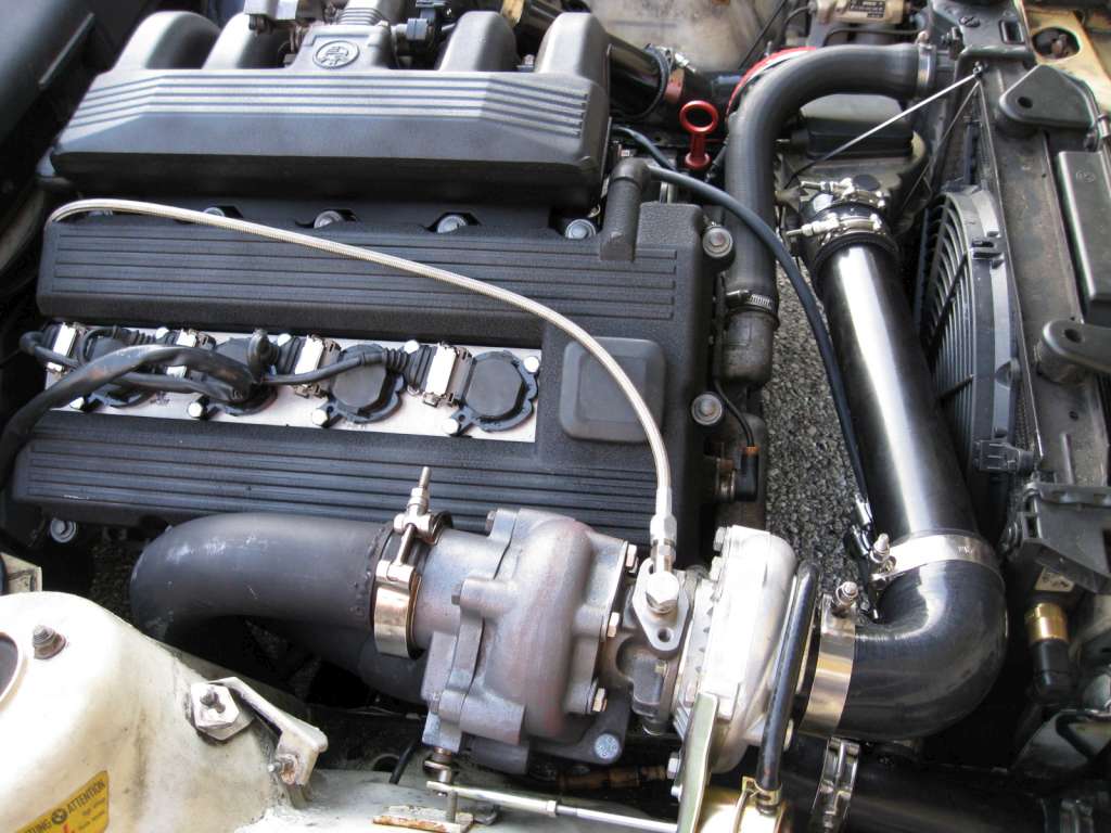

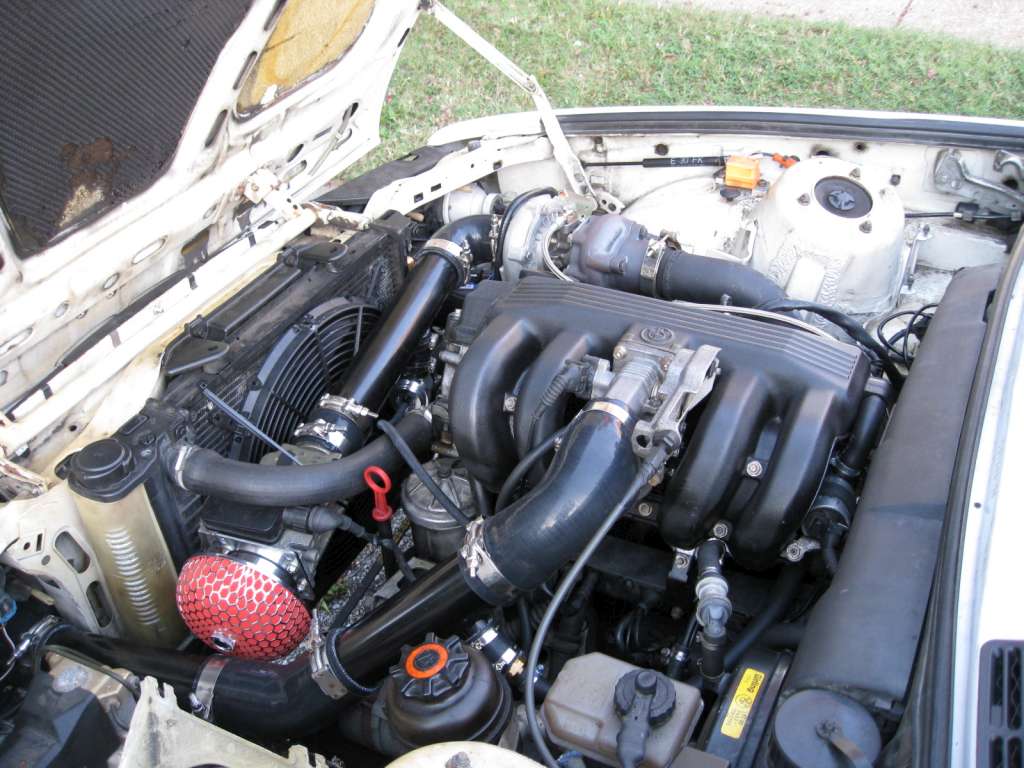

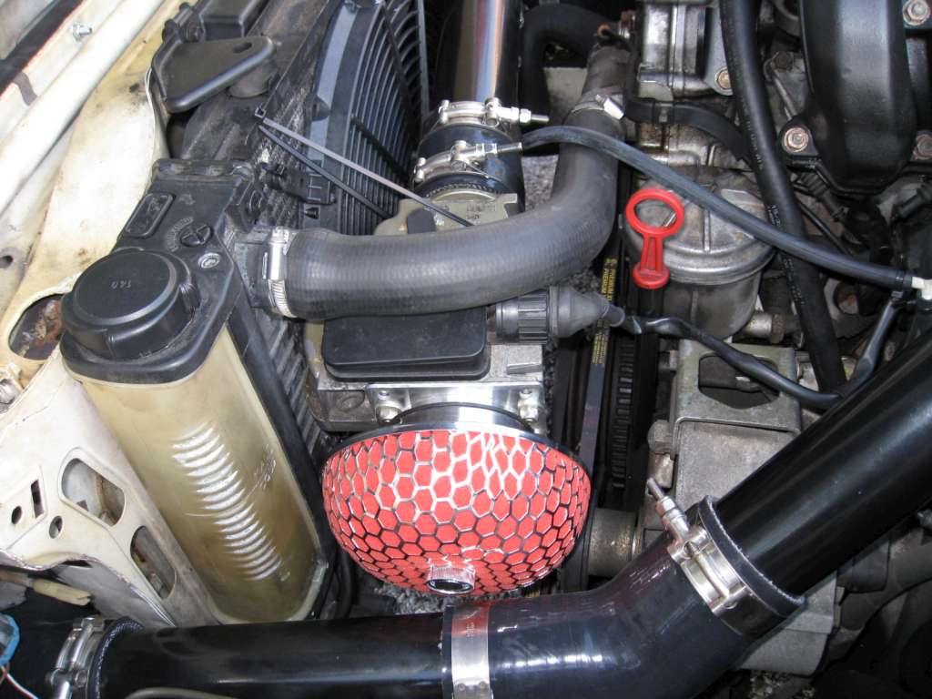

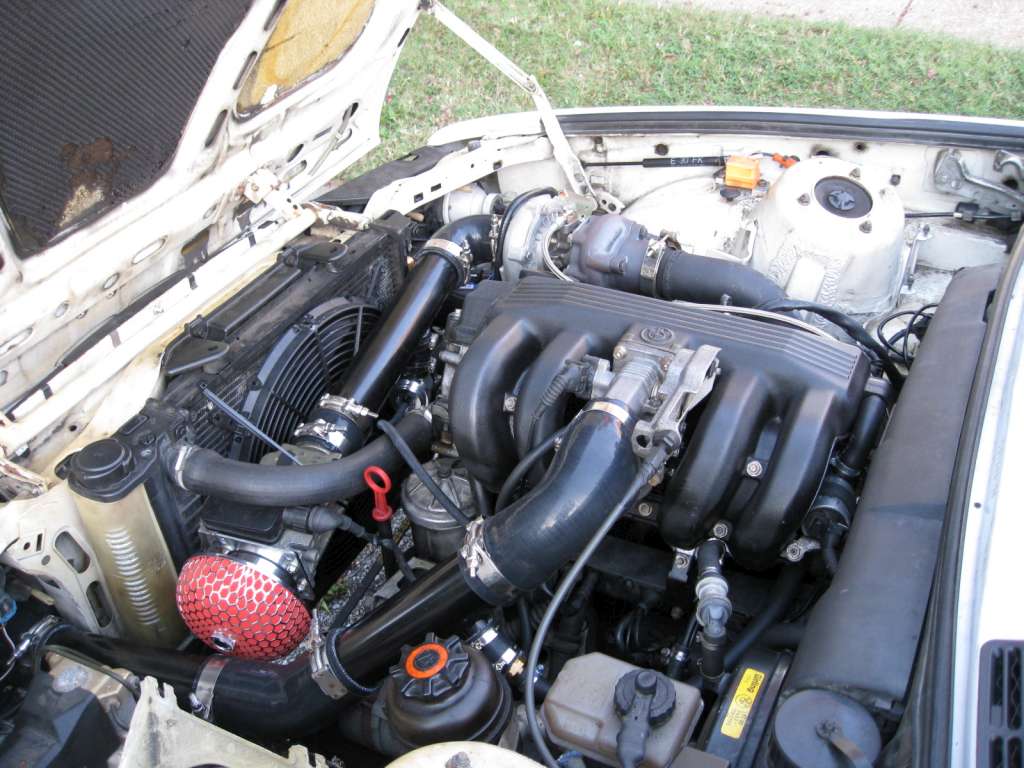

        Overview Pics

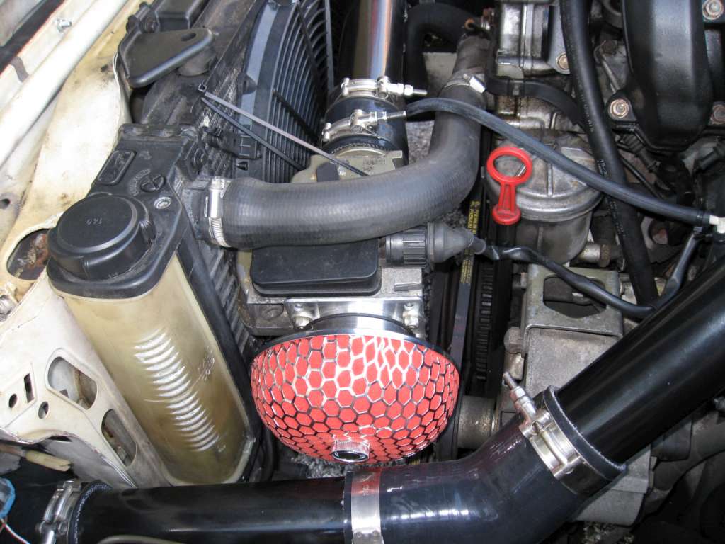

        You can see that there are a few more things to button up. I need to figure out some sort of bracket for the AFM/Filter. I did go ahead and plumb the valve cover breather to the intake tube, just before the turbo. I might add a catch can, depending on how much oil I get in the line.

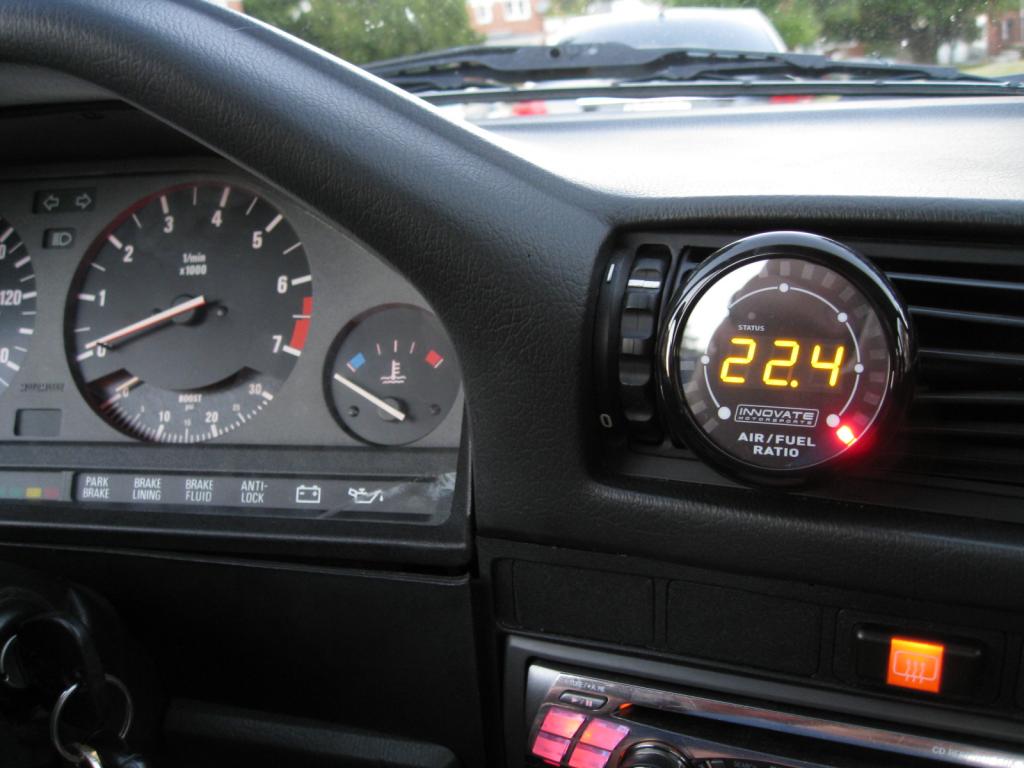

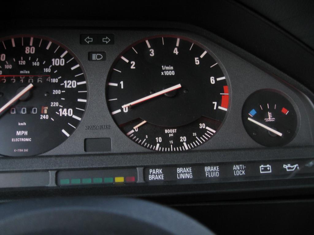

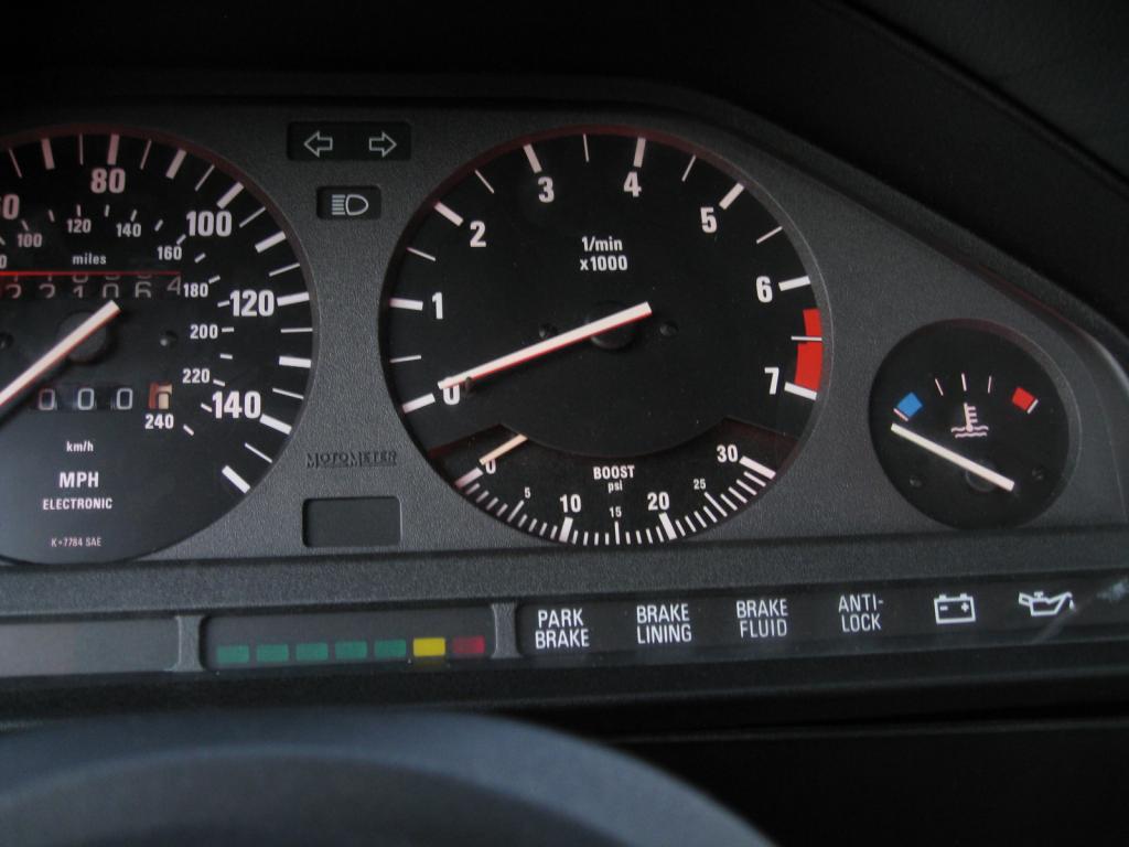

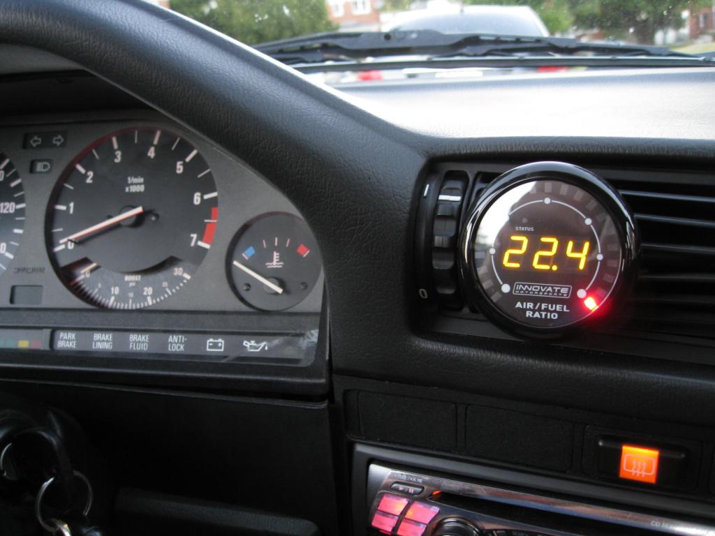

                                Got my gauges installed last week, really liking the setup.
                                Boost gauge replace the econometer in the cluster. 30 psi is complete overkill, but I got it cheap on the for sale board.
                                Wideband is the Innovate MTX-L. The installation is still pretty rough. I need to trim a little more out of the vent. AFR is really good, idle and cruise between 14 and 16:1 usually hovers right around 15:1. WOT is about 12:1. I was having some hesitation during partial throttle acceleration, so after checking for vacuum leaks I checked the TPS and AFM. TPS looked good, but the resistance on the AFM jumped around a bit.
                                I cracked it open and tried to adjust the sweeper arm because there were some pretty good grooves in the track, but couldn't get it to budge, so i jut cleaned it up with isopropyl alcohol. Just doing that really smoothed out the throttle response, and the AFRs jump around less.
