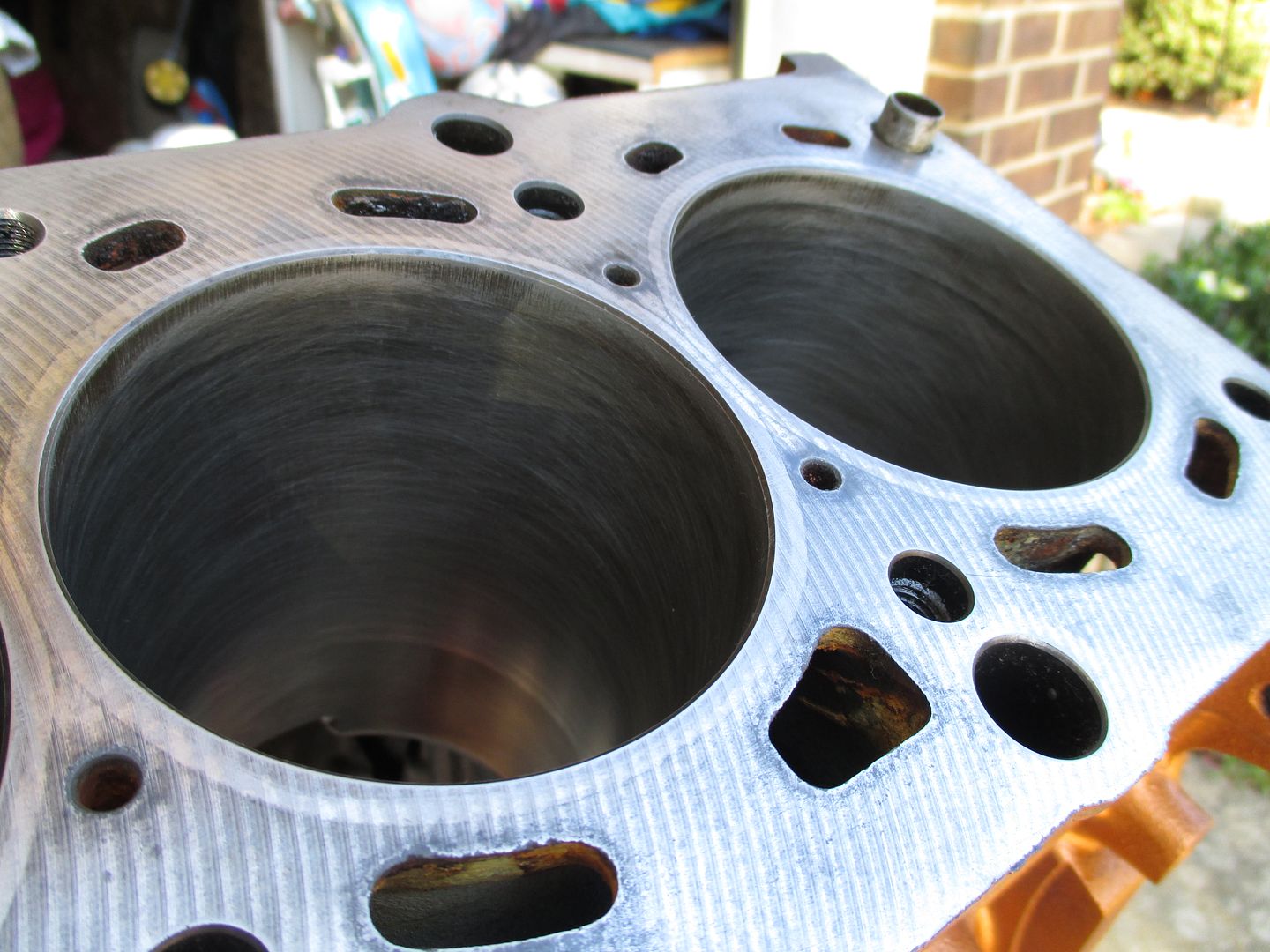

    Now that I have the engine apart, I decided to clean it myself rather than throw away money at a machine shop. Most shops these days use a "steam cleaner" dishwasher anyhow rather than a hot bath, so I figure with some elbow grease this can be done.
    Note that I plan to hone the piston bores later this week (after which I will do some more cleaning).
    One of the advantages to having a little 4-cyl: the block fits nicely in a utility sink in the garage, giving me direct hot water access and drainage. Before I put it in I coated the cylinder bores with some WD-40 to keep flash rush away (and it worked), and since I have an extendable faucet (my old kitchen faucet, lol), I was able to basically keep water out of the cylinder bores for the most part anyhow.
    So first I put the engine in and (both sides) sprayed it down with oven cleaner and let it soak.
    Then I used a brass brush and some brillow to scrub it good and clean. Then degreased it afterwards just for good measure. Seems like it's pretty good and I need to get some engine paint and do the outsides of the block now.
    Then I went to work on all the polished gasket surfaces (head gasket, oil pan gasket, timing case, etc). After I cleaned it as well as possible I block-sanded with 1000-grit wet-or-dry (slightly wet). This got the last remnants of gunk off of it and left me with a very nice and smooth surface. I can't feel any imperfections on any of the surfaces now, so should mate up nicely with the gaskets.
    outer cylinder bores have some rust, but not as bad as the camera makes it look.

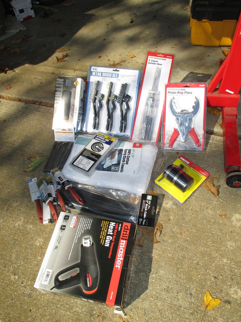

      First, a morning run to Harbor Freight, the greatest place on earth. Went to find a piston ring compressor, ended up buying a ton of other stuff as well, of course. And still paid $75 for all of it :)

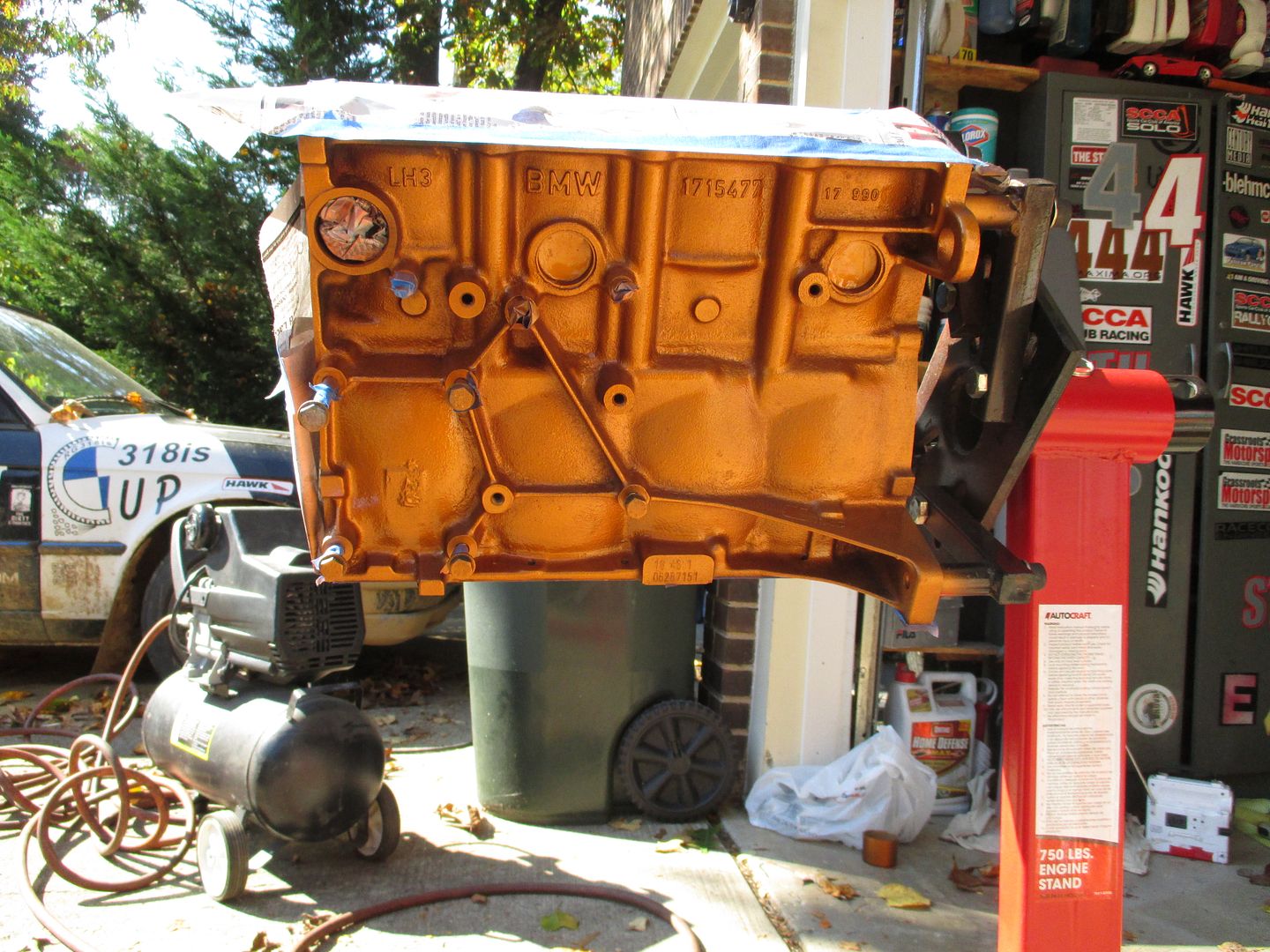

      Finished cleaning the block, and did some painting. Might as well make it pretty. The copper will look good in the Nachtblau engine bay I think...
      Also finished cleaning up the block deck, and did a light hone of the cylinders.

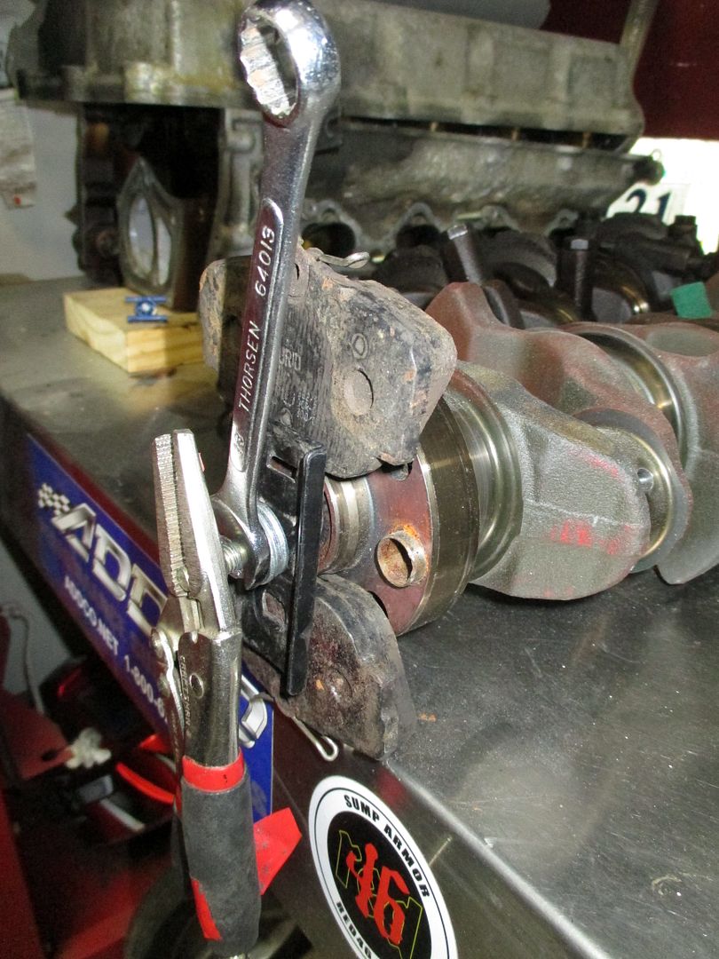

      and wanted to pull the pilot bearing, so fabbed up an awesome tool built of a bolt, nut, random roof rack clip, and two brake pads :)
