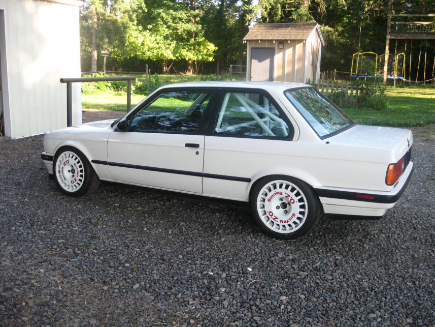

    Since my car keeps blowing up, I figured the project forum might be better than members rides , lol. This is my alpine track rat that hasn't made it to the track yet, and summer is gona be over soon!
    I melted a piston and killed my turbinetics t3/4, wasted the block when that happened. So I thought I'd post some pics of the current state and progress. The turbinetics was to much to fix so I picked up a new HX35. It's the turbo I wanted in the first place anyways. Also bought a m20 from a guy close to me with 91,000 miles, wich is about 100,000 miles less than my last one had. So I cleaned it up and am about to stick it in the bay. Just gota drill and tap my block for the return. This is the last m20 ill be using. They are just to hard to find, and to much money. I thought m20's would be like disposable, and easy to replace every time I blow one up, not really the case anymore. Dang.

      wheel, tire, suspension specs?

                God dam. That will be a beast.
                Also love the wheels what are those ones called I would love to source a set for my self.
                        Wheels are O.Z. Monte Carlo competition race wheel all magnesium, group A WRC Tarmac wheel. 17x8.5 235/40, found them in a back yard. Long story.

                              Did you have to roll your fenders pretty hard to fit 245's squared?
