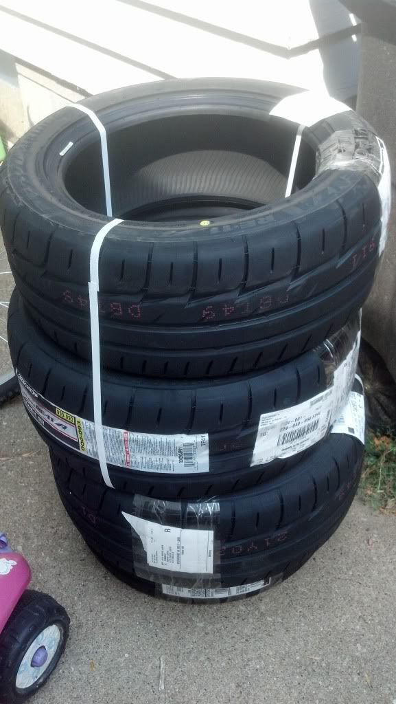

    Yesterday I ordered some bridgestone Potenza RE-11a tire for it, they showed up today and they should be installed tomorrow along with getting an alignment! I can't wait to drive this car with the new tires!!

                    Car is now aligned and new tires installed, drives like a dream! Next project is the brakes, after that I feel the car will be well enough to start in on the exterior and interior a bit.
