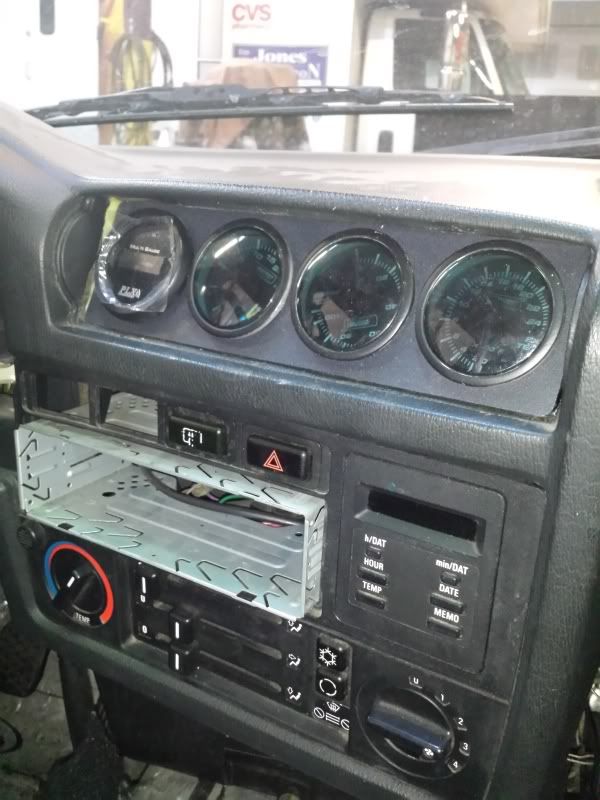

                      yesterday i did more buttoning up. The final details are always the most frustrating. Honestly its all the stuff ive been putting off because it sucks.
                      I started a little late because I have a buyer for my bbs rs and I needed to take the tires off. I havent done stretched tires before, only watched. They were a pain in the ass! Each wheel I had to flip the wheel on the machine like 3 times because the bottom bead breaker wasnt strong enough and was lifting the whole wheel. Anyways, selling them will get me out of alot the the debt I have accumulated with this project. Feels good paying off debt. Also, one of the 4 people at work is leaving so Ill have alot more work and responsibility, maybe more money and a chance to show what im made of .
                      Anyways, did all the gauge wiring. I am just stealing power from the window switches. I got everything wired just to find out that I have old prosport gauges that they don't make wiring harnesses for anymore. I called them and they happened to have used connectors that they sent me for almost free. Ill have to repin the ends but i dont think that will be too hard. Now theres a ton of wiring that will sit in my glovebox.

                                got it running. its missing alot and im double checking my wiring. I think its a grounding issue as Im using a shield where a ground should be. Basically when the ecu is on, one of the grounds is at +3v so its throwing everything off. Once this is sorted out I have a few things to tidy up and it should be ready to go on the dyno.
                                The gauges are wired now, it took FOREVER. Had to cut all the wires at the pigtail and sodered in all new wires. They all work and match the dash when the lights are on. Since they are getting power from the window switches, I can turn them all off via the circuit braker.
                                I have been thinking. I will be tuning this car to 17-18 psi and try to get max power, but i don't think I will really run that much power, even though I won't be dailying it, 10-12 psi (should be well over 300whp) is really alot in an e30. I know the m52 should be able to handle 500hp, but for how long? We have a car at work running 750 wheel with 315's out back and the car is really just a death trap, even with abs and traction control. I also will need to get used to the car in track events, and as an unexperienced track driver, I need to be able to drive the car within my limits. With that being said, some kind of electronic boost controller will be installed later (or through the ecu) so i can switch on the go.
                                did a compression test just to make sure everything was good and the motor is healthy. videos will come soon!
