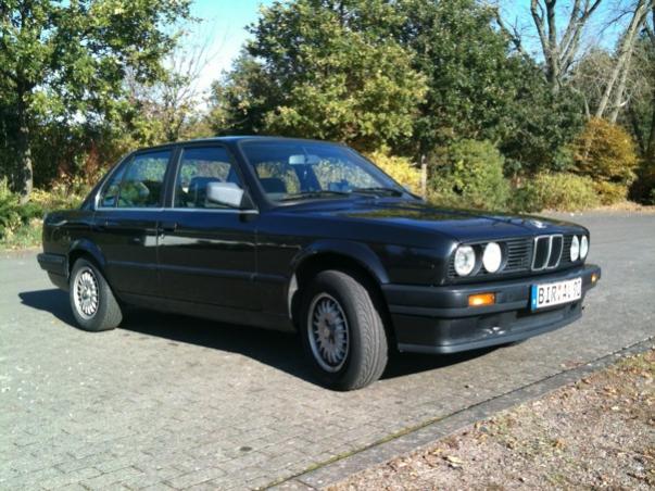

    So, some history, I took a almost 4 year break away from the BMW scene, In 2009 I bought a euro 316i E30, when I was in Germany with my ex-wife, and fell in love with E30's. My ex wife didn't understand that if a car has a temp gauge, it probably isn't going to have a dummy light. Needless to say, she overheated it, and popped the head gasket. I did a motor swap, and not long after that, ex wife made me sell it. Then about 2 years later, divorce, and sent back to the states.

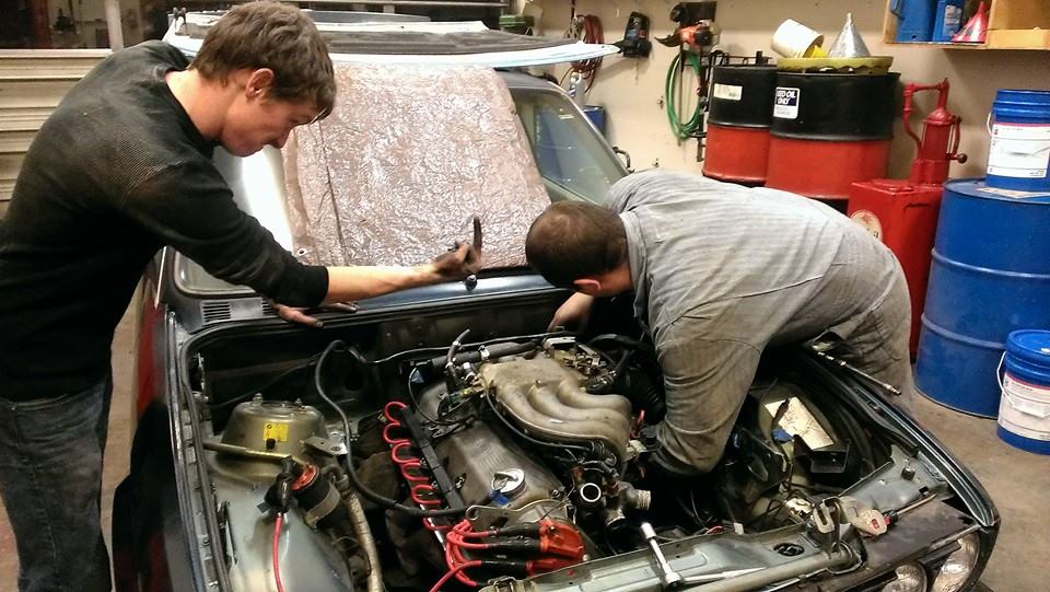

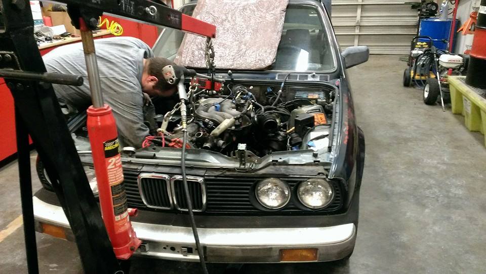

              Long time no update. Seta+Eta fuel system is in the car, and running well now, I have a hesitation between 2k and 3k, but it's driving. Some pictures of the install are attached.
              Today, I installed new lower front suspension arms. I needed both inner and outer ball joints on both sides of the front. so rather than fighting with pressing old ones out and putting new ones in, I just replaced the whole arms. I also replaced the bushings in my lollipops. Eventually, I am going to go with the treehouse ones. but for now, new oem ones make a difference.
              also, on the motor front, I have lined up a 1991 525i to use as a donor car for a M50 swap. it's got a M50nv, and a ZF trans, Not sure which one though, Fairly low miles, around 150k. I'm going to drive the donor car before pulling the trigger, but I think this is where I am going M50.....
