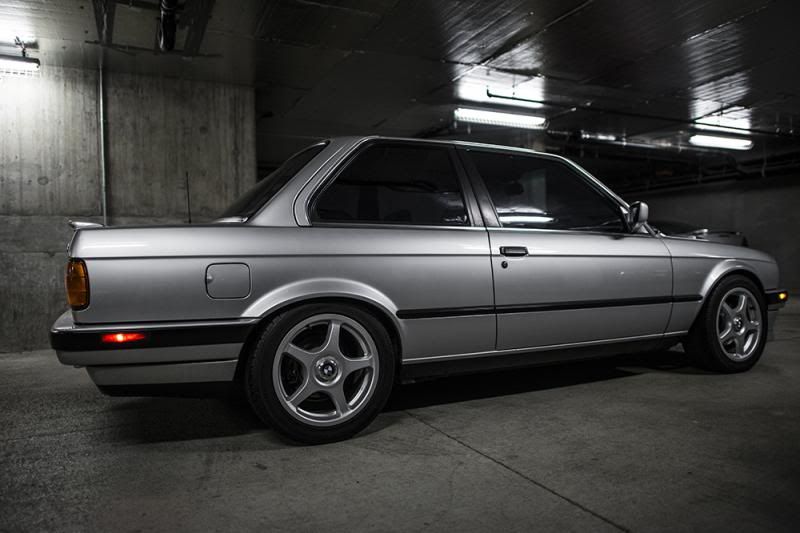

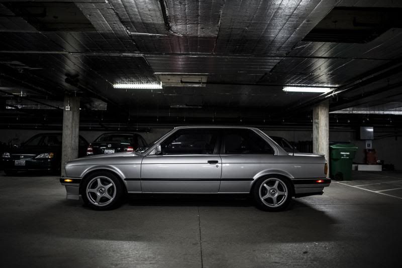

    So I bought this car about a year ago, and have been largely in the shadows on there until I got it to where I wanted my baseline to be for the project build.
    1990 325is
    here is the link to a full res image. (photobucket butchered it, along with the whole album) http://i.imgur.com/dNd6ihF.jpg
    here is a photo album of the car as it sits now:
    Discover the magic of the internet at Imgur, a community powered entertainment destination. Lift your spirits with funny jokes, trending memes, entertaining gifs, inspiring stories, viral videos, and so much more from users.
    Updated Mods Installed:
    New UUC EVO3 SSK w/DSSR and Delrin carrier bushings
    BavAuto clutch kit
    BavAuto springs
    Bilstein Sport shocks
    New Guibo and CSB
    Converted to 75MM wheel studs/nuts (from Apex)
    16" ASA JS1 Wheels
    New OEM Front Rotors w/Hawk HPS pads and rebuilt calipers
    New Rear drilled Zimmerman rotors w/Hawk HPS pads and rebuilt calipers
    Ireland Engineering Exhaust
    New BMW IS front lip w/fresh paint
    New BMW IS trunk lip spoiler with fresh paint
    Ti/E36 antenna
    Euro grilles
    Abraham’s smoked turn signal lenses
    New Mtech II steering wheel
    New ZHP shift knob
    New Mishimoto E36 Aluminum Radiator
    Wrinkle finish painted valve cover (black) with sanded BMW logo
    New Bilstein E30 M3 CAB/Lollipops
    Houndstooth Door Cards
    Black Leather Sport Interior
    Hartge Front Strut Bar
    New UUC stainless/teflon front brake lines
    Tinted Windows
    4.10 limited slip
    Viper Alarm
    Condor Speed Motor Mounts
    Condor Speed Transmission Mounts
    Bosch Euro Smiley's
    Megasquirt II (whodwho)
    Maintenance:
    Rockers re-sprayed black
    4 new head light bulbs w/fresh black painted trim rings
    Fresh flush/fill of ATE Super Blue (including clutch)
    New front passenger wheel hub & bearings
    New Continental timing belt & tensioner
    New Graf Water Pump
    New Behr 80C Thermostat
    Coolant flush & fill with BMW coolant, distilled water & Redline Water Wetter
    All new coolant/water hoses
    New Fan Clutch
    New Coolant Temp Sensor
    New Continental accessory belts
    Oil/Filter change
    Valve adjustment
    New valve cover gasket & rubber end plugs
    New distributor cap & rotor
    New air filter
    New fuel filter
    New spark plugs
    New OEM front cowl (lower windshield) plastic vent covers
    New wiper blades
    New front and rear Roundels
    New Pilkington windshield
    New Boston SE50 5 1/4" component speakers front & rear
    Alpine 9874 CD head unit

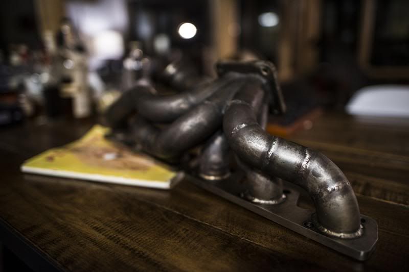

    Im building a new head, welding the water jackets, installing IE HD rockers.
    Once the machine shop is done with that, I will O-ring my block with an OEM head gasket and swap the new head over.
    I also have this RevShift Manifold:

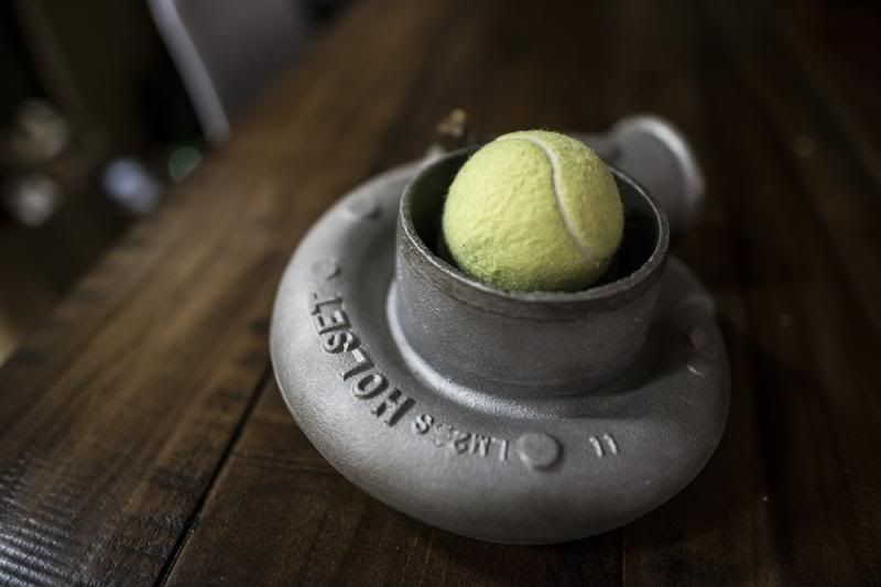

    I also picked up an HX35 (7-blade) turbo which I'm having rebuilt

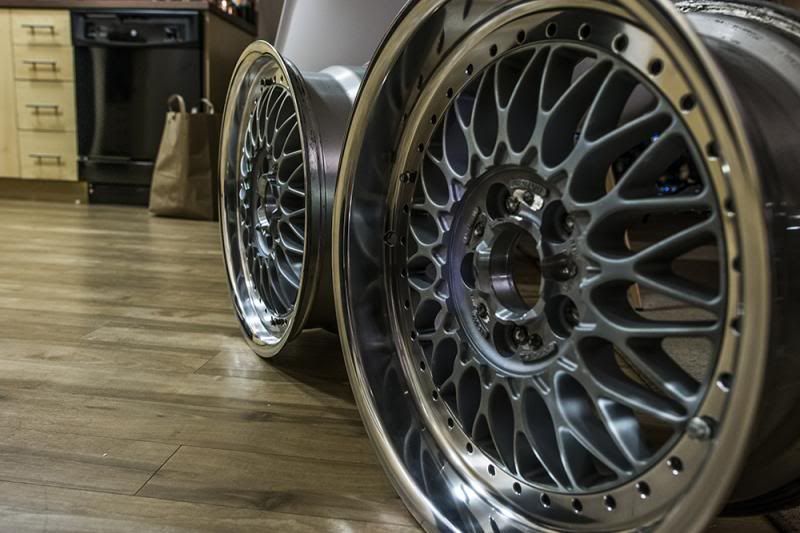

        Im replacing my ASA wheels with a set of staggered RC090's. Here they are stripped and polished. Im going to be finishing the centers with a hyper silver, which should look good with Sturling.

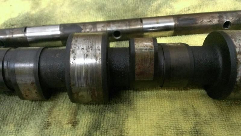

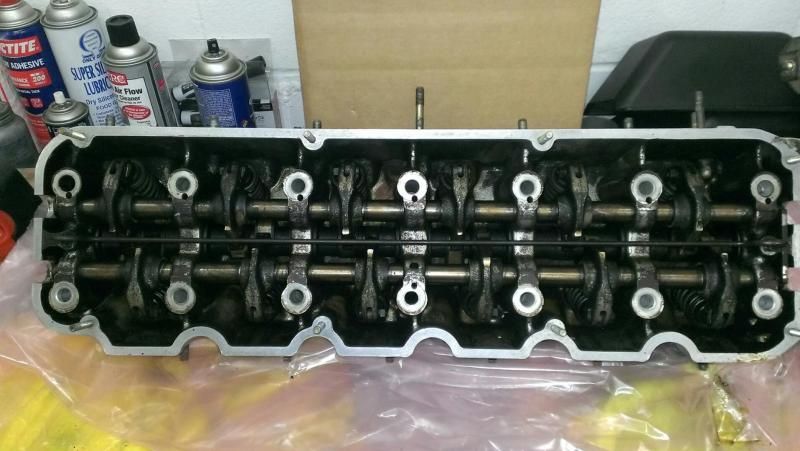

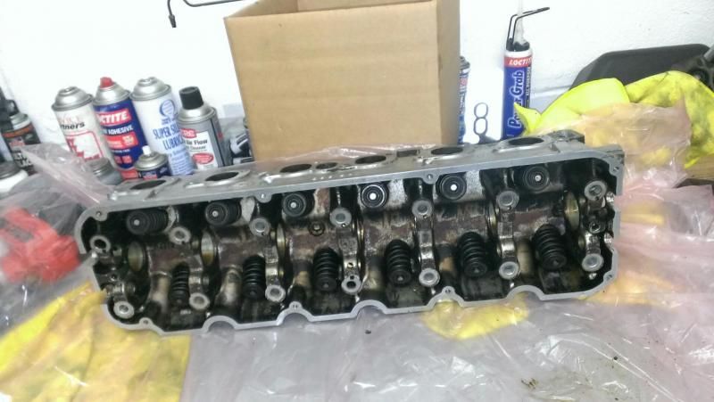

                            Update- Head disassembly
                            Starting point
                            Stripping it down
                            Cam decisions
                            My question to those who know or have done it before... Is there any benefit to buying a 272 regrind a this point vs having my stock cam reconditioned?
                            Im going to have an OEM head gasket, with an oringed block, and an entirely rebuilt head with HD rockers. Would it be safe to run a 272? is there a benefit with a turbo set up?
                            thanks for all of the help in advance, I'm learning a lot as I go on this build
                            • Chriskbmx
                              • Apr 2012
                              • 972
                              you could use the stock cam without an issue at all, and they are not that expensive to get brand new, or you could go with the bimmerhead turbo cam. You could use the 272 as well but I don't see the point with boost.
