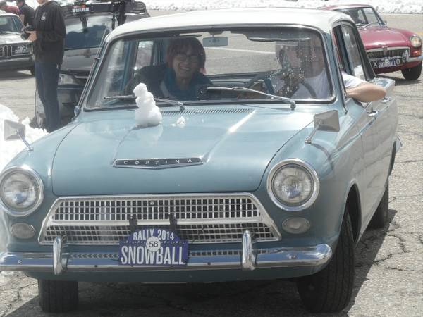

      good lord. how can there be so many of those things for sale at the same time? the chick inside the car looks exactly like the car. i thought the pic was from the early 70's but noticed the 2014 plaque on the front. this could be a portlandia skit.
