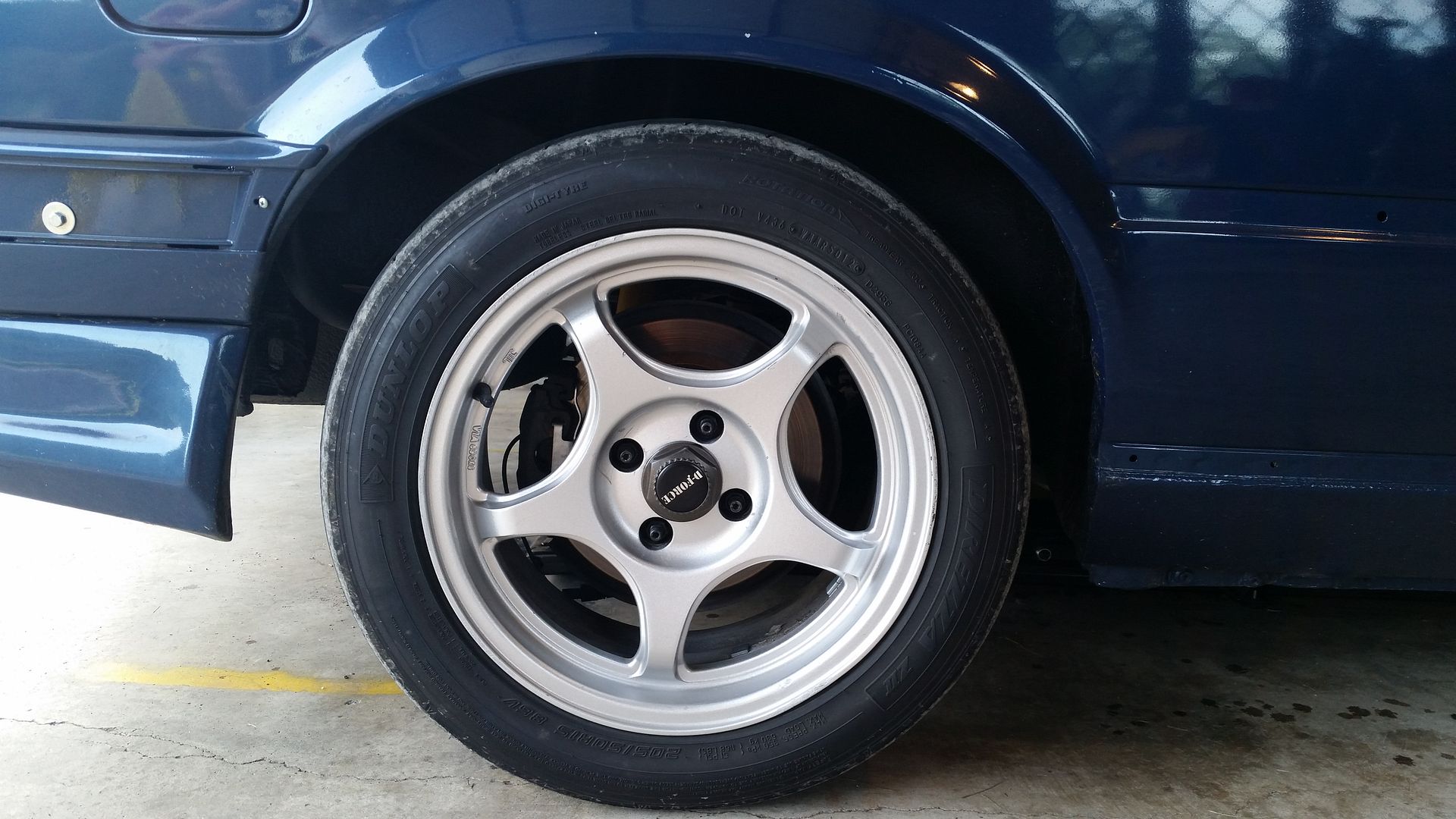

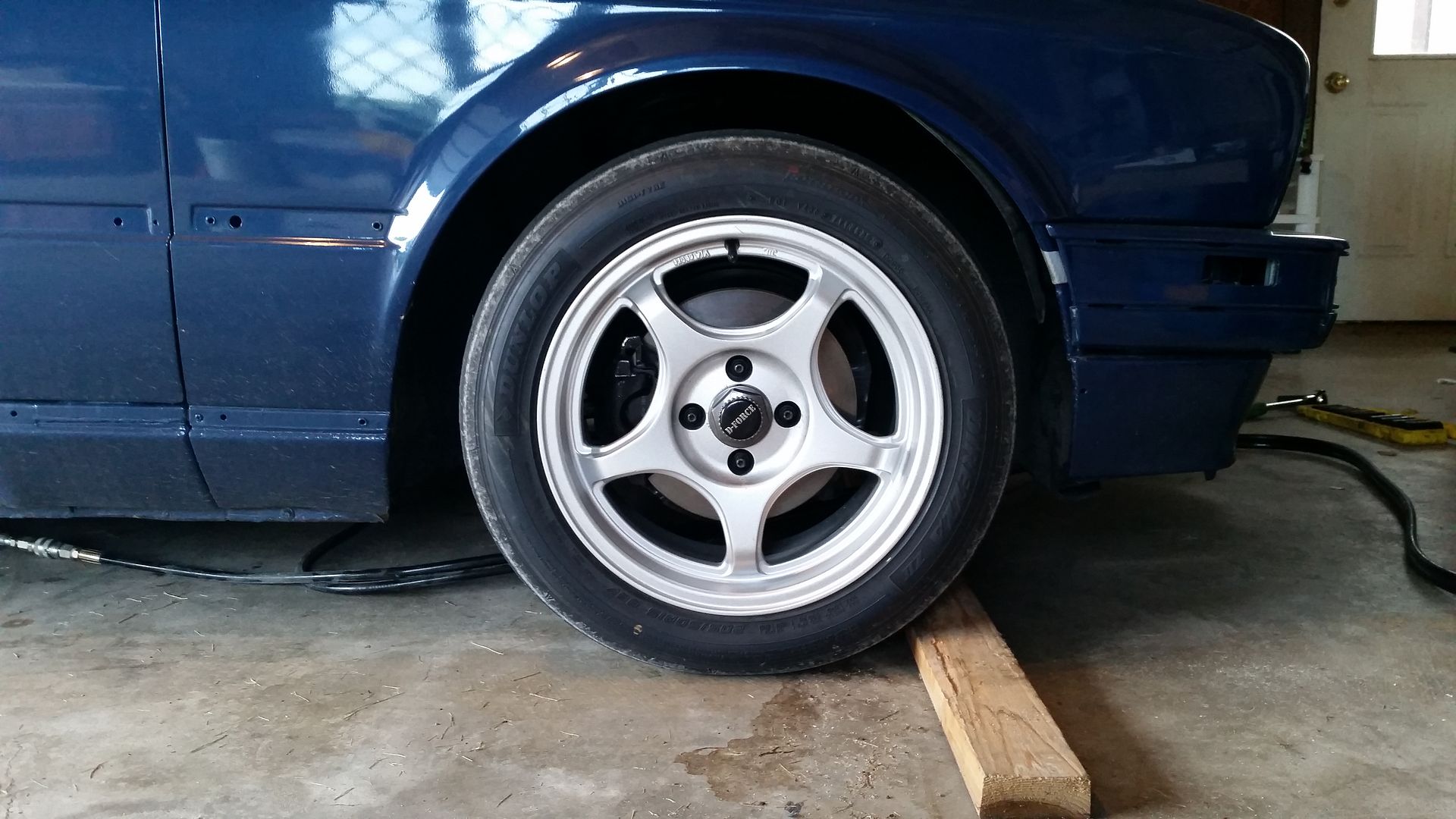

    So the first new tires arrived:

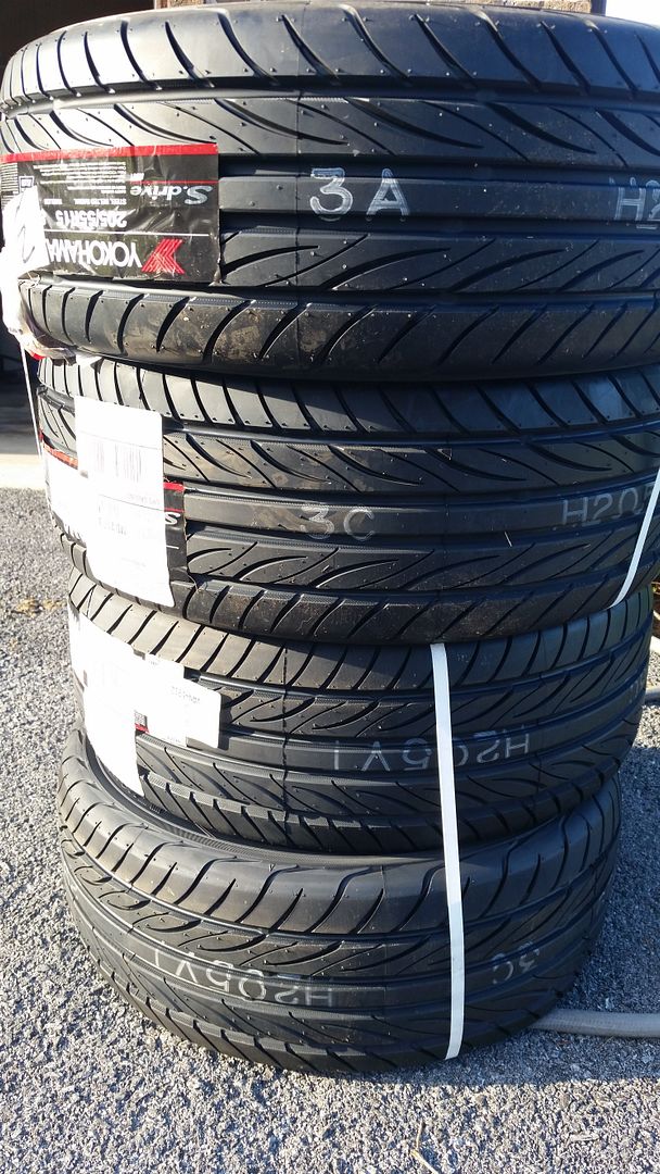

    Yokohama S.Drive, 205/55/15. These will (tentatively) go on the D-Force LTW wheels.
    Discount Tire Direct had a sale that was $135 off the set so I ordered them. I don't know that they are the BEST tires available but in my size they seem to give the best performance/value.
    I also orderd a complete set of "winter" (A/S will suffice) wheels & tires for the e30. The total deal on them was crazy. I don't LOVE the wheels but they will do the trick.
    Drag DR-20 (silver, machined face) ET10 15x7 for $85 shipped each, Kumho Ecsta 4xII tires (205-55-15) for $75 each, shipped. So why order them at all?
    First, the Kumhos were mis-priced on DTD. TireRack has them for $89 plus shipping. DTD has them as a "special order" tire so I got them at the crazy price of $75 each...plus a $135 rebate on the set from DTD, plus a $100 rebate from Kumho. The whole set was $65 shipped. The Drag wheels were $85 for all 4 with a $160 rebate, so $200 shipped, and mount & balance was free. Basically the wheels cost me $120 for the set, when you estimate $20 per tire to M&B. All told the set of winter wheels is under $200.
    DTD also had the 235/45/17 size for my WRX mis-priced at $88 each (versus $129 plus shipping on TR) so I got those with the same #135 + $100 rebates...~$125 for all 4 tires for the Subaru.

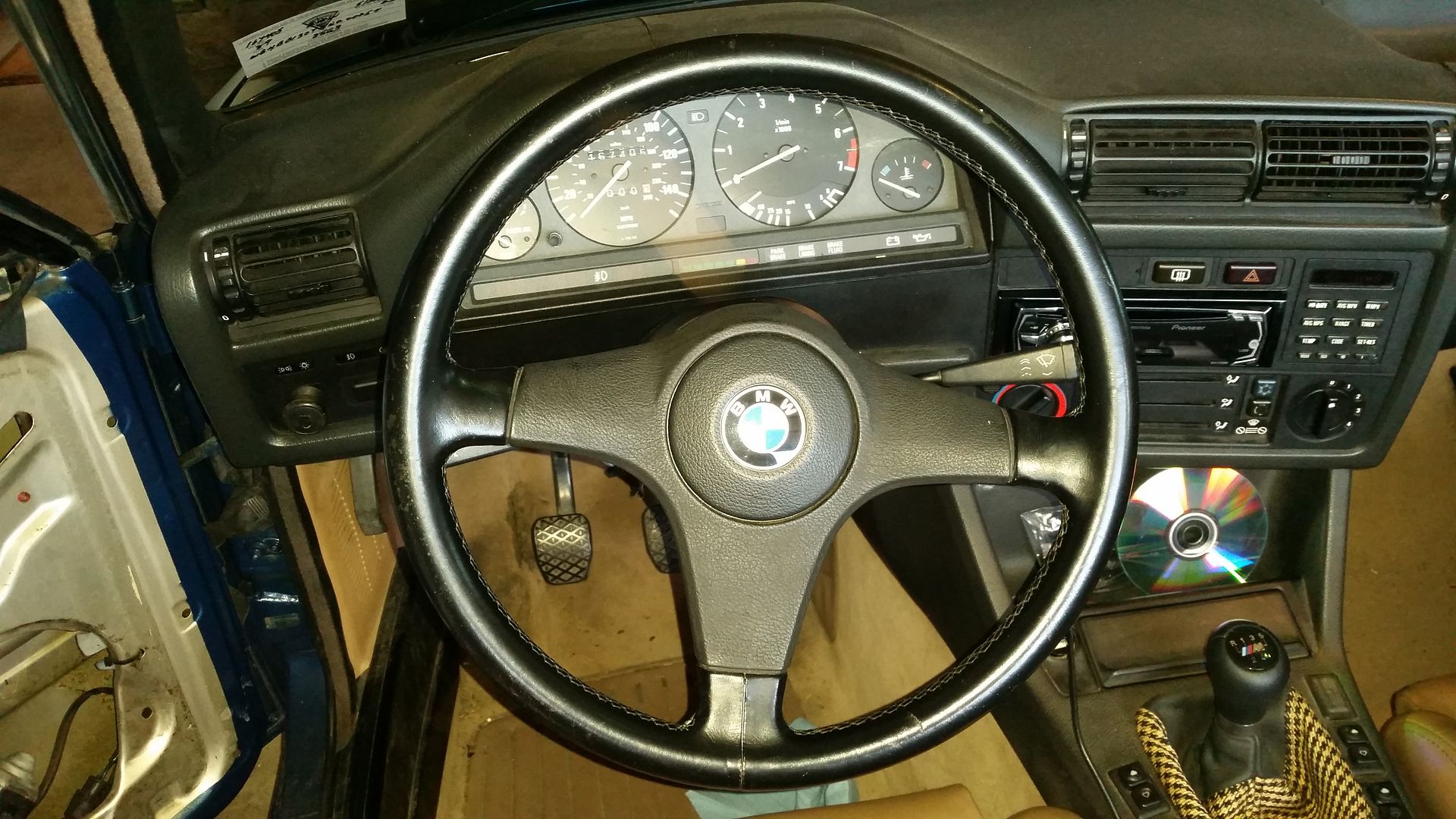

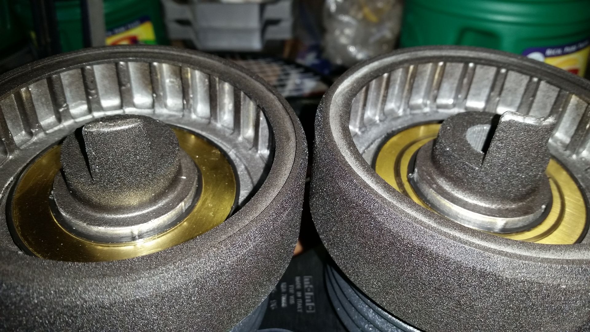

    Next up IO gave up on my Momo hubs. I have received 2 different hubs, both with defects (different defects) and neither will cancel my turn signals. I wasted $50 on a replacement turn signal arm thinking it was the arm but when I installed a 3-spoke Sport wheel that I traded for this weekend it worked perfectly.
    I have to say that I actually like the 3-spoke wheel quite a bit.

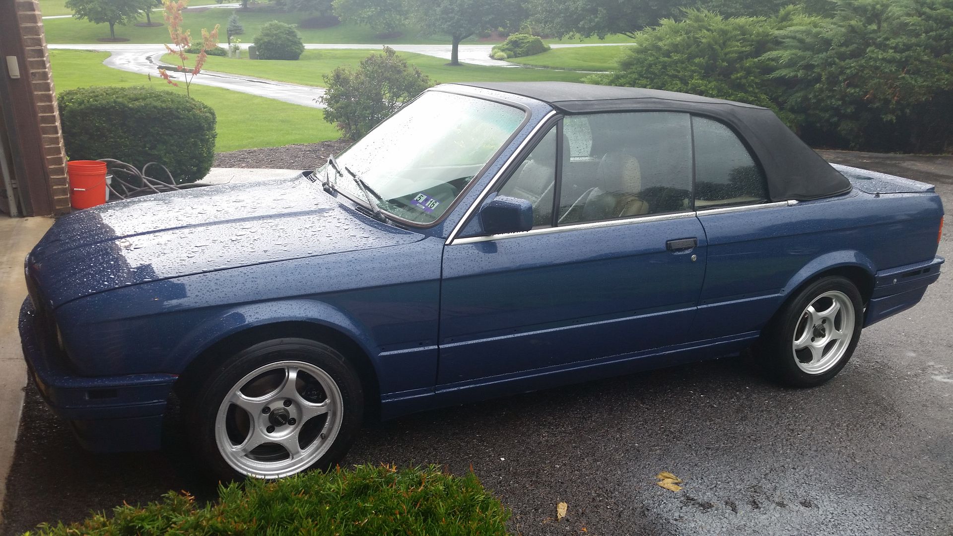

    So I washed the car in preparation for the return to the paint shop this week. I did it in the rain so that I got a nice rinse. I missed a few spots but I can go back later.
    Since I had nothing else to do I wired up some adapters for the fog lights using the leads from some destroyed Bosch OEM fog lights and the pigtails form the late model fogs. I crimped, heat-shrinked, and then taped them. Now all I need to do is install the lights after the paint punch list.

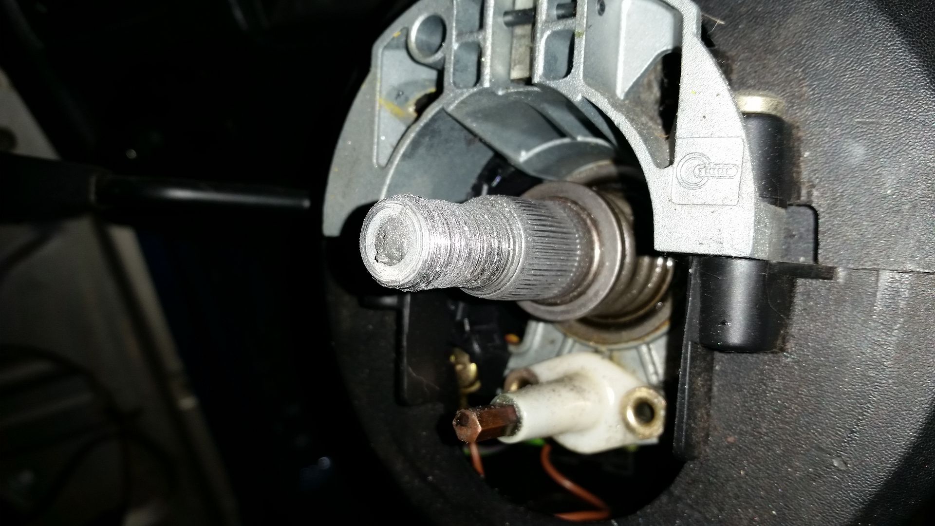

    So this happened...
    My turn signal cancel was malfunctioning worse now than before the alignment so I pulled the wheel to check the cancel nub. The nut (brand new) had compromised threads and the shaft itself was a mess.
    Upon examination of the old Momo hub versus the new one I can see that the hub has an issue with the casting of the cancel nub. I don't know if this caused the turn signal issues but my stalk will cancel from the right but not the left.
    Looks like I will be re-threading the shaft from an M14x1.5 to an M12x1.5.
    Fun.
    Looks like I might need a new steering shaft. 32311156068
    http://www.realoem.com/bmw/enUS/show...diagId=32_0448
    http://www.ecstuning.com/ES53072/

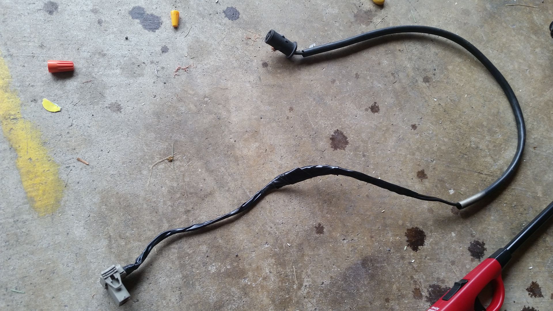

    Back to the antenna situation...
    So here is my not-so-solid temporary connection:
    As luck would have it I was selling wheels yesterday and I happened to mention my antenna situation to the buyer and he gave me his antenna cable end to use to splice together. After cutting it open the center lead looks like a single filament.
    I have posted in the audio subforum for suggestions on how to splice the 2 parts together. Best I could find is this, which tells me nothing...
    I do have a new cable but for now I want to have this until I do the whole re-wire for the amps and additional signal cables.

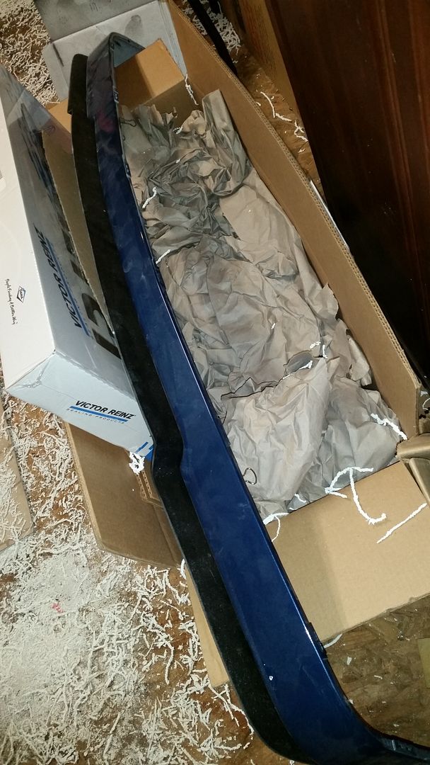

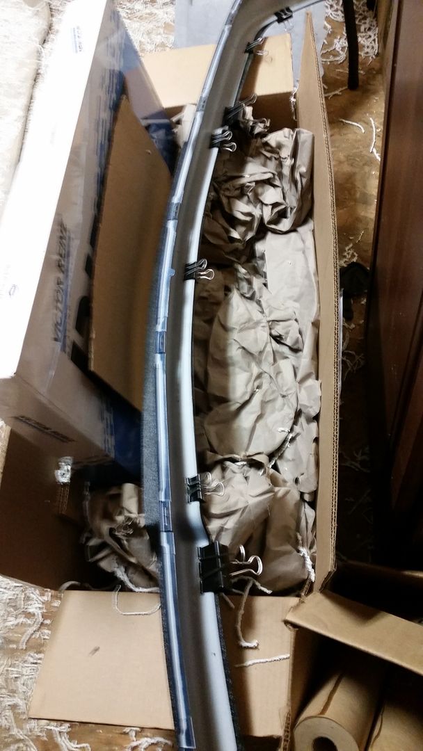

    So I started playing with the RyanG splitter last night. I had concerns that is was curled even after putting it flat in the sun for hours but after using some binding clips (the kind used for paper) I was able to get it to sit flat against my is lip. As soon as the paint is fixed/finished I will be able to install this stuff.
    I also noticed that the car has indeed settled. Between the loss of 3/4" ride height by downsizing form the 215/45/17 to my 205/50/15 and then settling after driving the car managed to scrape on the lift. It actually nicked the rubber coating on the hydraulic hoses so until I get the car up a little higher I don't think I will be parking it over the ramps.
    I did take a couple parking lot shots. The more I drive it the more i like it.
    I also managed to do a quick & dirty antenna repair on the mangled end of the OEM antenna cable. I took apart the 12V +/- connector and wired it uip to the Z3 antenna base and then used the raw end of the antenna cable and was able to get a solid signal to the headunit. No pictures now (and when I have them I warn that it is ugly) but at least I know that it is possible to have ot work until I install the replacement antenna cable.

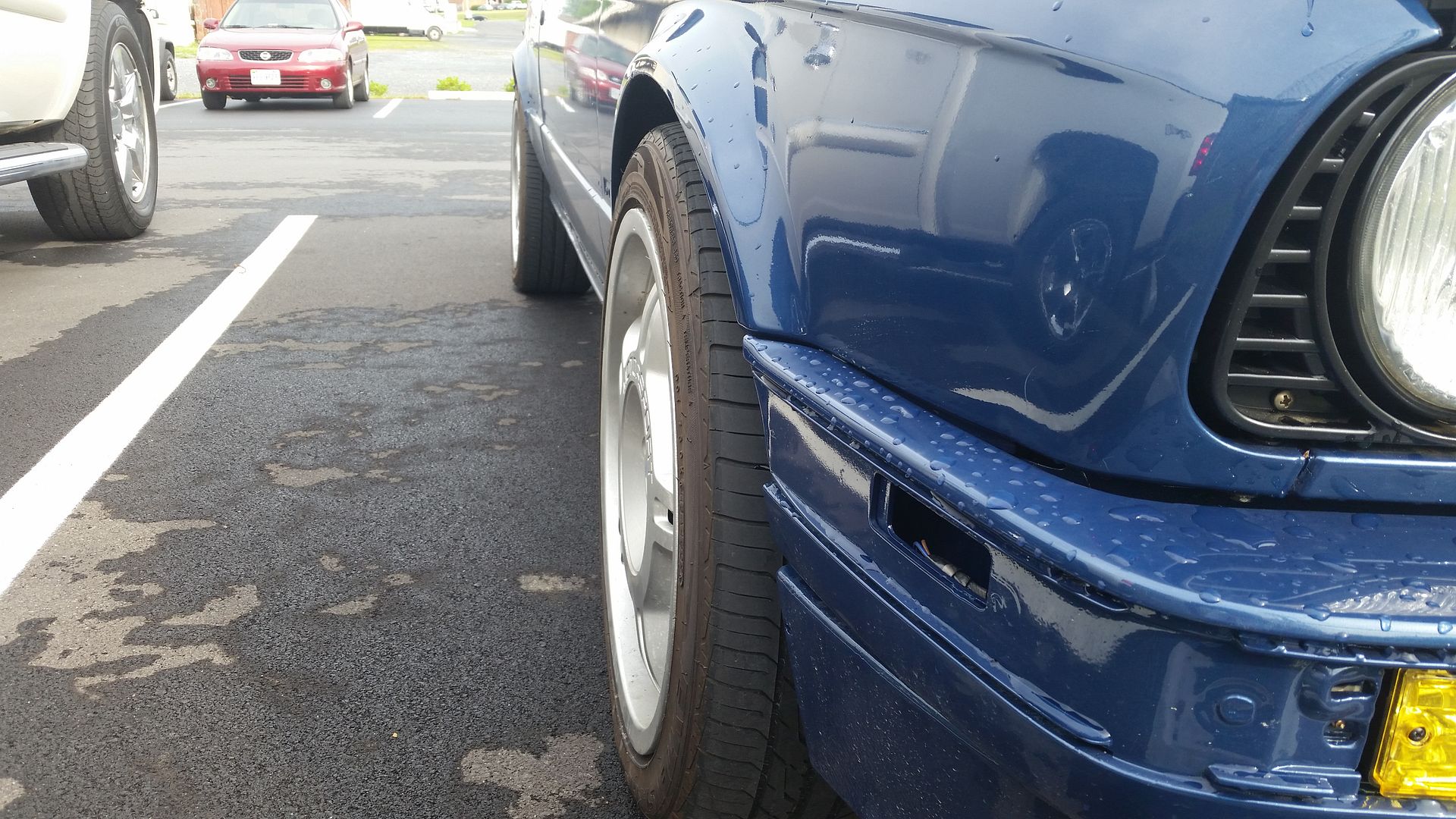

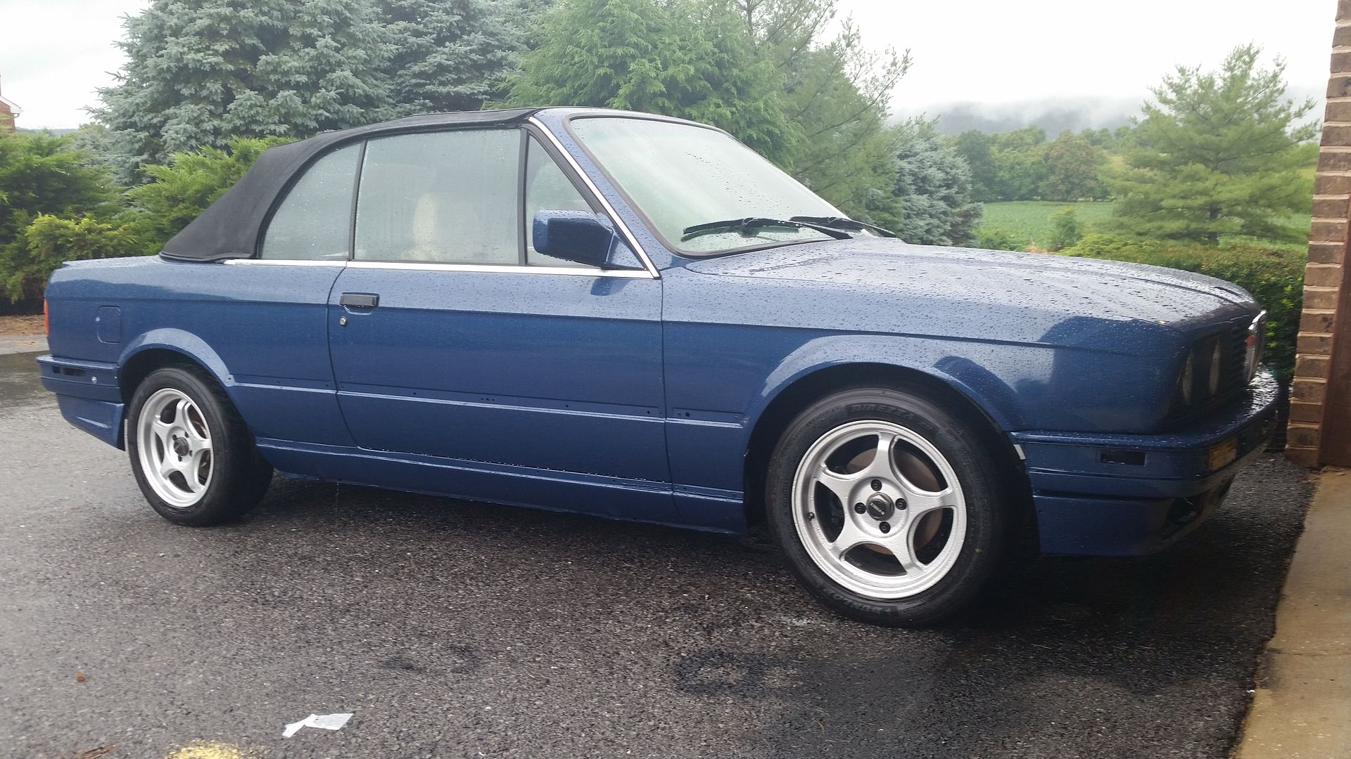

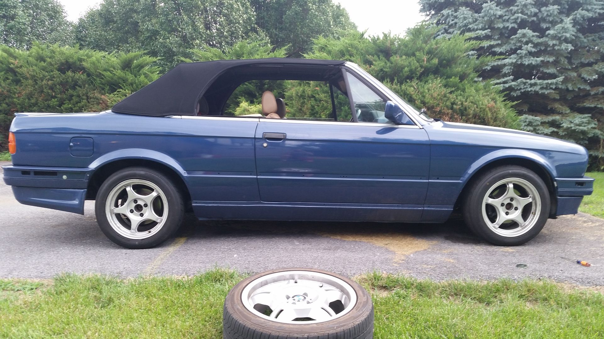

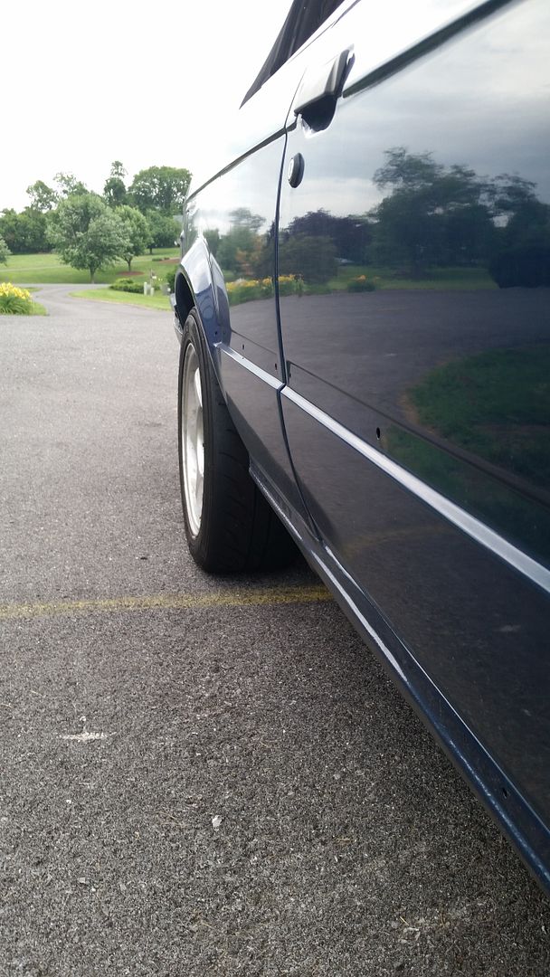

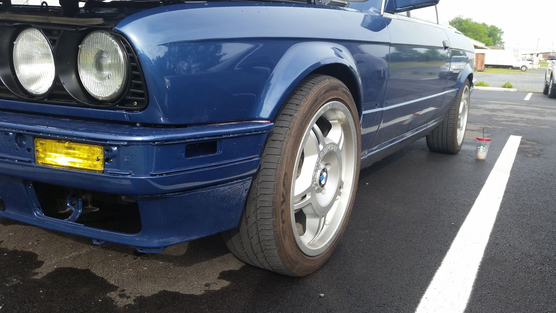

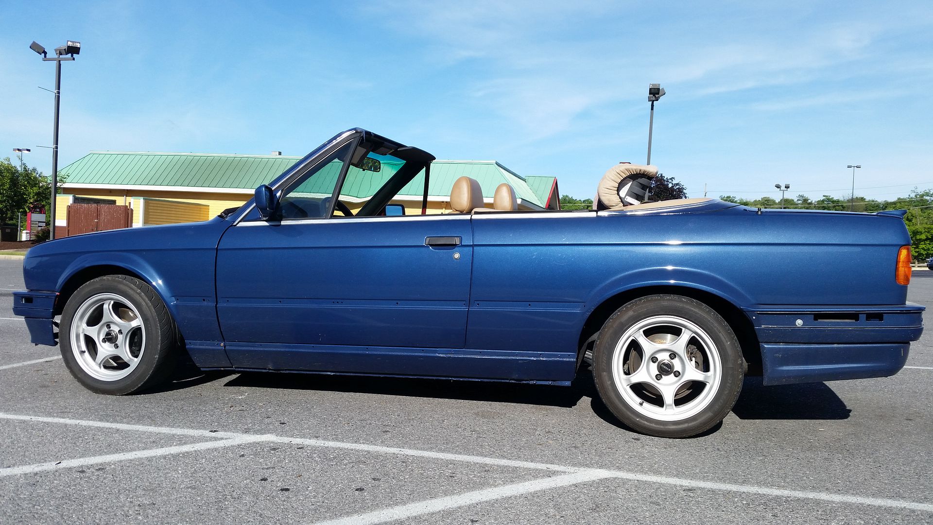

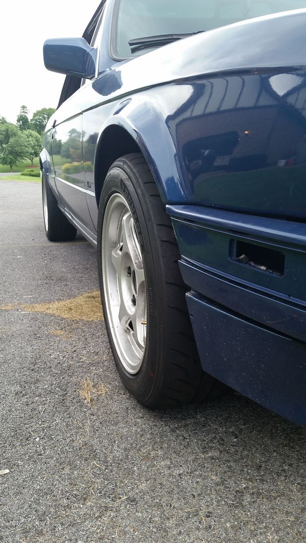

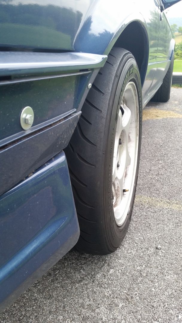

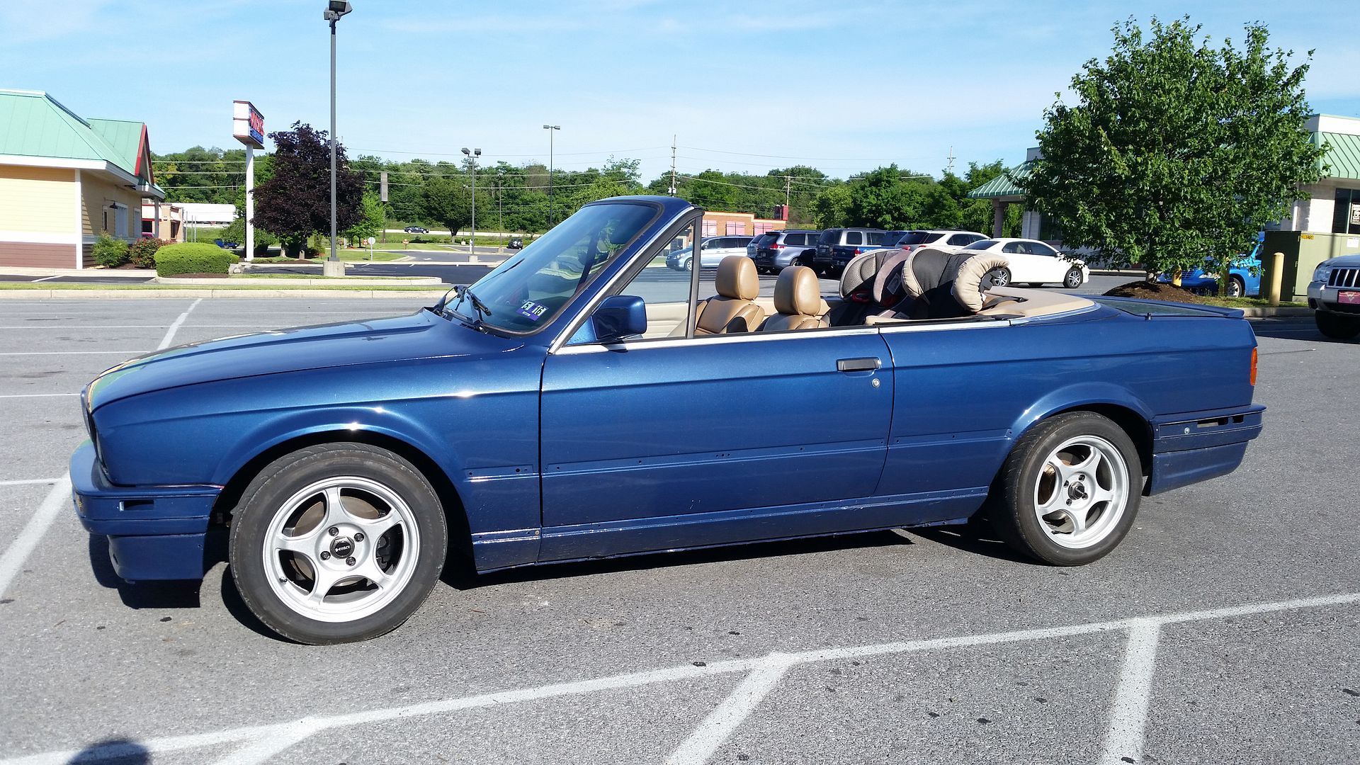

    Well, it was a sad day but the 17x7.5" Motorsport replica wheels are gone. They were big, heavy, and rubbed (on the fender liners, which I would prefer to keep) in turns so I sold them this weekend and installed the D-Force LTW wheels that arrived last week.
    First, a few pictures right after the install (they had not settled):
    Now a few after 20 miles of driving:
    And then after cleaning them up a bit (and more driving):
    All in all, not terribly happy with the look. I don't know if it is the gap with the 205/50/15 StarSpec ZII tires (as opposed to a taller 205/55/15) or the small wheels, or the offset, or what. I like the design of the wheels and I like the performance of the tires but it does not all come together well.
    For now I am considering a few options:
    First off, some data:
    Stock size (for the 14” basketweave wheels) is 195/65/14, which works out to 24” diameter and 7.9” section width.
    I had 215/45/17 on 7.5” wheels, which was a nice look but rubbed on the fender liners at certain points in the wheel sweep. Specs: 24.6” diameter and 8.2” wide.
    The current wheels are 15x7 wearing 205/50/15 Star Spec ZII tires. They are 23.1” tall and 6.5” tread width, 8.4” section width. No rubbing anywhere. The 1./5” smaller diameter explains why they look so horribly small in the wheel wells versus the 17” I had.
    So the options:
    205/55/15. I can run these on a 15x7” wheel without any issues but a 15x8 will result in a slight stretch. I see MANY examples of people fitting them on a 15x8 and they don’t actually look stretched. I was on the fence about it but I looked at pictures (see below for example) and I don’t mind it.
    Specs 1 (Kumhos): 23.9” diameter, 6.9” tread width, 8.4” section width.
    Specs 2 (Dunlops): 23.9” diameter, 7” tread, 8.4” section width.
    Both list a 7.5” wheel as the max.
    Here are the options on Tire Rack. If I go “summer: I’ll get the Direzza DZ102 and if I go A/S I’ll get the Ecsta 4x II, which has a $100 rebate all month. http://www.tirerack.com/tires/TireSe...r=17&zip-code=
    Here are a couple pictures of 205/55/15 tires on 15x7 & 15x8 wheels. http://www.r3vlimited.com/board/show...&postcount=187
    If I go this route and keep the current wheels I will add some spacers- 5mm or 8mm, or 5F/8R and worry about new wheels later.
    Pros: Comfort, cost, already have the wheels. Can run them on wider 15” later.
    Cons: Not in love with the (current) wheels, limits width to 8” (not that I would go wider), and well, 15” wheels…enough said.
    16” tire options:
    205/50/16: 24.1” diameter, 8.4” section width, 6.9 to 7” tread width. “Safe” wheel width range 5.5-7.5”
    225/50/16: 24.9” diameter, 9.2” section width, 7.4” tread width, 6-8” wheel range
    Here I’d have to err toward the 205/50/16 as a 225/50 might rub due to the overall diameter. With it being larger overall than a 215/45/17 and wider (at 225 versus 215) I am probably stuck.
    Pros (of 16”): The 205/50/16 is basically the same amount of sidewall that I have on the ZIIs on the car now but another inch of metal in the center. Probably would look great. Tires (in the long run) will be easier to find versus 15” but but the time I have to get new tires I may have had wheel-ADD kick in and will want new wheels anyway.
    Cons: I have to buy new wheels and tires. I can’t really find 16” wheels that I love right now. Well, I can find some that I like ( http://www.3sdm.co.uk/collection/wheel-005.php ) but my wife hates them and I don’t love them enough to press forward.

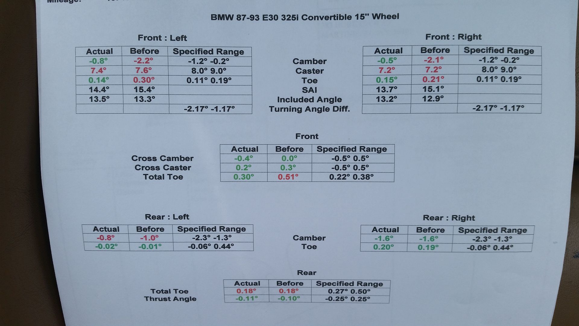

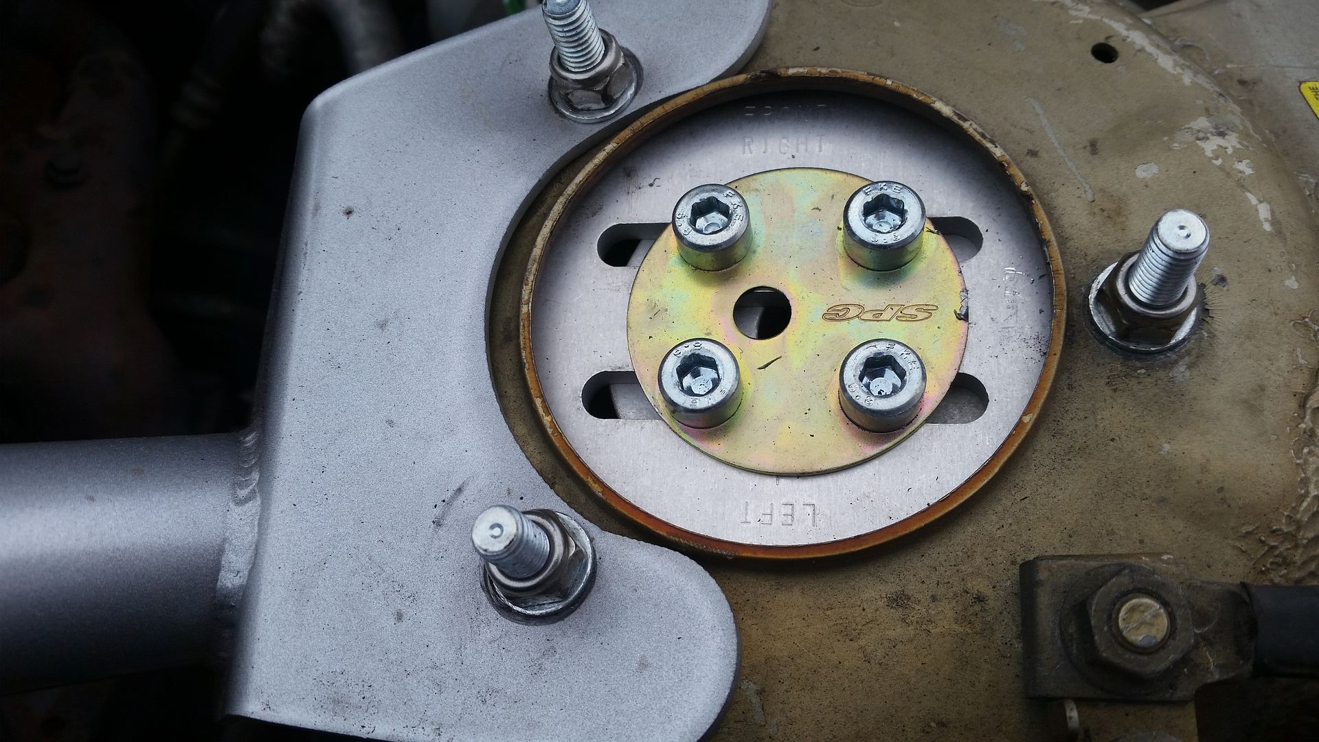

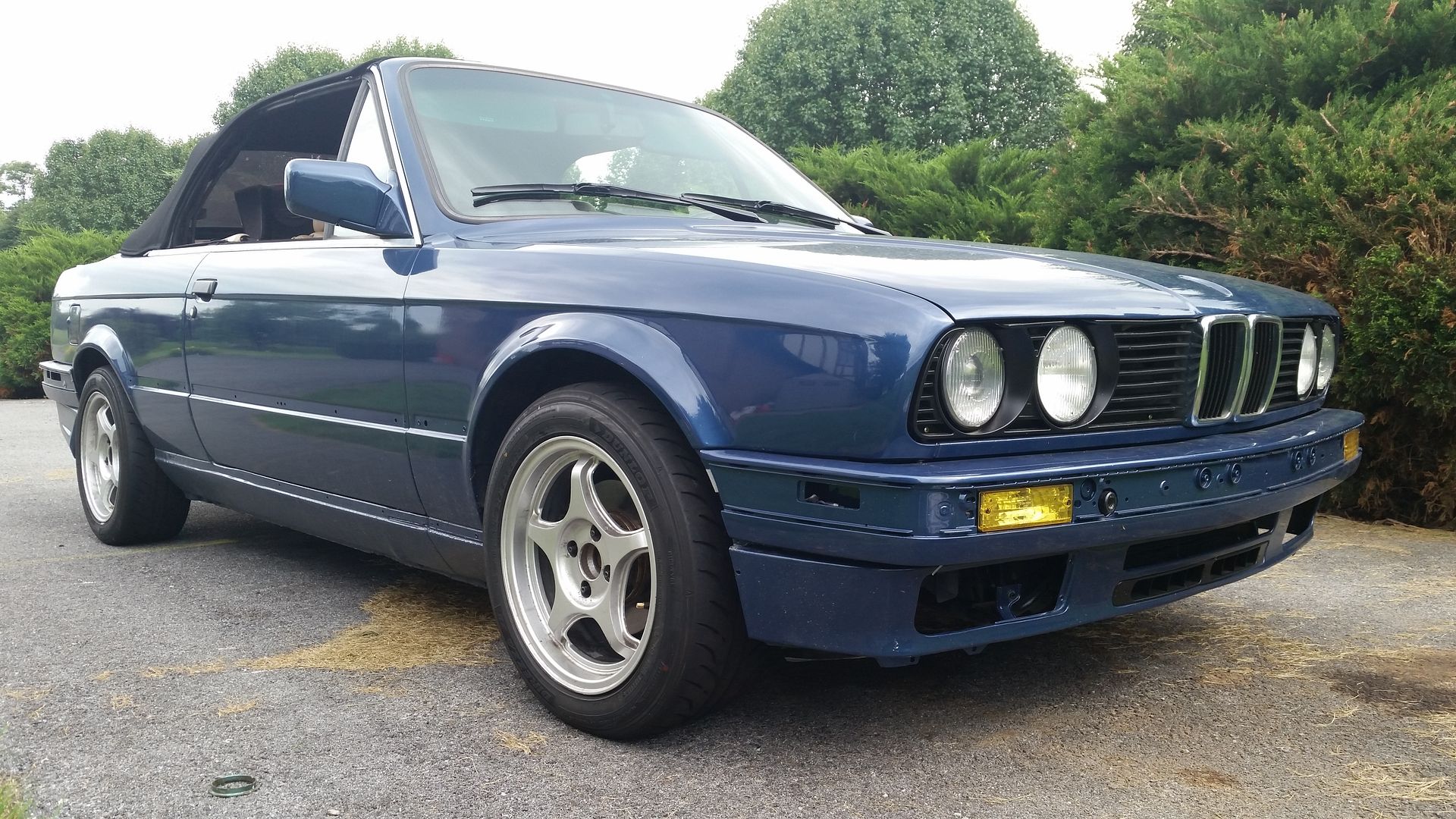

    So I got the car from the shop this morning. The difference is staggering. My alignment was so off that I was really questioning the whole "Ultimate Driving Machine" thing. After alignment: Excellent.
    The specs were pretty bad before- even moreso because the shop eyeballed the camber to something approximating normal during the camber plate install before putting it on the rack.
    The good news is that the car was able to be dialed into spec after lowering by using the UUC / SPC camber plates ( http://store.uucmotorwerks.com/e30-c...ries-p431.aspx ). The bad news is that the whole thing set me back about $500, installed and aligned.
    So before the alignment and camber adjustment the car looked somewhat stanced and was generally looking boy-racer-ish up front. Now it looks like it is owned by someone who likes to drive- not hard park. "Before" pictures are on pages 19 & 20.
    After:
    So the sad reality is that the frame on this car is not perfectly straight. Look at the difference in camber plate setup to get the numbers above:
    So now on to test-fitting the 15" D-Force wheels to see if I like them. I have the 17" reps tentatively sold for this weekend (the guy paid a deposit) but if he continues to flake on pickup dates I am going to move on to another buyer- or just keep them. He has had to reschedule for almost 3 weeks now and messages to set something up for this weekend are receiving very non-committal replies. I don't have any interest in disrupting family plans to meet his schedule when I gave him my availability over 2 weeks ago.
