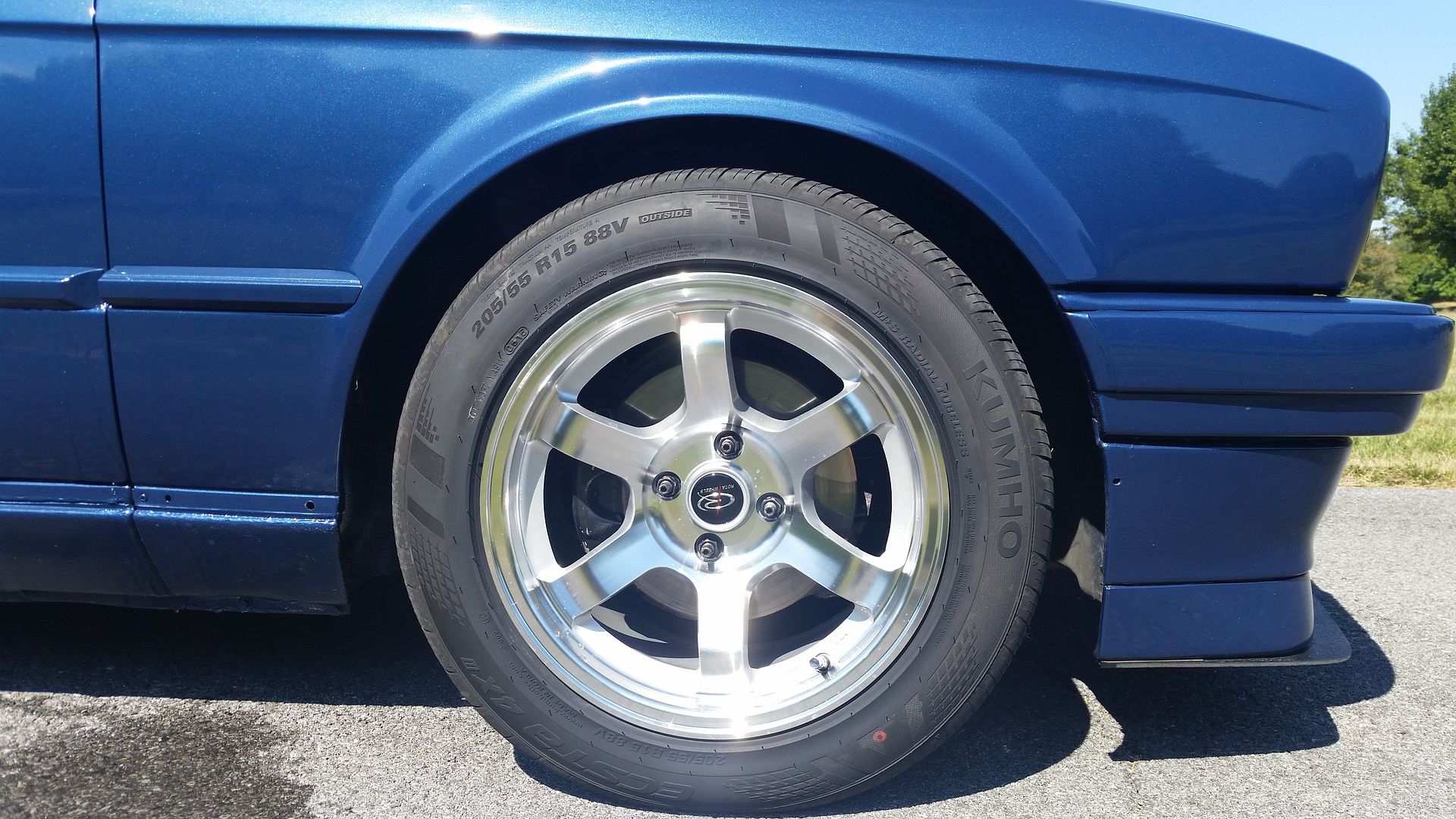

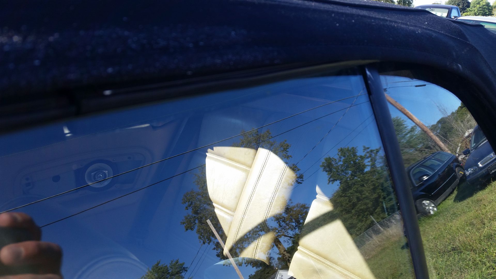

        Got an "after" shot of my window alignment:

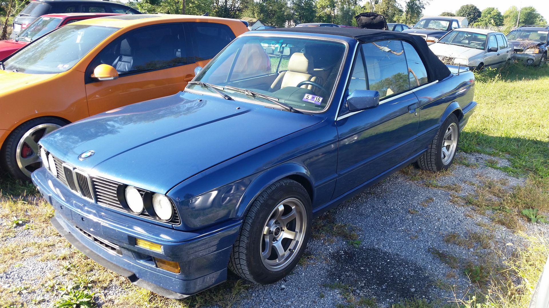

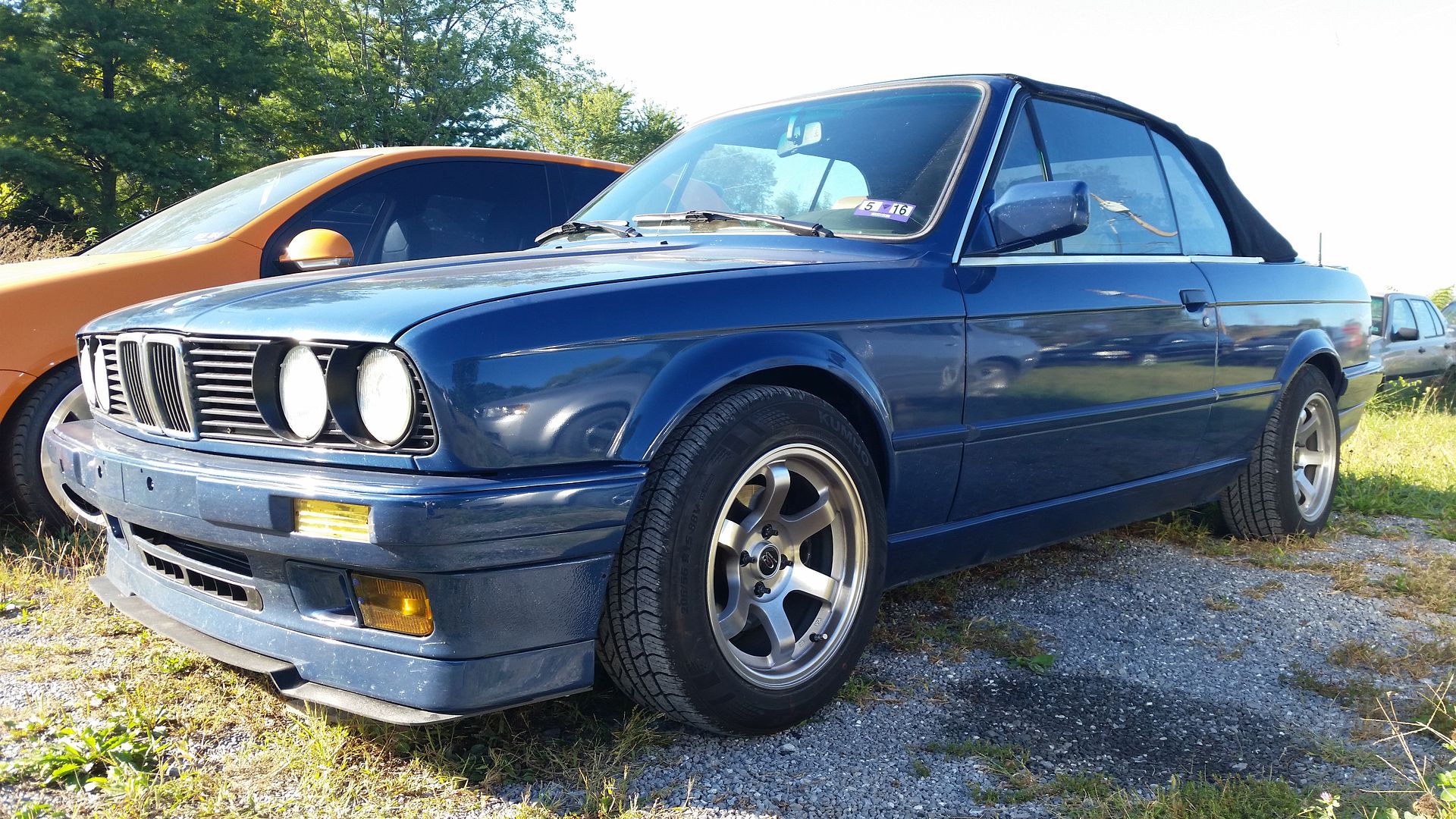

        And snapped a few shots of the car with the top up (a rare sight).

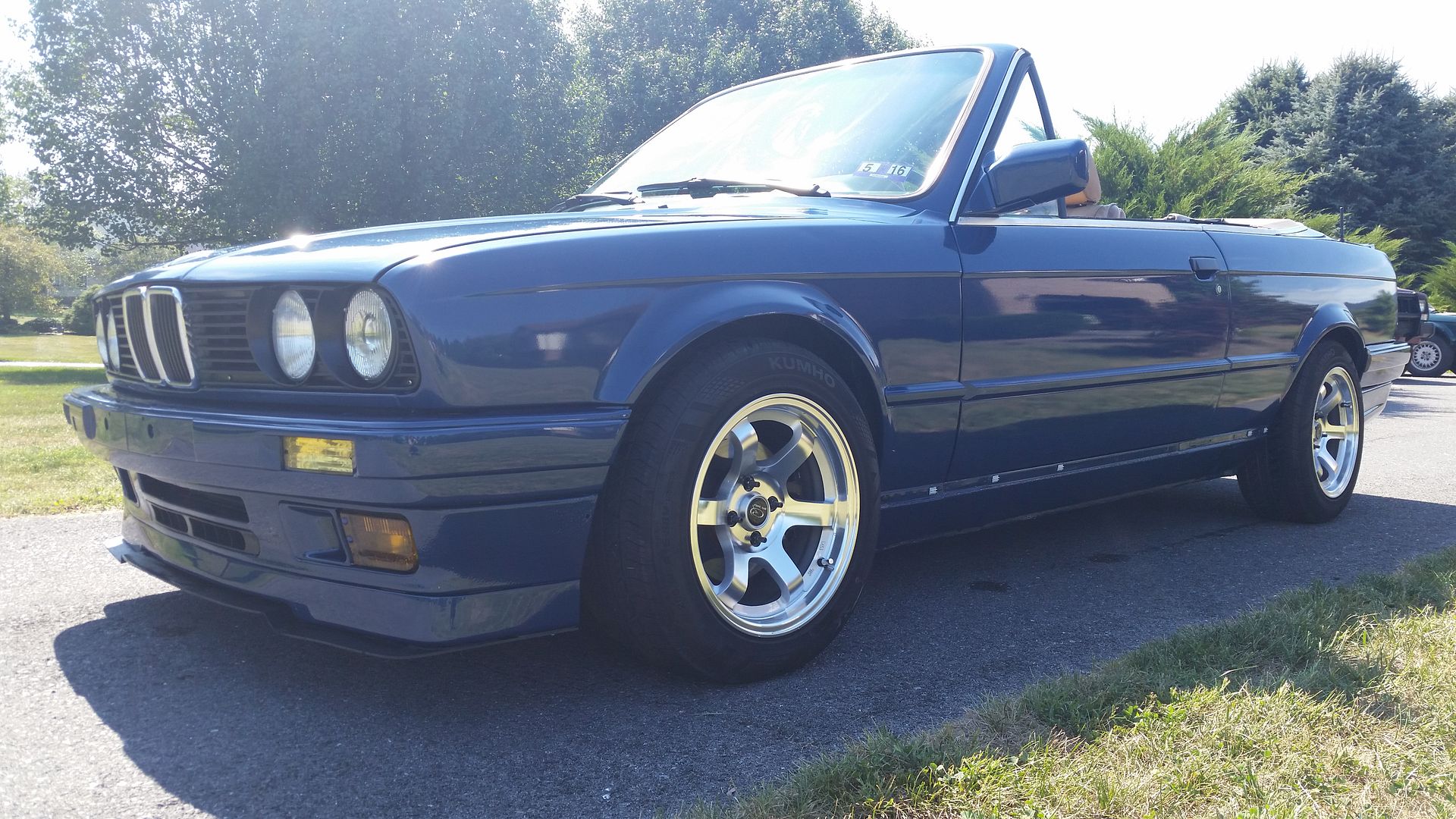

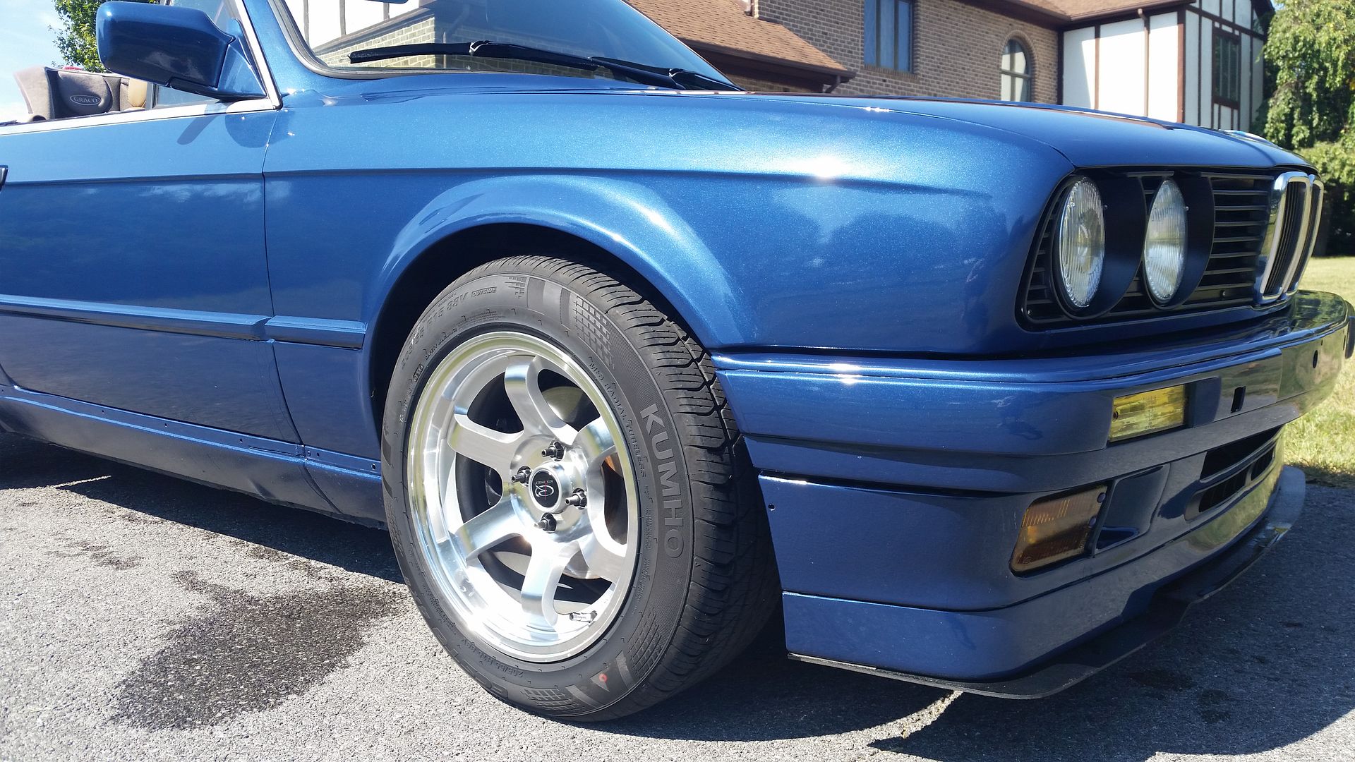

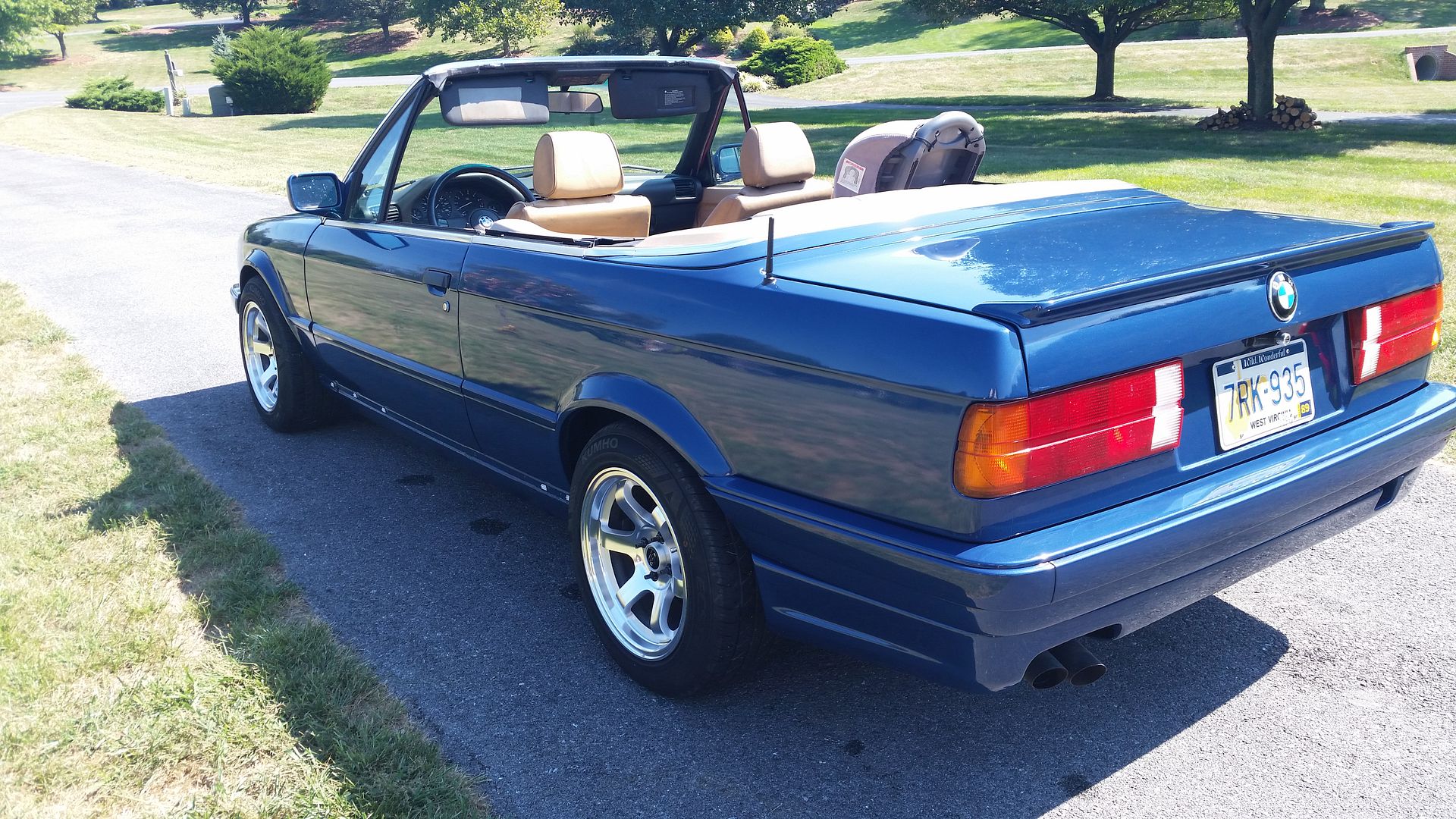

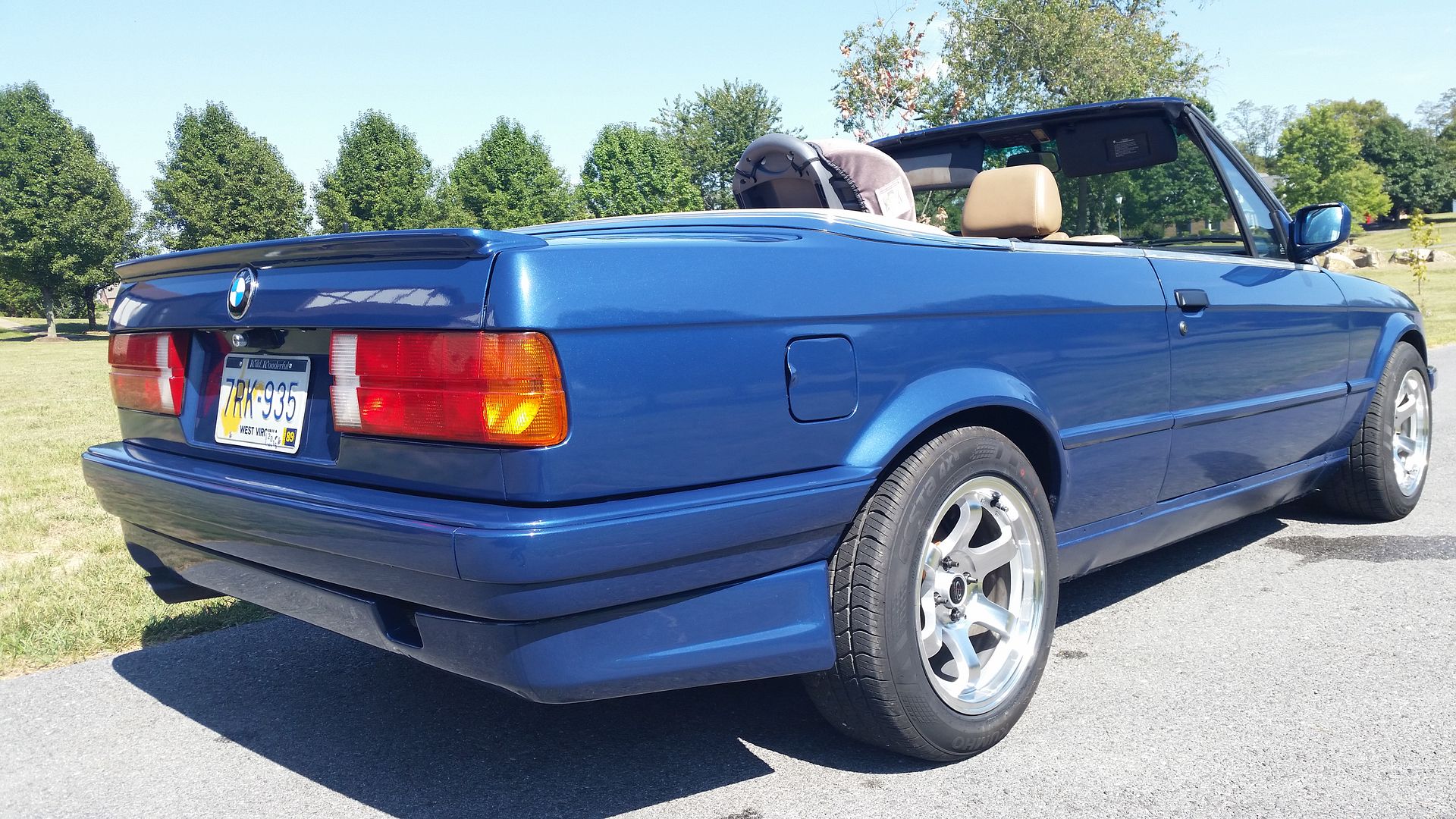

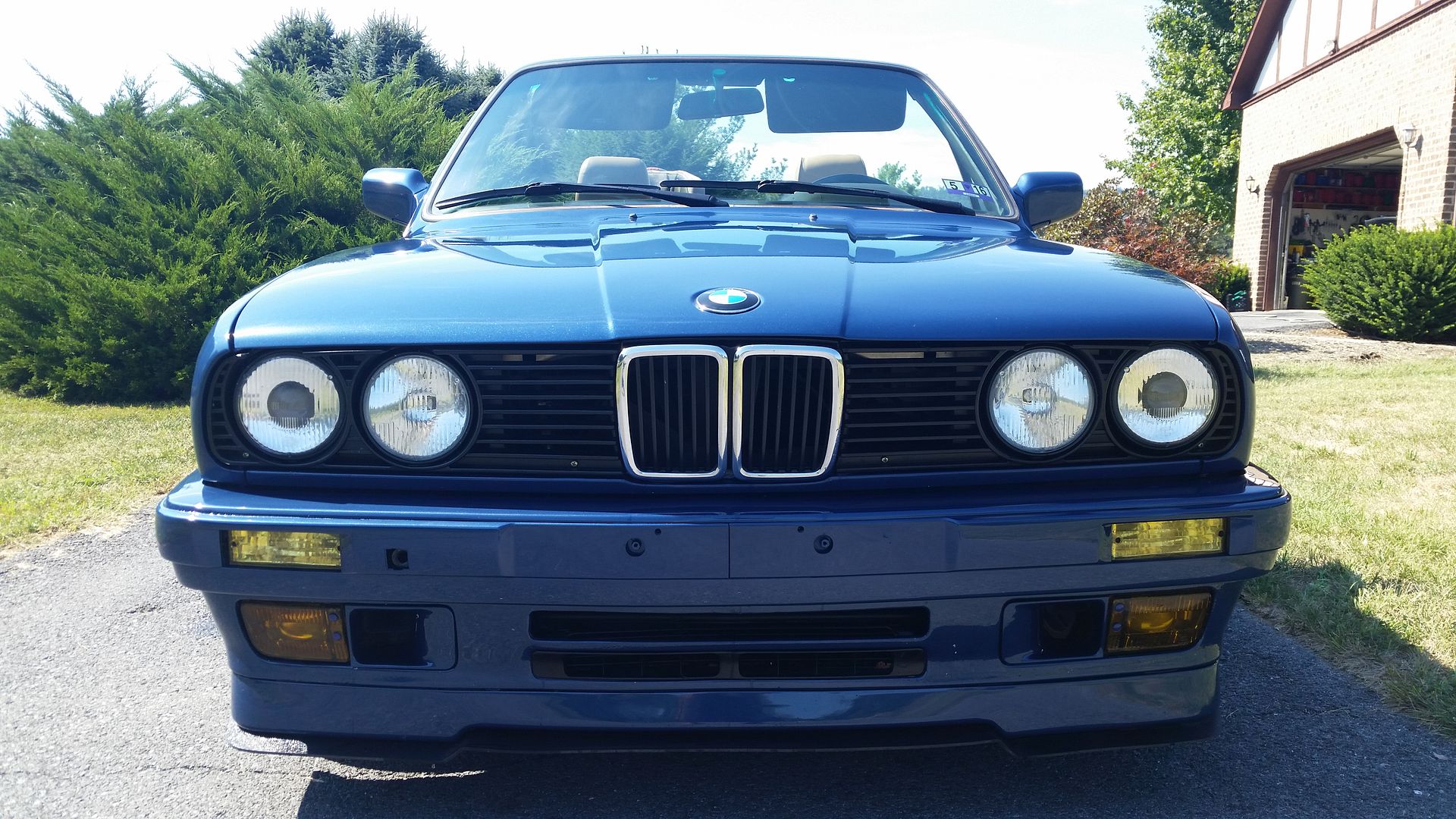

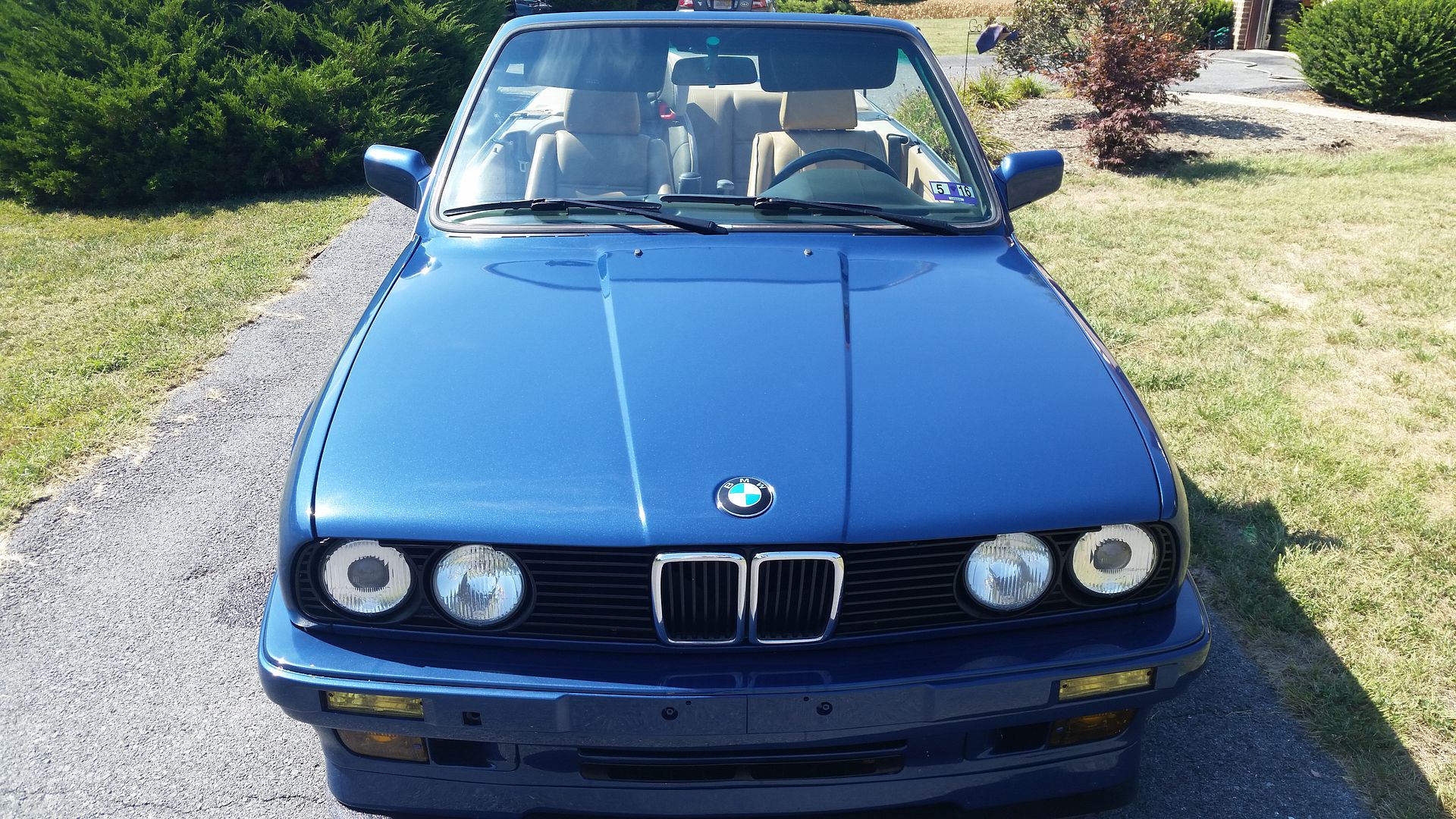

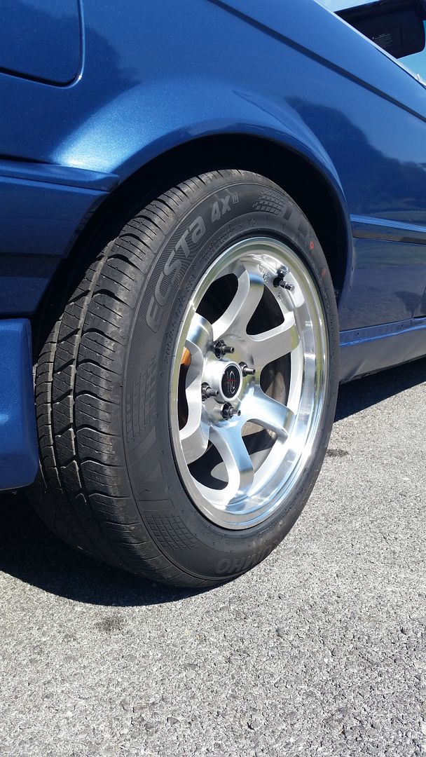

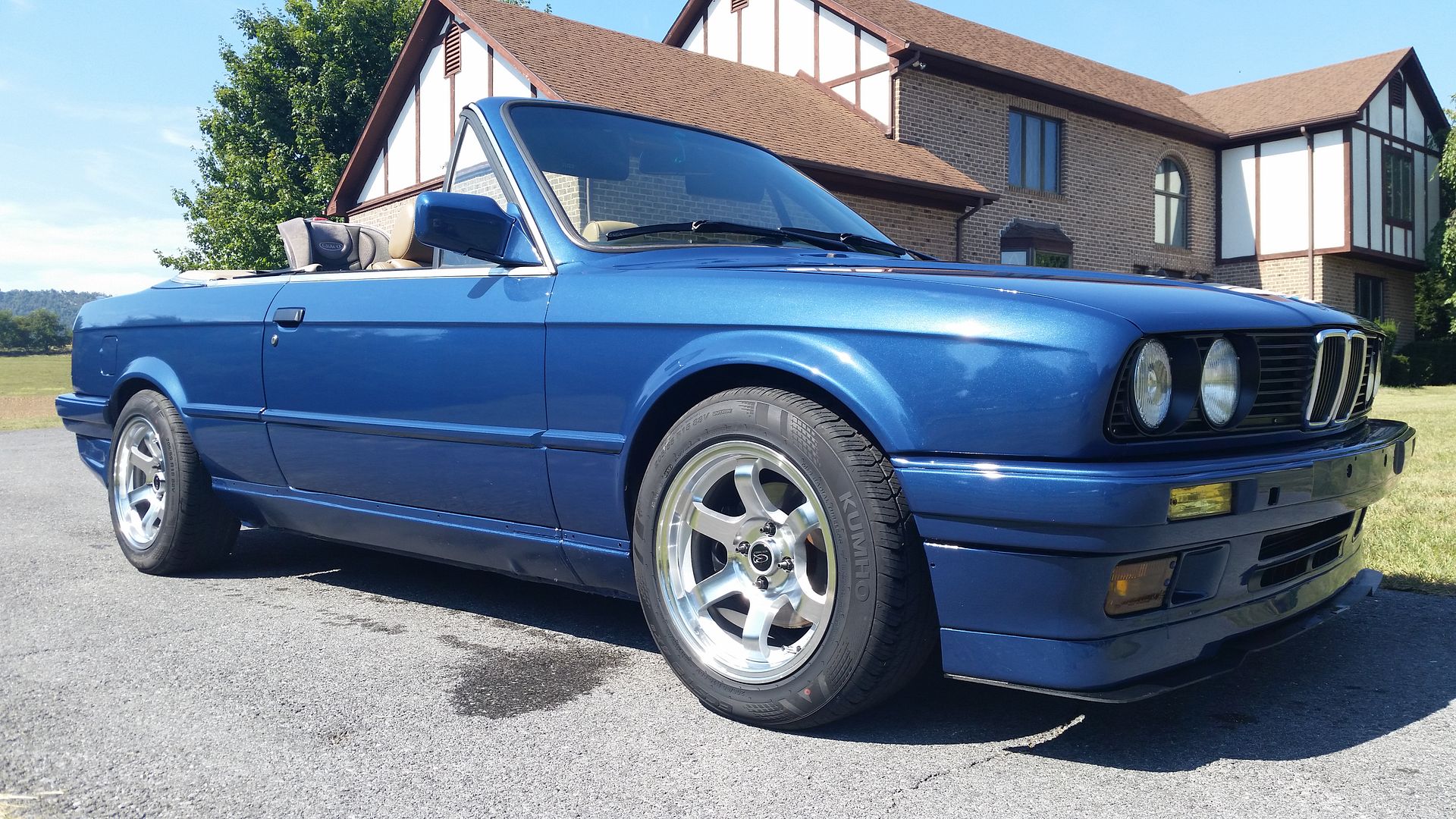

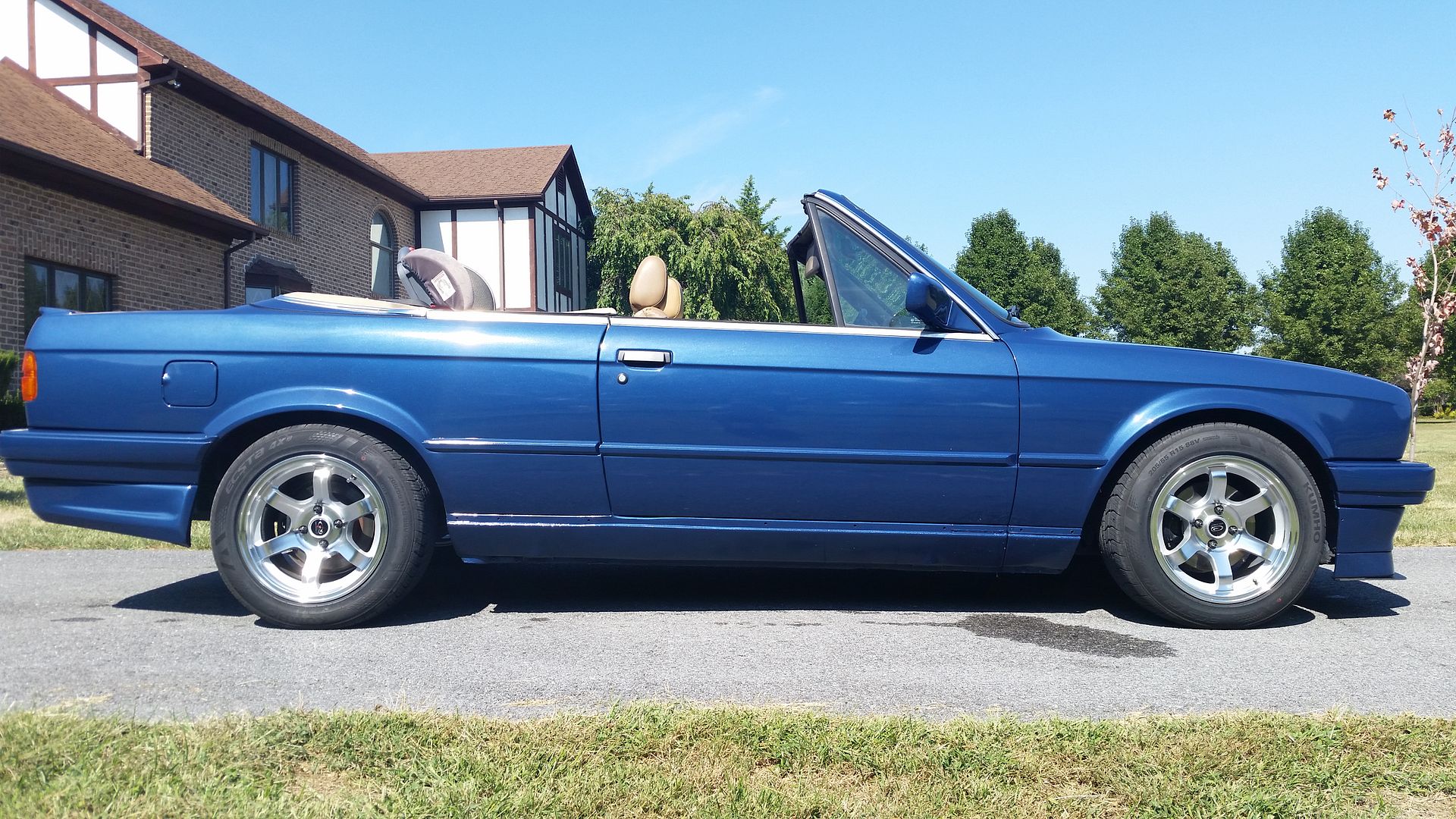

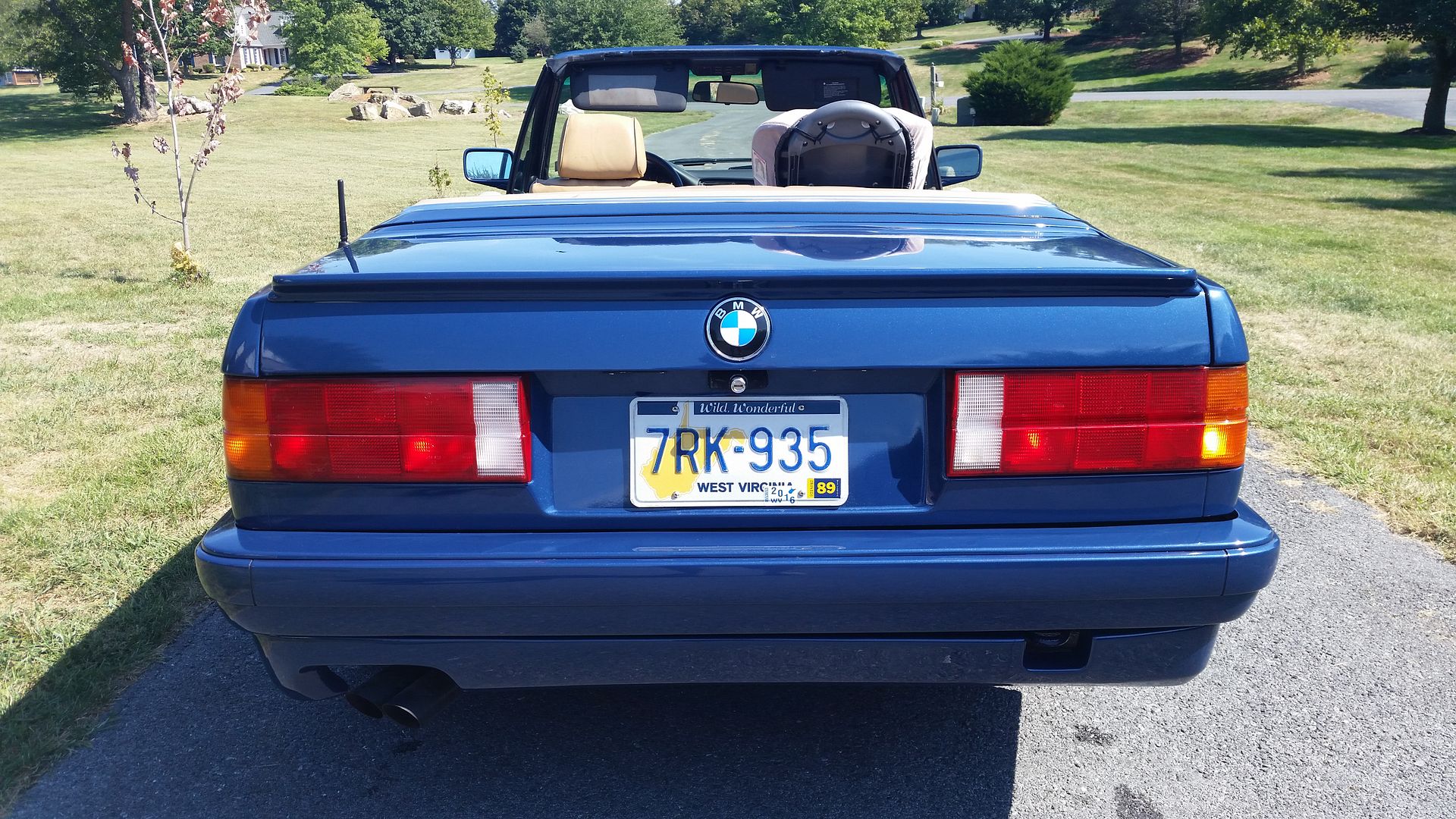

          In more positive news, I washed the car for the first time since I got it back from paint:

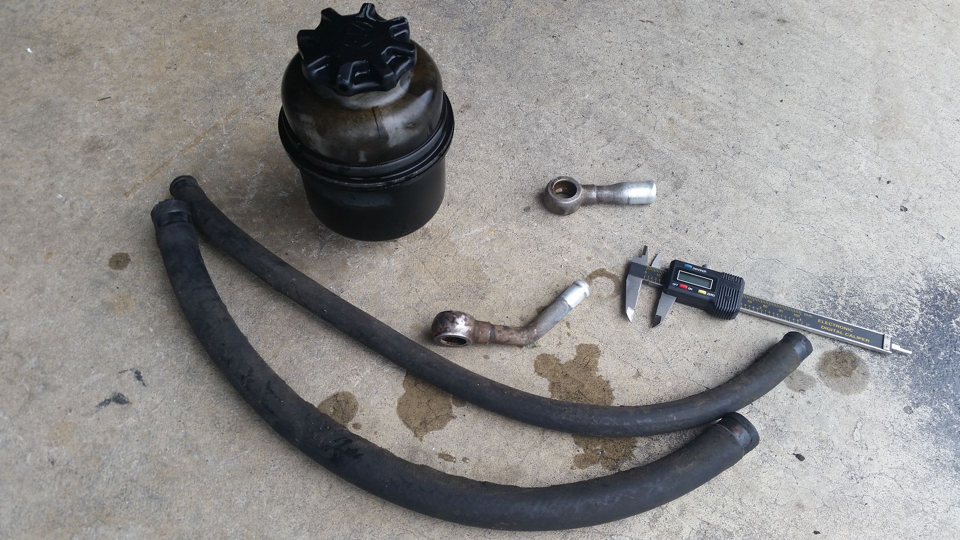

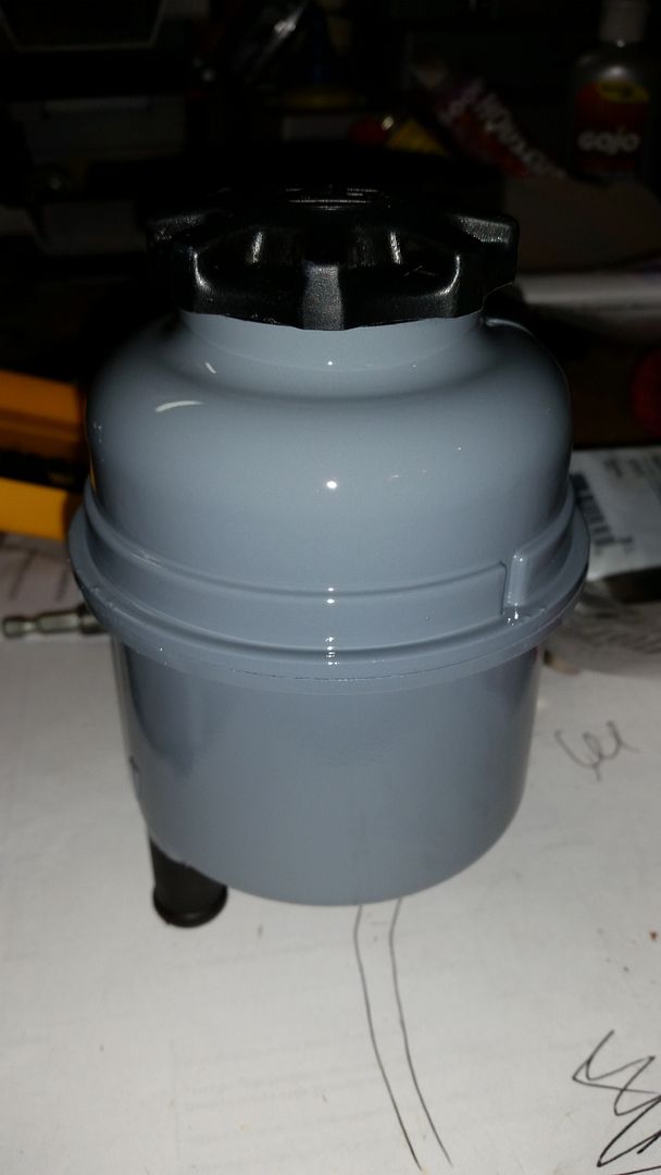

                            Next item, I was dismayed last Wednesday to come home to find some oily spots in the garage where my e30 usually sits on foul weather days. My wife used it to take the kids a few places (not a problem) but the oil spots under the car are growing and there is now a new PS fluid leak. After investigating the lines they are leaking from the reservoir and associated lines so I went to the parts pile and found what looks like a nice, clean ZF reservoir.
                            I took the assembly apart to replace the hoses, as I don't like the idea of re-using bad lines.
                            I took a caliper to the fitting and the lines are a 12mm ID and a 16mm ID. I could not find that info anywhere so for those looking for info in the power steering lines, there you go.
                            Since sourcing the replacement lines with fittings is expensive and sourcing metric lines locally is difficult I will first try using 5/8" and 1/2" lines to make my own replacement hoses. I will report back on the results.
                            Out of boredom I painted the spare reservoir:
                            I plan to replace it the next time I make an order from one of my regular vendors but the shipping of a single part is a bit excessive so I will wait until I have a bigger order- unless this ones seals up properly, in which case I will stick with it.

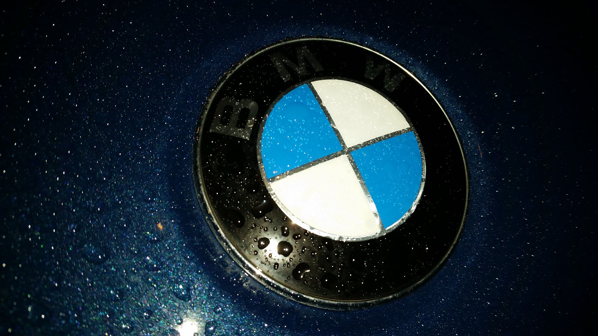

                            Lastly, when I was really young I saw a print for sale in an old Road & Track or MotorTrend magazine (the paper kind- remember those?) of a Porsche emblem with water droplets on it. After pulling the e30 back in the garage Sunday night I saw that the droplets on the Roundel looked pretty cool:
                            They looked cooler in person. Whatever.

                              You are reading my mind. I just ordered new reservoirs. I need to address the leaky PS hoses. They are too expensive to justify purchasing new. You did will preserving the banjo fittings. I plan to replace the hose onto the original fittings. I think the hose will need to be special ordered.
                              ACS S3 Build / Dinan 5 E34
                                As I searched out oil cooler lines for my W123, I came to the conclusion sourcing hoses like this through the dealer is silly. The hardware is good. The hose needs replaced. There are numerous hose shops in the area. I intend to have them rebuild mine after weighing the cost of simply buying the hose from them and using my own clamps.
