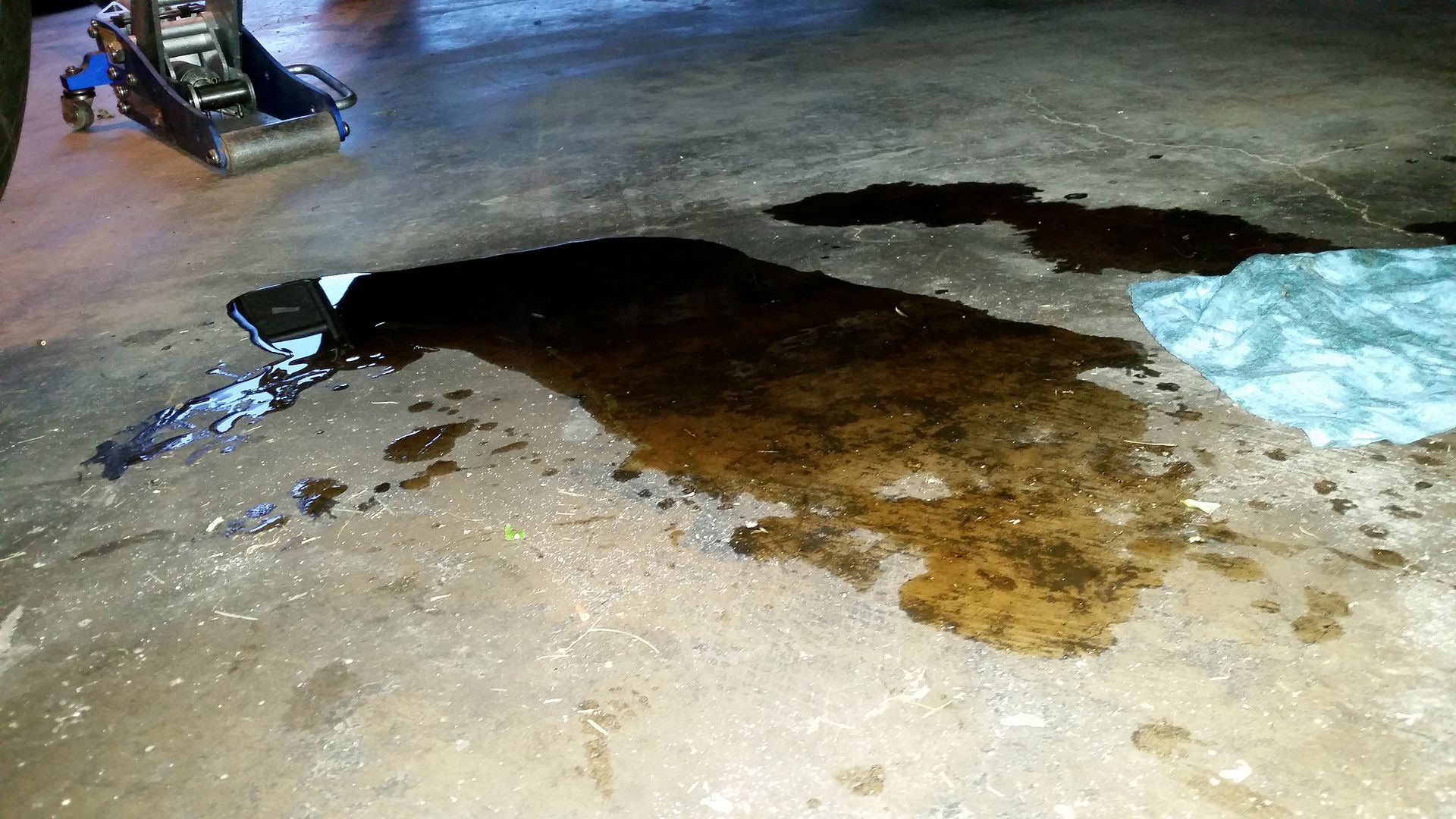

Not much has gone on lately, and unfortunately I have not driven the car other than up and down the street. The fan is still not hooked up (it is in place but not wired) and the oil cooler fitting is (was?) leaking like mad. The power steering line(s) also still leak badly.

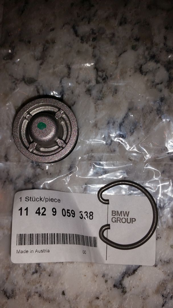

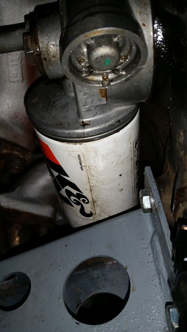

Also worked on a remedy to the leaking oil cooler. The leak looked like it was coming from the o-ring that mounts to the block (between the adapter and the block) but after replacing that I still had a leak from the oil control valve gasket. I looked at the how-to here and it seemed simple enough, plus the parts were cheap ($14 shipped).
(BMW P/N 11429059338 )

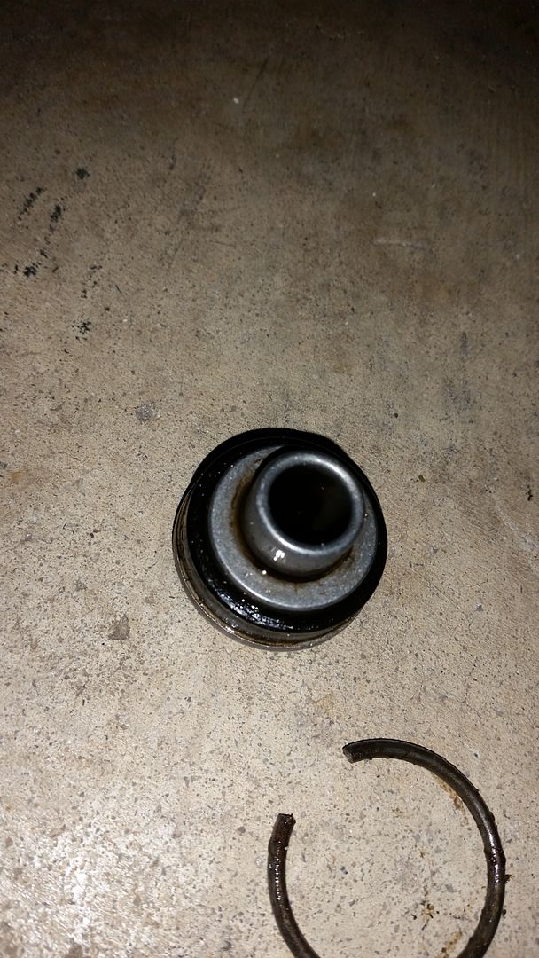

Old parts:
That ring is pretty spent. New parts installed:
I will delete the cooler if this does not work but it seemed like a less messy solution than removing the cooler but in the end I am not sure. Replacing this was a messy PITA but it is done- now I just need to drive it to see if it worked.

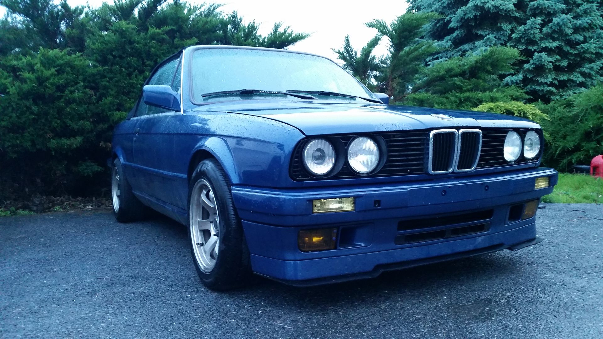

But I had to end the rainy weekend with a beauty shot as she awaits this week's impending sunshine.
So I got the e30 out and did a few hundred miles over the last week. The 2.7i feels amazing and I am very happy to say that most of my leaks have been resolved!

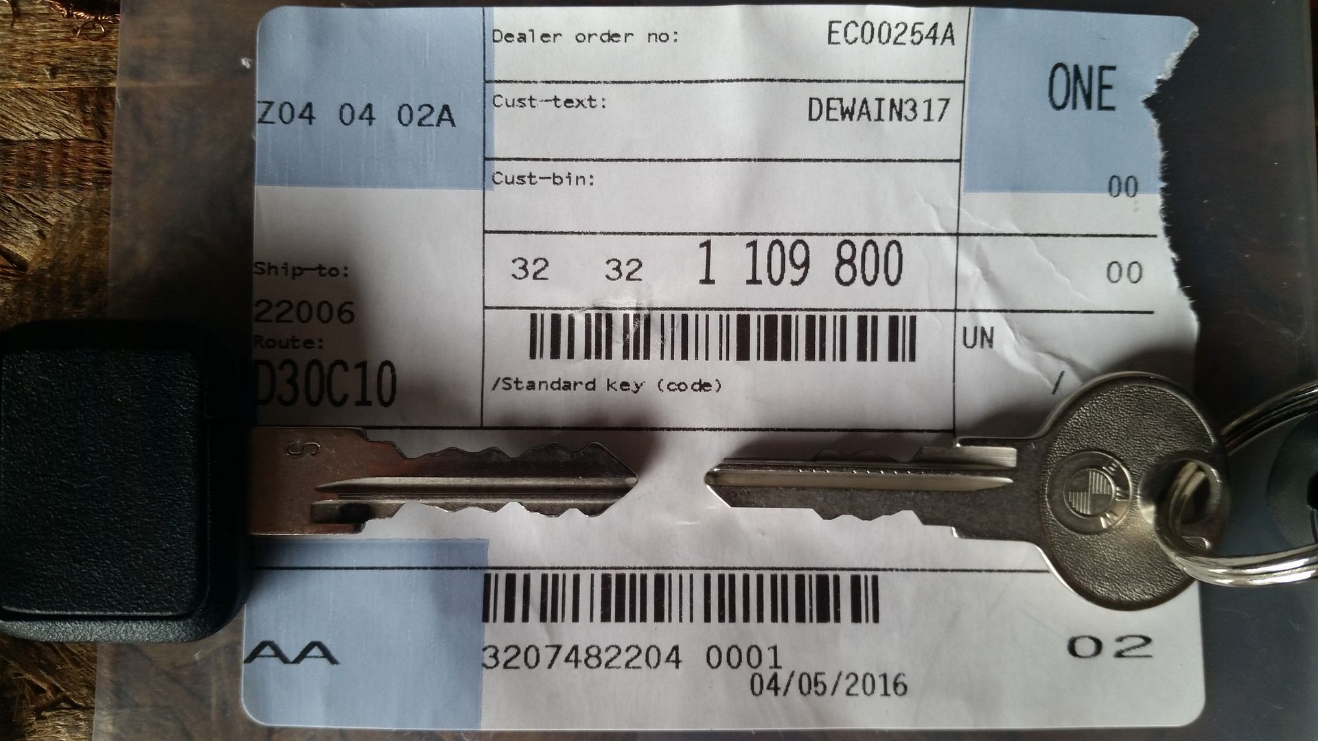

Not much to report. My only news was that I finally (after 2 months) picked up my spare key for the e30 (as well as one for the e36). The E36 key looked fine but the e30 looked off. I argued with the parts guys but they insisted it was wrong.
Valet key...brilliant move, BMW.
I'll post the info on how to order the correct key but after several calls the replacement key is on the way to the dealership. Now I just have to find time to make the trip to pick it up.
That is definitely a valet key, not a master key. the "Standard Key" is a valet key.
check out my E30 OEM Key OCD Thread for more info (link in sig)I BUY/SELL REFURBISHED CM5907s & CM5908s
