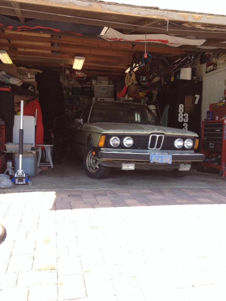

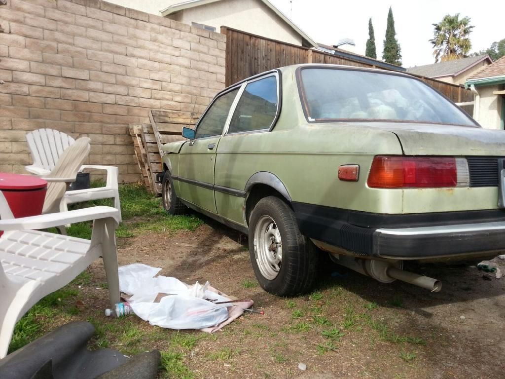

    Parked at my buddies house

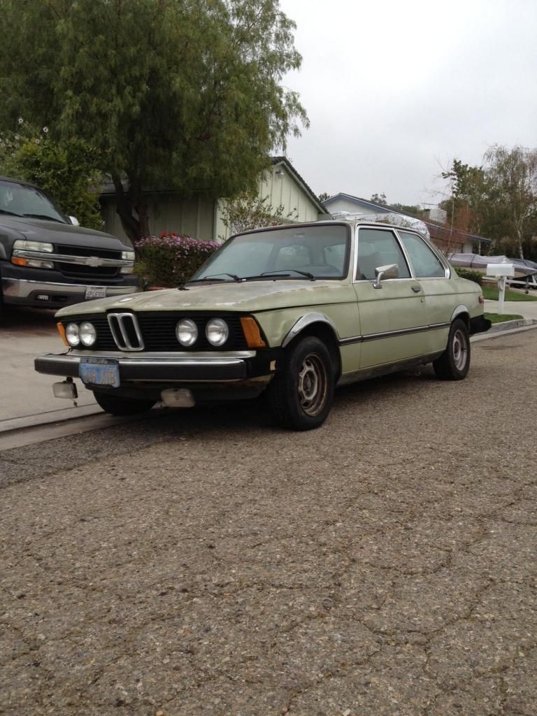

    Here it is after the night I towed it home. Covered in 7 years of dirt and spiders. With original wheels and original 70s styling.

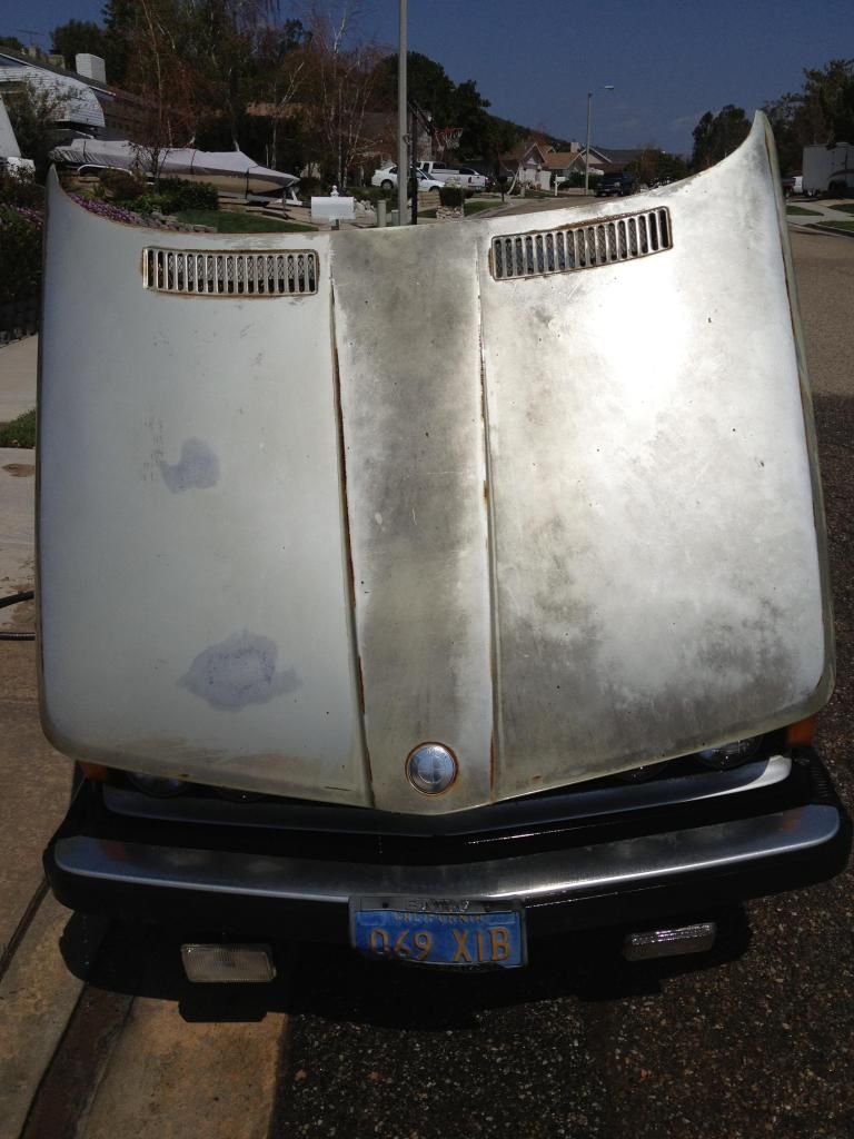

    Here is a shot of the hood after I vigorously scrubbed the thick layer of grime of the paint. Clean is on the left and dirty is center and right

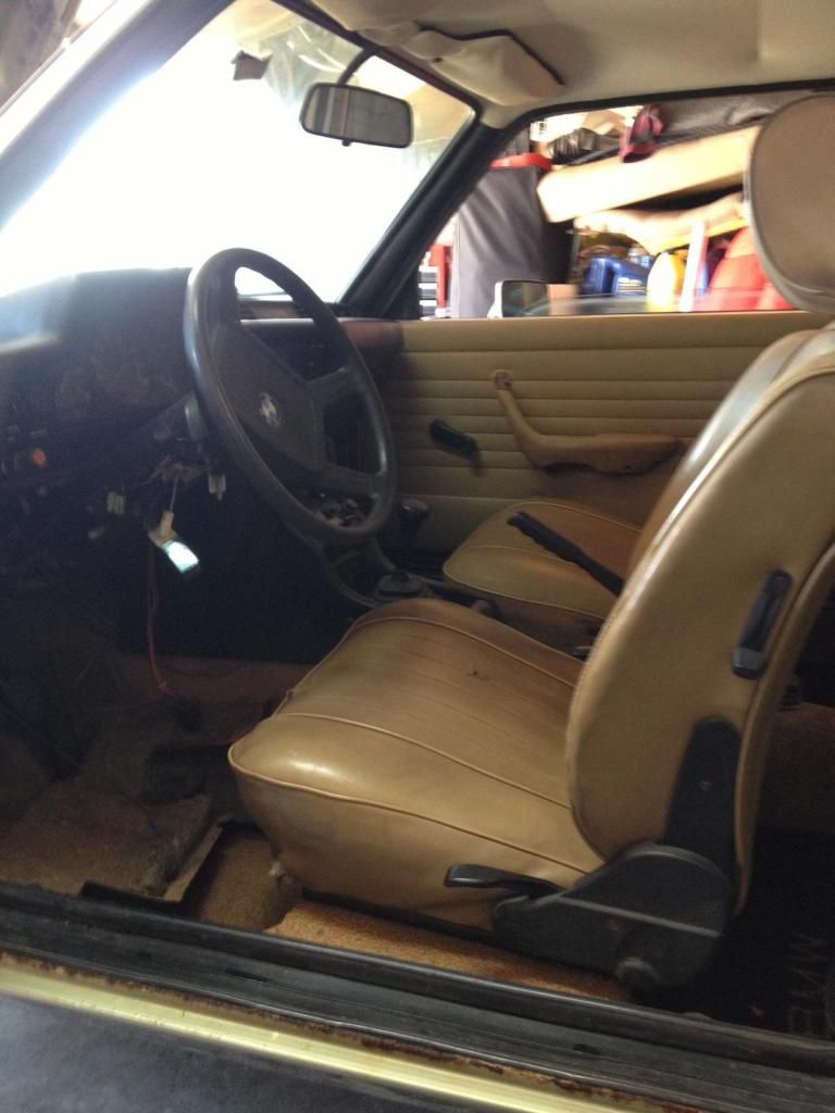

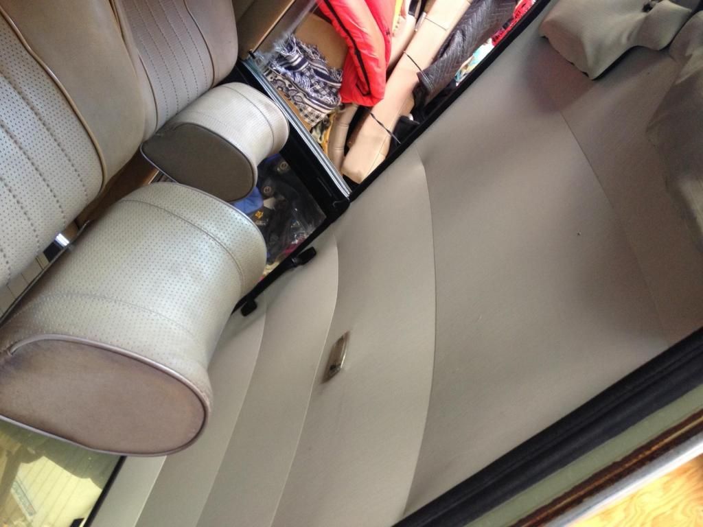

    Here is a crappy interior shot. The car is surprisingly complete and clean. Carpets are mint and the seats are decent. The headliner is pretty much perfect as well.

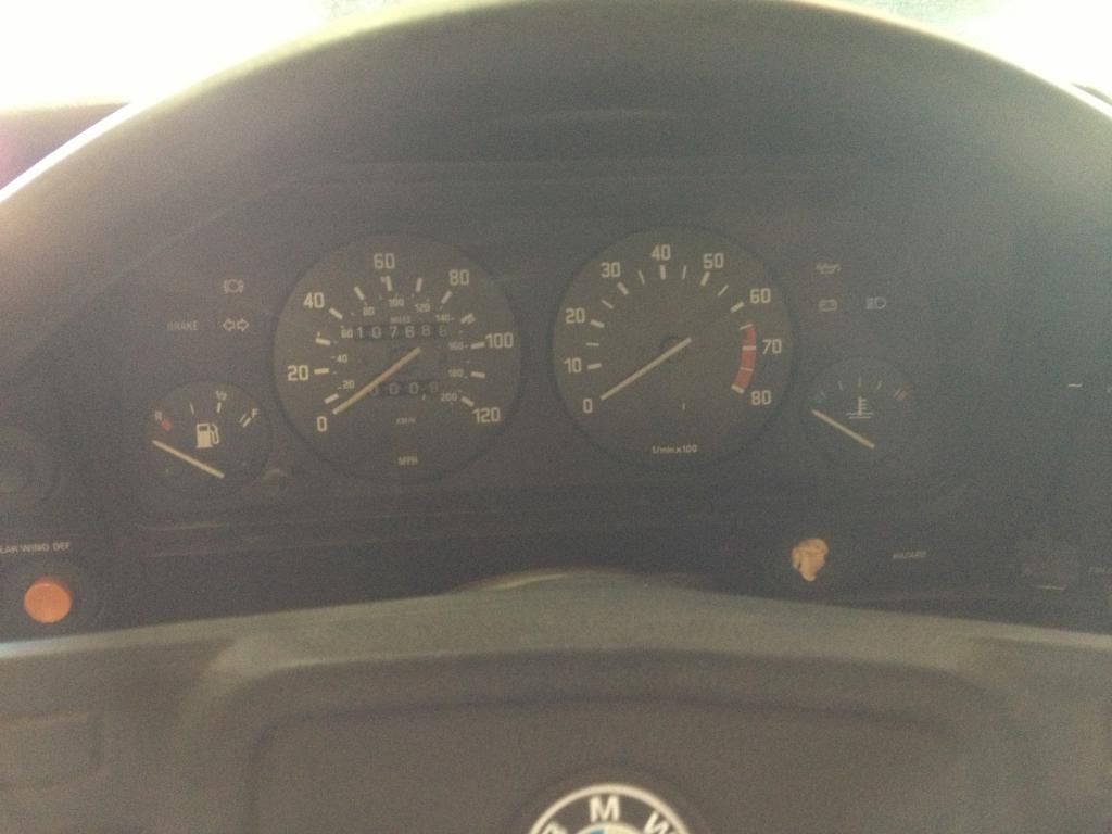

    Gauge cluster with working odometer at 107k

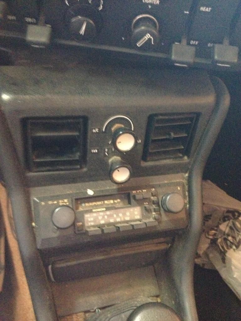

    Center console area with everything there pretty much

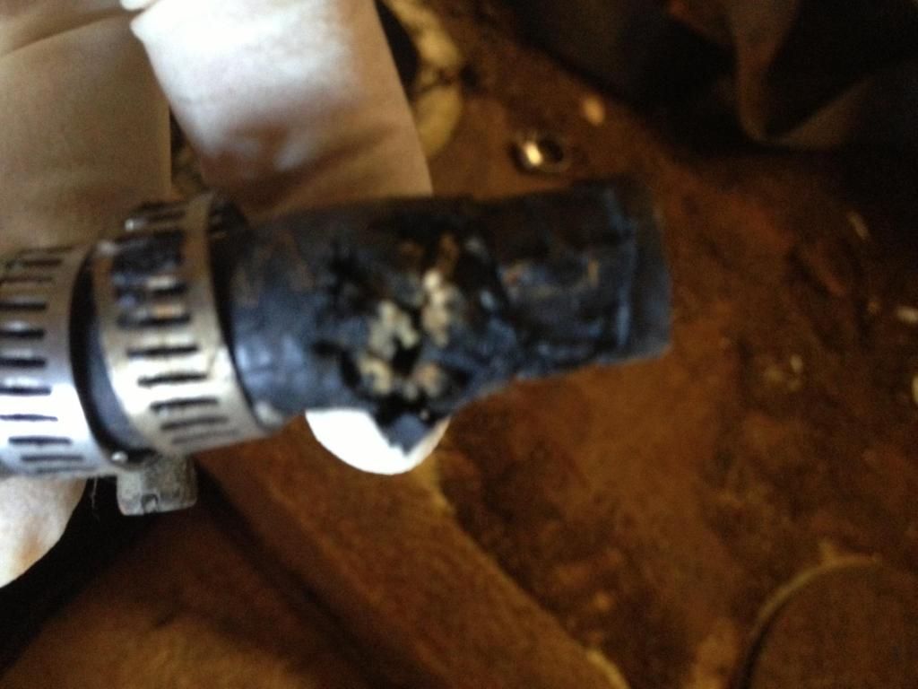

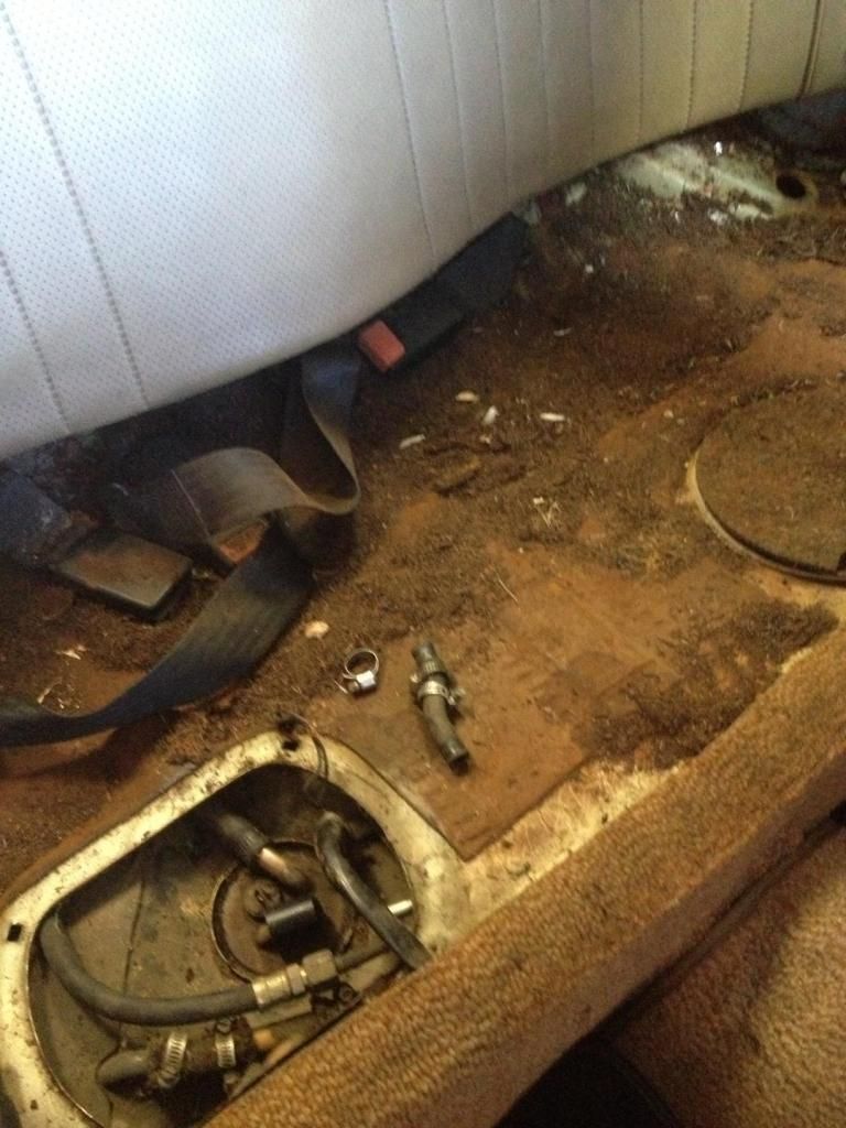

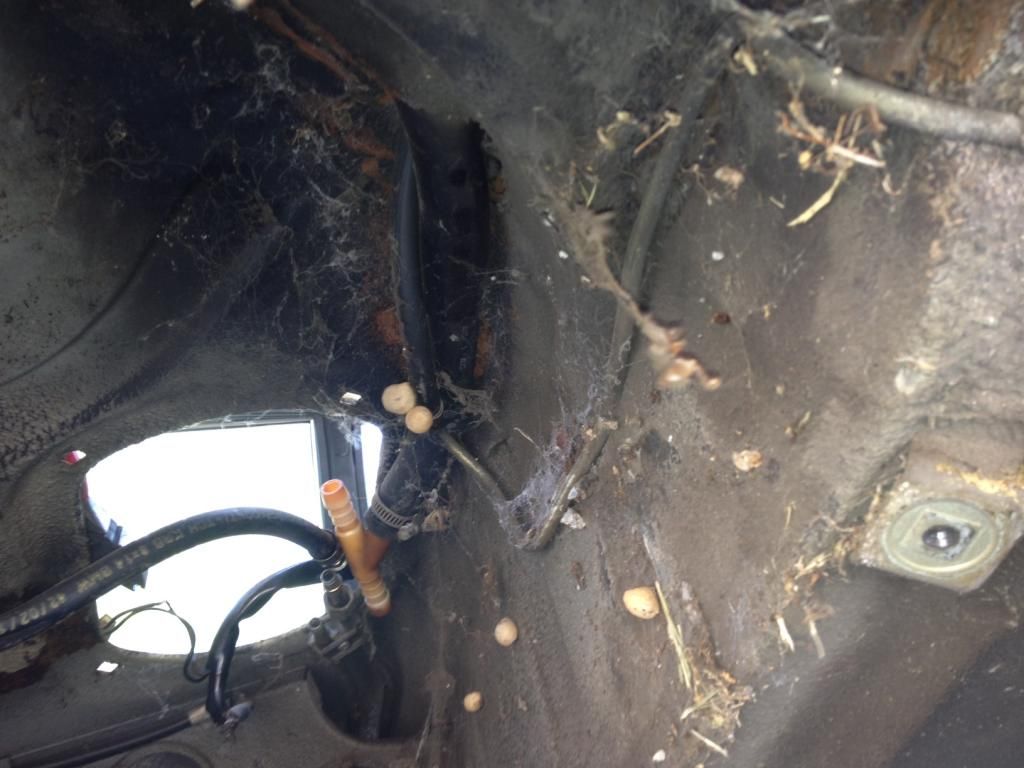

    Then we moved onto fuel and since it seemed we weren't getting any it appeared to be our issue. We pull up the back seat to find this:
    Pretty gross, but im guessing that ruptured fuel line may have been the reason the car was originally parked. And im + $1.18 on the whole car

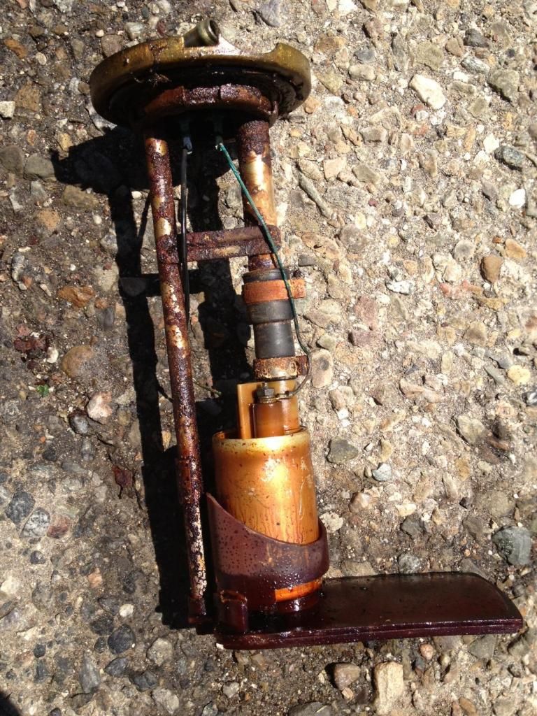

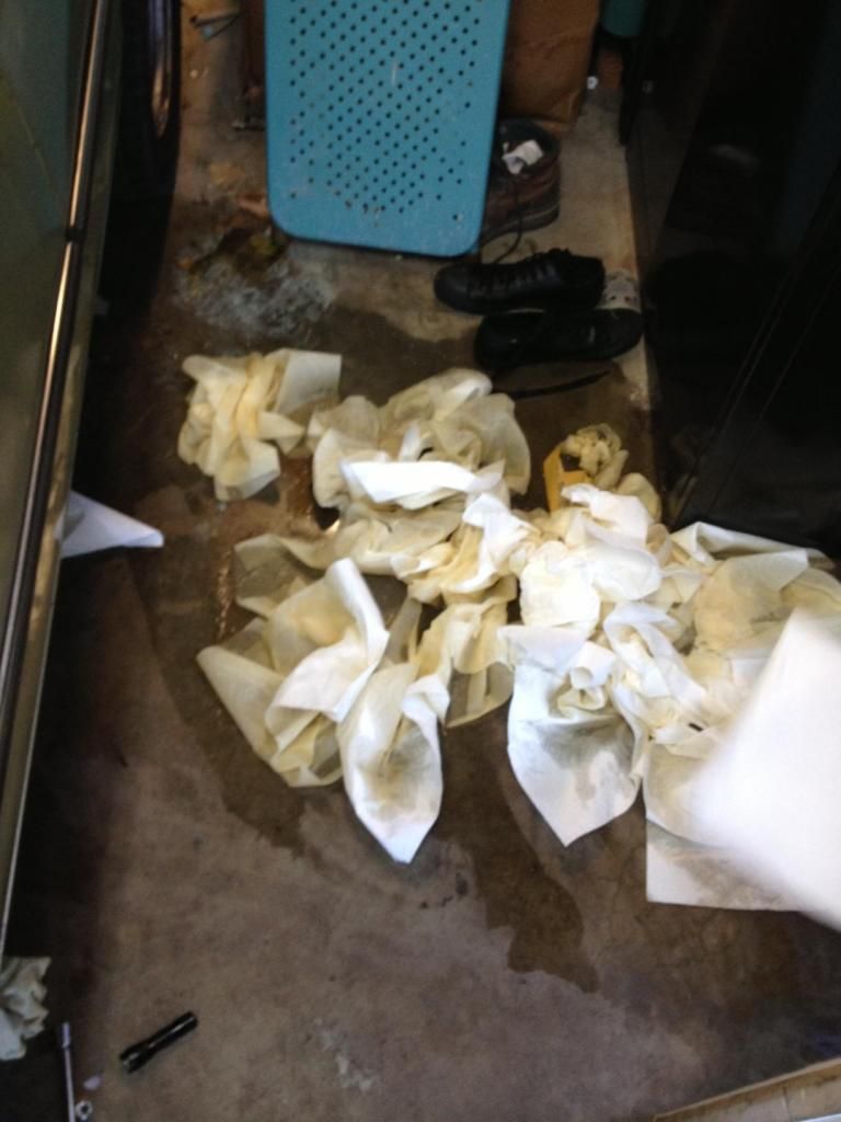

    We then checked for power at the in tank transfer pump and the external pump and were getting 12v but the pumps weren't turning on. So we pull them to find a rusted out tank and seized pumps. Predictable. Gotta drop the tank now. So, today I had a chance to drain the tanks, which turned into a nightmare when I underestimated the amount of disgusting varnished fuel in the tank. My catch can overflowed about 2 gallons of gas onto my garage floor and halted all progress for the night in favor of a 3 hour clean up job.
    this picture does not do justice to how much damn gas was on the floor. This was after about 30 minutes of cleanup.

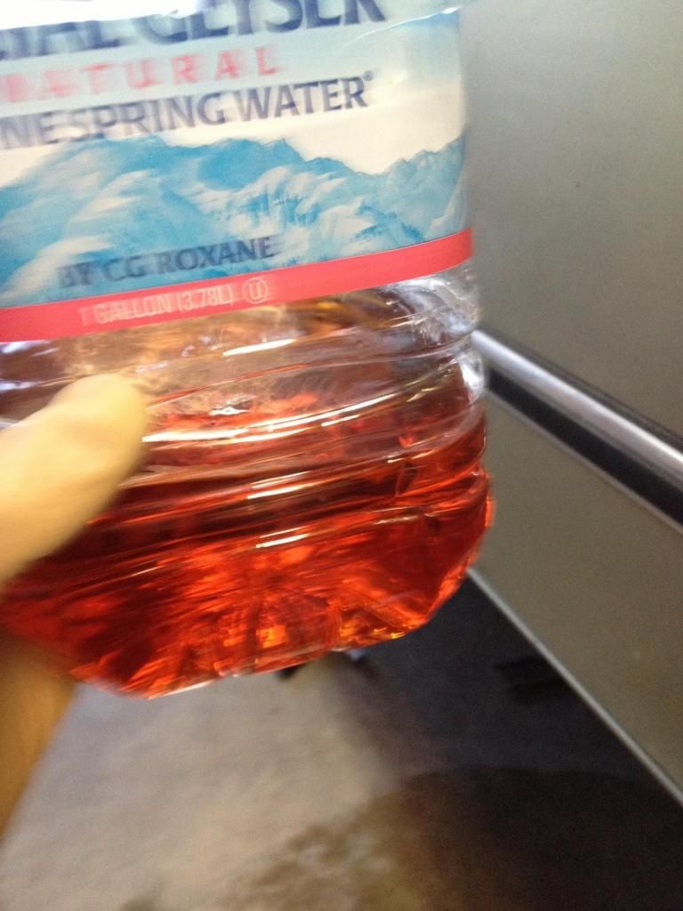

    Here's a pic of the gas that came out. YUM
    Not super silty, but still nasty.

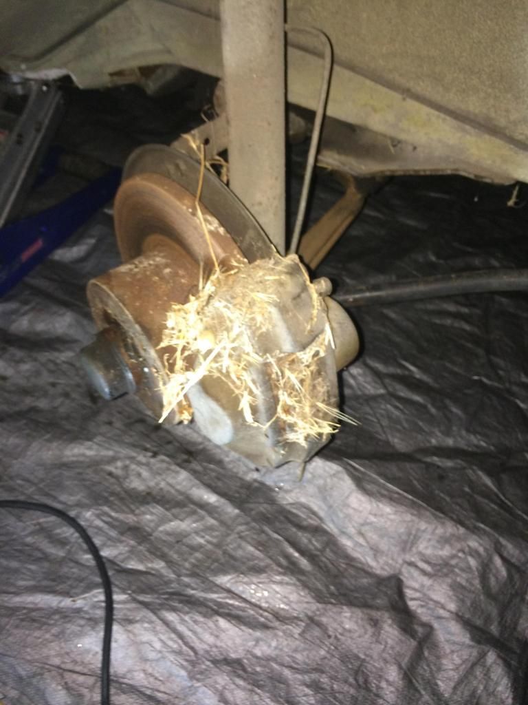

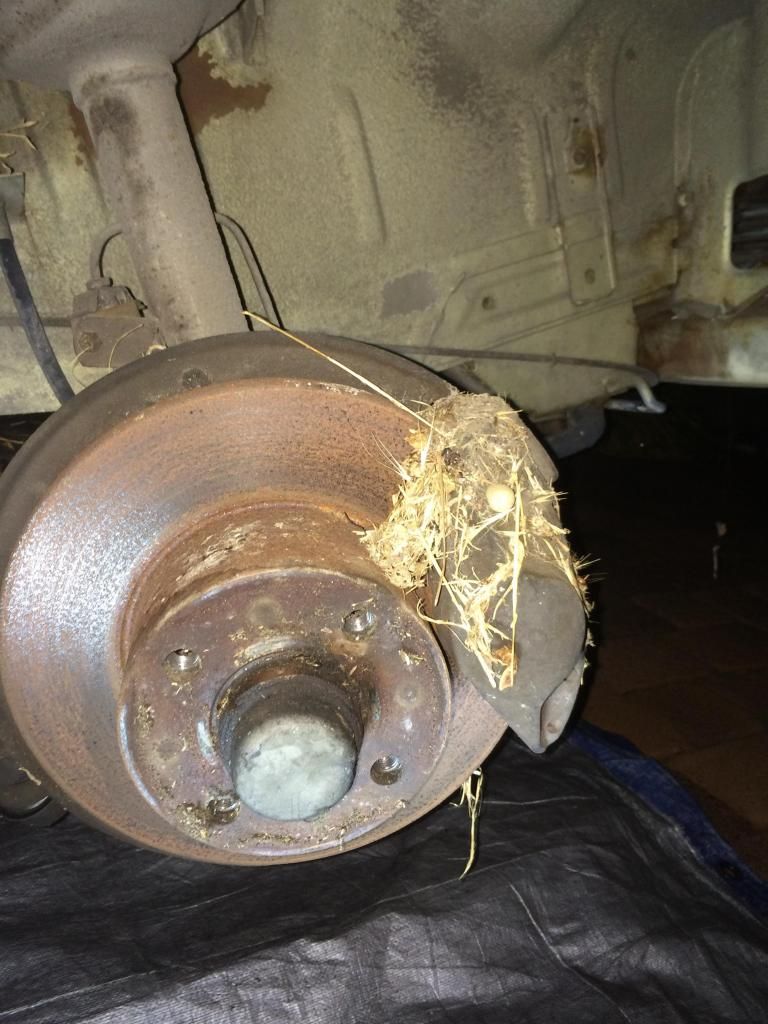

    Then we pushed the car out and cleaned the whole garage floor, and while it was outside I pulled off the wheel to find this:
    Pretty sweet little nest/ black widow eggsack depository on the brake calipers, also fairly nice rotors that appear to be almost new. Yay free car.

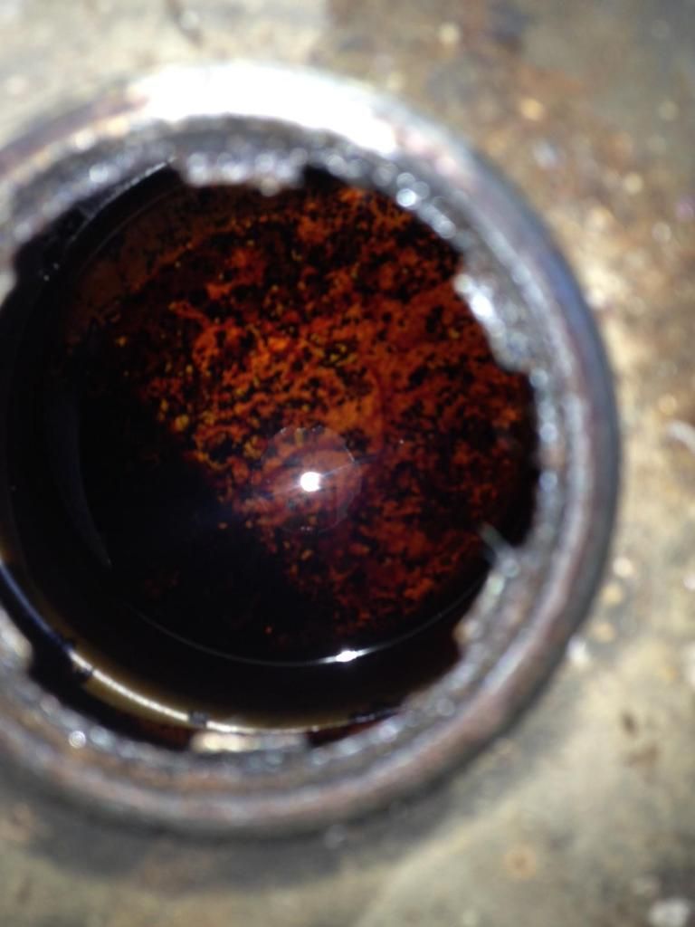

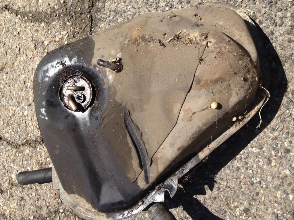

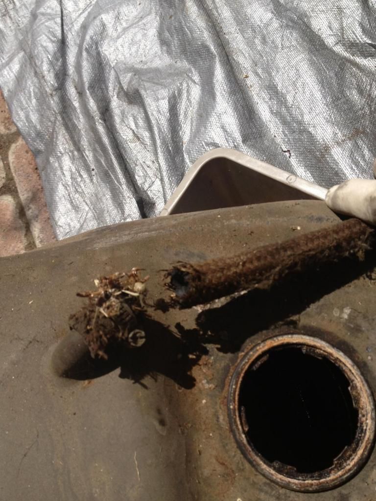

      Here is what we are dealing with rust wise, in the tank
      Here is the in tank transfer pump. Looks great ;D

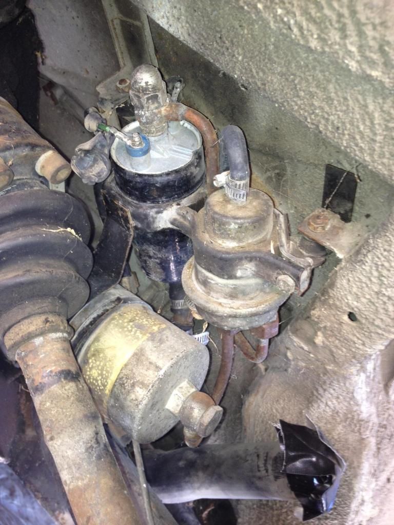

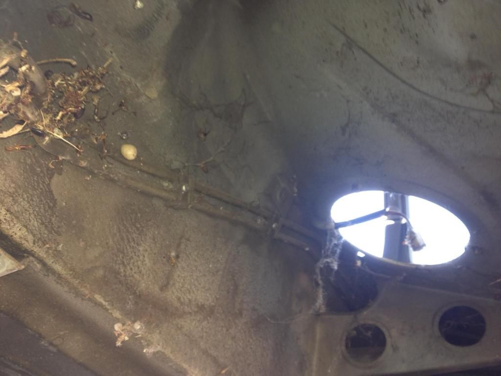

      Here is the externally mounted mess of a fuel pump area on the e21.
      Fast forward five minutes and....
      First half of the tank is out. I'm getting nervous because all im finding is black widow webs, eggs, and dead carcasses of the males and I have yet to find one widow....

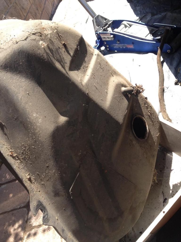

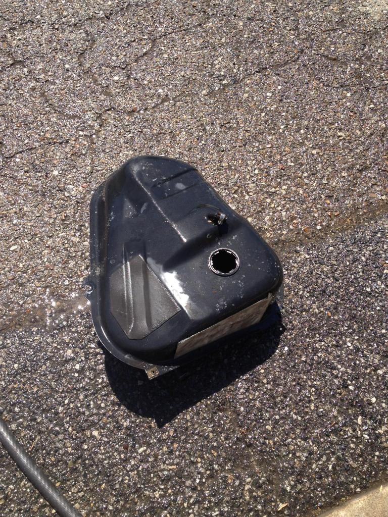

      Here is the tank after putting it in the street
      Another 5 minutes.... Another tank
      COOOOOOOOOLLLLLLLLLL
      So I hosed them out and 100s of dime-quarter sized flakes of rust came out of each tank. Tomorrow I will try and de-rust more completely with vinegar while agitating with some small rocks. I'm not super hopeful but we will see what happens.

                          go to home depot and get a few gallons on muriatic acid. it will eat the rust to nothing and in just a few minutes. rinse with water and then acetone and then use the gas tank liner called red-kote. oreillys carries it locally here. cheaper than anything else. i switched to a single tank unit with screen on my e30. if interested i can get part number for a cheaper option and more reliable.
                          if you use red kote, then you need to let it dry to no smell. heat does nothing to speed it up imo. i used a fan pointed in the pump hole. that seemed to get it good. it took a few days to dry. i suggest cutting it with acetone to help spread it easier and dry time a lot better.
