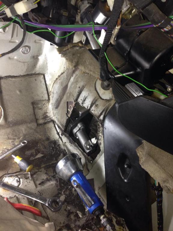

        it's been awhile but i haven't been slacking off, actually working my arse off to get this thing done as it's so close to being finished now!
        Had to modify the tunnel to fit this cable to hyd clutch conversion on the tremec.

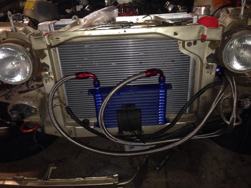

        Oil cooler relocation kit done!
