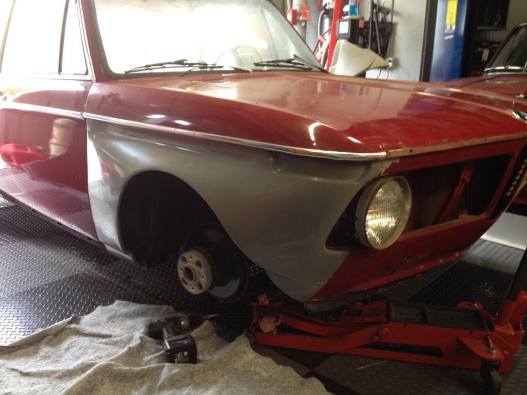

    Here is how it all started:
    2002 seen with original owner in the background!
    I put her in the barn for a year, and just pulled the 2002 out this week.
    My dog Hurley overseeing the tow.
    Towed the car up to be washed off briefly before going under the knife in the garage.
    Garaged.
    Shot of the engine bay and that lovely M10!
    Finally, what’s in store sitting next to the 2002 in the garage. Thanks again Ryan for providing the engine and accessories to make this S14 swap possible.
    I’ll post up some shots of the wheels soon. I haven’t had time to mock them up on the car and figure out what tires sizes will be possible. I guess that will depend on the flare size and suspension set up though.
    I am hoping to get the S14 transplanted in the next few days and begin to tackle the wiring job soon, Ill be following the Aardvark Racing swap manual closely to accomplish this.
    Stay tuned from some M2 fun!

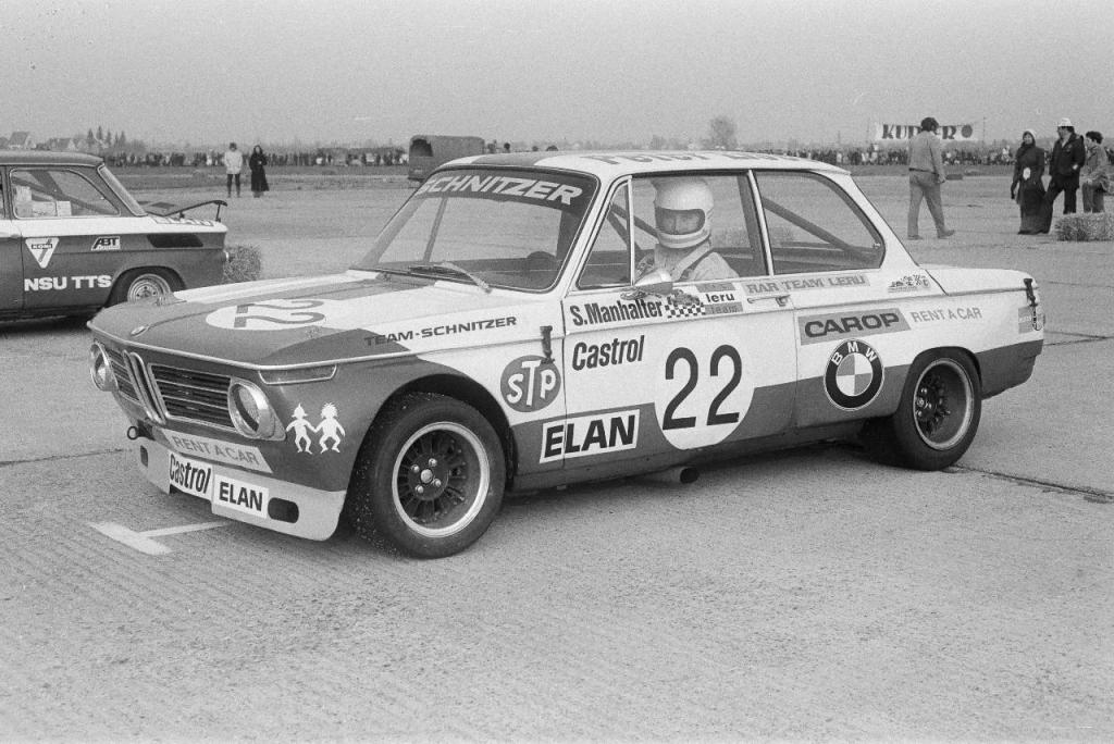

                      I can offer advice on flares.
                      some flare porn:
                      • Lodsin
                        • Sep 2006
                        • 734
                        Originally posted by JRKOUPE
                        good luck w/ her....sweet
                        some flare porn:
                        I saw OP mentioned Alpina fender flares, so I googled just that. Not knowing much about 02's, is this alpina flare a whole fender? No hack and slash? I got a lot of pictures for googling alpina fender flare lol, but your pictures confirm what had assumed were them. Why dont e30's have flares like this?
                        • oliver.r
                          • Mar 2012
                          • 3839
                          nice!
                          i want to check this out since youre local
                          • oliver.r
                            • Mar 2012
                            • 3839
                            they replace the whole fender they're commonly refereed to as "pig cheeks"
