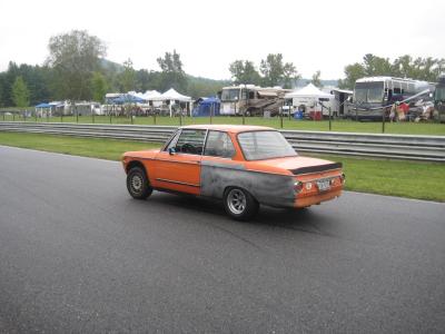

      the Inka pig is mine....an ongoing resto mod...
