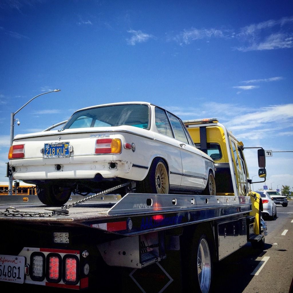

Guys, heres the update on the 02. I sent it over to CATuned to be finished. They're checking the wiring, making the harness permanent and cleaning it up, finishing the battery install, checking the fuel system and adding a new fuel pump, and rolling the fenders. Here are the pics from when the Bucket left my possession:
