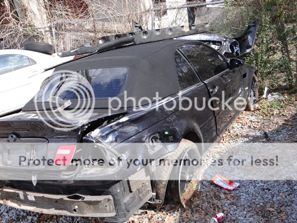

    here is a little back ground on how this came to be. I have been a life long fan boy of BMW's, I have owned 7 e30's, 1 e36, 2 e39's and a e46. Prior to mutsie I had a e46 m3, the car was my life. it was by far my favorite car I have ever owned. One night I was enjoying a spirited drive on back country windy road, I came around a turn and seen a SUV (coming in the opposite direction) start drifting into my lain. so I flashed my lights and then laid on the horn. none of my attempts to get their attention worked, I was forced to scoot as far over to my right as possible, well there was no should and only about 3 inches of grass before a ditch. my tires caught the ditch and it pulled the car, I went through a telephone pole at 74 mph(speedo was stuck there). luckily I walked away with out a scratch, unfortunately my car was totaled. here a few before and after

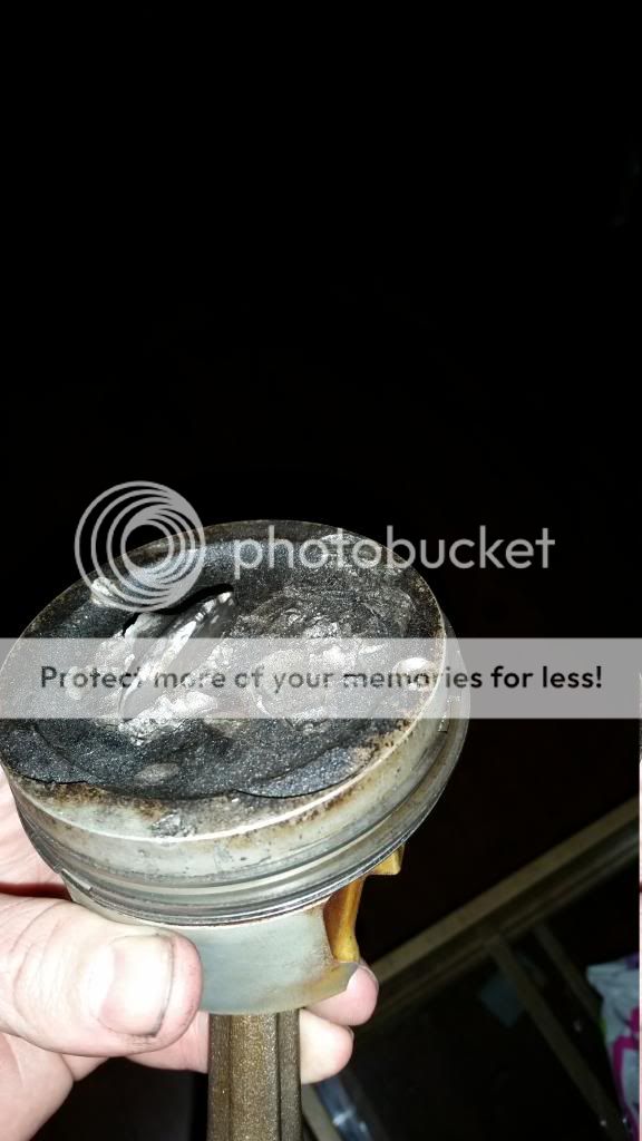

    I purchased a e39 and loved it. I loved it so much that I bought another one and made one nice one (still needs paint though). I then purchased a e30 from a friend who was starting to do a turbo s52 swap. I was going to finish what he started. that was until I noticed this
