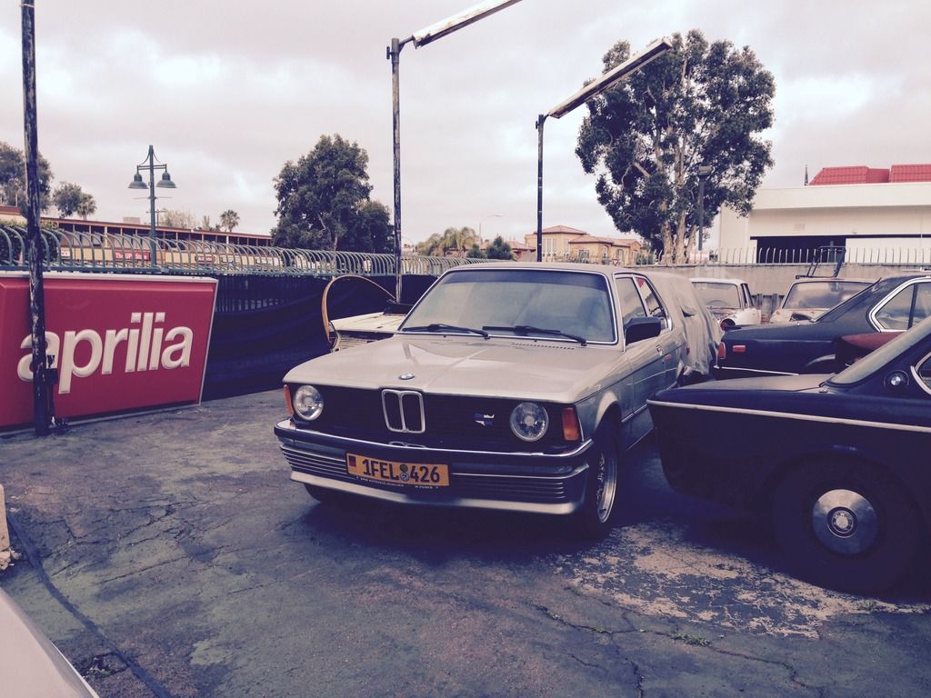

        E21 project
        Thanks! The cars in the showroom are not mine, most of them belong to my buddy, a few belong to his other friends. If you like the 700 sport in the showroom you would probably like the 700 cabriolet in the yard (behind my car to the left). There is also a 700 sedan in the back by the fence
