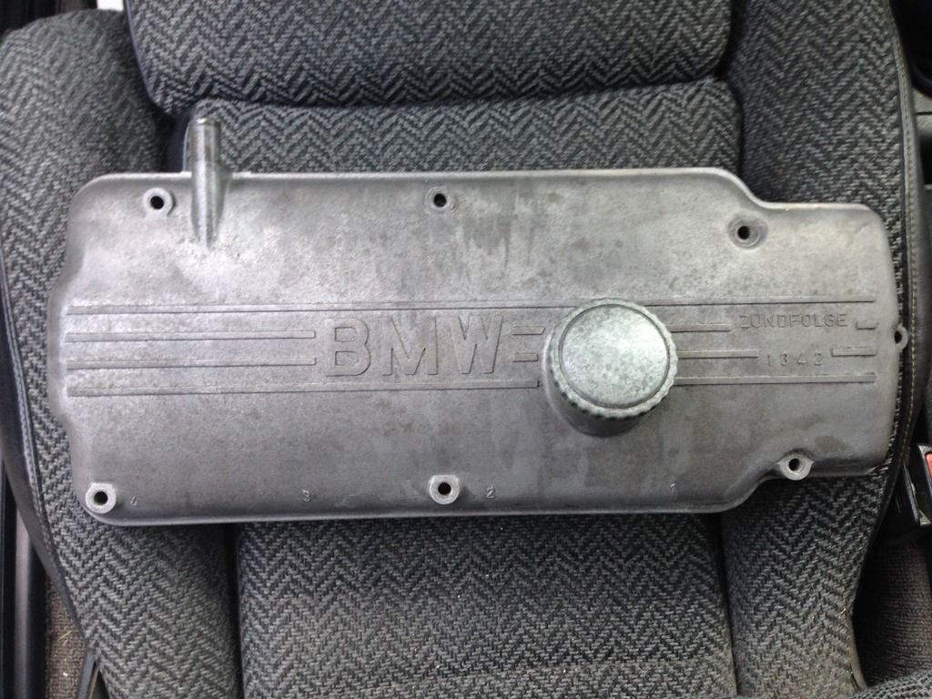

            early cover

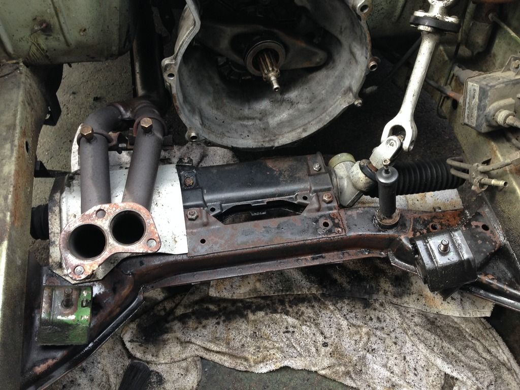

                                Test fit... need to modify the headers. There is no way they will work if the 2.25" tube sits right under the trans drain plug
