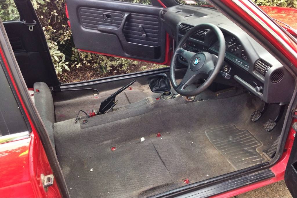

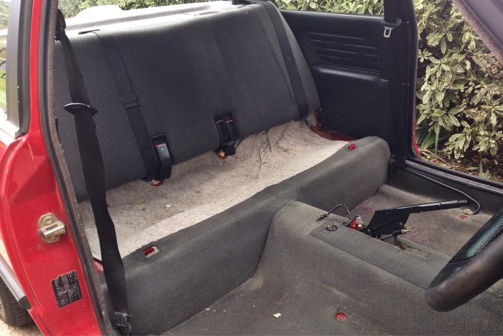

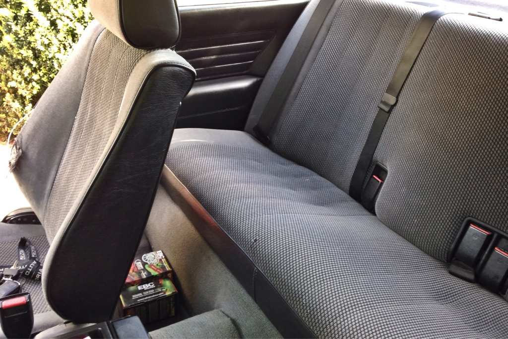

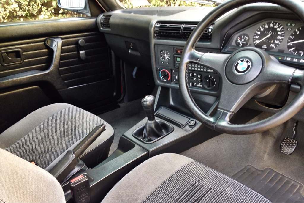

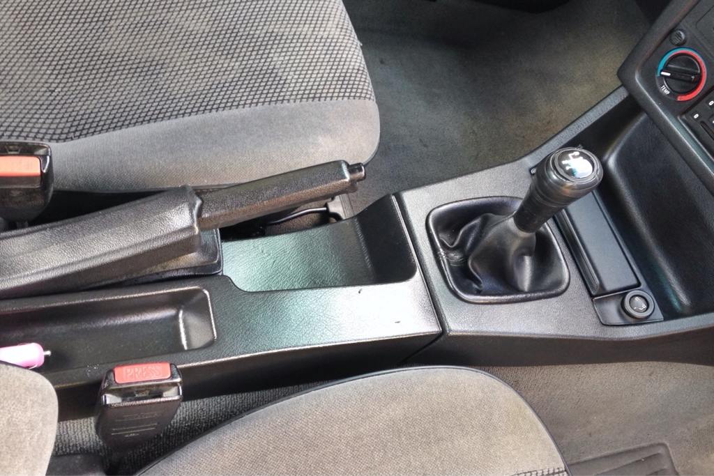

            Few updates.
            Pulled all the interior out and have it a good clean. Came up better than expecting so that's a positive.

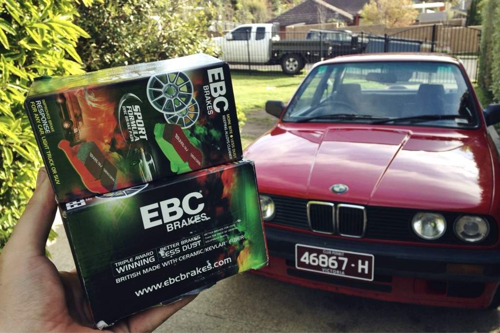

              Bought a few goodies for the thirty
              Ebc green stuff front and rear pads, now just need rotors but undecided what I want at this point.

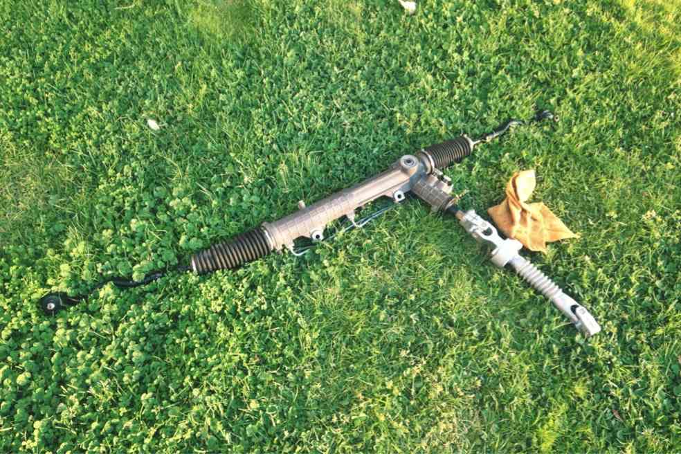

              E36 328i steering rack, now to sort out linkages

                      Get a Barina steering column link, they work perfect
                      We're out there in here.
                      • Byrnnn
                        • Apr 2013
                        • 34
                        Any more details. Or model and years.
                        Have you got any photos?
                        • Hooffenstein HD
                          • Nov 2012
                          • 1388
                          XC model Barina, or RHD Vauxhall Corsa C. Can be picked up off ebay.co.uk relatively cheap if you can't find one at your local wreckers.
