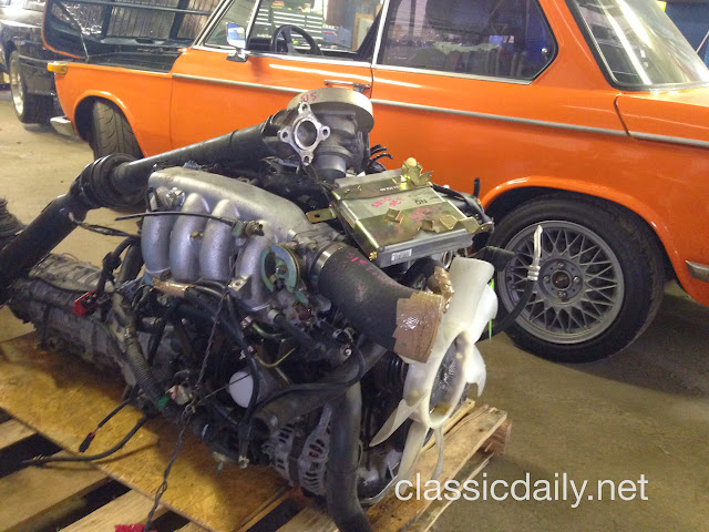

    This is a unique one to say the least. The customer wanted a fast fun 2002 that would put a huge smile on his face every time he drove it. The car came with a rebuilt m10 but he wanted efi and a turbo...A Nissan S15 SR20det was picked to check those boxes.
    So here we go.
    Unwrapping with it's new home in the background.
    First test fit of the engine and a lot of things are in the way....booster, master cylinder, pedal box, steering box and linkage, etc etc....so things will have to move.
