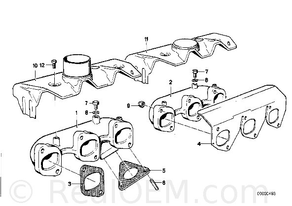

              I need some advice on the exhaust gaskets (or lack thereof). RealOEM gives 2 pictures of exhaust manifolds for the 745i. One is obviousely correct and lists no exhaust gaskets, aside from the rings that are set in to the manifold, #15 p/n 11621706800
              The other picture listed is clearly not the correct manifold, but it does list a gasket for #3, p/n 11621723851
              Should I use an actual exhaust gasket? I could reuse the standard m30 gaskets and heat shields, but will that cause a problem? I'm totally confused

                Hmmm may have to ask my friend with running m106 what he did
