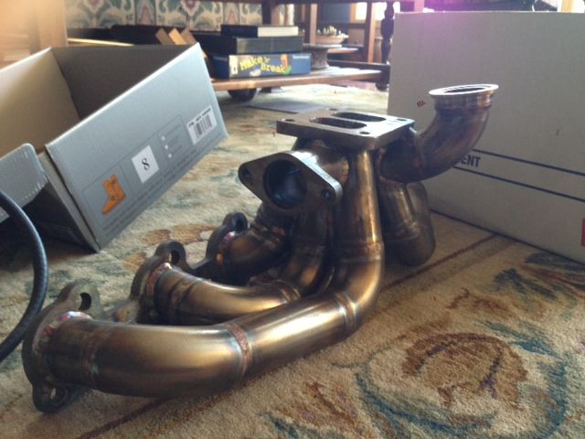

After that I aquired this bad boy from Brandon's (F34R's) group buy that never took off so I think I have the only one.
It is a divided T4 flange with twin 38mm wastegate flanges. I regret making one a two-bolt: I had a spare at the time but have since used it elsewhere and have two MVS v-band wastegates as well as a Tial Q BOV.
I bought and sold countless turbos (still selling some) trying to trade my way up to the perfect turbo but have now resolved to buy a new Borg Warner S256SX divided T4 0.83 a/r unit.
