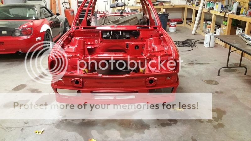

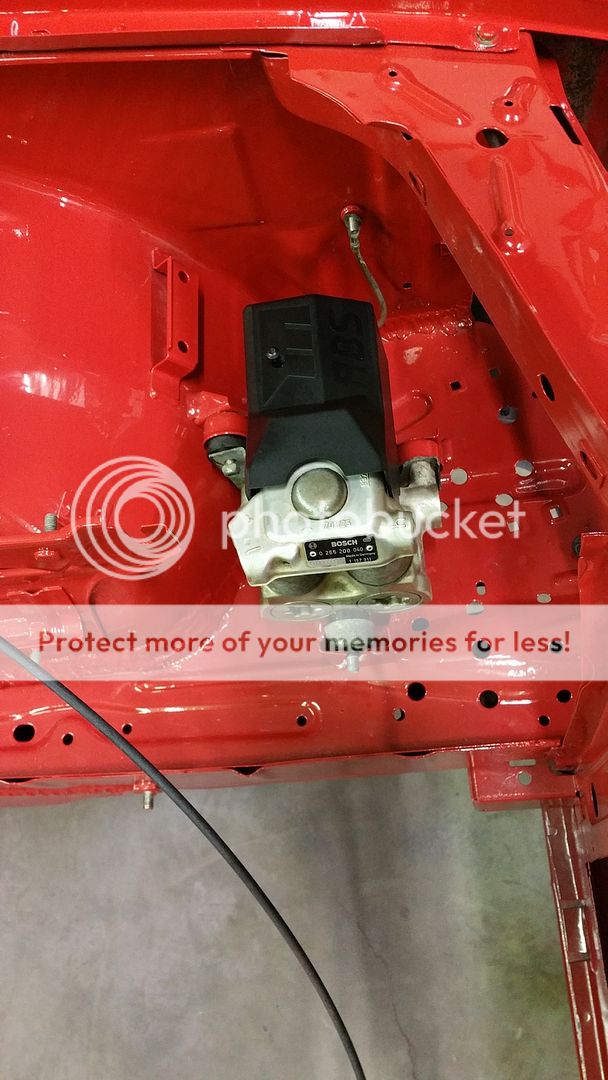

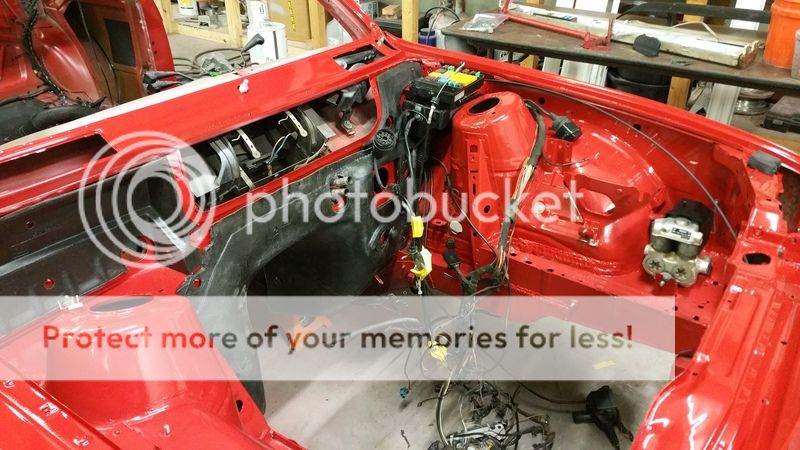

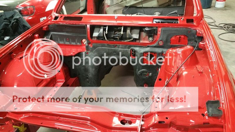

    I've always wanted a 24 valve e30, but never did it to my silver car for reasons of moving classes. So I've sourced one and I am getting everything together to slide her in, but there is no sense in painting the car and not doing the bay. I've started by removing the not used brackets and cleaning up some of the messy OEM seam sealer.
    Not shaved but better than stock.

        This was alot of work but we'll worth it. The seam sealer on the shock towers has bee removed and reapplied more neatly.

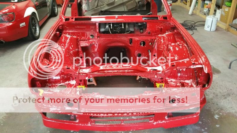

            Did alot of work this weekend, had some friends from out of town come up to help.

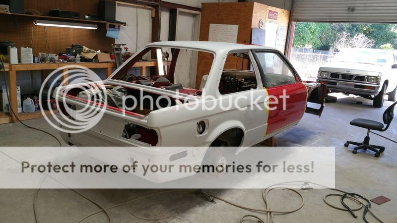

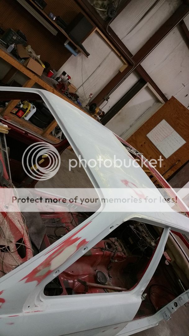

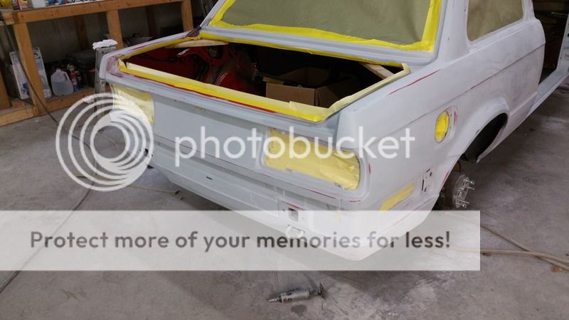

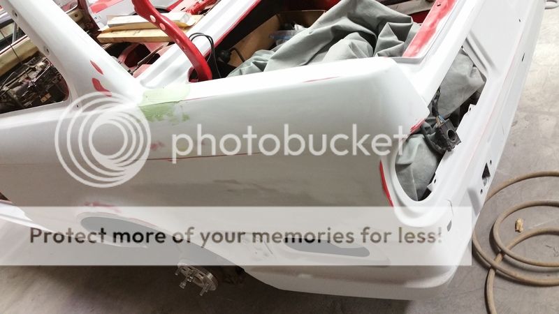

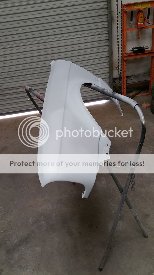

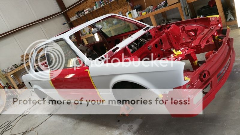

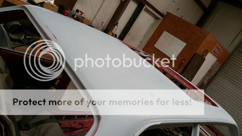

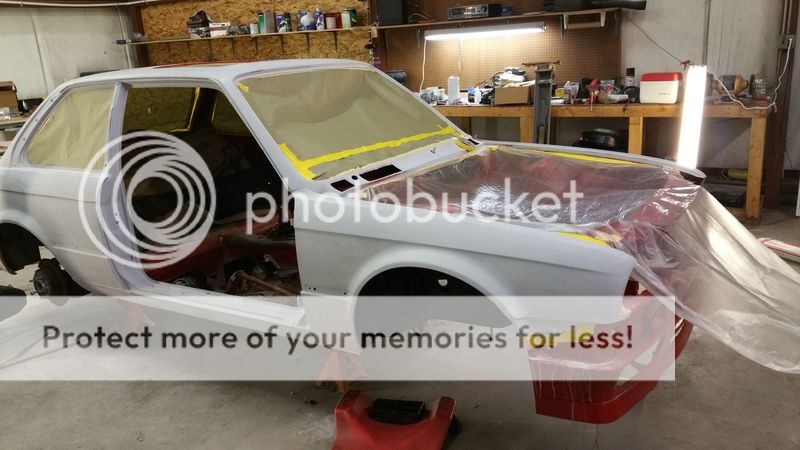

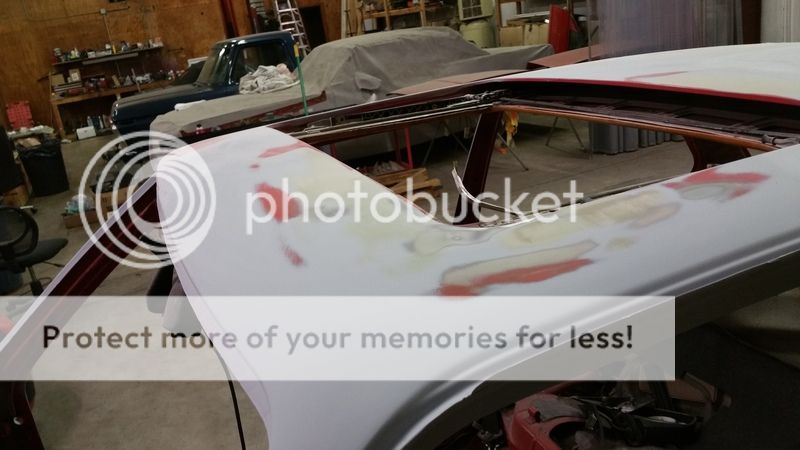

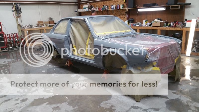

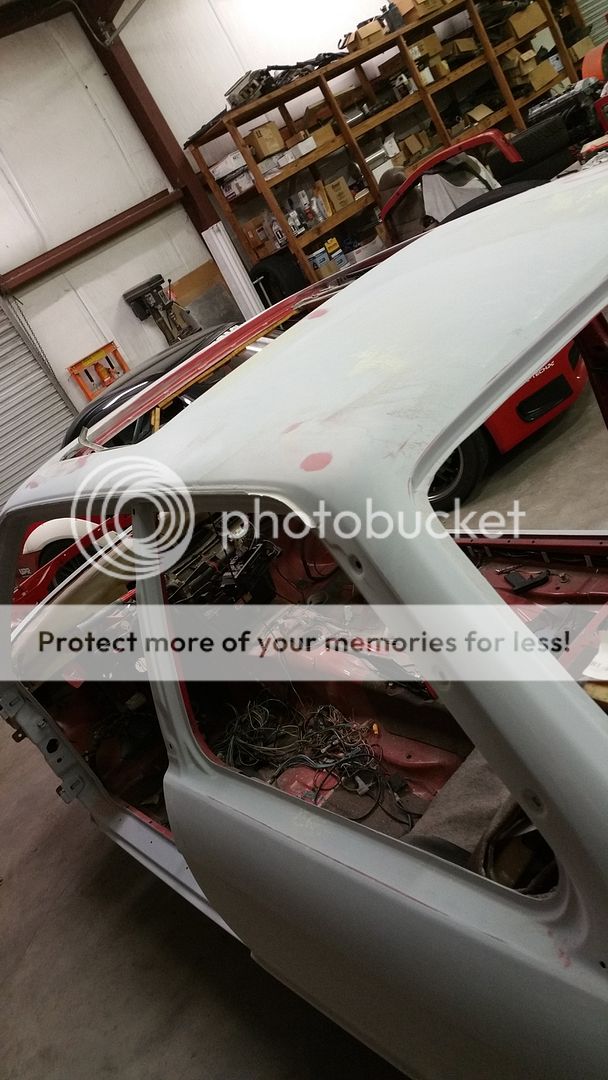

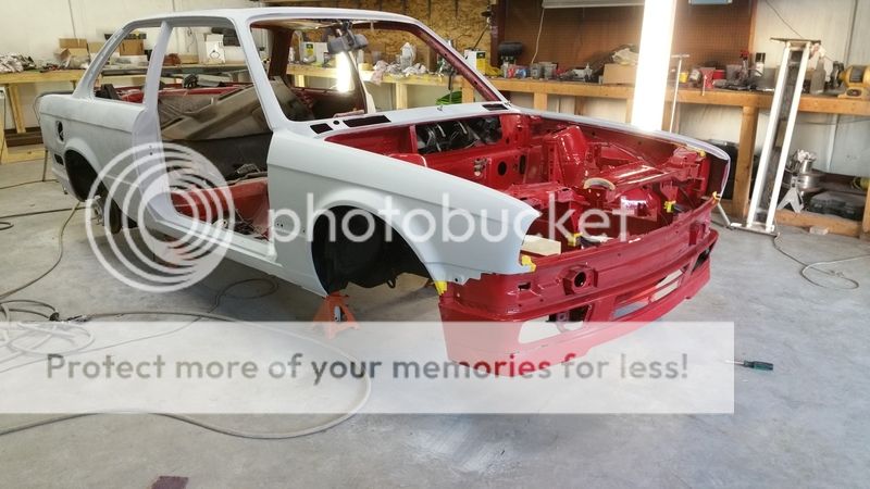

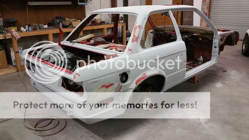

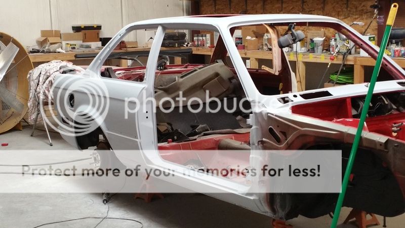

                  Sorry there have not been any posts on this in some time, but I have been working on the car. Once the car is in primer the body work will begin. Enjoy...

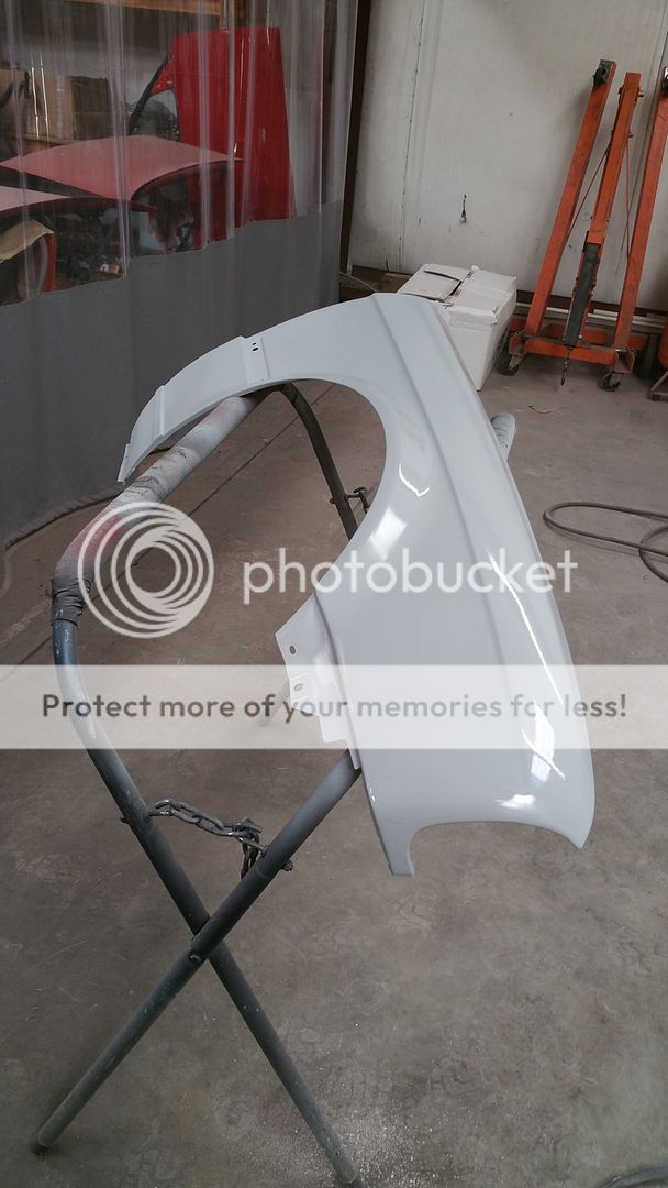

                  Prime and prime again
                  back on the car.

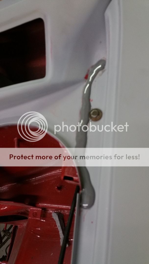

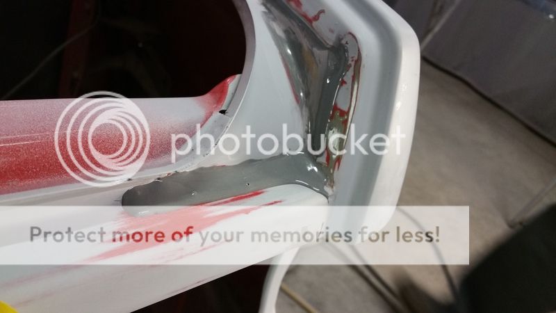

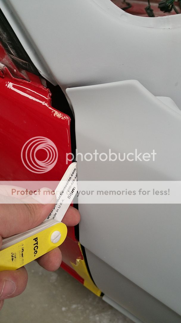

                  Doors back on to get the gaps perfect. Looks like one of the doors was off from the factory.

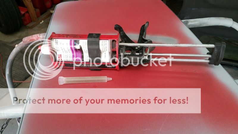

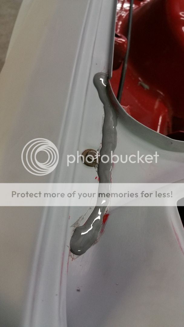

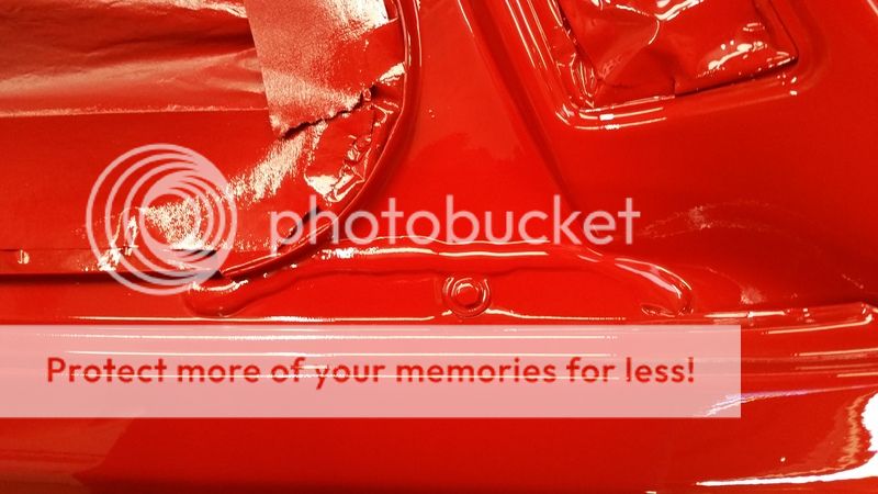

                  Now to replicate the factory seam sealer.
                  and in the trunk opening.

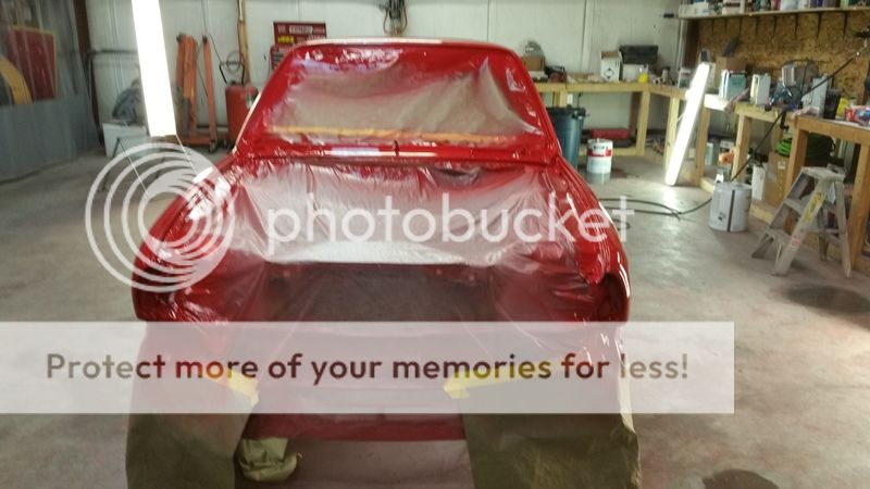

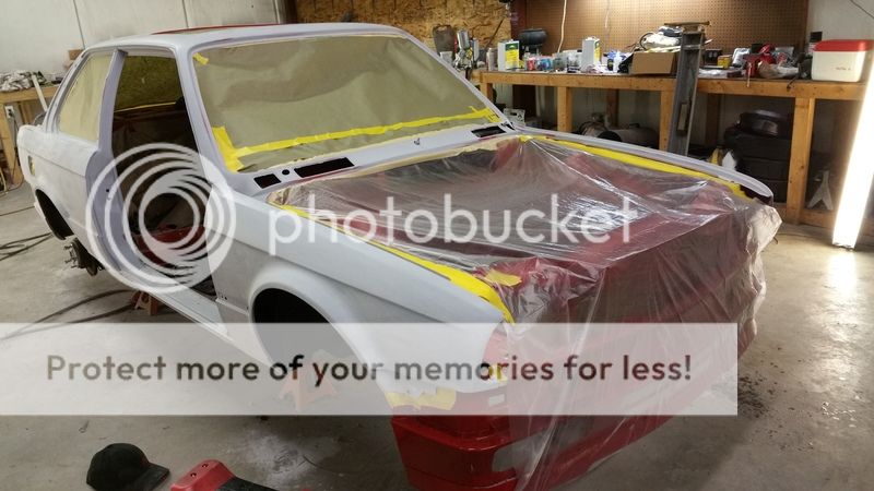

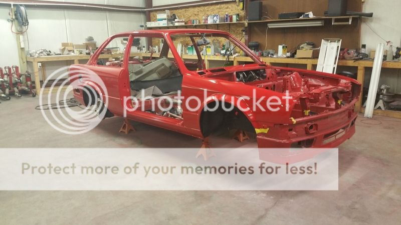

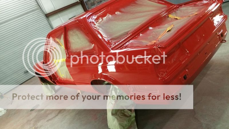

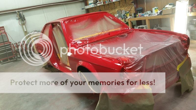

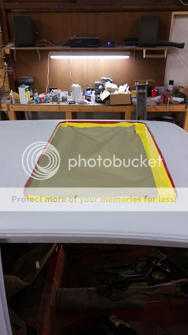

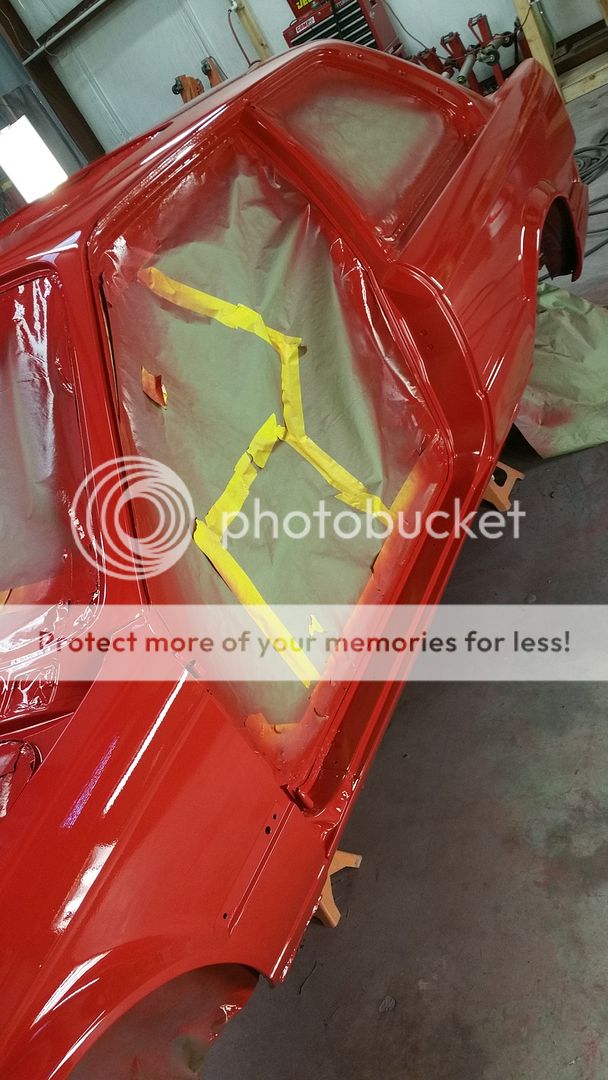

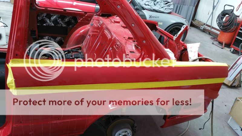

                  All of the body work is complete... start masking
                  And it begins...
                  sealer down
                  http://i510.photobucket.com/albums/s349/e30bulldog/20151015_121714_zpsxldnul95.jpg[/IMG]

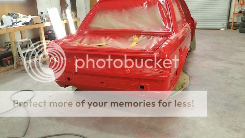

                  now base.
                  I love not having a booth, gotta get the trash out before the clear.

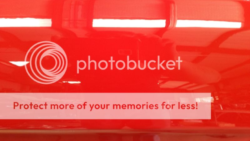

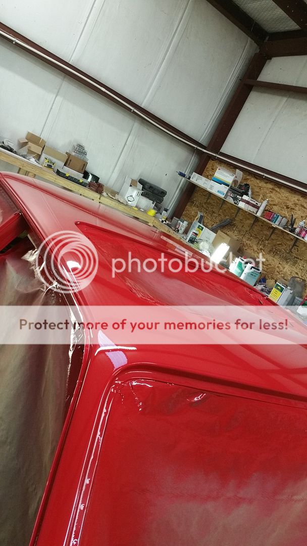

                  Now for the best part.
                  Now we play the waiting game, 1 month before I can cut and buff.

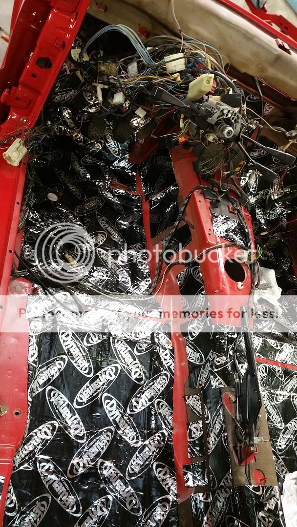

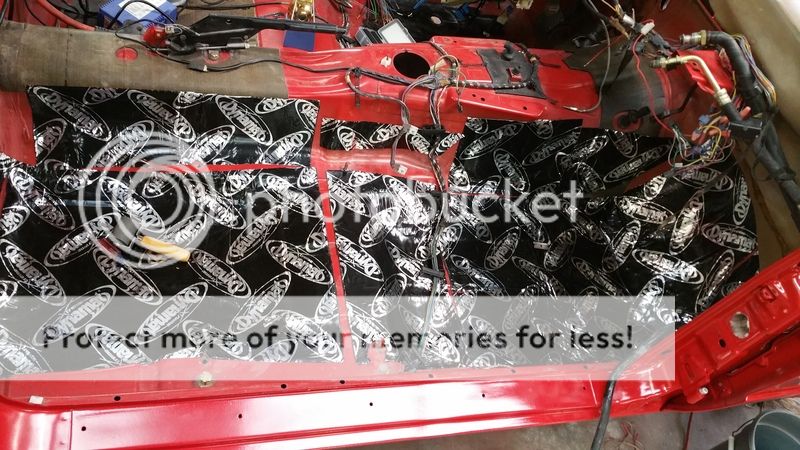

                  Dynamat!!
                  brand new anthracite carpet from BMW

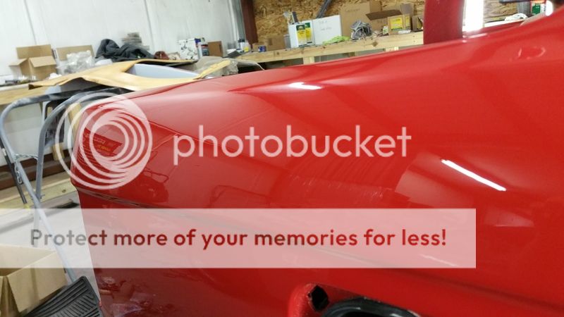

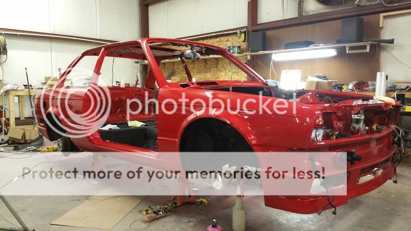

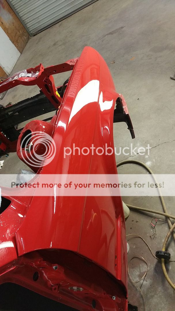

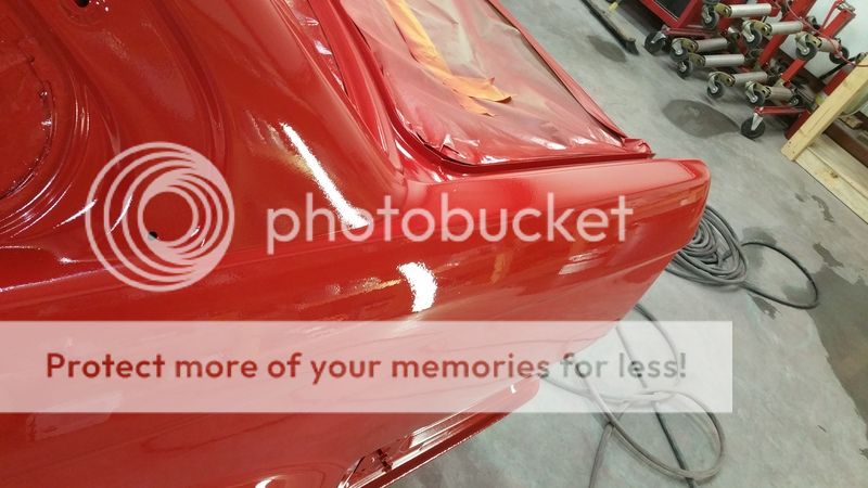

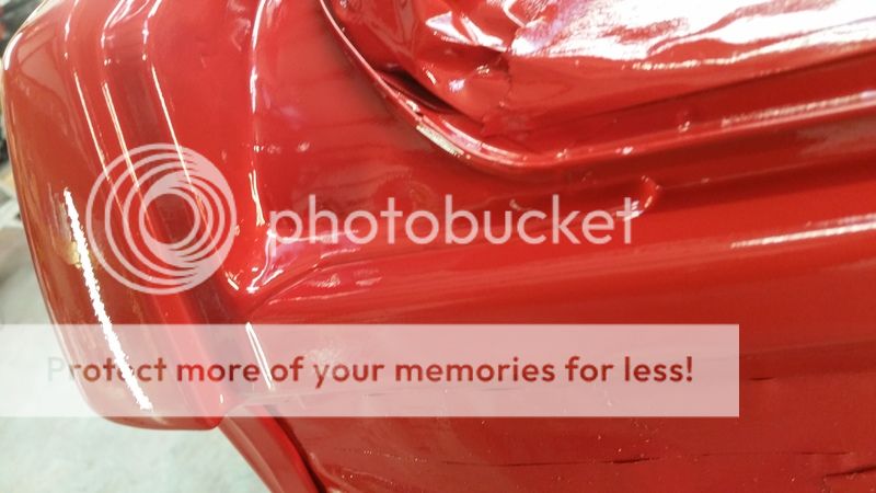

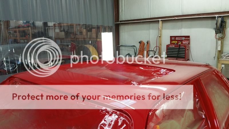

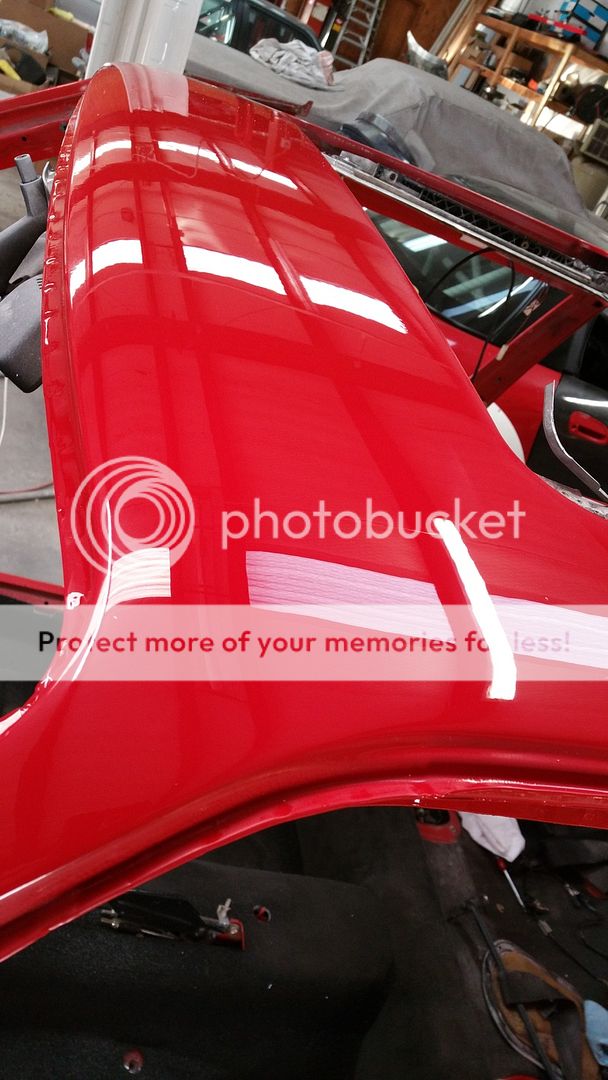

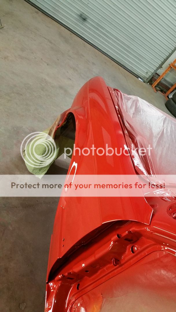

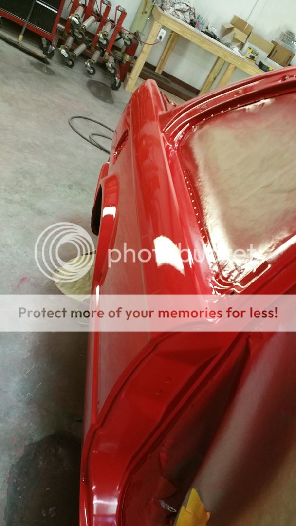

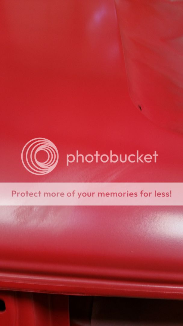

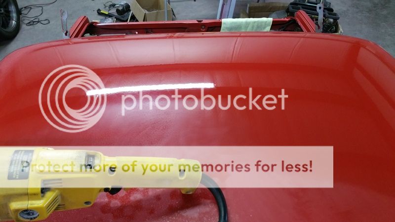

                  Its been a month, time to start cutting the paint. I did get some orange peel due to it being hot when I painted. No need to worry.

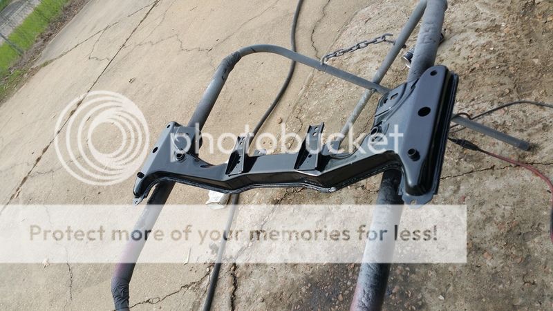

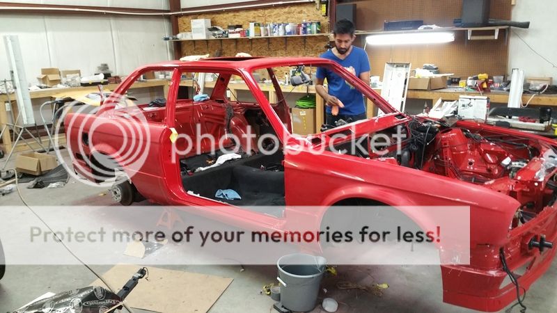

                  step 1 complete of the 3m perfect it kit. Time to reinstall the subframe and get this thing where I can roll it. Gotta see it in the sun. This car has been inside for over a year.
