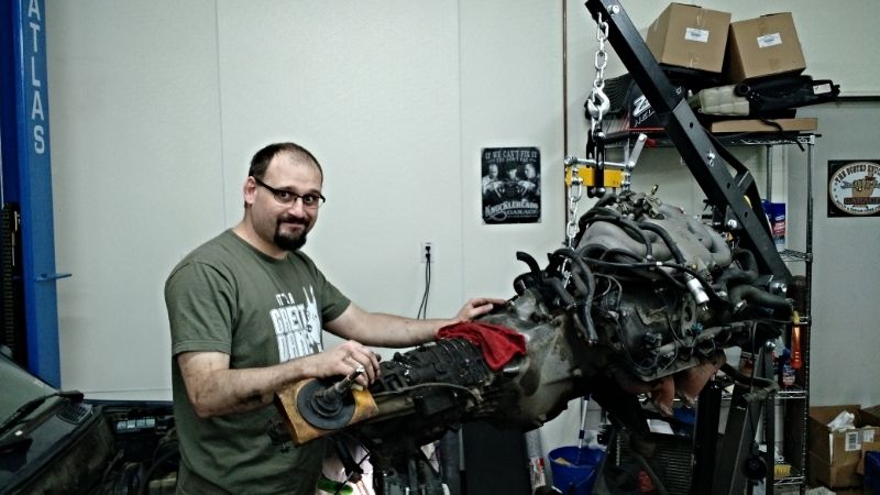

                Made some progress yesterday and started breaking down the M52. I need to decide if I'm going to pull the head and do a head gasket and valve seals.
                Took stock, and unpacked parts.

                    Made some more progress on the engine. Assumed the oil was drained from the engine....but found out the messy way it wasn't...
                    Cam lobes look good. I plan to get into the bottom end this weekend and check the bearings.

                        More Progress Made
                        Made some more progress.
                        Got the diving boards pulled, original exhaust and drive line pulled.
                        I was excited to find almost no rust on the underside, except the exhaust and a few spots of surface rust near the wheel wells and on the trailing arms. I will convert, treat and coat after tear down.
                        This weekend I plan on pulling the engine. I decided against doing a full rebuild on the engine M52, in the interest of time. I need this car running for the spring driving school at HPR and with luck before autox season starts. Euro bumpers showed up from Latvia and smilies from Netherlands. Still have to source all of the rubber parts like gaskets, o-rings and hoses.
