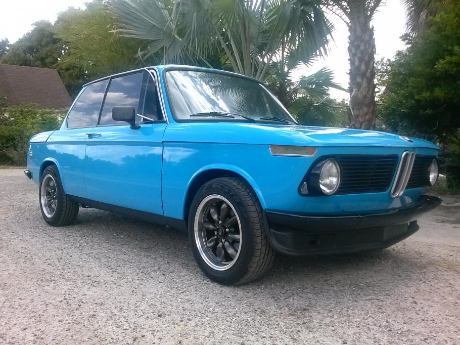

                                Looks great. A lot of nice craftsmanship! Color suggestions: Gulf Porsche blue and orange, mintgrun or Porsche Mexican blue
