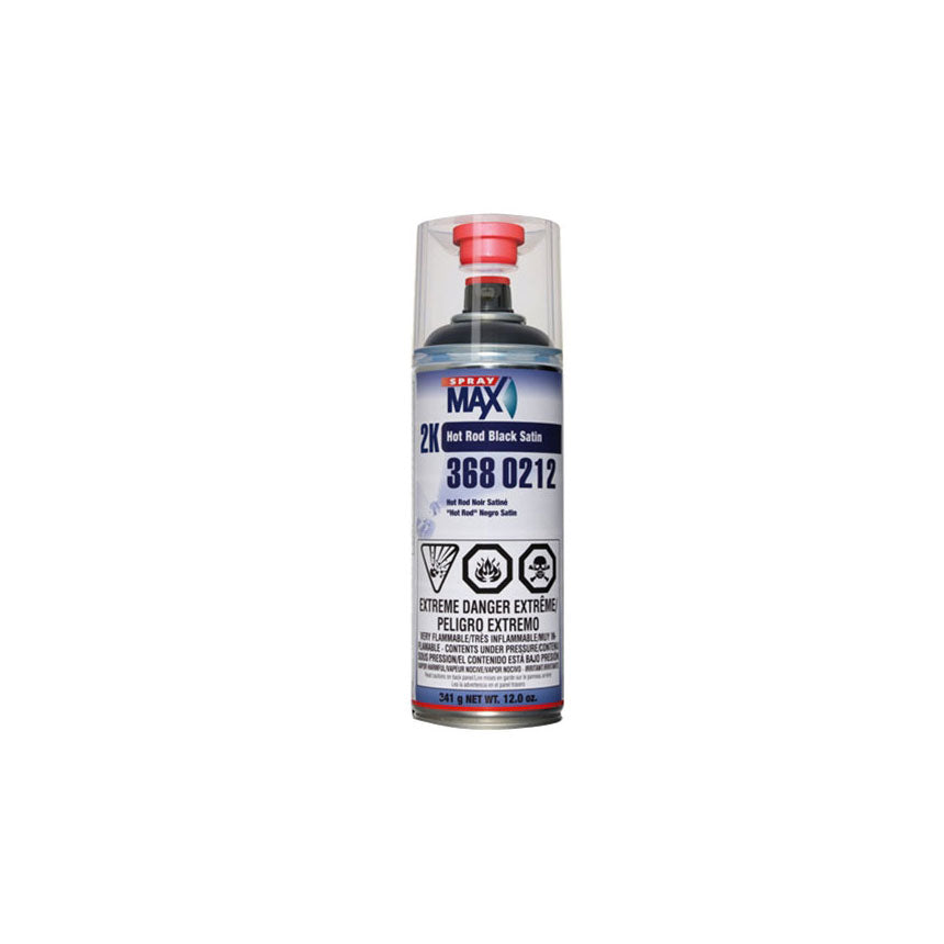

    Originally posted by mjweimer View Post
    Use some sort of automotive paint prep solvent (wax/grease remover) with heavy towels to remove anything on the surface. For example I used this on my last engine bay project:
    You want to use a prep solvent that does not leave a residue. Once cleaned, scuff with a scotchbrite pad, repeat the cleaning step, tape and shoot.
    The rockers can take a beating from road debris so it is a good area to shoot with a 2K automotive urethane paint. I am planning to use this product on my car:
    Hot Rod Black Satin is a high quality professional 2K component auto paint with smooth flow and leveling. Delivers greater scratch resistance and durability. Satin-finish black 2K aerosol.
    You might be able to find a local paint shop that sells the SprayMax 2k product line.
    MJ
    Thanks! I will look into that. Its only temporary and will get covered up by the Mtech II just depends If I have the money for a full repaint this year.

    Originally posted by Staszek View Post
    Sounds much easier to me! What should I clean with?
    MJ
