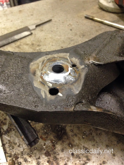

    Reinforced front sub frame steering box mount.

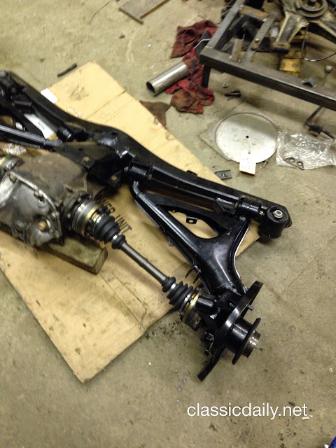

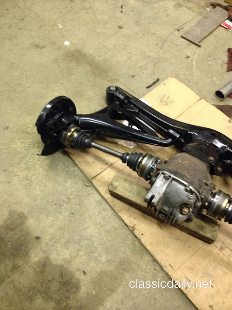

    Completely rebuilt rear subframe and 3.25LSD

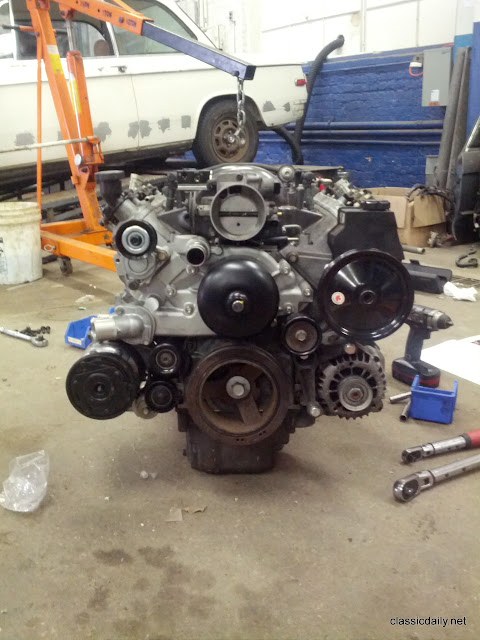

    So...engine came all apart, new pistons, rings, bearings, all seals, 243 LS6 heads, and 228R cam, LS7 lifters
    LS6 intake
    belt drive all installed
