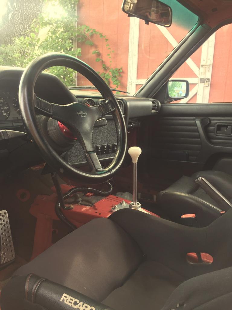

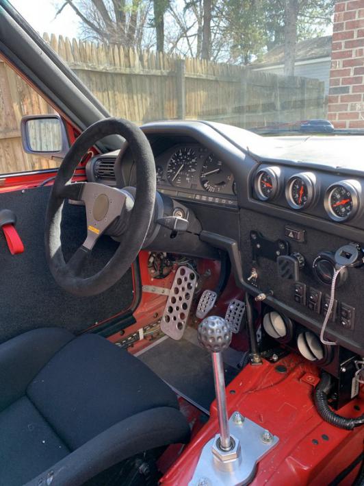

            All that I have really done at this point was interior stuff. I ordered some mounts from Lee so that I can put my SPG in. I forgot how much of a difference having a bucket seat makes in the driving experience. Outside of that, I put in a new steering wheel, pedals and dead pedal from OMP.
            Finally, I got something that I have wanted for a long time... An AKG short shifter.
            It was worth the wait and money. It exceeded my expectation in how it was made/ enjoyment that I gained from having it In the car.
            It totally ads to the experience of driving the car.
            I'm in the process of painting the wheels and hopefully the front suspension stuff soon but other than that I am just glad to be driving and enjoying the crap out of this car.

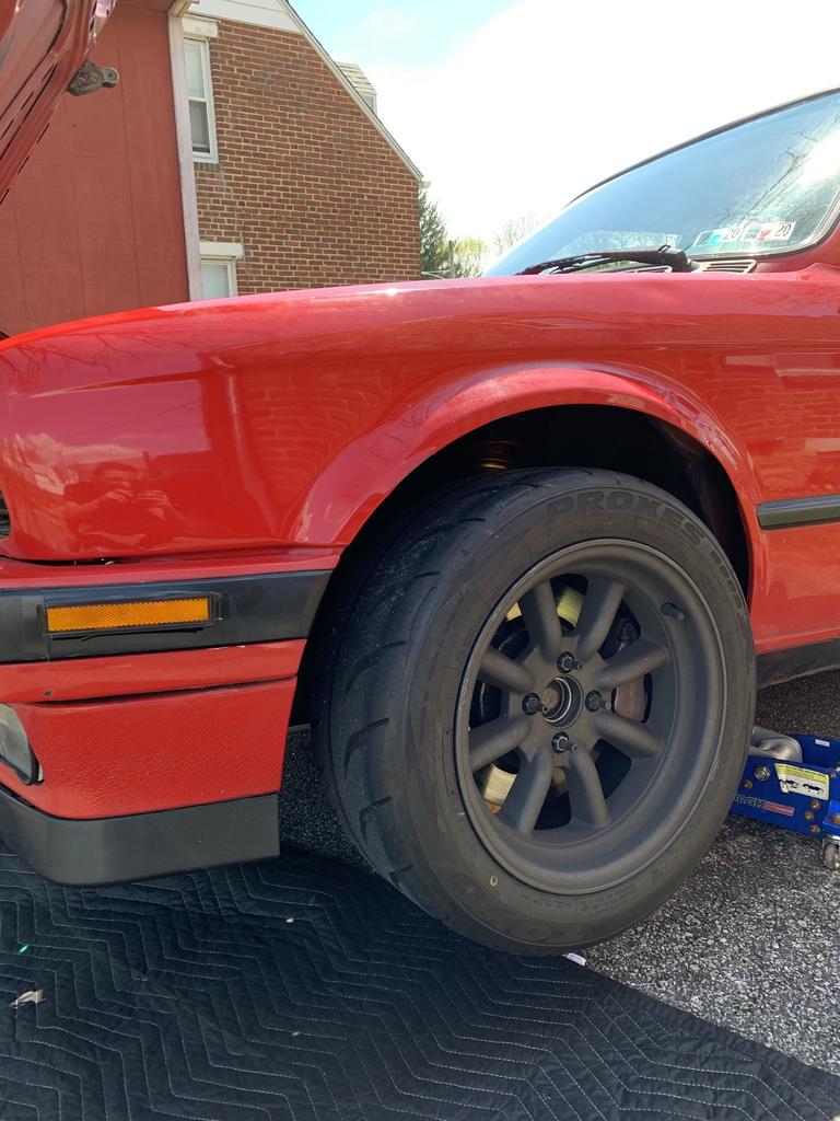

                The wheels were a bit of a pain in the rear but knew I had to figure out a way to get them to work.
                They are 15x8 +10 and 205 50 15s (though r-888s run wide)
                As they were, I expected them to site well on the car and only need a slight roll or pull.
                Of course, it was not that easy. I have wilwoods on the front and ended up having to run a 15mm spacer to clear the calipers up front so it was a bit more work.
                It sits well in the back (rubs a bit under hard cornering) and pokes a bit in the front.
                The front will be perfect with -3 or so degrees of camber, when I eventually get camber plates.

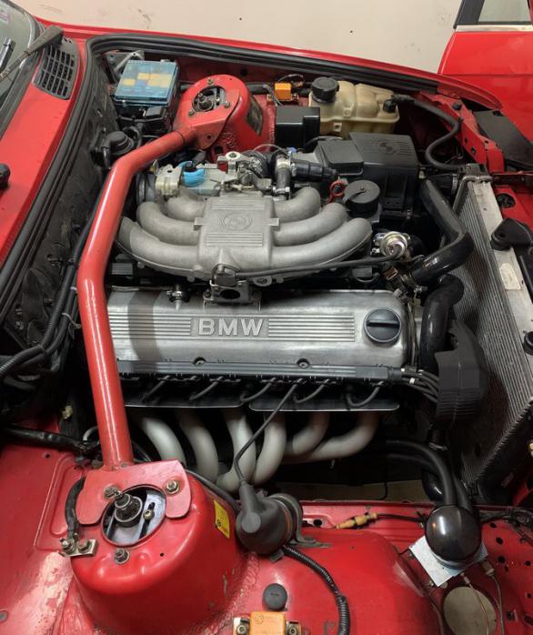

                      One thing that has always frustrated me, is this low RPM misfire/bucking. I have always attributed it to being a poor tune on the MegaSquirt so I went out and got a new wideband controller and started tuning and it tunes right around my issue.
                      So no fix.
                      I believe I have it narrowed down to it being the harmonic balancer not being “balanced”
                      It is pretty wobbly and straightens out as the RPMs go up, which would explain why it’s only down low. The issue is, I put a new one on and it’s the same shit.
                      I’m assuming it’s an issue with my woodruff key then? Maybe the gear is crooked a bit? For now, it’s going to have to do and then I’ll try and address that soon.
                      Eventually, I would like to just 24 valve swap this thing or build an m20.

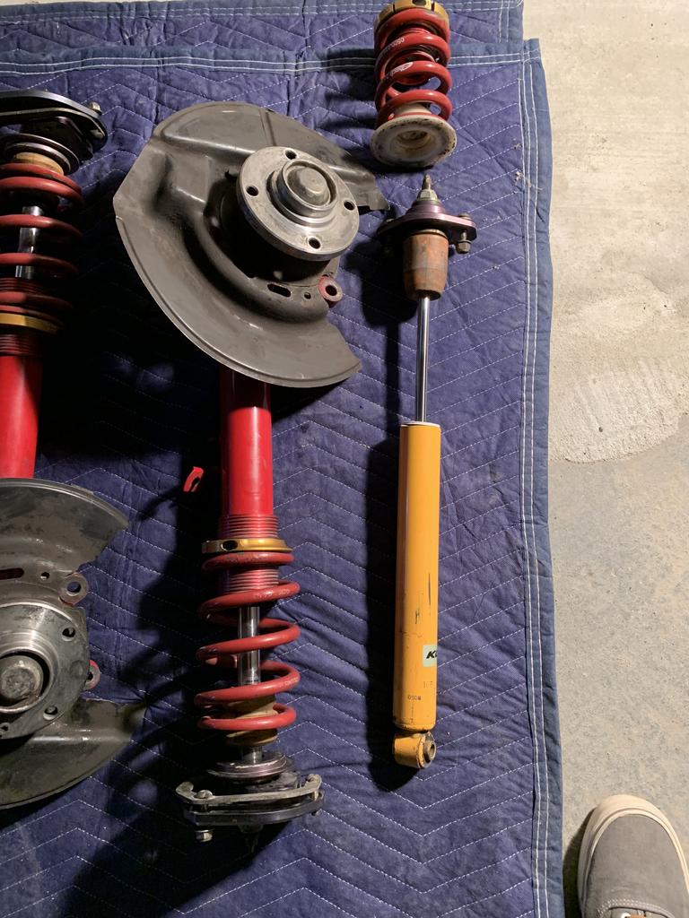

                      Here is what I have added for this summer, suspension wise:
                      Some tree house style front CABs from Condor
                      GC coilovers with shortened housings and Konis
                      Went back to stock end links, which ended up being life changing.
                      When I put the coilovers on, I assumed that all of my front end noise was the race camber plates. I was like “shit, this is going to be annoying” but turns out, it’s just warn spherical end links are annoying as hell. I Put some stock ones on and it sounds like a solid German car again.

                          Also- Wanted to provide some feedback on the GCs, over my older Spec E30 set up (H&Rs and Bilstiens)
                          I put 500 miles on them this weekend, down in Western VA @ Shenandoah National park and i have to say, they are pretty impressive.
                          Obviously, I expected less body roll, as the rates are quite a bit stiffer but the car is just so much more compliant and the biggest difference is how much less bouncy it is. Whether it is over dips, or expansion bridges, the car just feels SOLID but not harsh. Its really great and have never been so happy with how my car's suspension has felt.
                          Highly recommend the setup, if anyone is on the fence.
