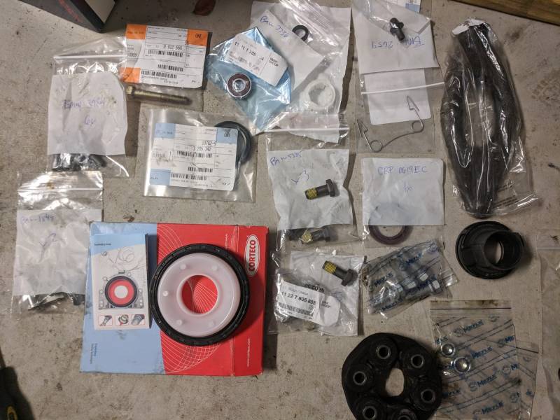

                        So two years into the project and I barely have anything done, I guarantee this will be the longest M52 build on r3v :p
                        Anyway, Im trying to get as many parts together so when I finally do find time to work on the e30 between work, church, baseball games, soccer games, yard work and keeping my e46 running I'm not wasting time. I'm not really doing anything performance wise on the engine (no m50 manifold, upgraded injectors, etc...), just normal maintenance stuff.
                        Here's a list of parts I've gotten together so far. Are there any other parts for the engine/transmission (g260) I should go ahead and replace while the engine is on a stand?
                        Already Purchased:
                        SAP delete/blank plate
                        oil filter housing gasket
                        valve cover gasket
                        metal water pump
                        thermostat
                        belts
                        trans input & output shaft seal
                        trans shift shaft/selector rod seal
                        clutch pivot fork & pin
                        clutch release/throwout bearing & spring
                        SS clutch line
                        I also have the following accessories/etc...:
                        Oil Pan/Gasket/etc...
                        Motor mounts
                        944 booster

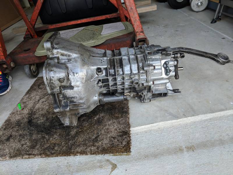

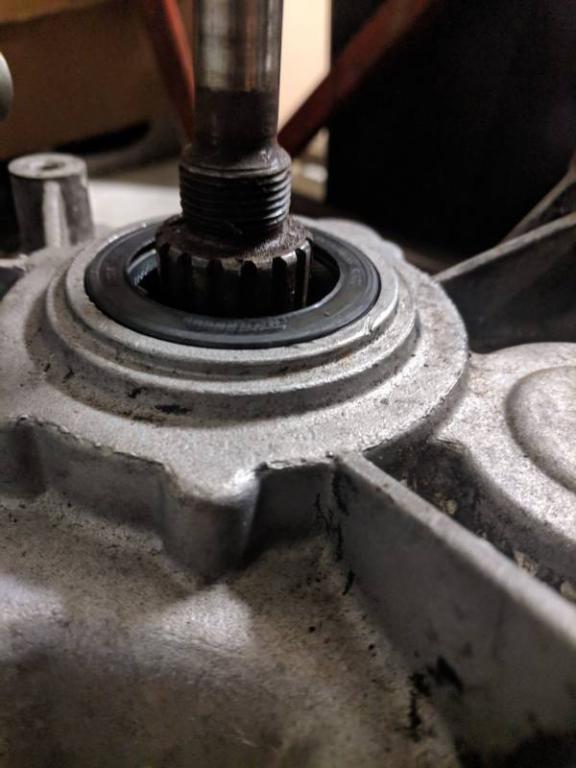

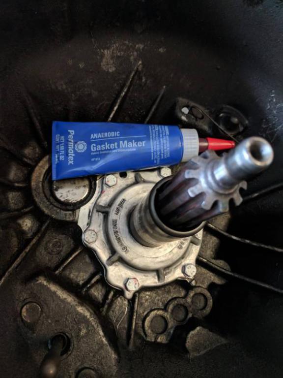

                              I'm also pretty much done with the transmission refresh (seals and some other odds and ends...a few pics below) so I'm ready to mate that back up to the engine.
                              Then need to prep the engine bay (remove AC parts, install 944 brake booster, e36 engine mount arms), attach headers and then drop the engine/trans in.
                              Knowing my timeline that'll take another 6-9 months. [emoji13] Although I'm sure my neighbors are going to love seeing a 'broken down' car in the driveway so I guess I have some incentive to get the engine in so I can actually roll it into the garage to work on it.
