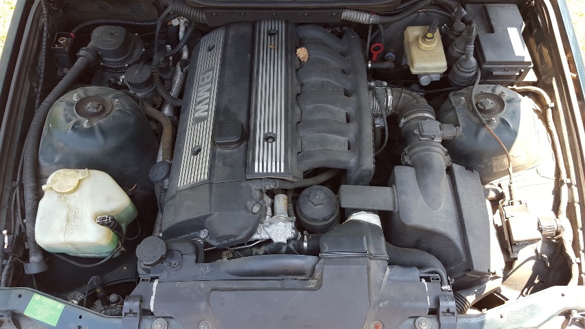

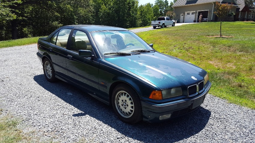

    So this is the donor car. 1996 automatic 328i with ~170K miles
    I drove it home about 200 miles without much a hiccup! Engine seems to pull pretty strong and looks clean!

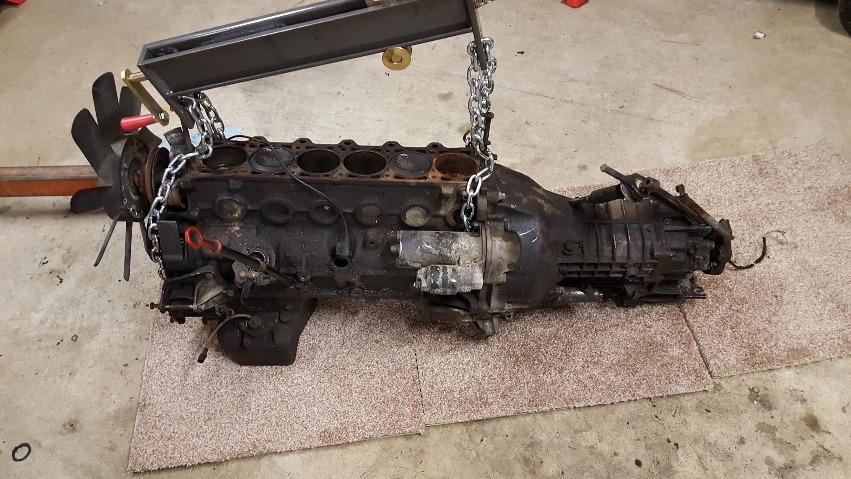

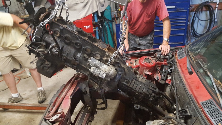

    And here's the M20 coming out of my e30
