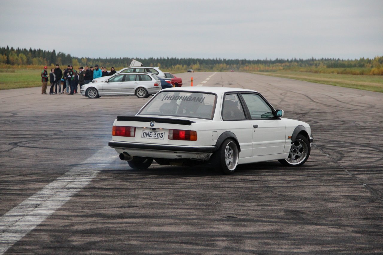

            After that we got 3 piece work wheels to replace the borbets. Can anyone guess the model:

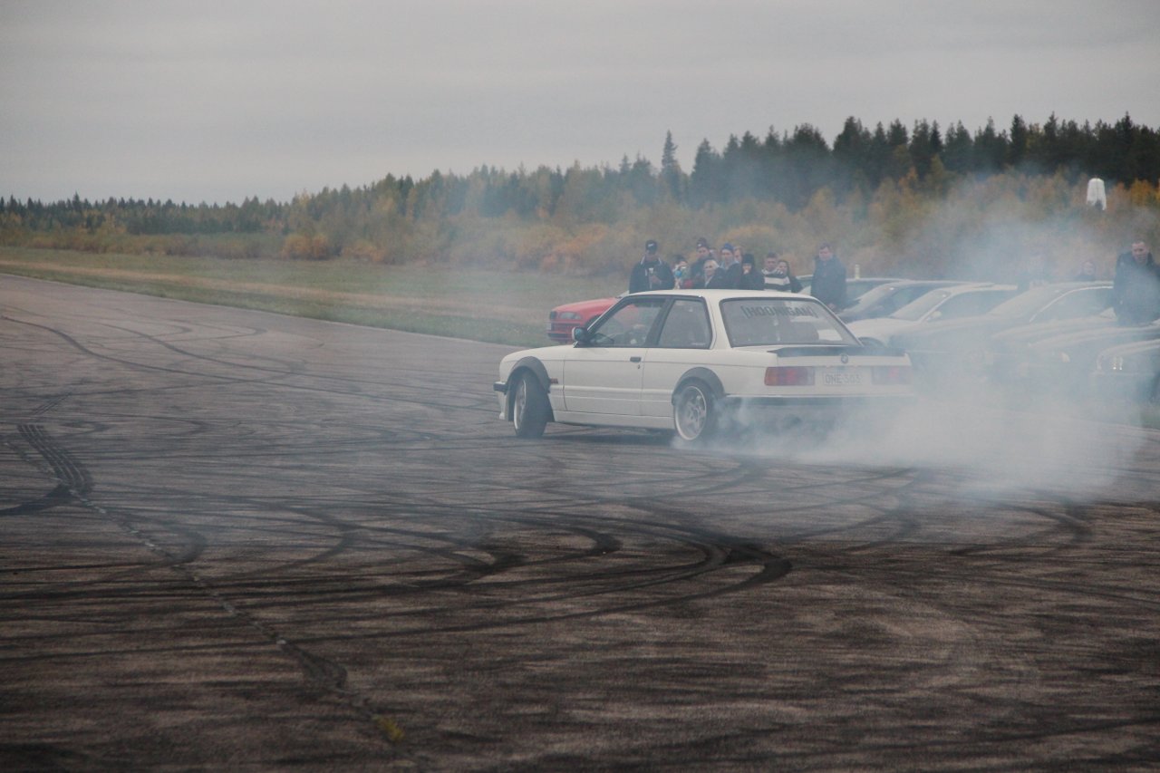

            And to end the summer season there was ykameet, where we could destroy the wrong size tires which came on those wheels:
            Here is video material also: https://www.youtube.com/watch?v=dpl8VyoDolk
