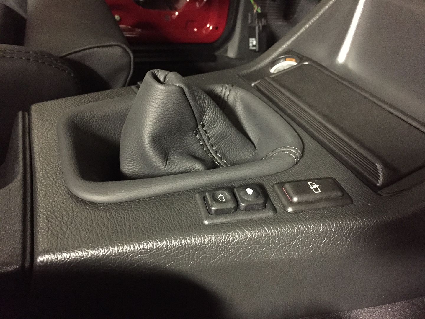

                              I got the parking brake and shift boots installed.

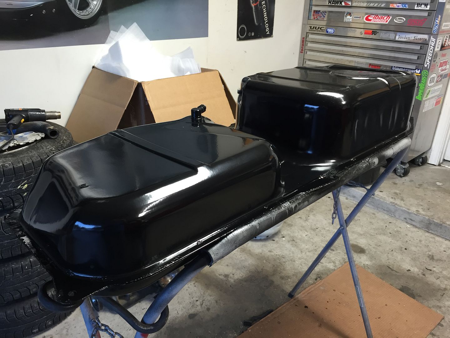

                              The task that took the longest today, by far.... was cleaning the fuel tank. I wish I had taken a before picture because the tank was so so dirty and the entirety of the bottom and sides was covered with thick cosmoline. The interior of the tank itself is thankfully spotless, I was concerned there could be some rust in there not knowing how long the car sat but I got a small gift here.
                              I started with basic purple power cleaning with a stiff brush to remove the actual dirt, then moved to a plastic scraper and lacquer thinner to lift the cosmoline off. The lacquer thinner does flatten the paint a bit, so I then cut & buffed the tank and finished it up with a nice coat of wax.
