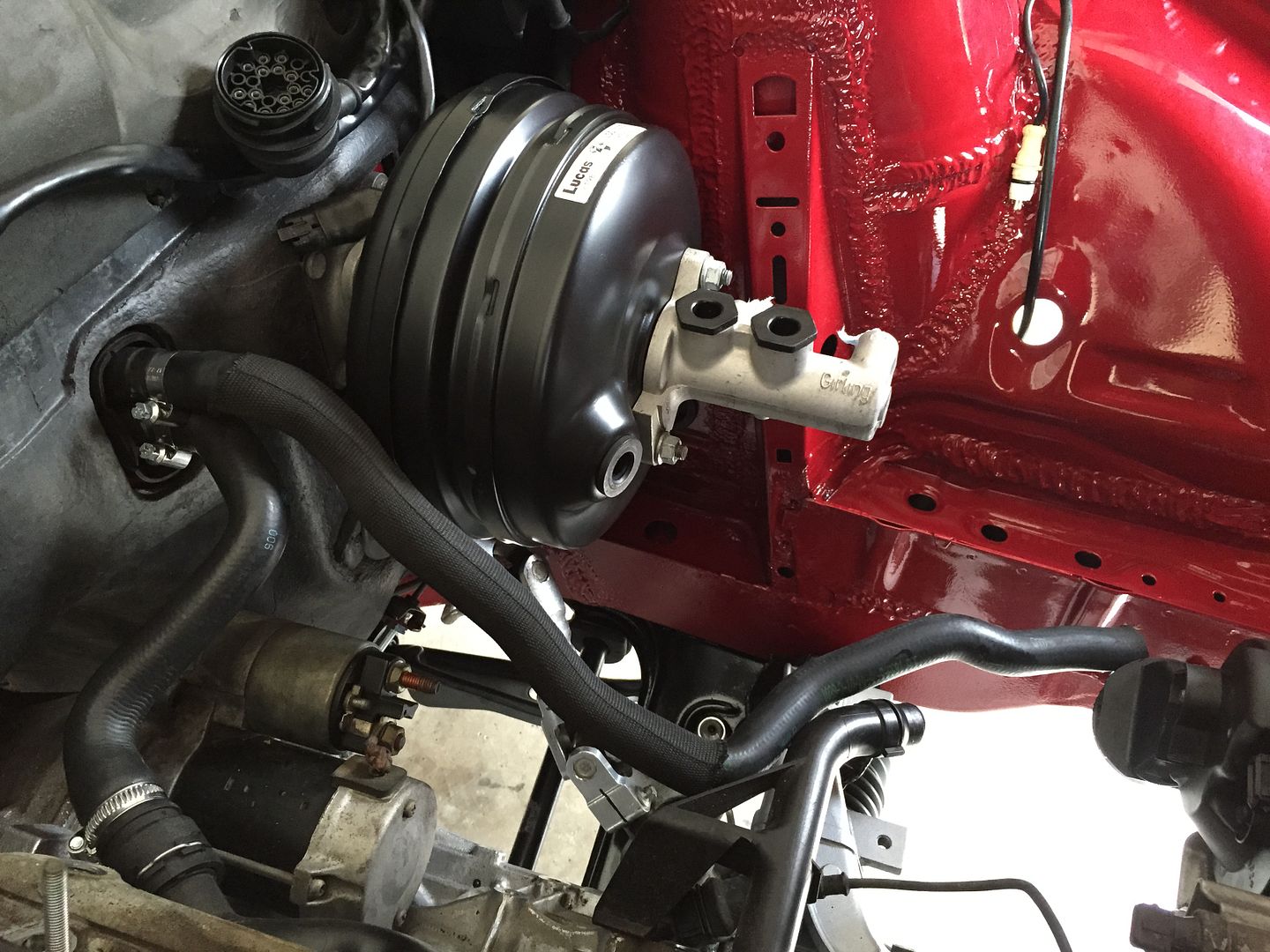

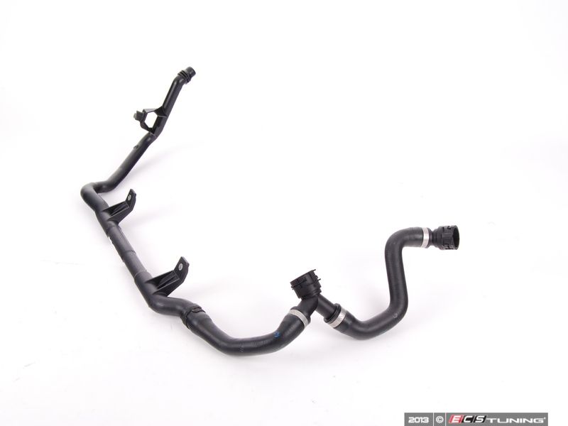

        This morning I went to install the brake booster and found the intake was going to have to come off. No big deal it literally comes off in 3 minutes at this stage. Up and off and the booster dropped in easily.
        With the manifold off I decided to go ahead and plumb the heater core. I bent both nipples straight down about 1/2" so the hoses would best clear the intake plenumn.
        I brought home an armful of various hoses from work to adapt for use, not knowing exactly what would fit. Here is what I came up with:

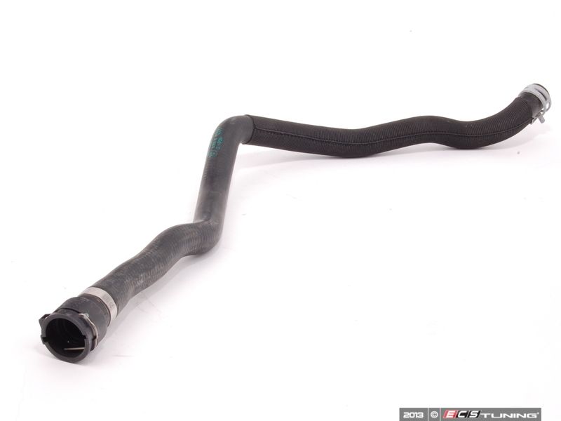

        The lower hose that comes from the back of the plastic block pipe to the heater core is part of PN 17127548223. It is used in a slew of late model I6 BMW's like the E9x. All you need is the rubber portion, cutting the crimp rings at both ends to free it up. You'll need a straight oring adapter to hose clamp back on.
        The upper heater core hose needs to tee into the lower plastic block hose and they both go to the expansion tank. It also comes from an E9x, PN 64216951946. It clips to the far end of the hose referenced just above. This hose has a good natural shape is droops into the appropriate position without tension and has a nice abrasion resistant cover on the portion that passes by the intake and booster.

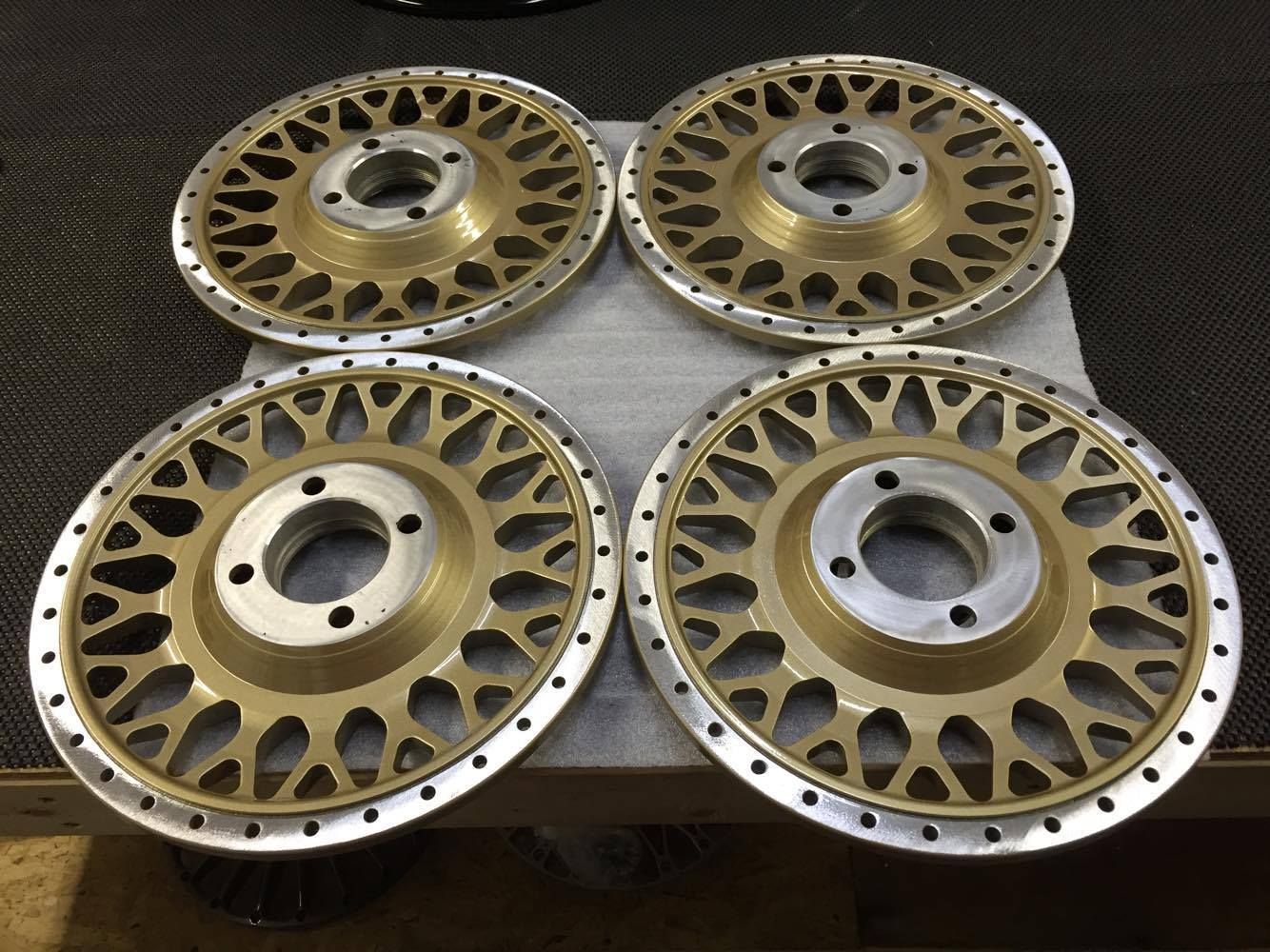

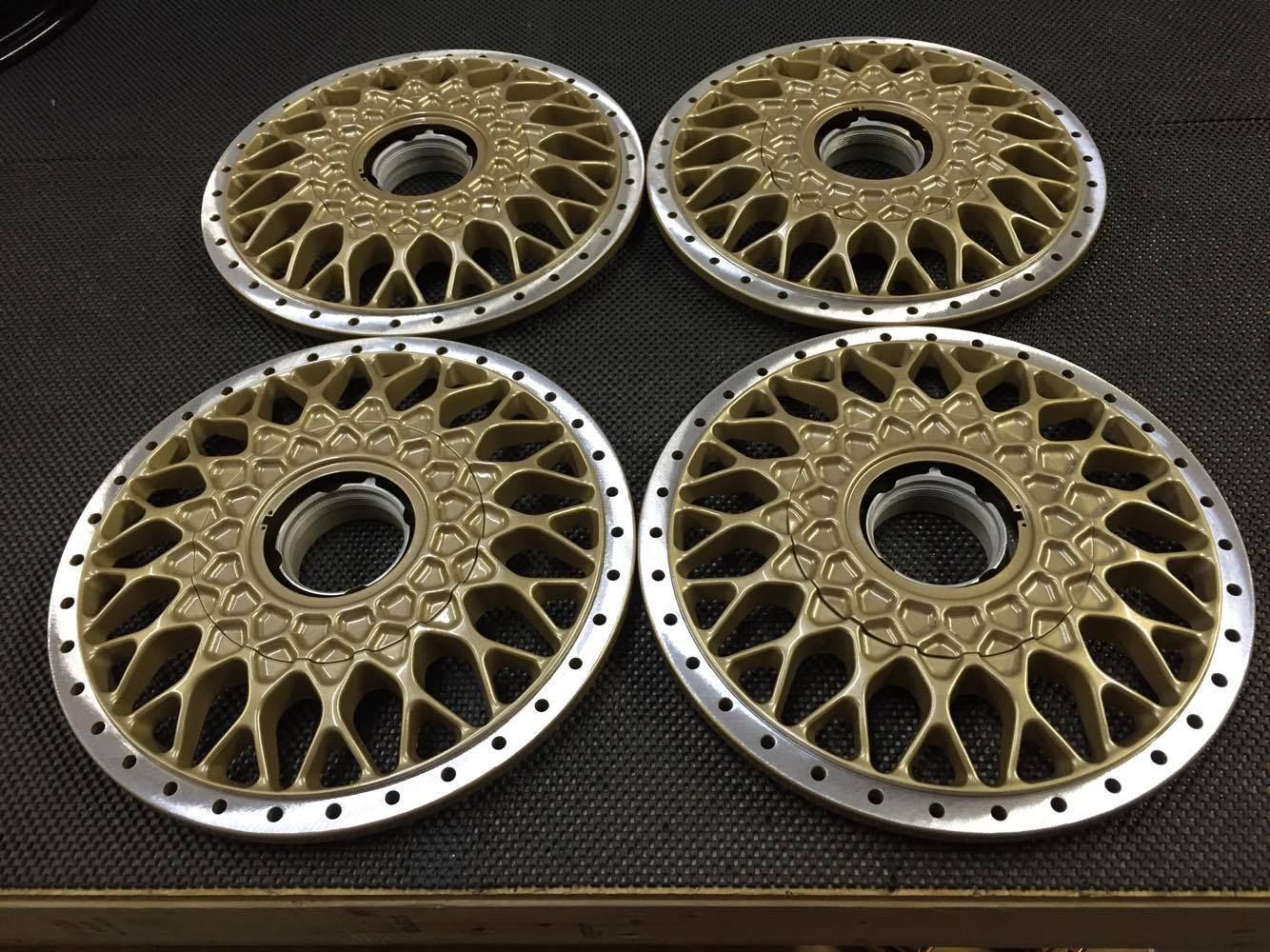

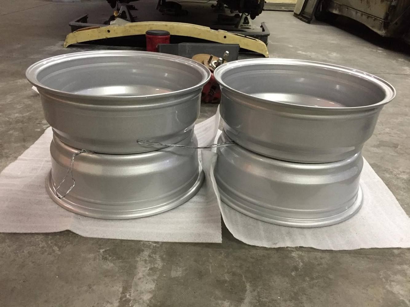

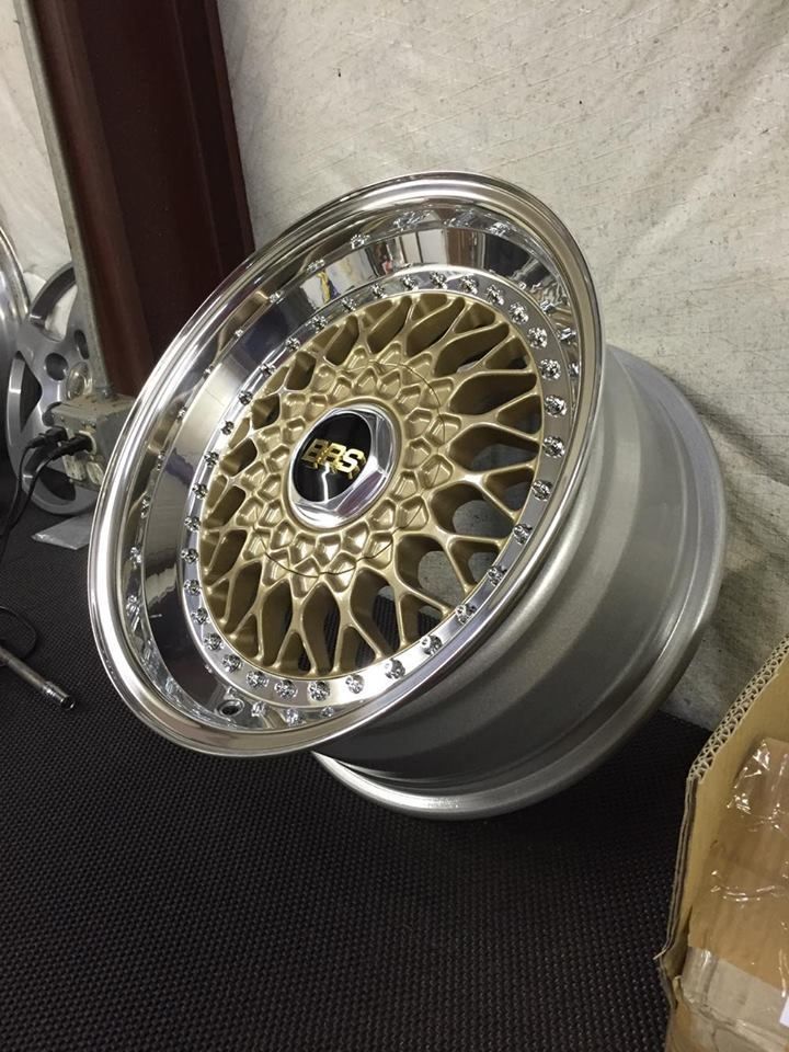

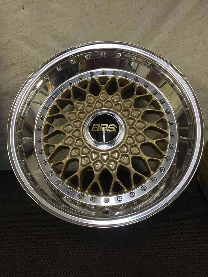

          Anyone watching on R3V today had the sneak peak on the completed wheels that Paul @ Ehrlich Wheel Works is wrapping up. They should ship this week! Paul has been working on these for me since just after I picked the car up. He really knocked it out of the park with the work on these wheels and they are going to look killer on the car.
          The wheels are 16x8 ET24.

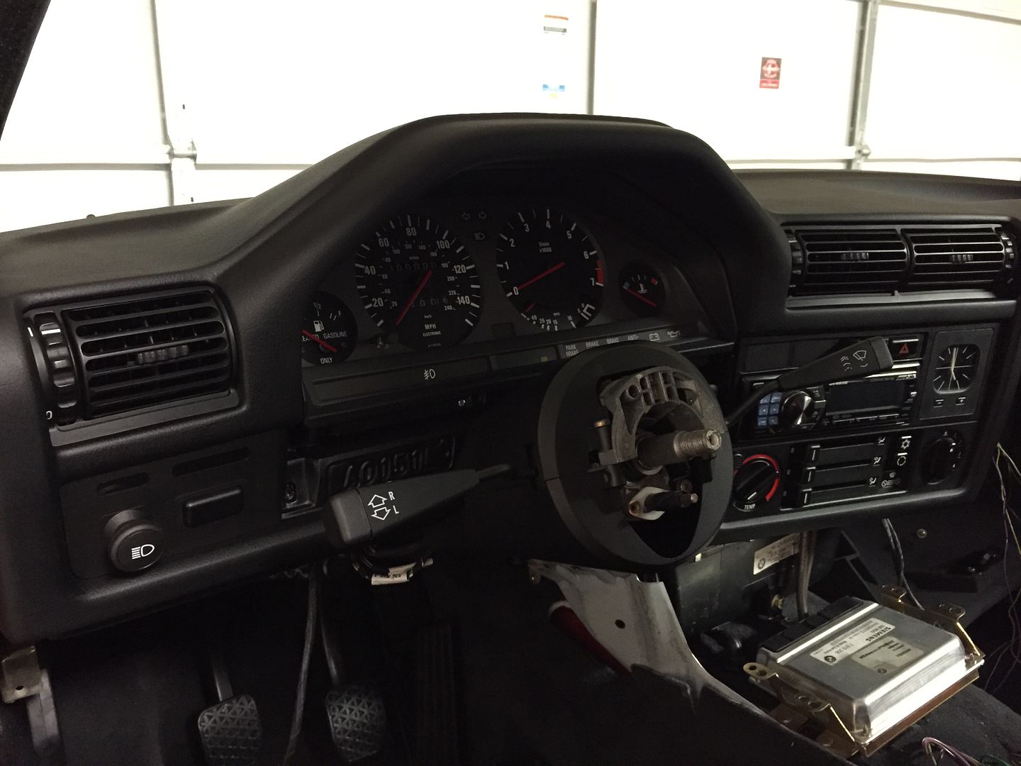

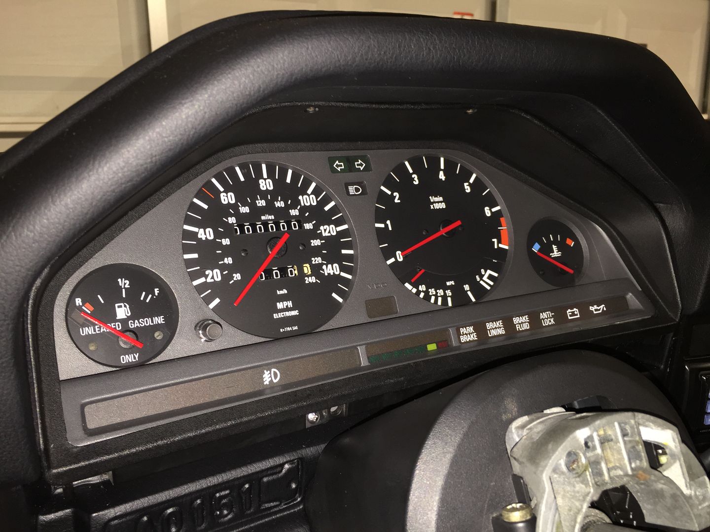

          Paul really stole the show today, all I got done was installing the gauge cluster with the freshly polished lense.

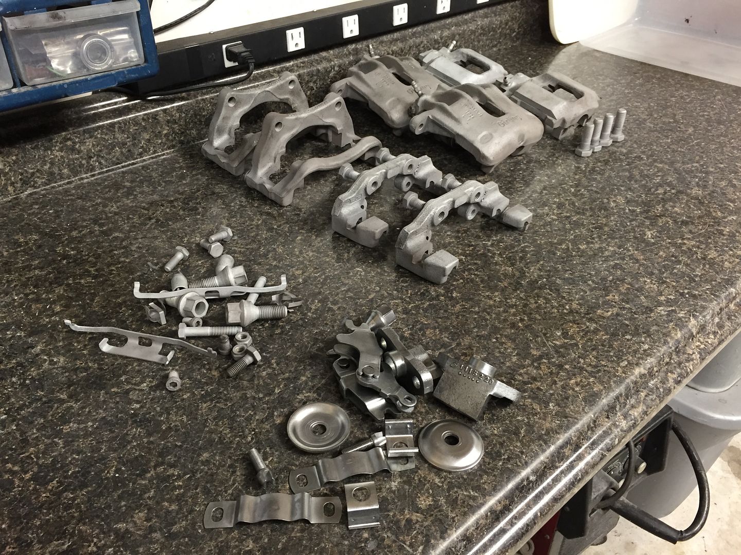

                  Yesterday I spent the bulk of the day at a friends shop hunched over a blast cabinet cleaning four calipers and a large assortment of hardware. I'll need to go back tomorrow and finish blasting more loose hardware.
                  All of the parts will be dropped off for yellow zinc chromate plating, to reproduce the original finish. Many of these parts are either not available at all, unreasonably expensive, or available but no longer in the original finish (dull gray zinc or something like that)
                  Unfortunately the blasting media leaves a fairly rough surface finish, and plating over that will result in a satin look to the parts. Each part needs to be polished with a steel wire wheel to give it an appropriate surface finish for a nice iridescent sheen after plating is complete.
                  The small pile in the front are finished and ready to plate, much much more to go.

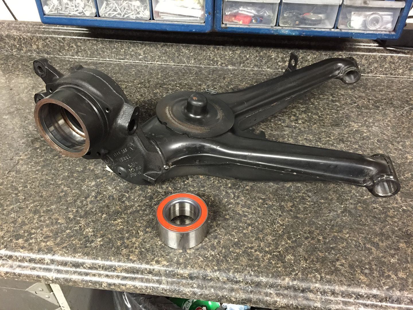

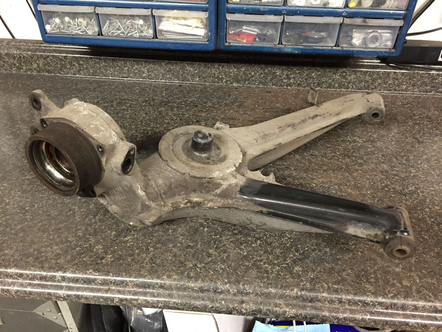

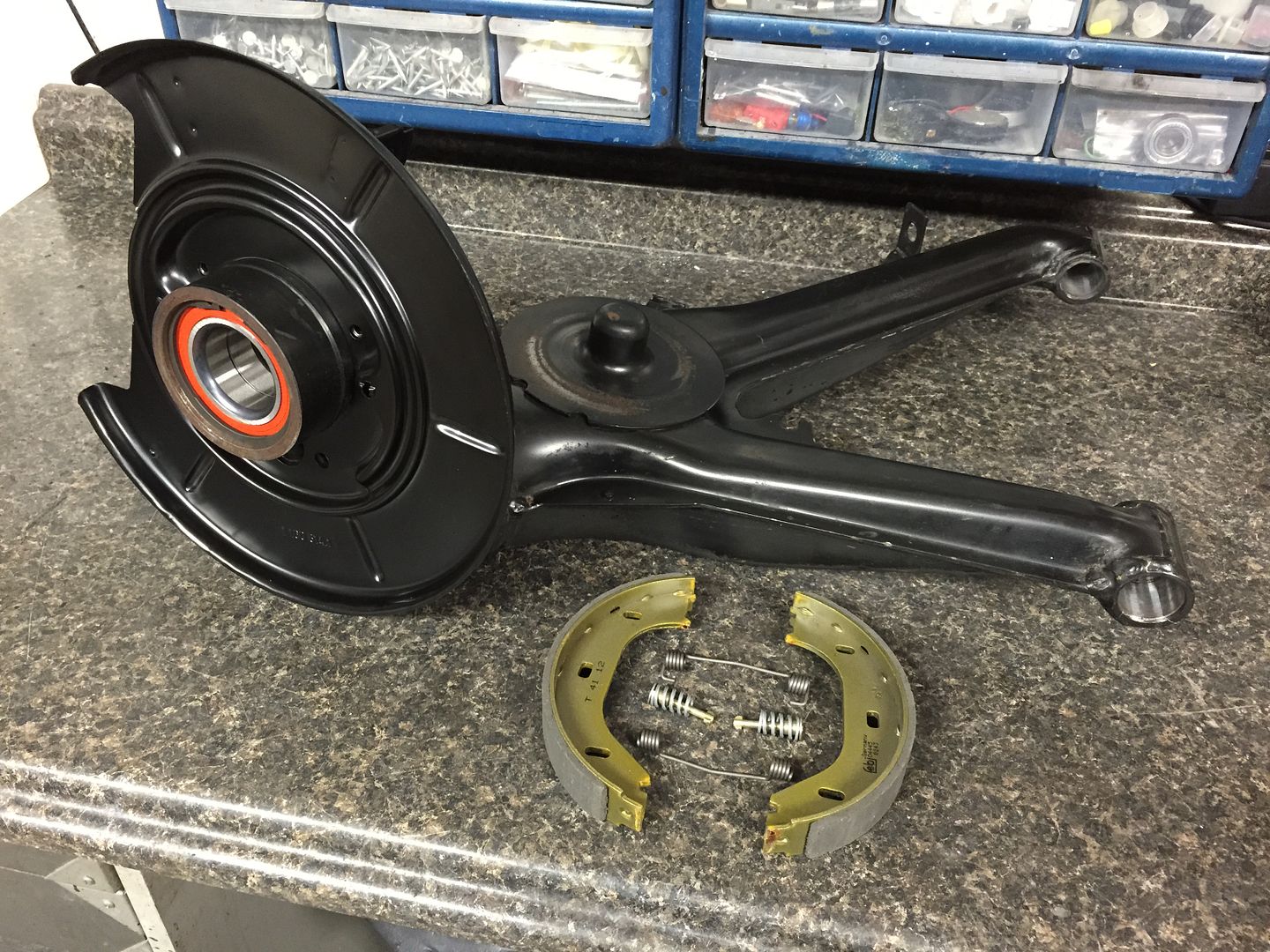

                        This evening after the movie I spent some time on the rear suspension parts, cleaning the trailing arms, subframe and axles.
                        Right rear trailing arm, before any cleaning with one test swipe. Roached half pulled apart wheel bearing in place.
                        She cleaned up real nice, all of that dirt revealed a good deal of cosmoline that was removed with lacquer thinner. New wheel bearing ready to go back in.
                        Wheel bearing installed, new brake backing plate, parking shoes, springs, etc.
                        The other arm will get the same treatment tomorrow, along with the subframe. I already pressed the old subframe bushings out and new ones in.

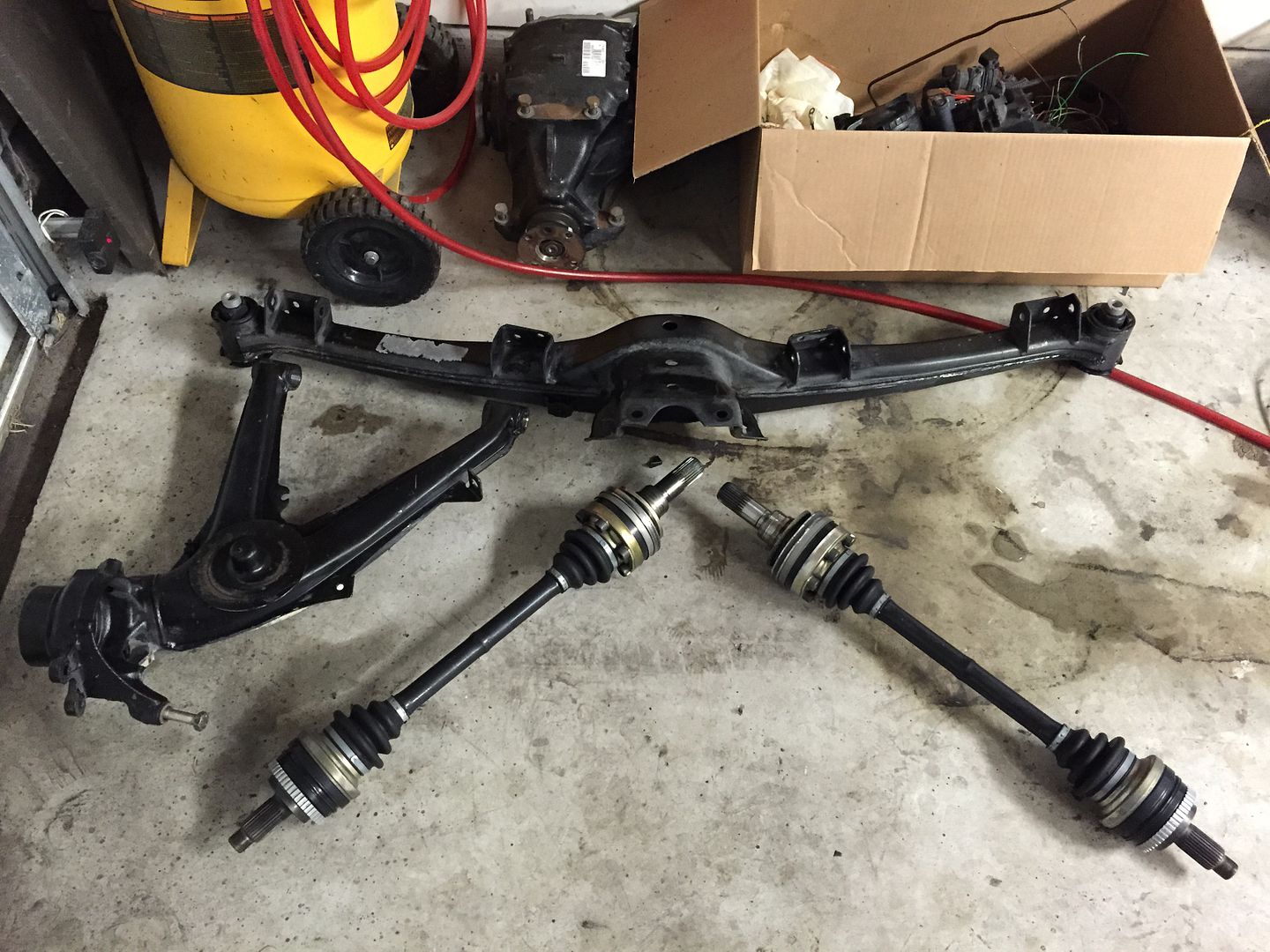

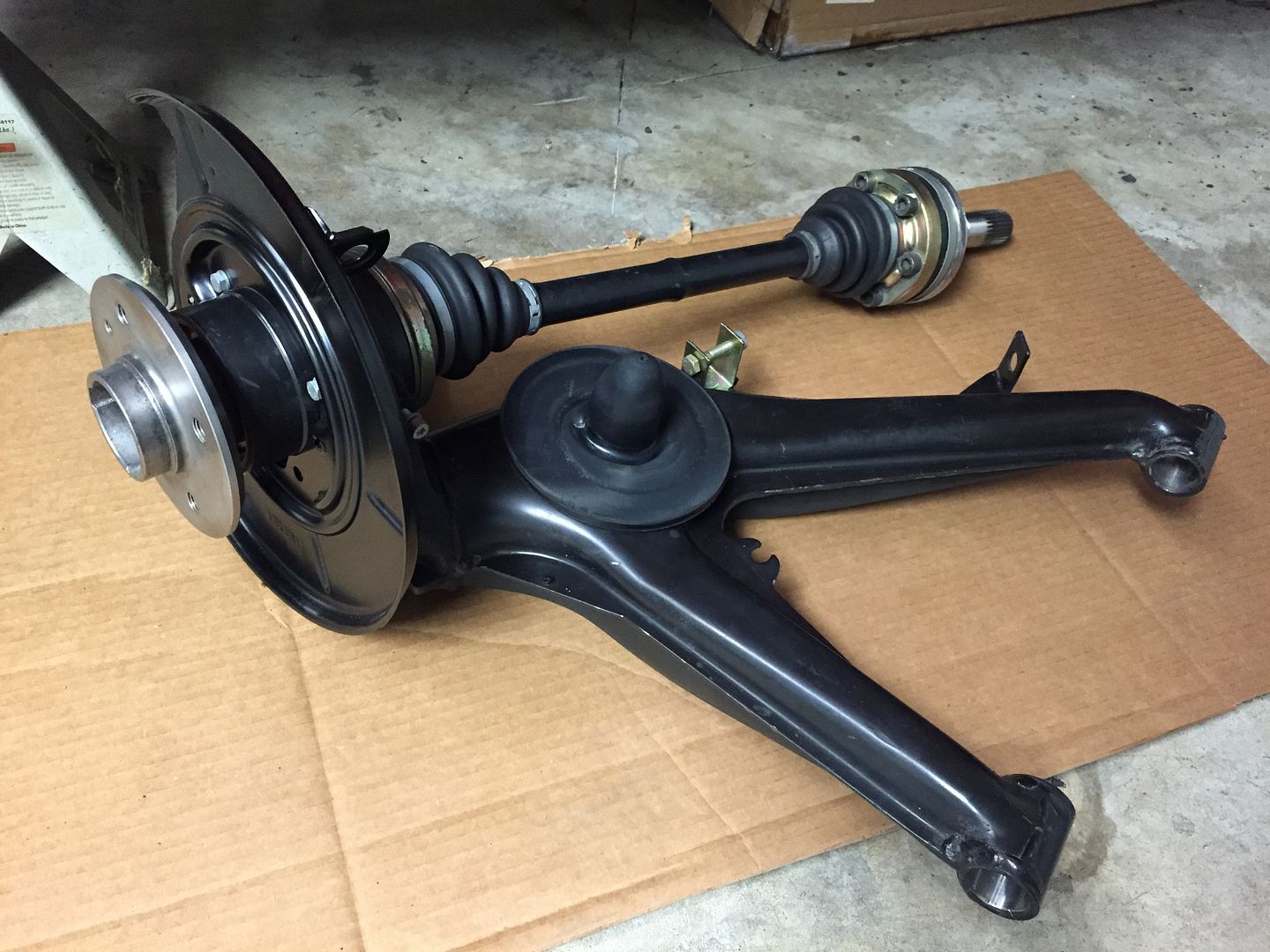

                            Both trailing arms are back together now with the hub and axle pressed together. I somehow forgot to order the trailing arm bushings but those will be here tomorrow. Not a big deal as I will be waiting on hardware to come back from plating before I can throw the rear suspension back on the car.
                            I spent the remainder of the afternoon cleaning the rear undercarriage of the car. Leaky diff sling and grime of that sort. I think I am going to relocate the carbon canister and the MS43 fuel filter/FPR to the location of the original fuel filter. It looks like it may fit and work well there with minimal modification to the metal hard lines that run up to the engine bay.
