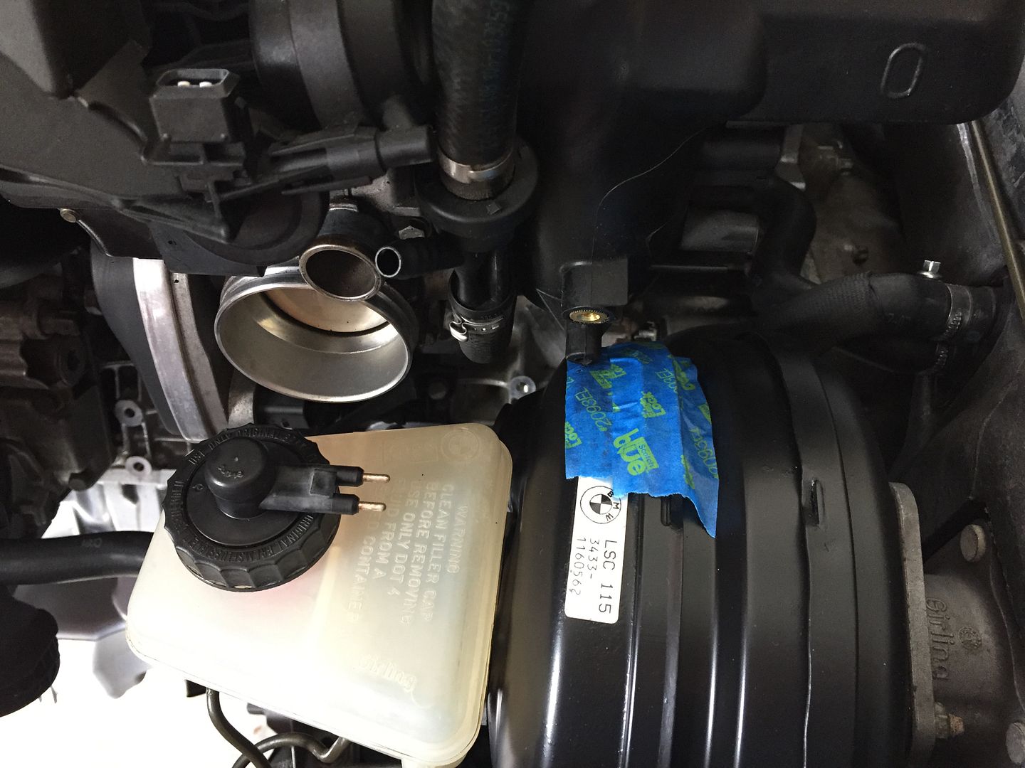

    Having done 6+ M5x/S5x swaps I can tell ya the M54 manifold definately intrudes into the booster space more in some ways but less in others. The way the underside runner goes a single stack booster likely would have a better bet at fitting, like a P944 unit or something of the like.
    I'm going to try flipping the aluminum bracket and shaving the nubs on the manifold, and if that fails I will find a different booster.

  • kronus
    replied
    I'm running the E32/iX booster without the spacer and have a decent amount of room to an M50 intake manifold. You have to do some firewall modifications, though.

  • smooth
    replied
    I used a VAG booster for my M50 swap. I don't know the clearance differences between the M50 and the M54.

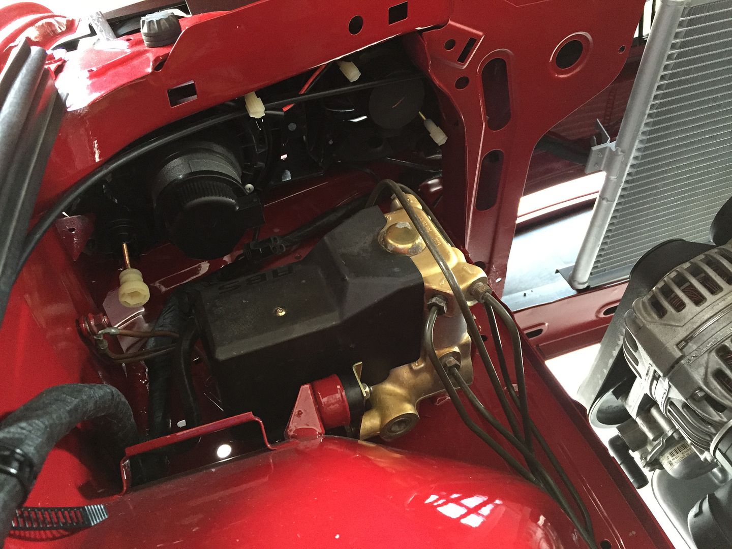

    I finished installing the ABS pump with new brackets, and plumbing all of the lines.

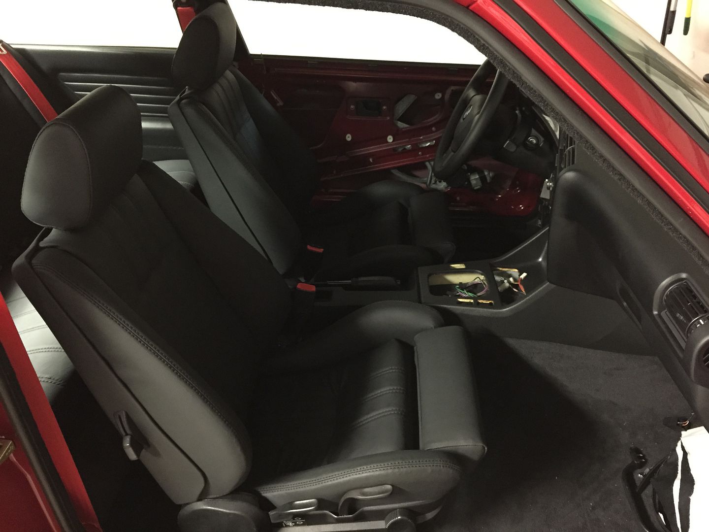

    I finally found a dye that matched the leather perfectly and dyed the seat backs to match. I installed them after letting them dry overnight.

    I can't find where I read that the E32 735i booster works straight up with the M54 but it sure as shit does not. Major interference issues attempting to drop the manifold back on.
    I'm hoping I can remove the booster and flip the angled aluminum bracket between it and the firewall. With luck it will not hit the strut tower, and it will give me another half inch or so along with removing those 2 nubs on the manifold that I can do without.

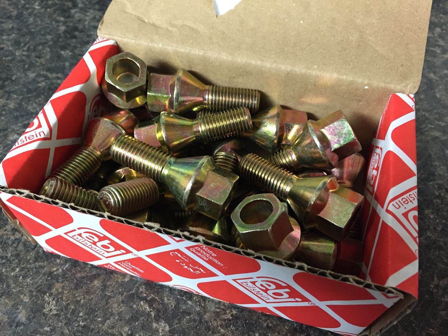

    Not much to report this evening, just a newly arrived box of new lugbolts.
