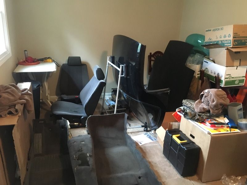

            Glad you liked them. Don't think I'll be at this weekend's event, I need to put my interior back in.

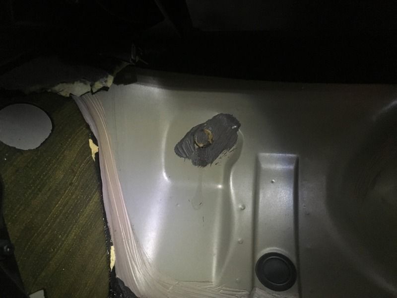

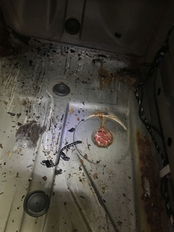

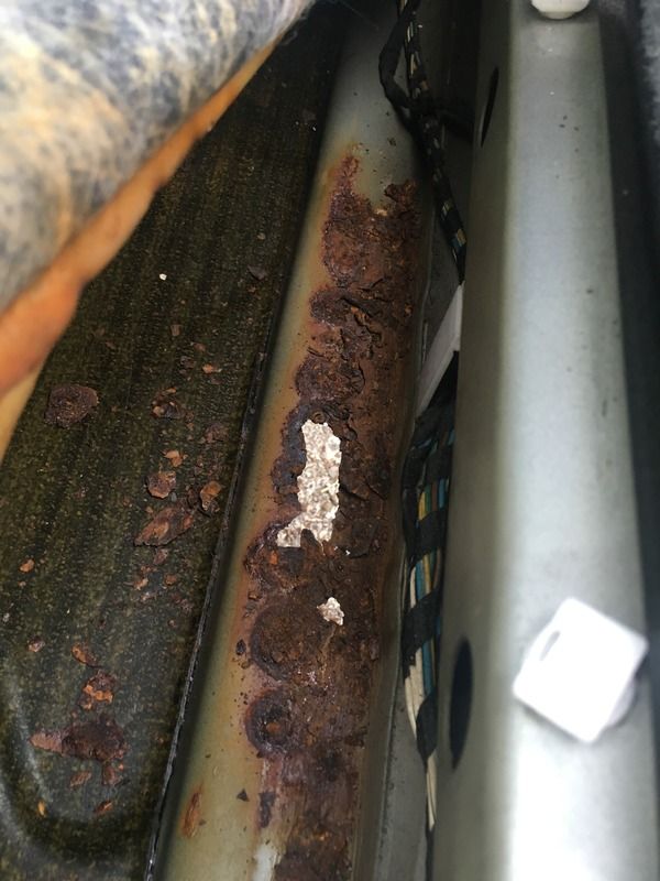

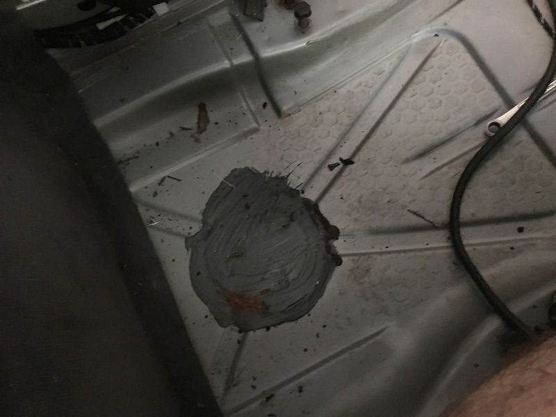

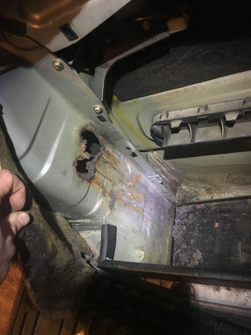

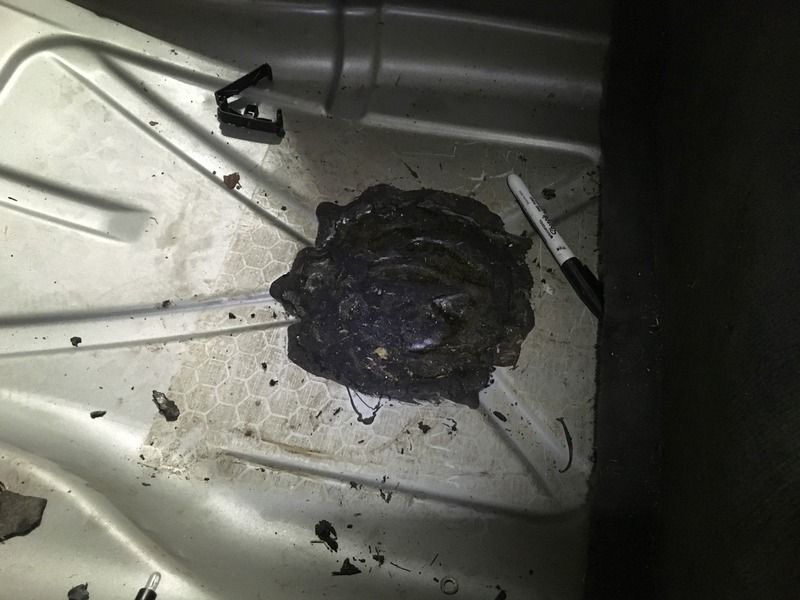

                Little quiet on updates, been spending a little time checking on structure.
                Good news/bad news. Found the source of moisture in the right rear hatch compartment
                That triggered me to start poking around further. Front passenger floorboard (and a pretty wet floor) -
                Passenger outside rail -

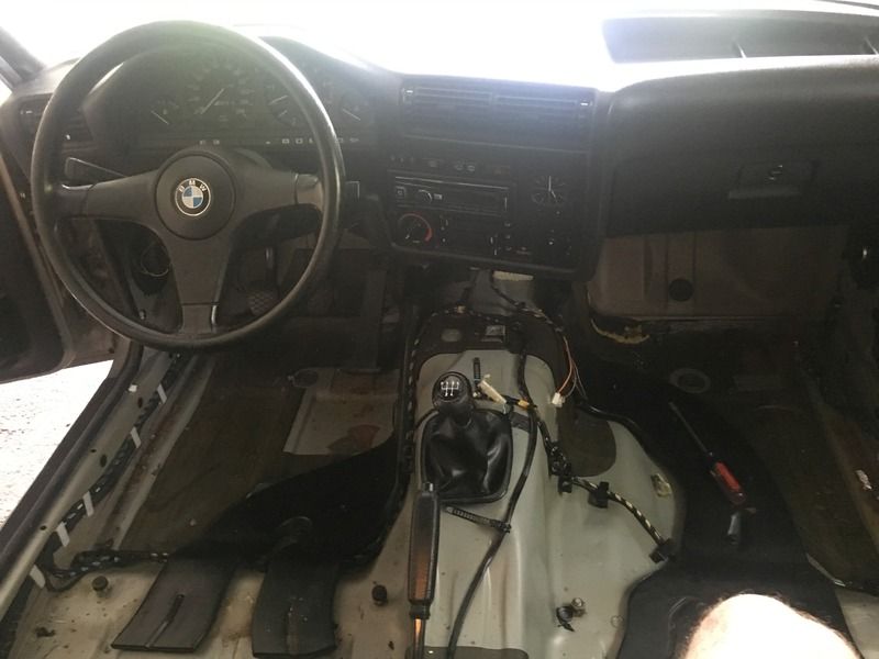

                Ran out of light pretty quickly, but that's enough for me to realize I need to go ahead and strip the interior down bare and see what I really have going on.
                The front passenger corner spot is pretty mushy, so I assume moisture is heading in there, but at the same time, I don't know what's along the trans tunnel or inside corner.

                  #38
                  Woah, I never would've expected two great holes in the storage compartment! Any idea what might have caused them?
                  I suppose I'm not too surprised at the front floor pan rust at the corner. But along the seam, weird.
                  Now I feel bad that I never pulled the carpet up. At the least this will serve as new (to me) information on where to look for rust on tourings. Hope you get it fixed quickly and inexpensively!

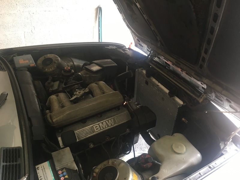

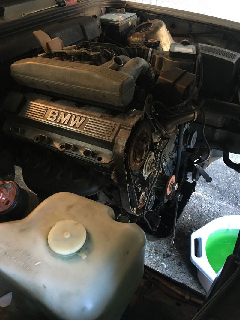

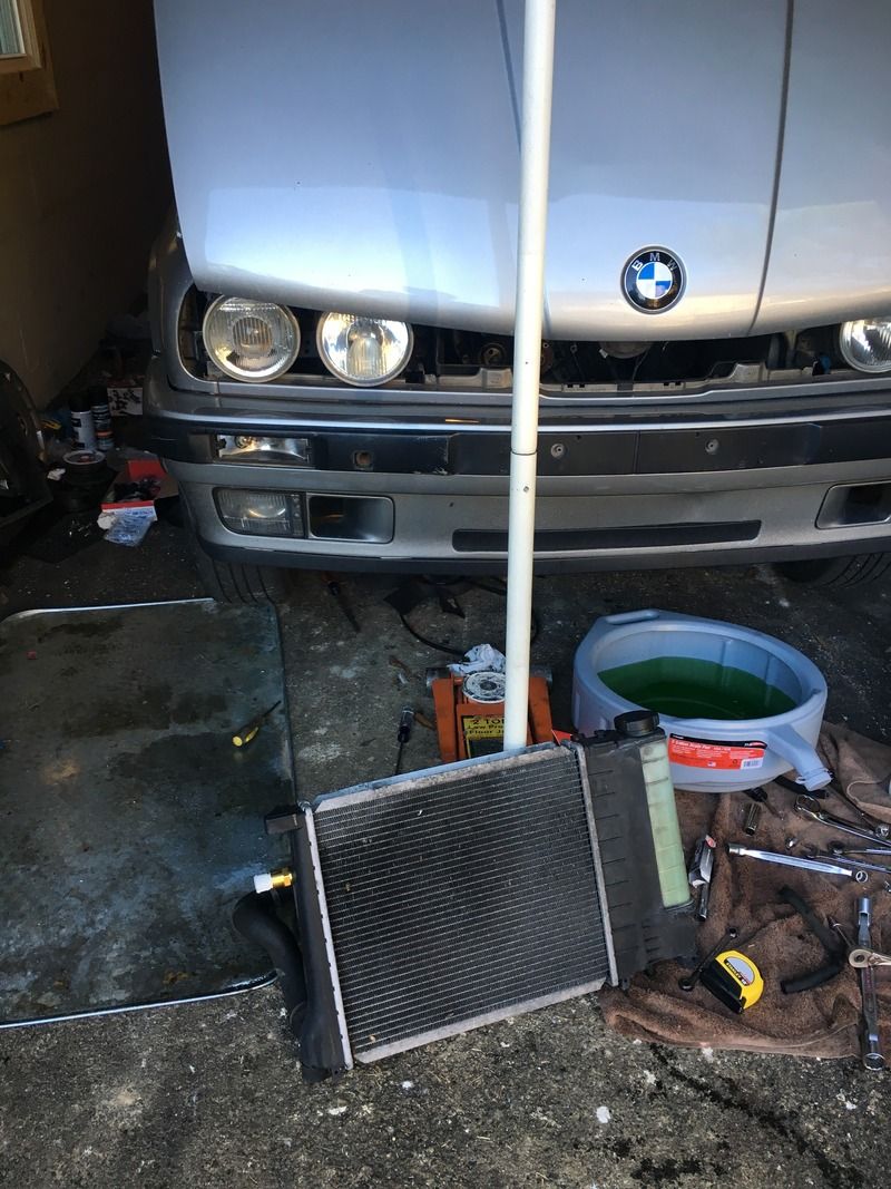

                    Timing belt fun! Learned that the M40 wasn't timed correctly at all, was advanced... like a lot. A whole lot. The plugs definitely showed it too. Good news is that the car runs a lot better afterwards.

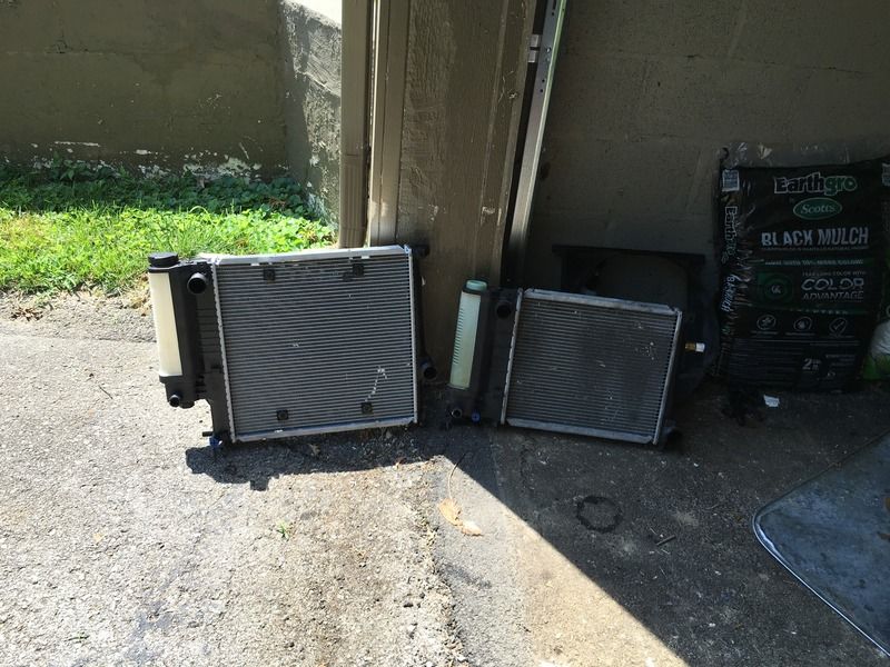

                    Learned how small the M40 radiator was, lol:

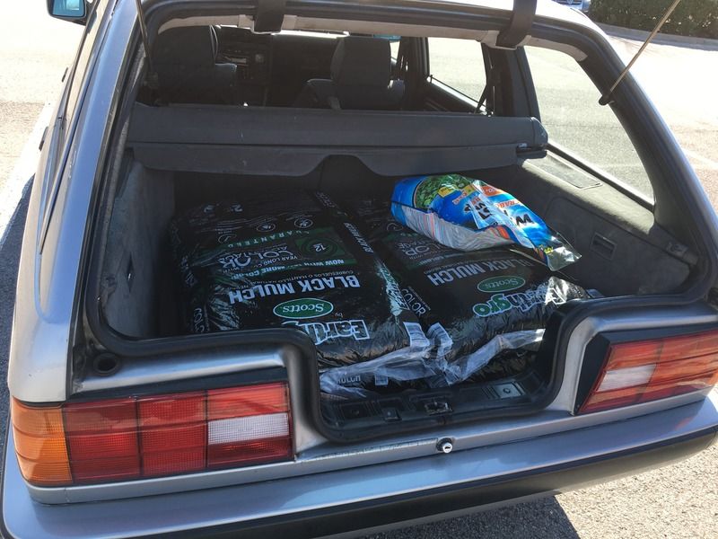

                    Did some yardwork -

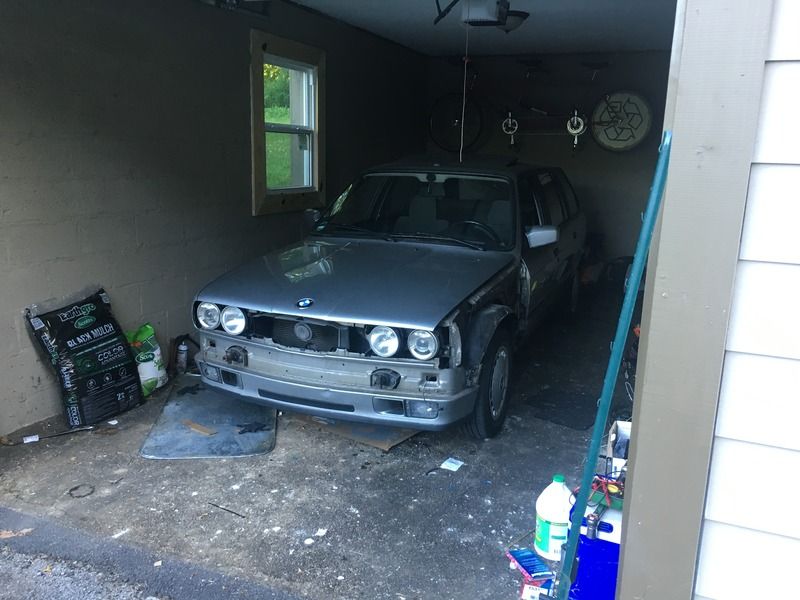

                    Pulled/reset the front bumper with new bumper trim, repainted the grills and black eBay kidneys:

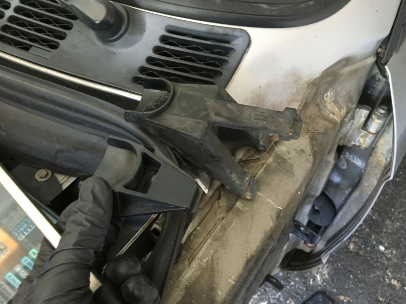

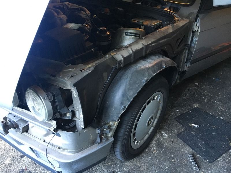

                    A few months later, I set out to finally get the e-fan, M42 radiator and some other garbage all setup. Pulled the driver fender to check things out and to run the fan wiring harness through there:
                    Sad car
                    M40 radiator is ridiculous
                    Definitely need to get the M42 radiator mounts for the swap, the M40 ones are huge and hilarious:
                    SO MUCH ROOM FOR ACTIVITIES
                      Really not sure about the rear rust spots honestly. There's rust in the neighborhood there, but not immediately adjacent.

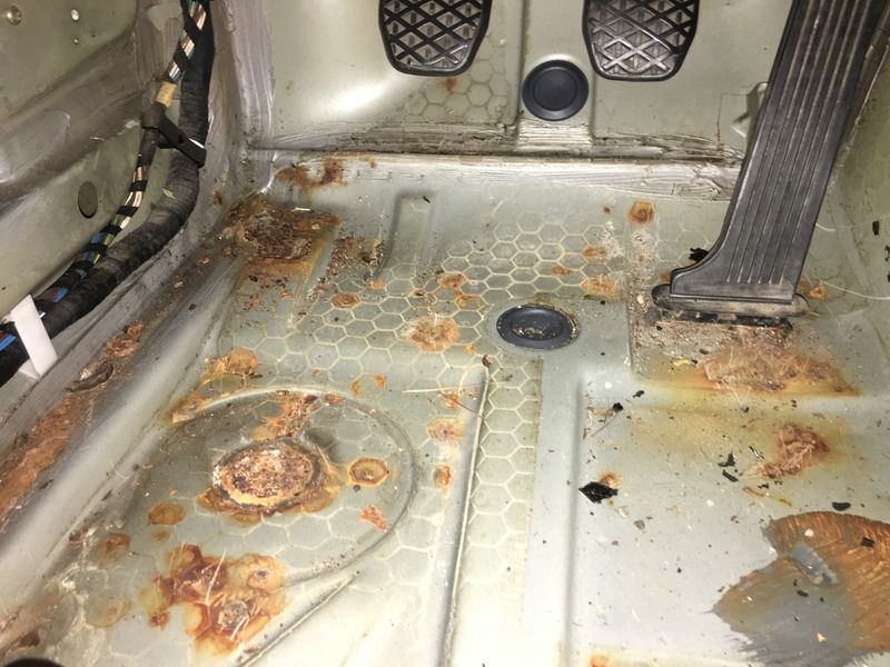

                      I'll post some more progress later, but I did get the carpets all stripped out and the floors of the whole car aren't that bad. The passenger floor is pretty sad, but I think it'll only take a 2-3 reasonable sized patches to be cut/welded. The driver's side rail also shows the beginnings of the same bad rust as the passenger. It's reasonably deep but still superficial damage. I can't punch a screwdriver through anyway, so that's a good leg up from the passenger hah
                      Driver's side has been repaired somewhat in the the front toe-box, but only partially. May need to cut that one too and see what exactly they did.

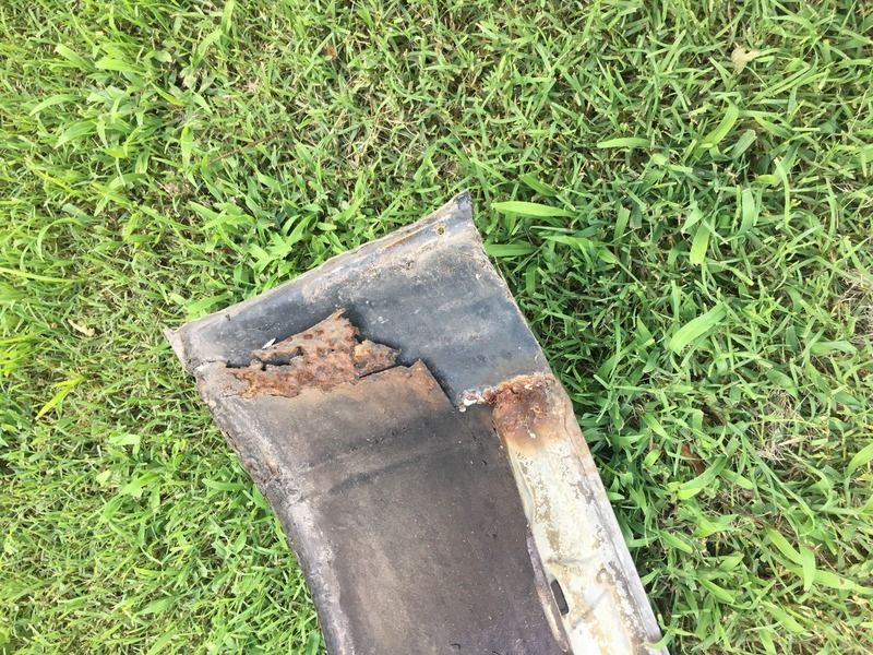

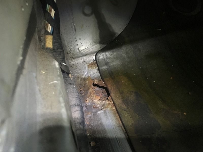

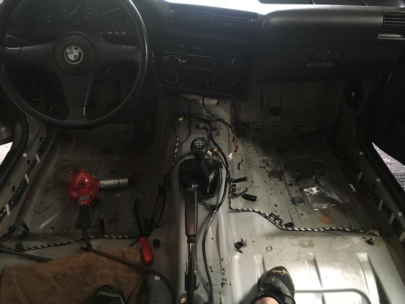

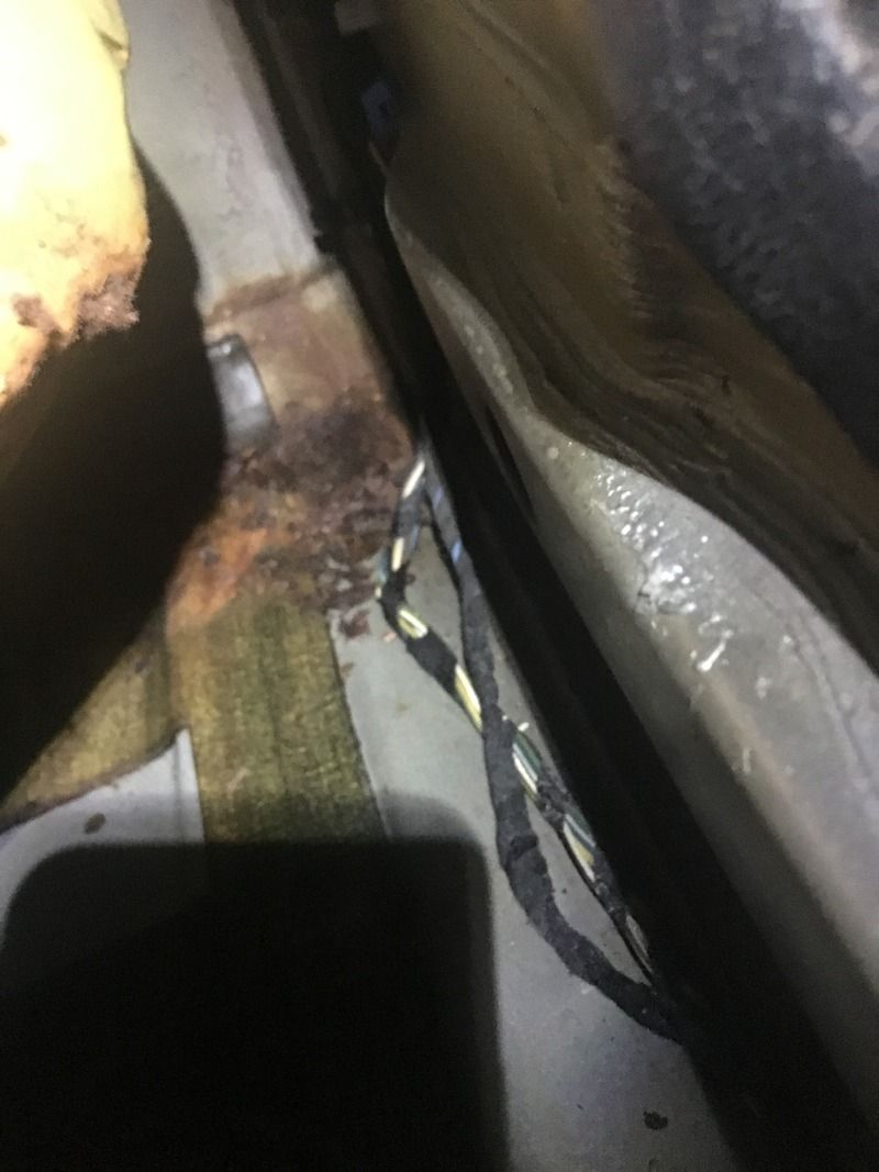

                            So, the passenger floor is very soft
                            This is right before I pushed my finger through the front toe box area:
                            So, go ahead and call me Barney Rubble.
                            Anyways, continuing on. Carpet all out:
                            Sound-deadening all going the way of the dodo. Heat gun works wonders on this crap, although I probably took a decade off my life from cooking it all.
                            Glad I did though, cause underneath the driver it had been a little wet at times -
                            Driver's toe -
                            I thought it had been patched, but it's was just the bottom of that front jack box that I could see through the floor. All that shit has to go now.
                            This is where I'm confused though, what do people do with these sorts of things?
                            They're naturally not sealing very well, so replace them and POR15 over the top? What's the course of action for the seals?
                            Also interesting to see the different sealants, I guess someone has been back through these and resealed them?
