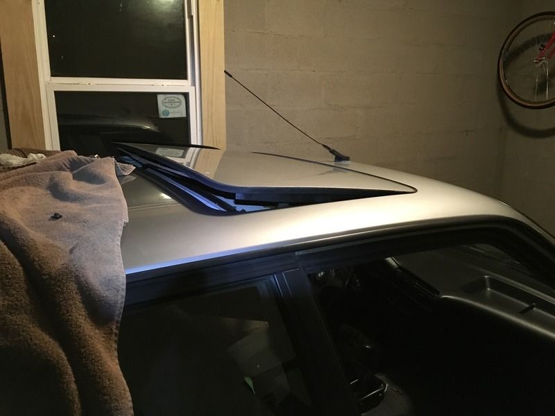

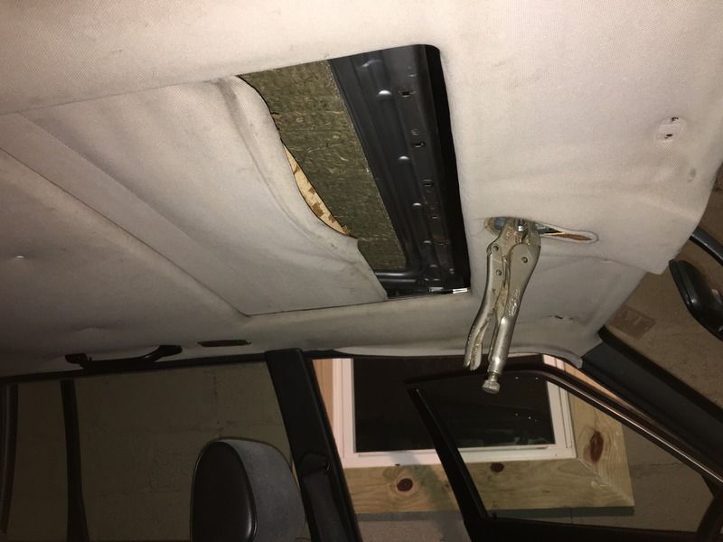

                So, we have functioning roof.
                A very... ugly roof.

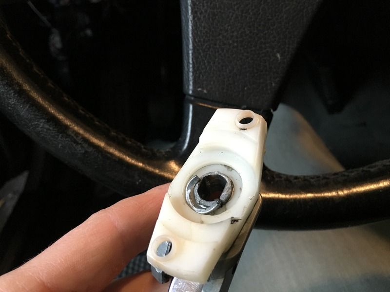

                Ordered some 3M interior adhesive to get the sunroof cover fabric back in place, and also need to get myself a new handle
                Seems to be another causality from the initial breakage. Annoying, but whatever. Also ordered some new front euro trim, rear roundel, brake position switch.
                Need to go ahead and order rear trim pieces, and get some replacement belts. Also on the docket are PS lines, but I really need to knock out the blower motor first cause it's getting pretty damn cold.

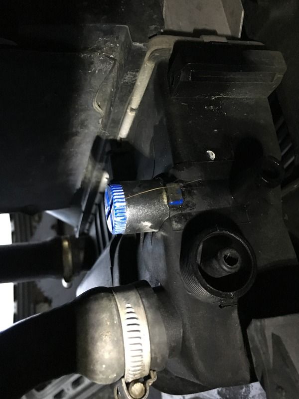

                          Looking for a little coolant drip, think it's actually the drain plug gasket. Annoying.

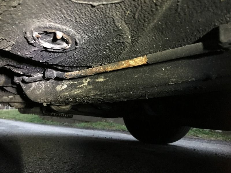

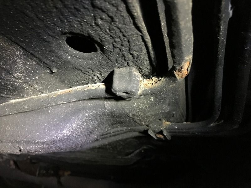

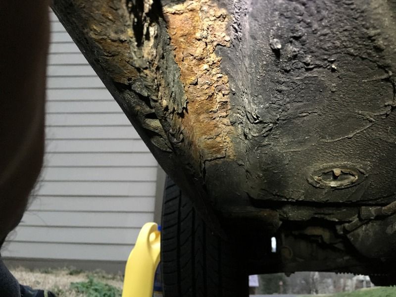

                          Also took the chance to grab some rust pics. Rust doesn't really bother me, but on a scale of 1-10, where do these fit?
                          The front jackpoints have a little gap, which is shitty, so they're rust compromised. May need to grind off the undercoating in places and see what things really look like in the sills :/

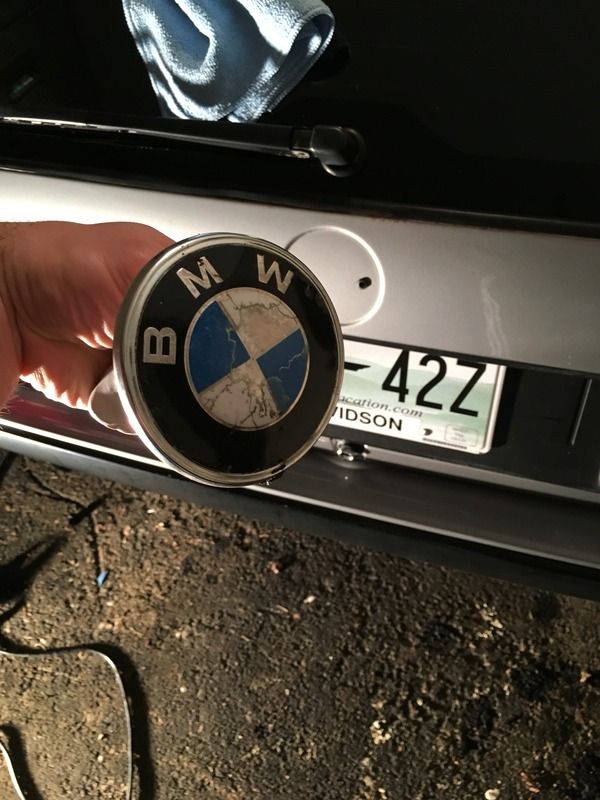

                          New Roundel on the back... cause:

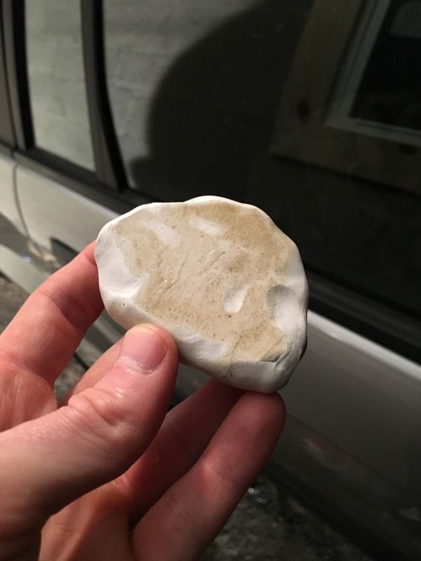

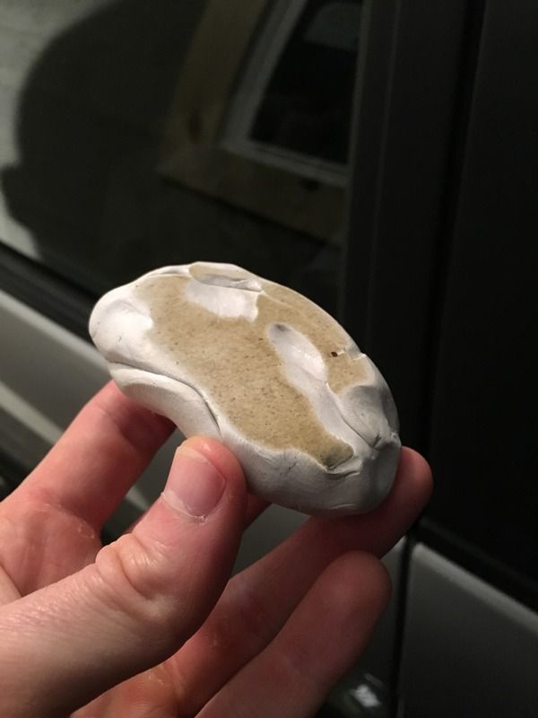

                          Since I finished up the sunroof, took the chance to do a paint cleaning and quick single-stage polish and collinite wax to give it a fresh sealing. Tiny tiny bit of clearcoat failure on the back, so want to preserve the nice paint I can.
                          Here's ONE PASS on the sunroof panel on the claybar:
                          Second pass:
                          Cleaning just the roof took forever (and also killed 1.5 claybars, ha)
                          Edit: Actually, looking back through some of Rougetoasters photos (thanks dude) I see that the bottom of the car really wasn't too rusty before the coating was redone. I guess i'll just continue on with the previous plan of maybe repairing the front jack point area, and then pulling off the fender liners and bumpers to check for other rusty regions.
                          Need to go through and treat a few areas. Tiny bit of surface rust in the back right hatch compartment, little bit underneath the rear window on the hatch.

                            That rust does look to be a bit of a worry as the pic appears to show metal flaking. Even so, it looks like it's still at wire wheel/rust coverter/undercoat.
                            As to the radiator, it's fairly uncommon to have the "drain plug" (rarely works as it gets clogged with deposits) leak. Fortunately, it's all M42 stuff, so is readily available.
                            For the sunroof handle be sure to get an OE one as every alternate brand I've tried has broken or had the spring fail. For instance, the spring on the one that was in the car failed the day you came to pick it up, despite being under 6 months old.

                              I'll have to inspect the radiator a little more. For lack of a better description the little blue 'block' on the bottom of the drain area seems to slowly collect coolant and drip. It's also conveniently the lowest part of the radiator, so I may strap a gopro under there and see where I'm pushing coolant.
                              It's a pita, but I think i'll just buy a new oem handle. I blew through another used factory piece in all of 10 minutes.

                                I'd bet that you're getting a coolant leak from the tank gaskets. You can rebuild the radiator overflow tank, but it's a bit of a pest to do and not much less expensive compared to a new radiator assembly.
