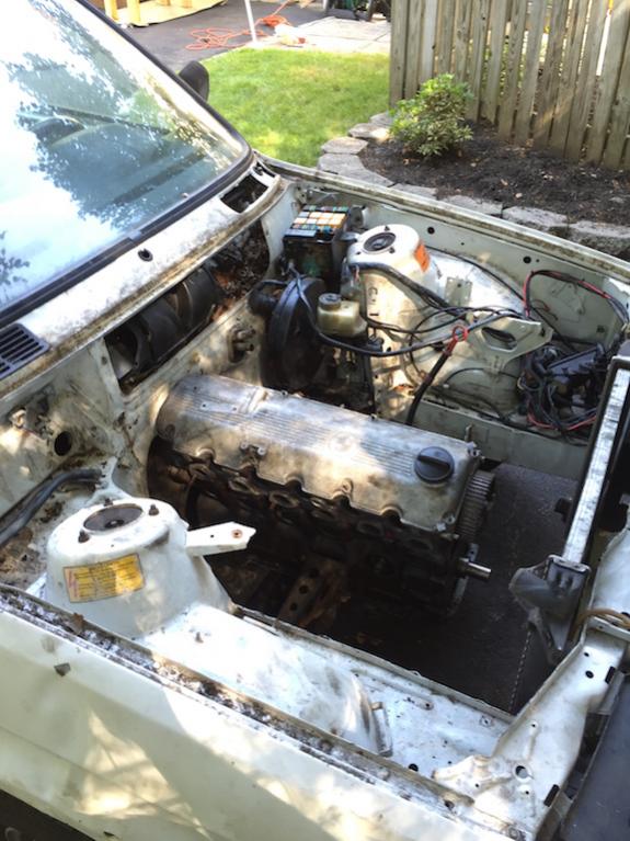

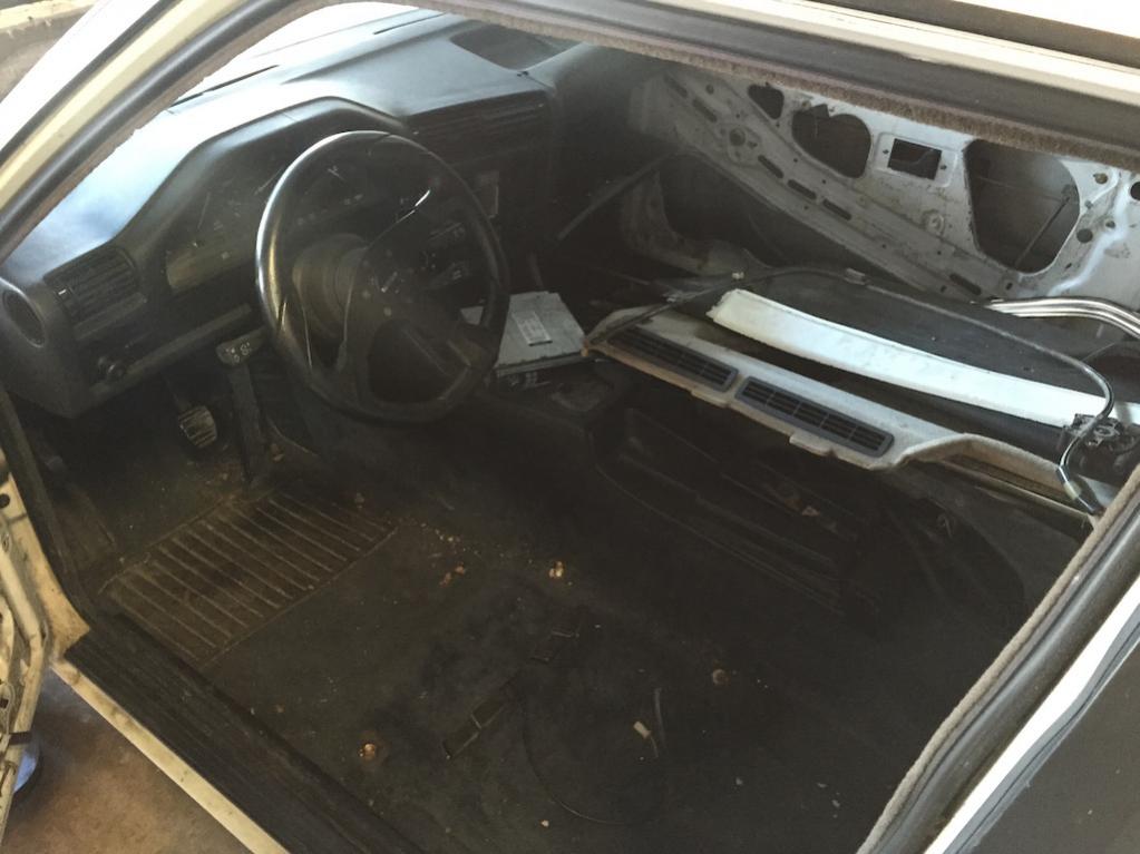

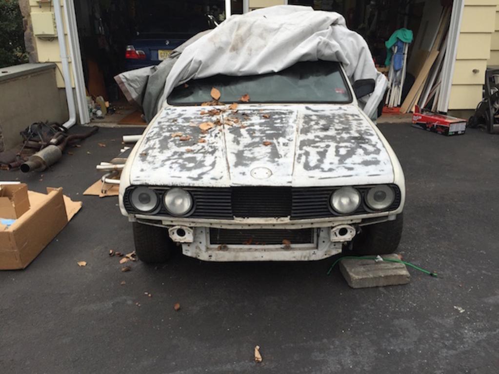

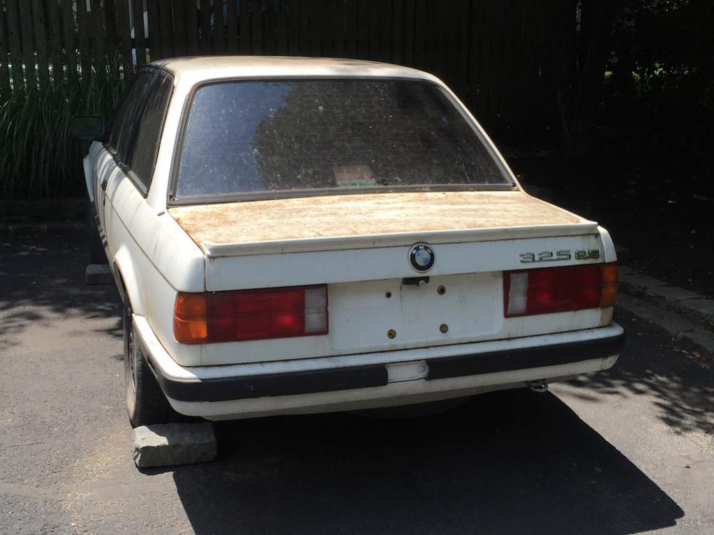

    So today I finally started a project that I have been collecting parts for since July. First swap, though I have had the opportunity to do a ton of work on other cars. Also, most of what unbolts from the car is for sale. I am only keeping what I need for the swap and keep it on the street.
    First the car. I bought if off a guy who was in the middle of a rebuild, but unfortunately had to get rid of it as he no longer had the room (he was moving). And as the price was right, and I have an issue with heavily modifying a clean car, I came home with what my my parents and friends affectionally call the rolling wreck.

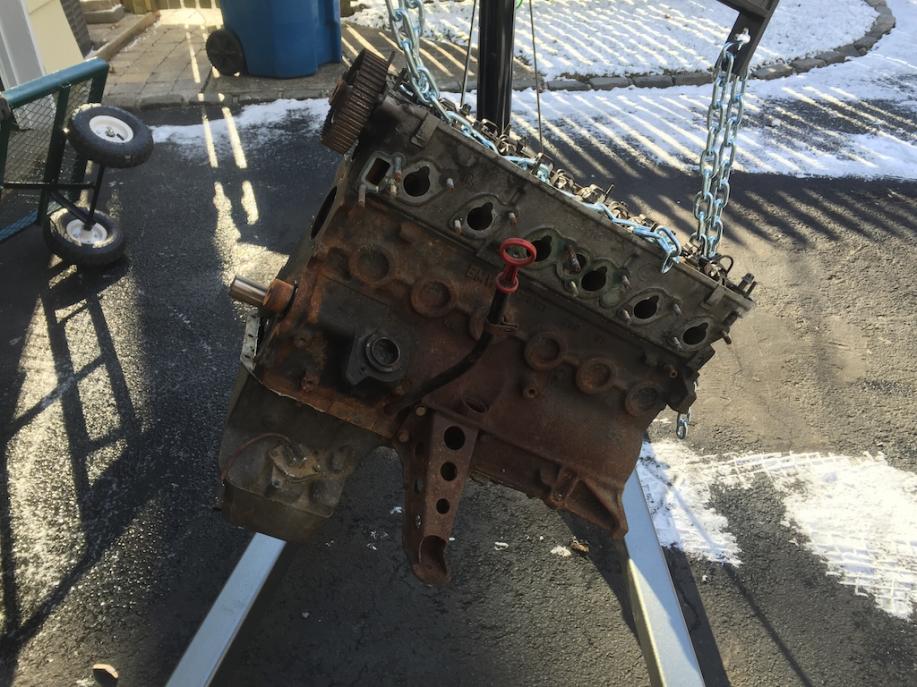

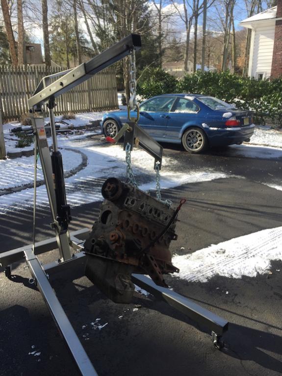

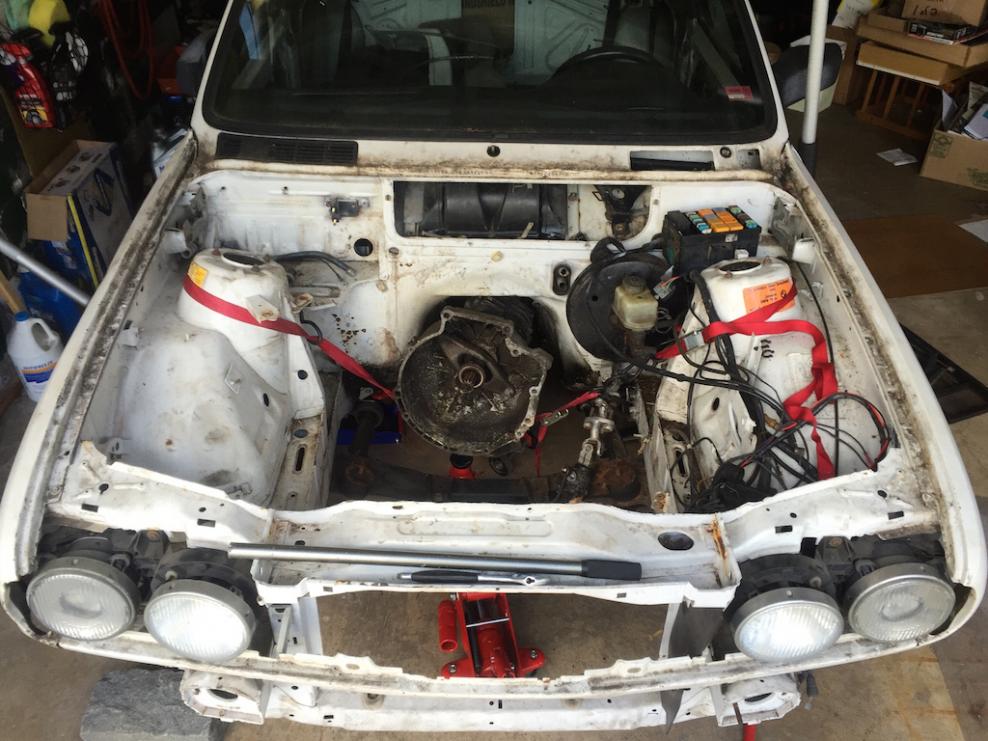

    So today we took the engine out. Was a little cold since we were standing outside with the crane. Took us two tries, as we hit the top of the garage doors right before it cleared the first time. So we unbolted the transmission and tried again which thankfully worked.

    Engine has seen better days.

    We used ratcheting ties to support the transmission and keep it from twisting of the jacks under it.
