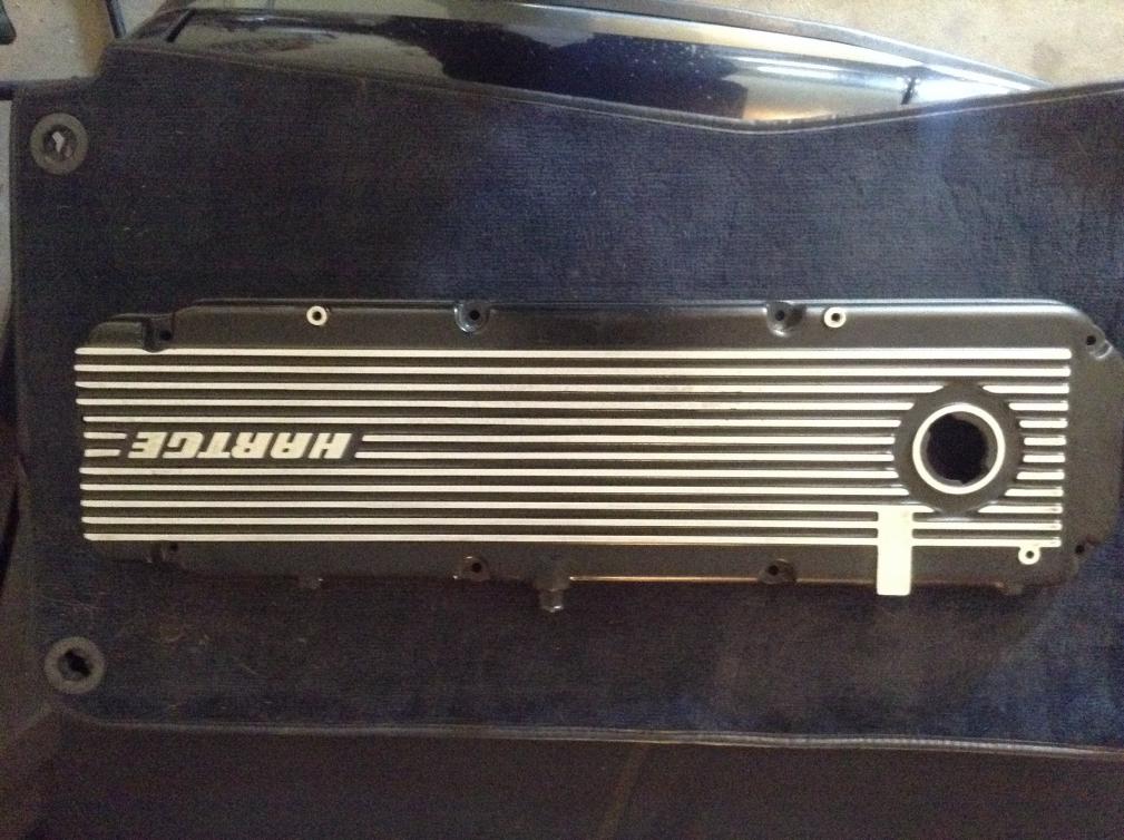

                ...........this should clean things up nicely

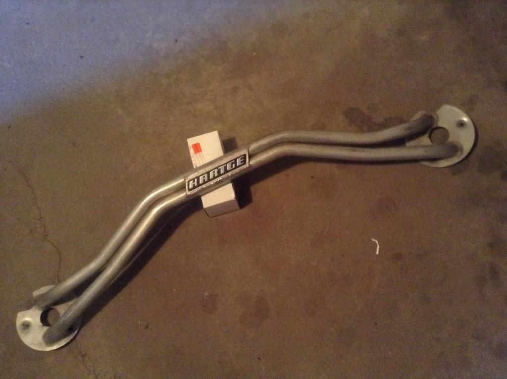

                  ..............then....get the "period correct " expansion tank set-up...
                  ....................& polish-up & add one of these
