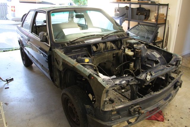

    Here are some photos of the car when we first got it, pre and post wash. It then sat for a few years getting filthy again.
  • humguy
    • May 2013
    • 13
    Before having the M40 pulled
    New home in my garage
    While it wont be the factory colour, it will be a dark blue of some sort

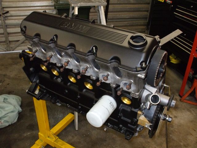

                          Oh yeah, and I picked up another engine. An M20B25 with all the parts for 2.8 stroker, and a Schrick 288 cam. Cant wait to get it together with RHD ITBs!
