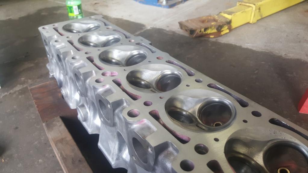

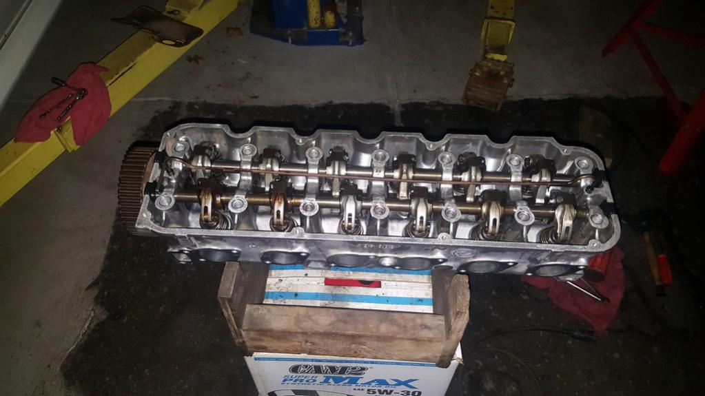

    Head gasket x2 (for those wondering, Jb weld holds up to cylinder pressure for about 18 months on a nick in the head)
    New timing belt 215,000 miles when head gasket got done
    Used head lapped in all valves, decked by AIM parts in glenshaw PA

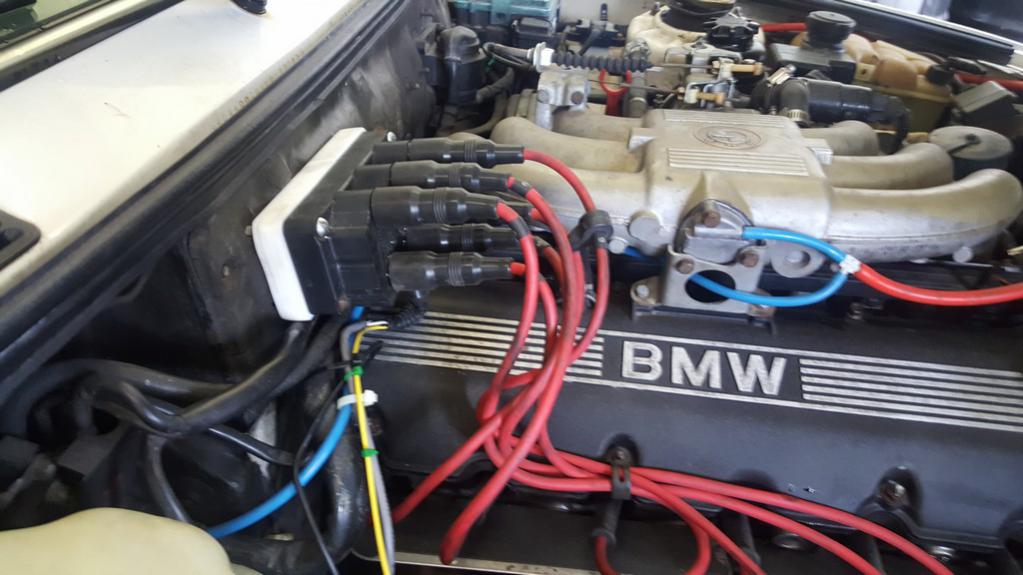

    Get saab v6 ignition coil and finish wasted spark (done)

          Wasted spark done (want to find nicer looking set of plug wires)
          Distributor delete plate on
