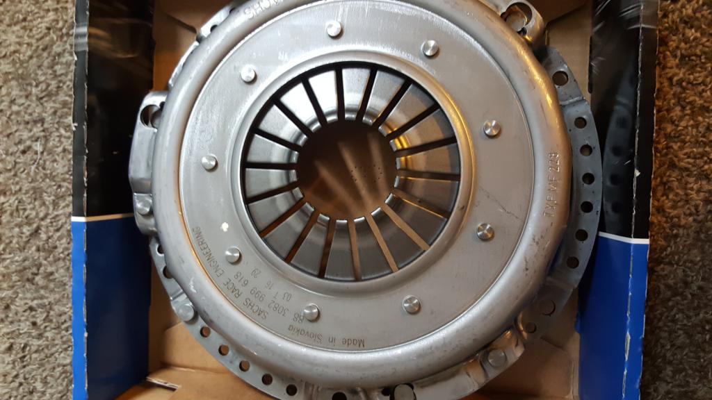

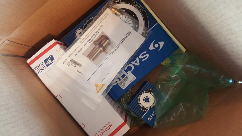

        Goodies arrived 618pp and disk and z3 1.9 shifter and bronze pivot pin

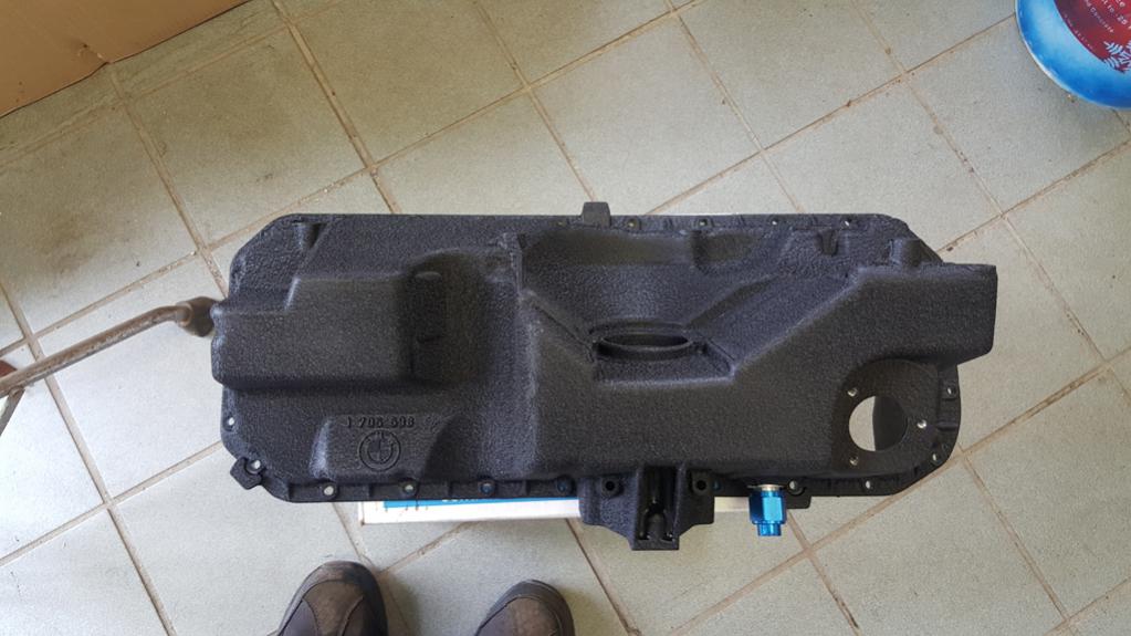

          pan painted up and oil return welded in

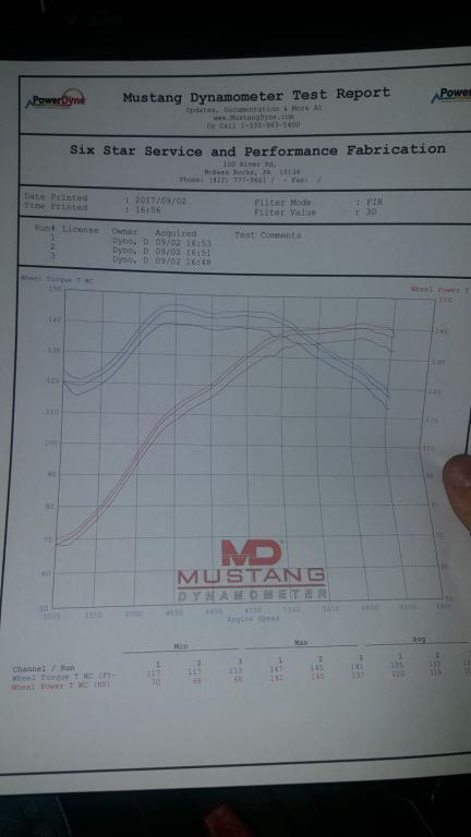

                    Dyno
                    Finally got the old girl on a dyno, Huge shoutout to six star performance in Mckees Rocks PA
                    142 AWHP
                    147 AW ft/Lbs

                      Did you dyno it stock?
                      AWD > RWD
                      • 2002tiiguy
                        • Jul 2013
                        • 467
                        Not as it came from the factory, no, but theres no performance parts on it
