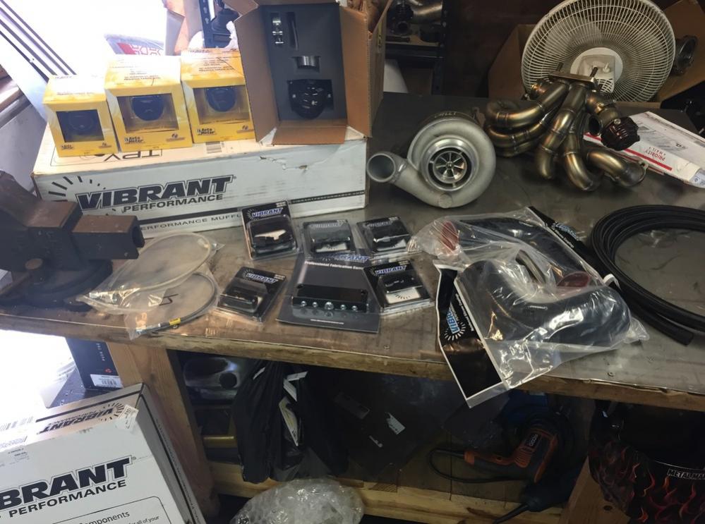

      starting to look like something!
      [ATTACH]112260[/ATTACH]
      [ATTACH]112261[/ATTACH]
      [ATTACH]112262[/ATTACH]
      [ATTACH]112263[/ATTACH]
      [ATTACH]112264[/ATTACH]
      IG- nv_e30

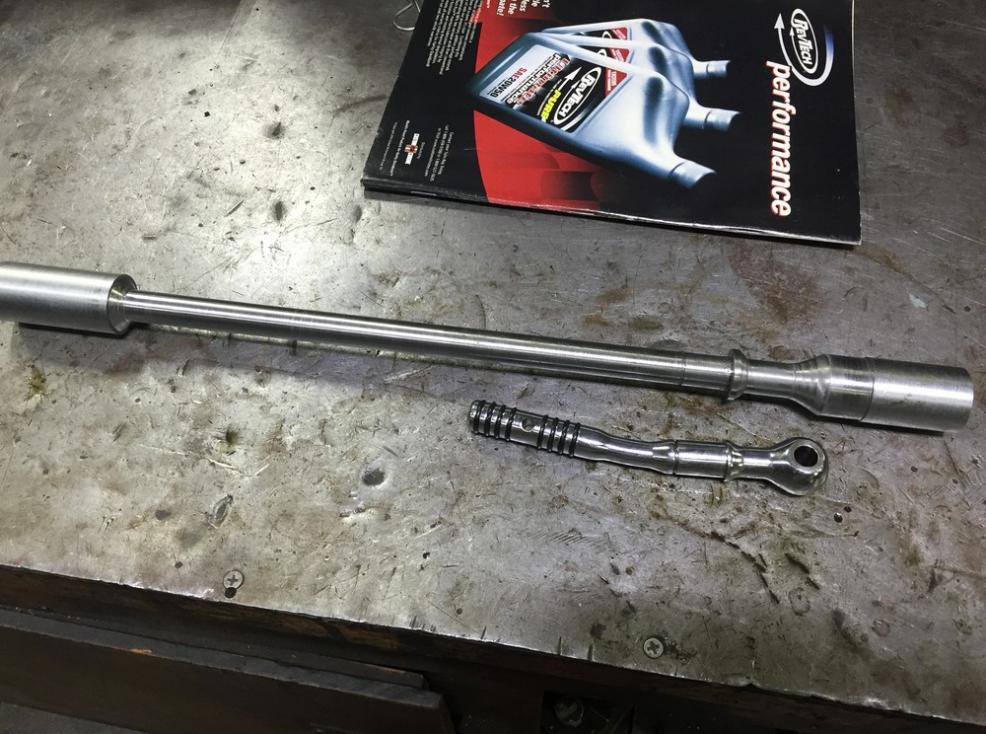

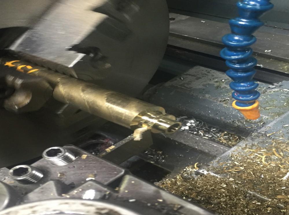

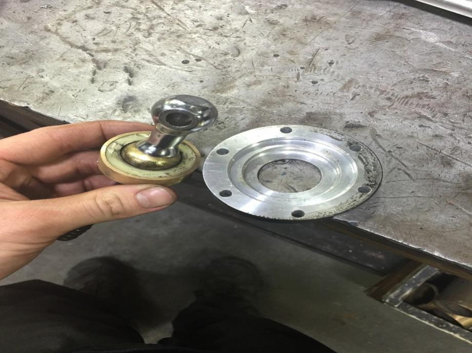

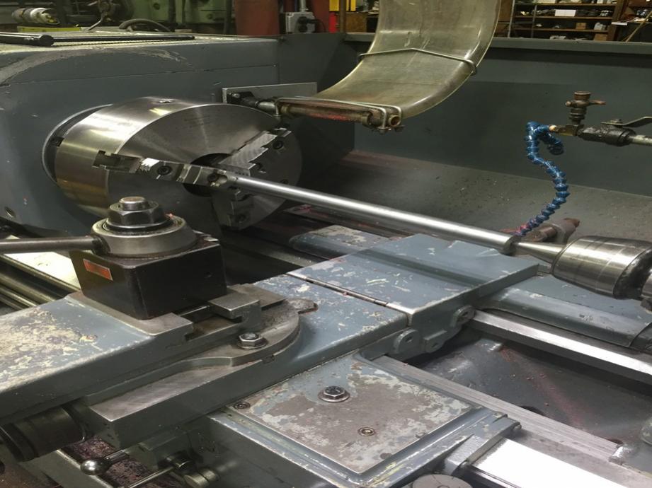

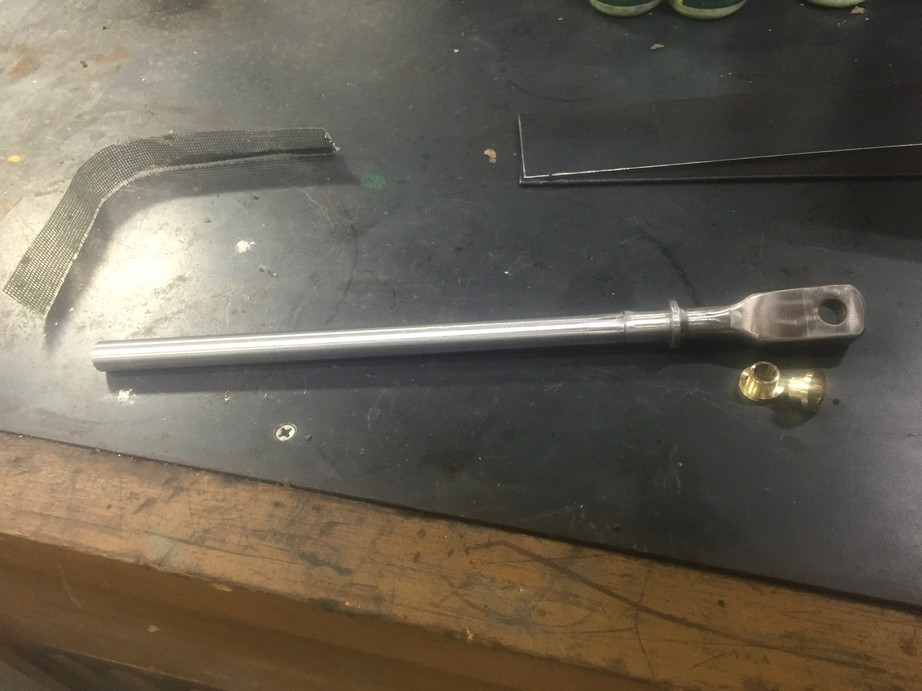

          I did want to pay for a solid mount shifter so i decided to make one
          I found the aluminum circle in the scrap bucket at work and it almost fit the nylon bushing
          so i made a brass sleeve that the nylon pressed into and then pressed into the aluminum circle
          I made the shifter long and decided i can cut it down to the height that feels good in the car

          after turning it down i took it over to the mill and made the end flat to receive the brass bushings

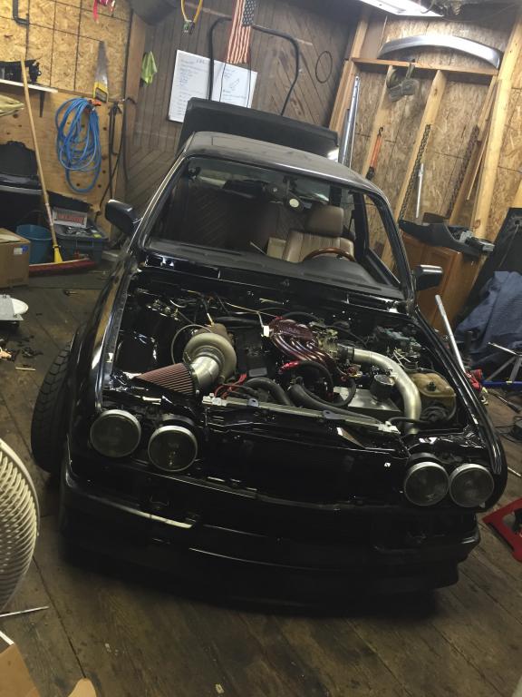

                    This was an awesome day!! I took a week off work to get her from an empty painted bay to a running car with all -AN fuel lines, Meth injection, and well everything else needed to run
                    A GIANT thanks to Dennis over at OMG Motorworks for helping me with all these parts and dealing with my constant emails of, Oh wait i need one of these too and oh wait i need two of these every day for that entire week :SOS:

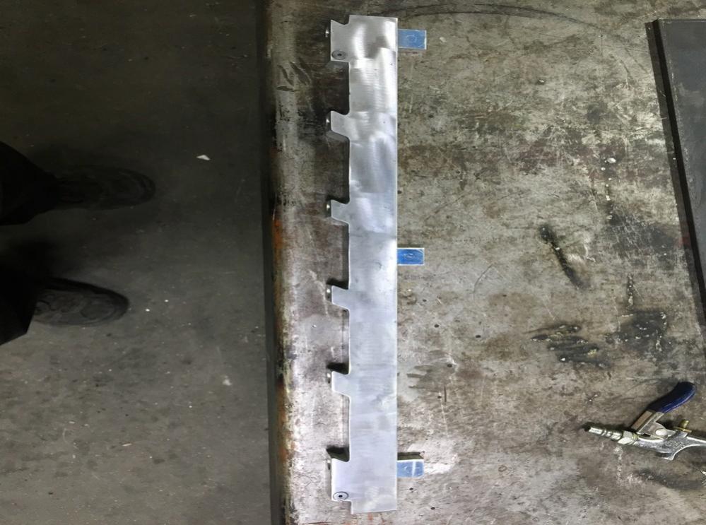

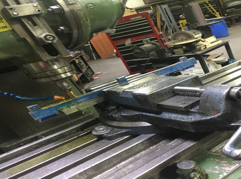

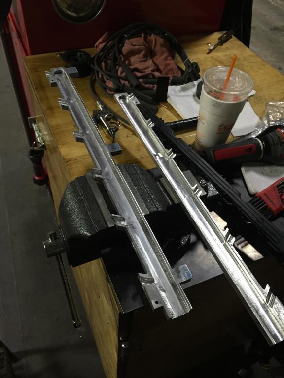

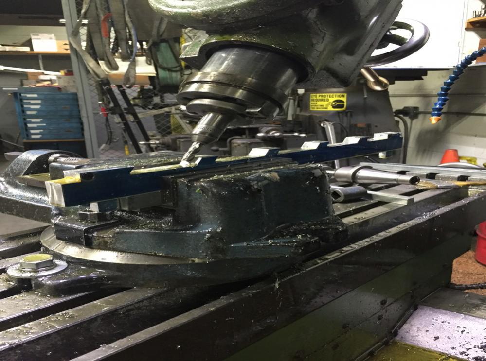

                        The oem wire holder wouldn't fit with the turbo and the previous owner of my valve cover/ catch can had the coil packs mounted on the valve cover
                        so I used 3 of the holes to mount my own wire holder to get them out of the way and save them from melting
