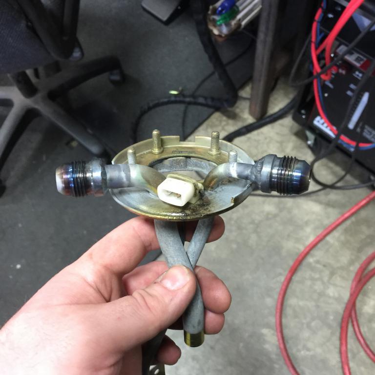

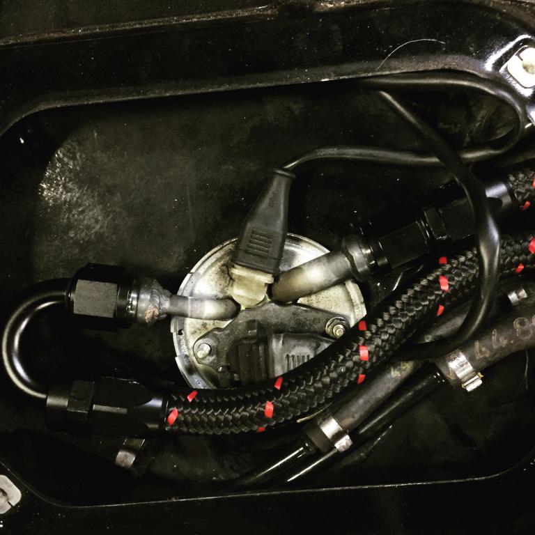

    After all that well more bad stuff happened :(

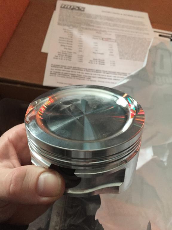

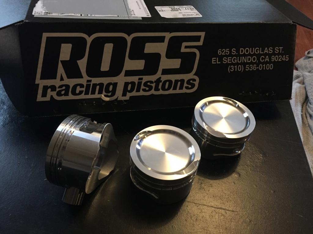

        id recommend against the ross pistons, they are kinda crappy quality, you can see the comparison in my build thread. the je pistons i'm using are pretty nice.
        je, ross, and high compression m20 (9.7:1 CR)

          Too late I already have them but thanks for your opinion
          Is your Ross racing in the middle like it says beneath the picture?
          I did read your build thread before and isn't the JE the one that broke?

            correct on both counts. The ross piston has a very basic crown. I don't know enough about it to speak intelligently about the piston design, but I like how the je piston directs the combustion around the spark plug like the stock style pistons instead of being flat on top

              I'm sure that has to do with the compression ratio they are specified to yield
              My Pistons look more like your JE Pistons on the left
              I'll get some pictures up tonight when I have time

                heres what i have for pictures to give you an idea
